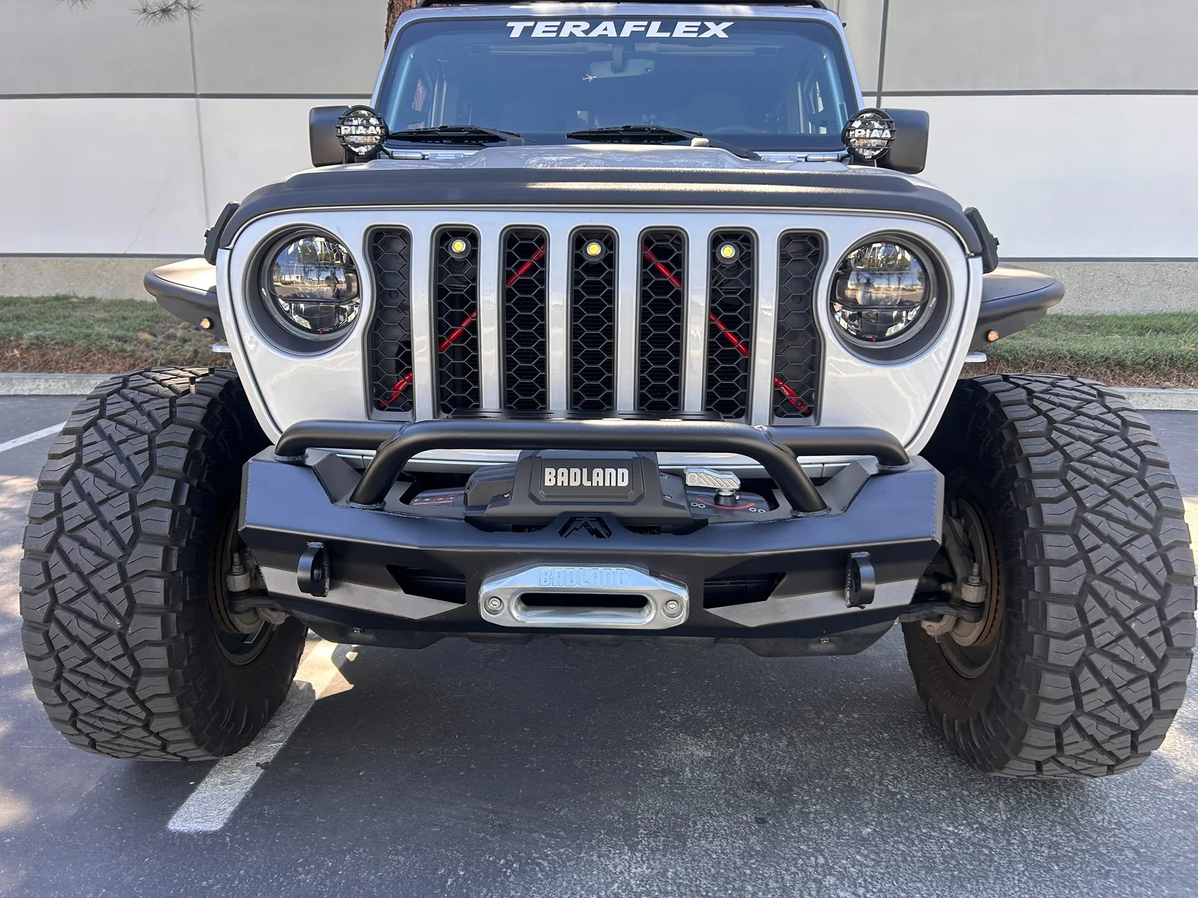

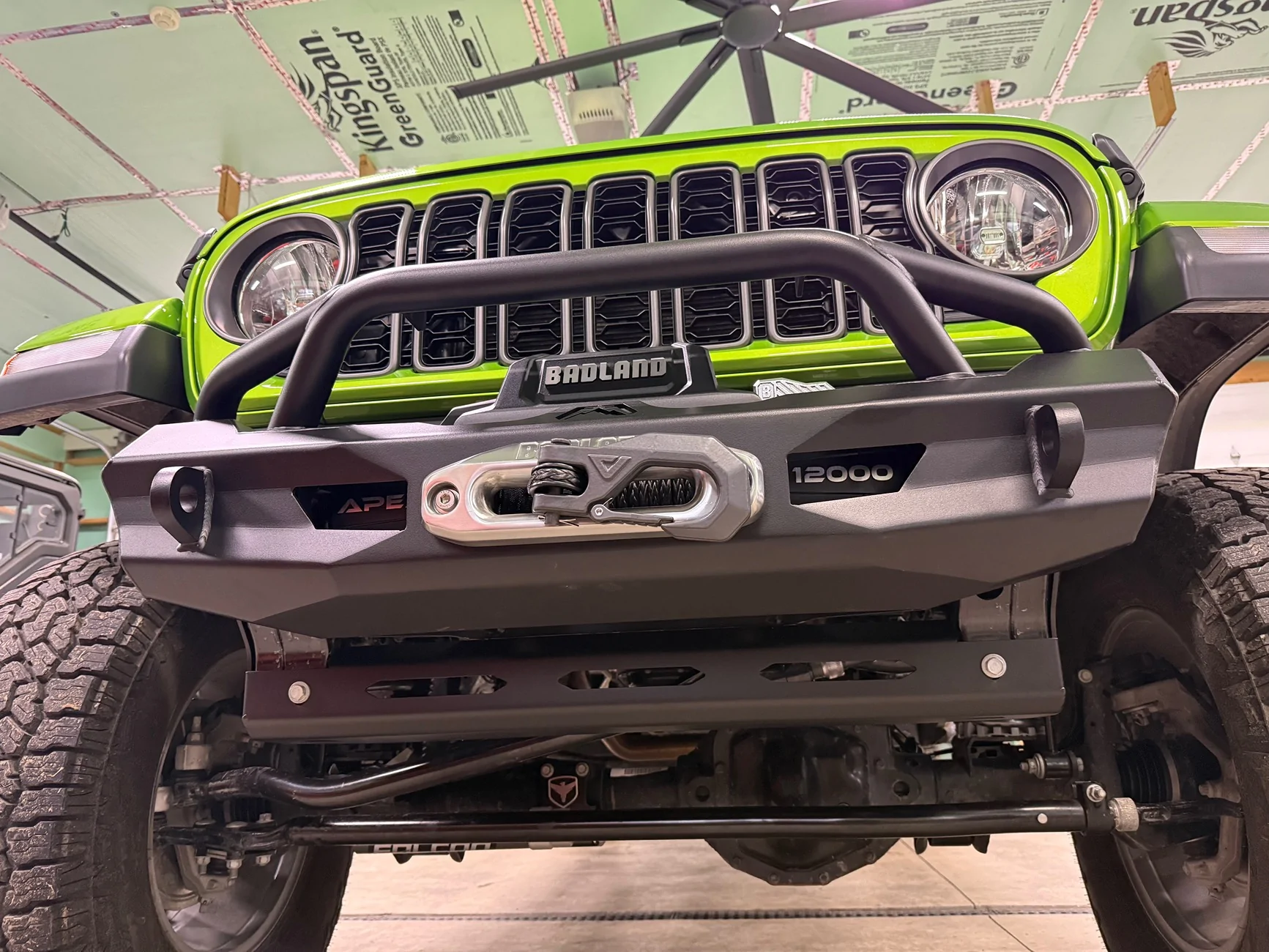

I just finished up installing the new Fab Four Ghost Stubby front bumper and sway bar cover along with the Badland Apex winch tonight, I think it looks great!

Pretty cool Ron, that bumper has the big Badland winch down low not blocking airflow to grill, not sure I have seen another that low.

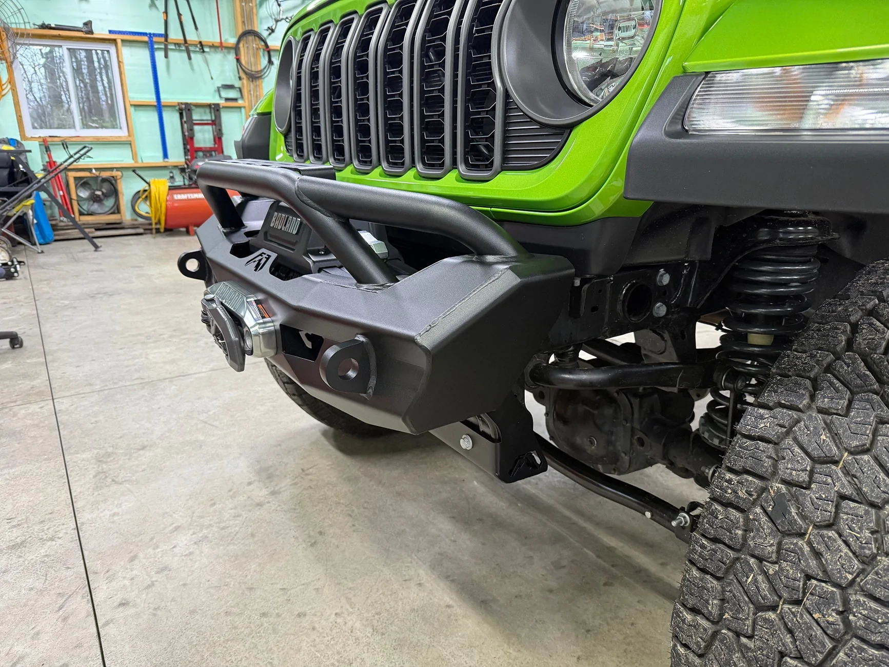

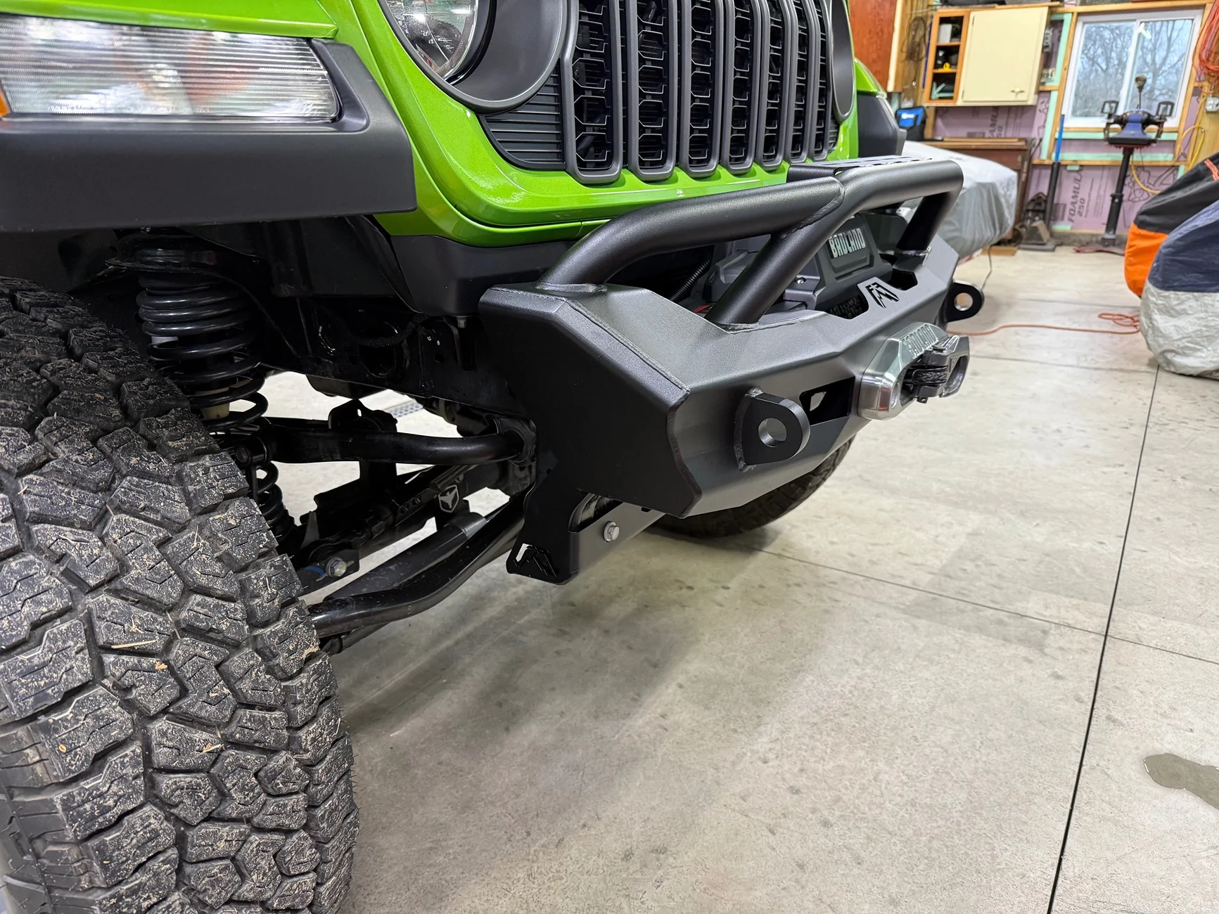

I've been contemplating switching out my bumper to this one but have seen very limited pictures out there. Any chance you can post more pics of it from different angles?
Sure I can do that, I couldn’t find any pictures of this bumper as well besides the few on the website. I can say it’s very well built and the packaging is great they had the bumper wrapped up in a fairly heavy cloth bag to protect it in shipping.
Nice!…..Jack
The Warn winch sits that low in the Mopar steel bumper.
Your right just looked back at a couple bumpers even Badlands is below the new grill slots, I just see so many that really stick up, my small Warn with relocated control box is inside the Warn performance bumper. …Jack

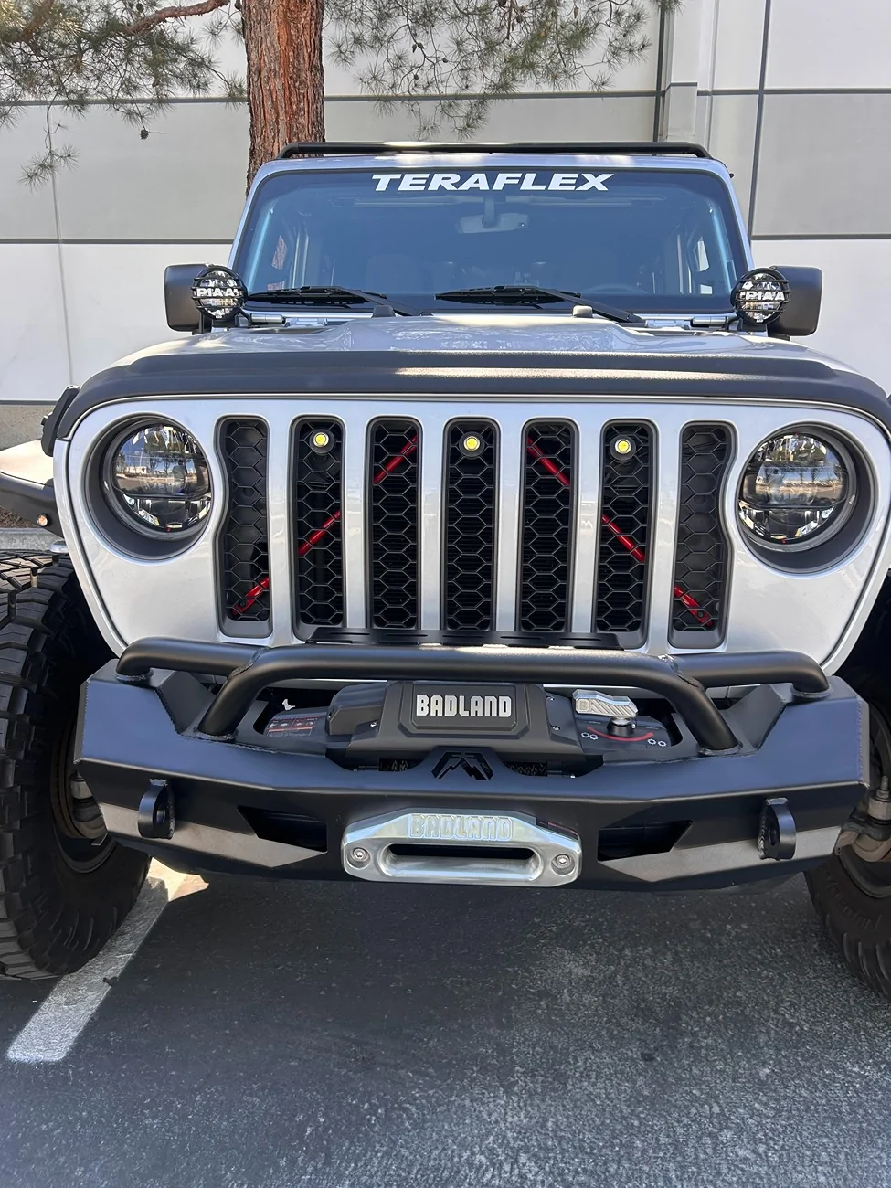

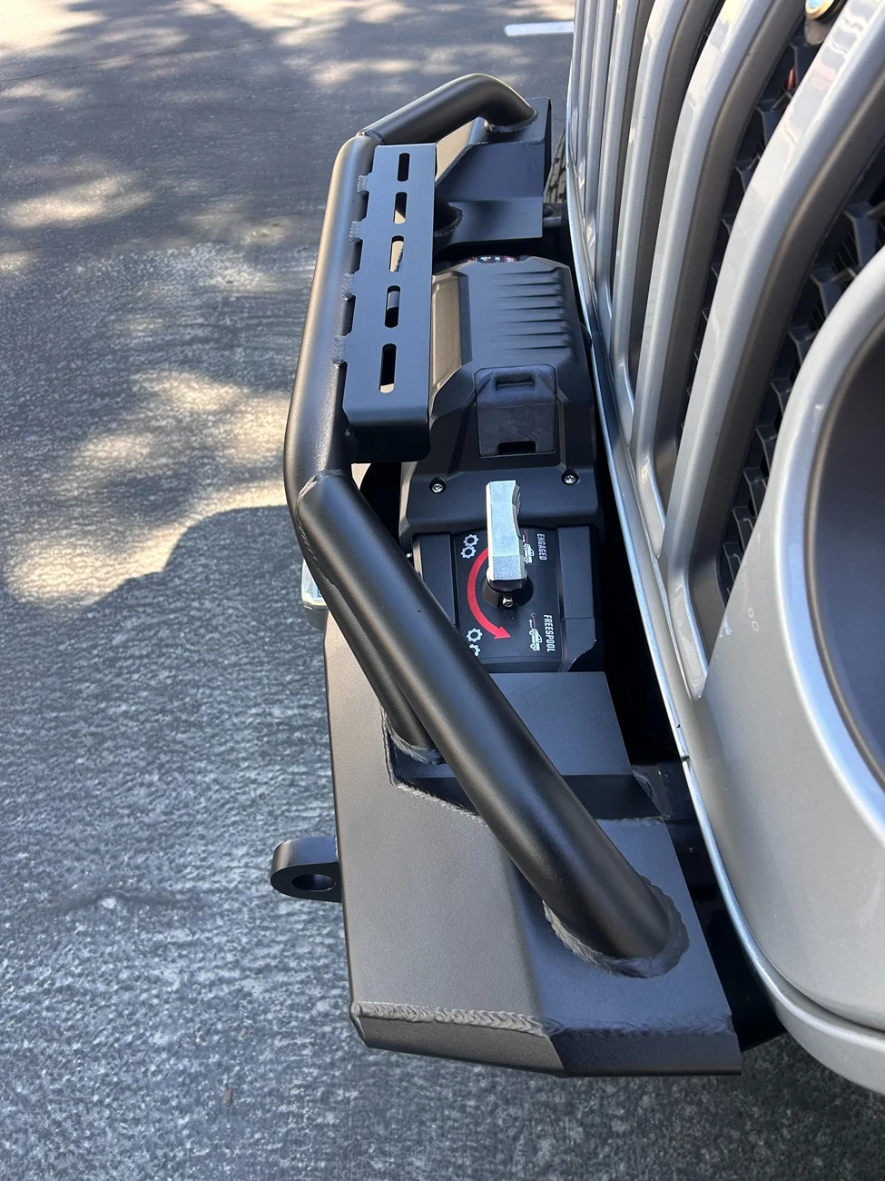

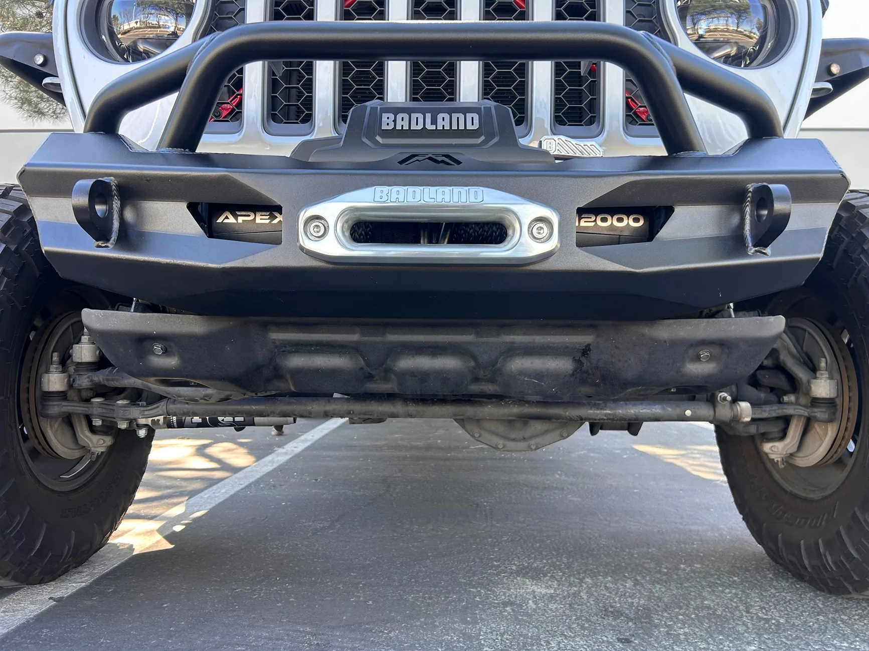

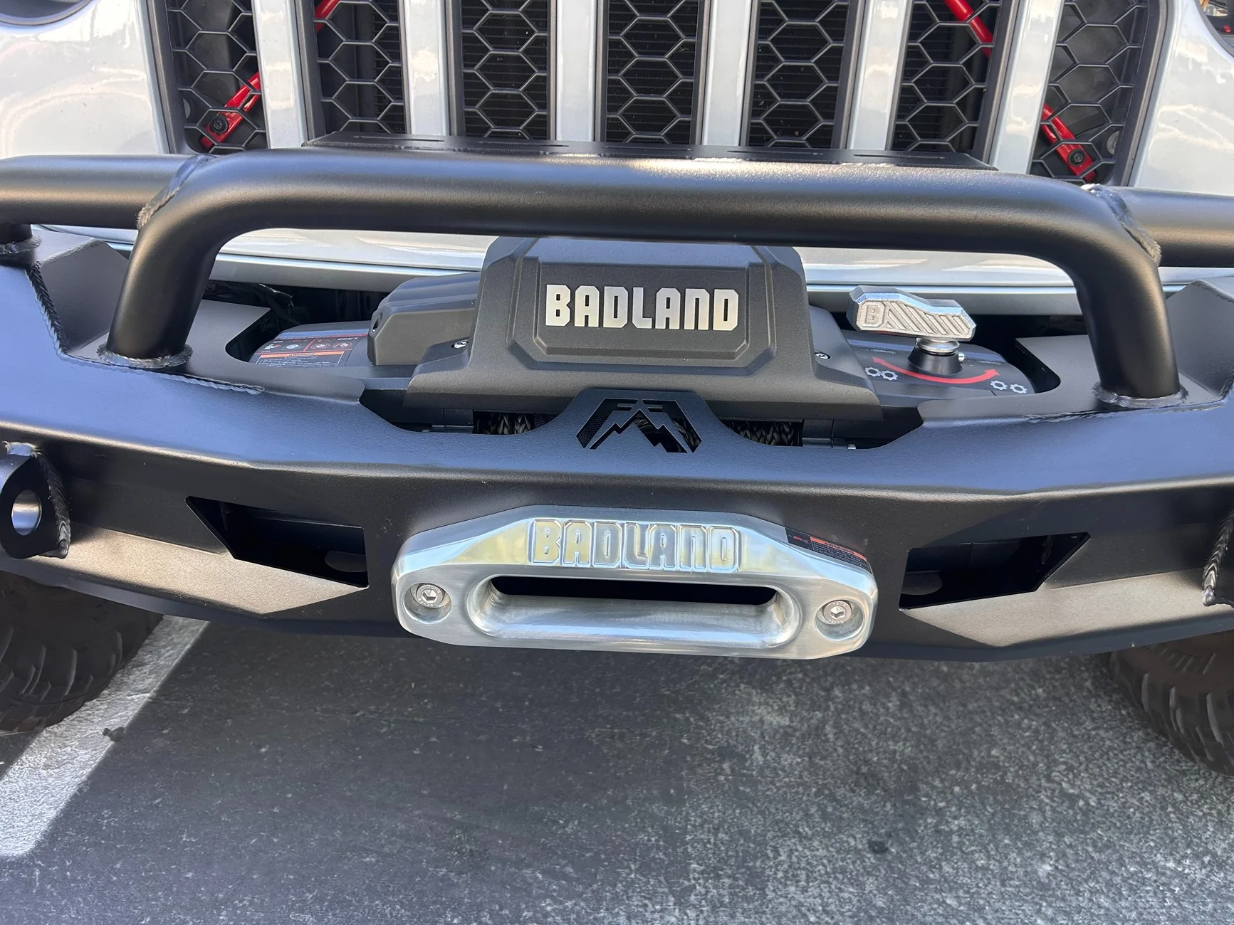

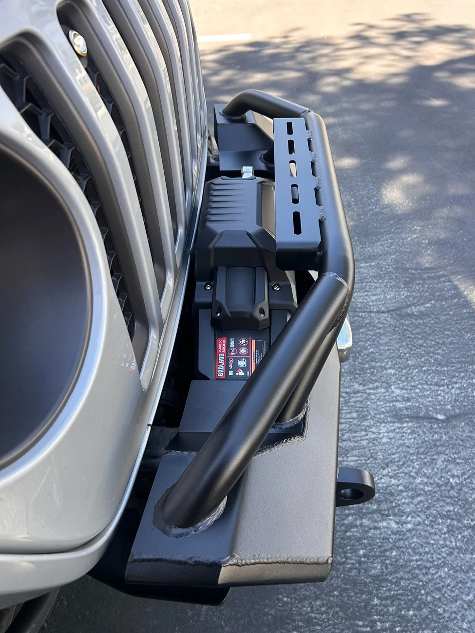

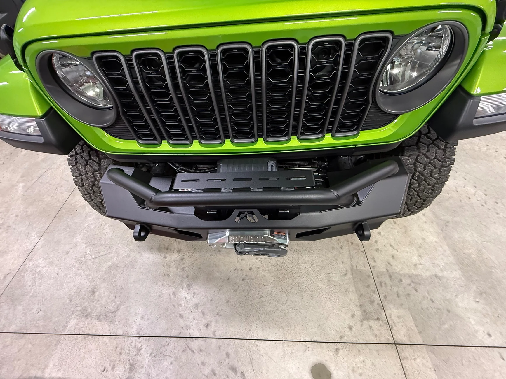

I just installed this exact bumper on my 23’ Gladiator Rubicon yesterday.

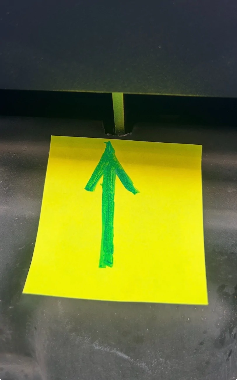

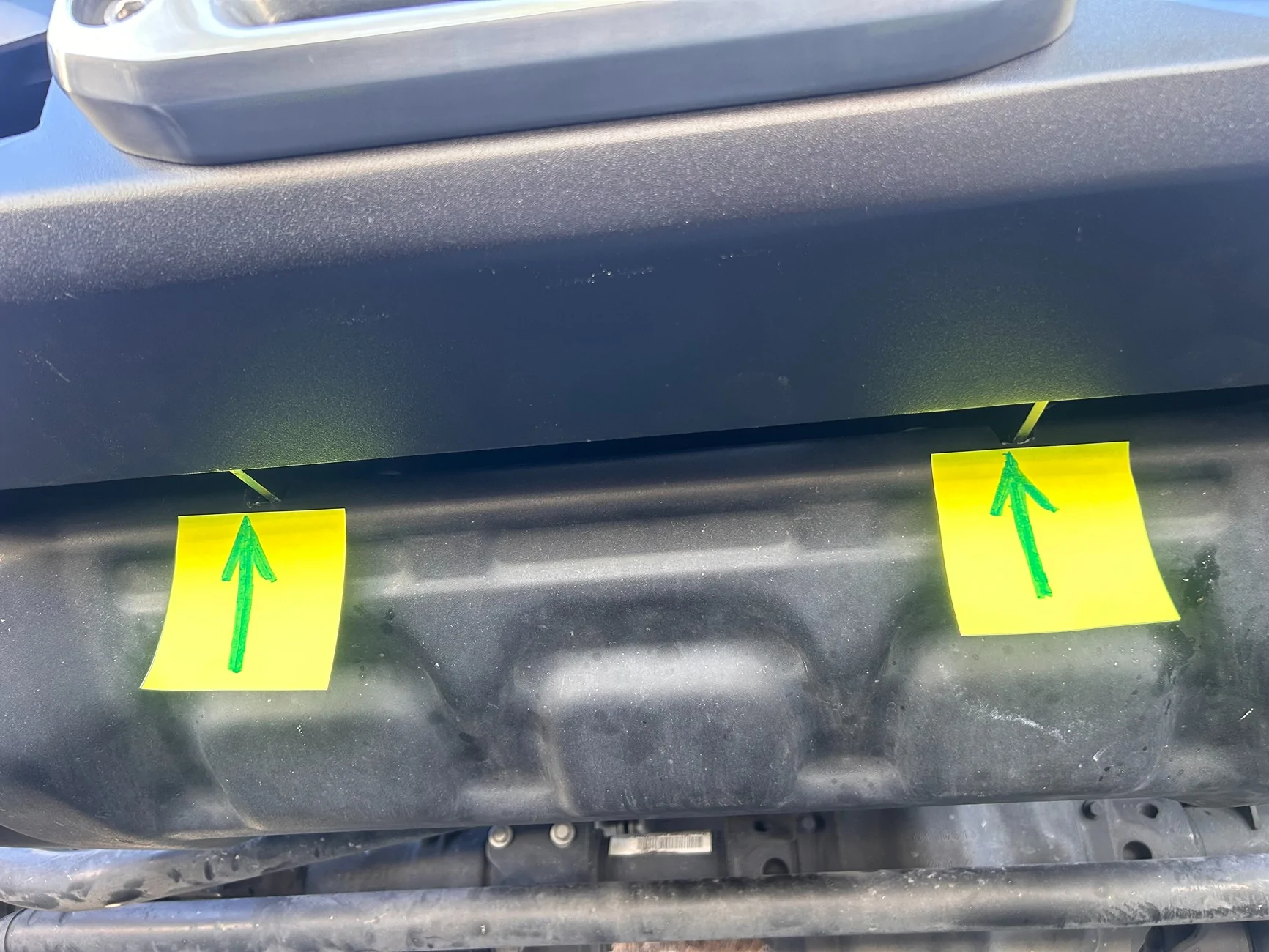

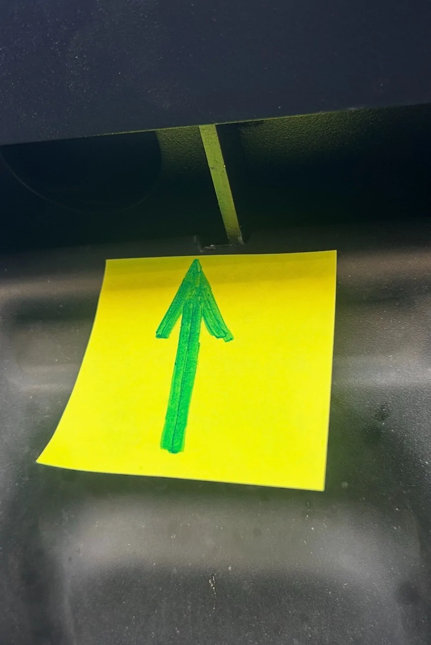

The Badland 12k Apex Winch with synthetic rope fits like a glove, and bolts right onto the existing Fab Fours winch holes. I recommend you remove your grill and that should give you the required clearance to install the Badland winch after you install the FabFour bumper. Unless you decide to install the winch onto the FabFour bumper before your full install, but that might require a couple of people holding the bumper in place while you can go under the jeep to bolt it on, the combination of the bumper and winch makes it heavy AF. Another recommendation is that you pre run your bolt screws through the FabFour bumper screw holes with a little WD40, I found some over spray that seeped into the threads that could of cause pontential stripping or made it extremely difficult to tighten up while I was under the jeep. Ooh and I was able to use my factory skid plate (Big ++) Just had to do some minor fab work if you want to call it that lol. Just did some minor grinding to make two little slits on the front top of the skid plate to make it fit and settle into its original location. Super easy to do (pics of that to come to). And the slits are so minimal that it did not damage or weaking the factory skids plate if anything I feel it’s just as strong as before.
