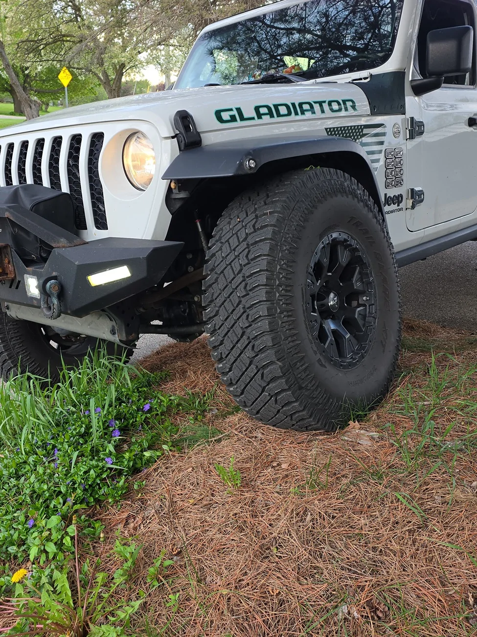

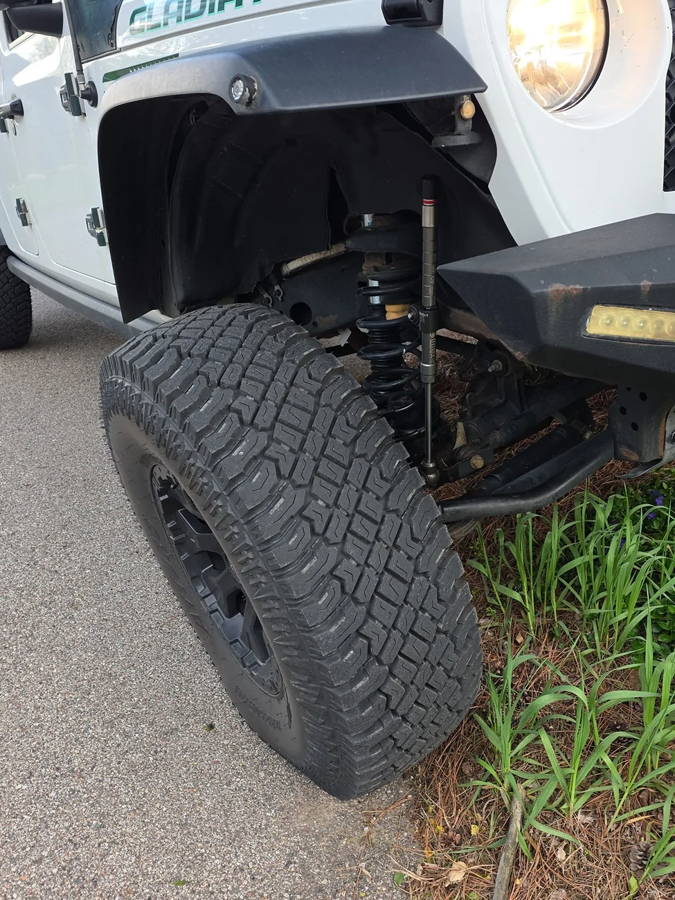

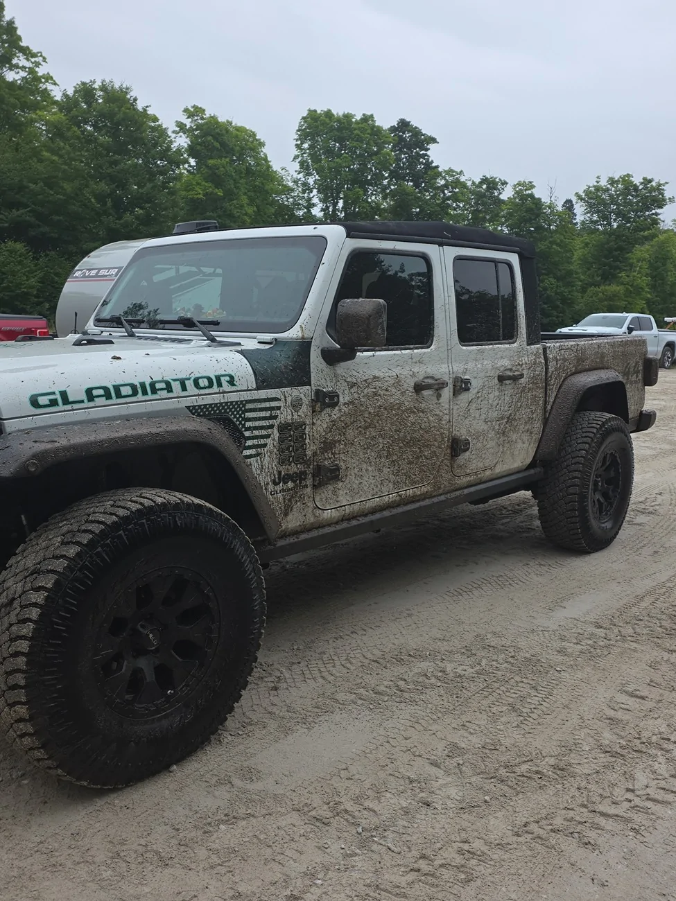

2.5" level front, .75" rear puck
37 x 12.5. Max Toe split flares.
No rub when offroad
