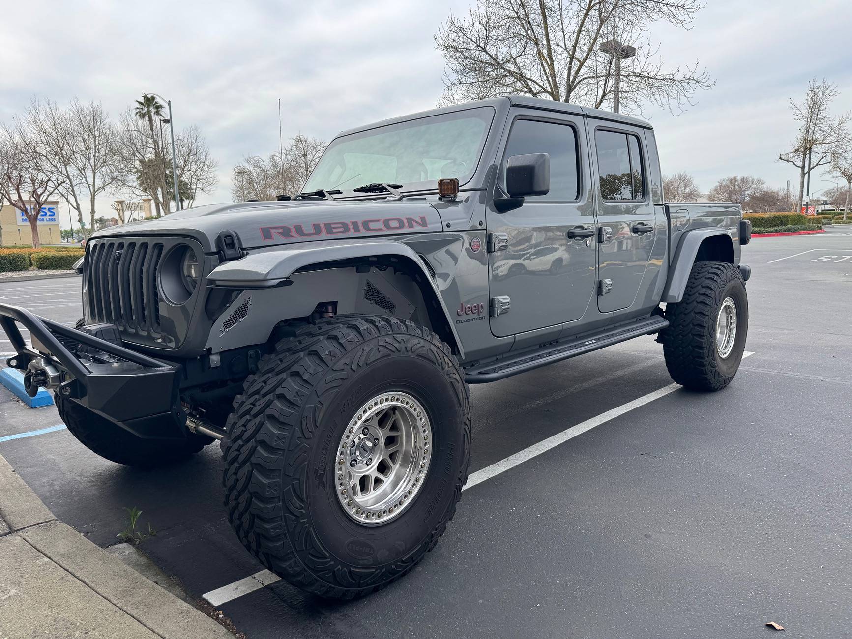

what brand inner liner is that ?
These are the Motobilt High clearance inner fenders part number MB1243. They gain you 1.75”s of clearance in the upper rear corner and if you choose to you can cut the bottom by the rocker back an additional 1.82”s. You don’t have to but you can gain much more clearance doing so.

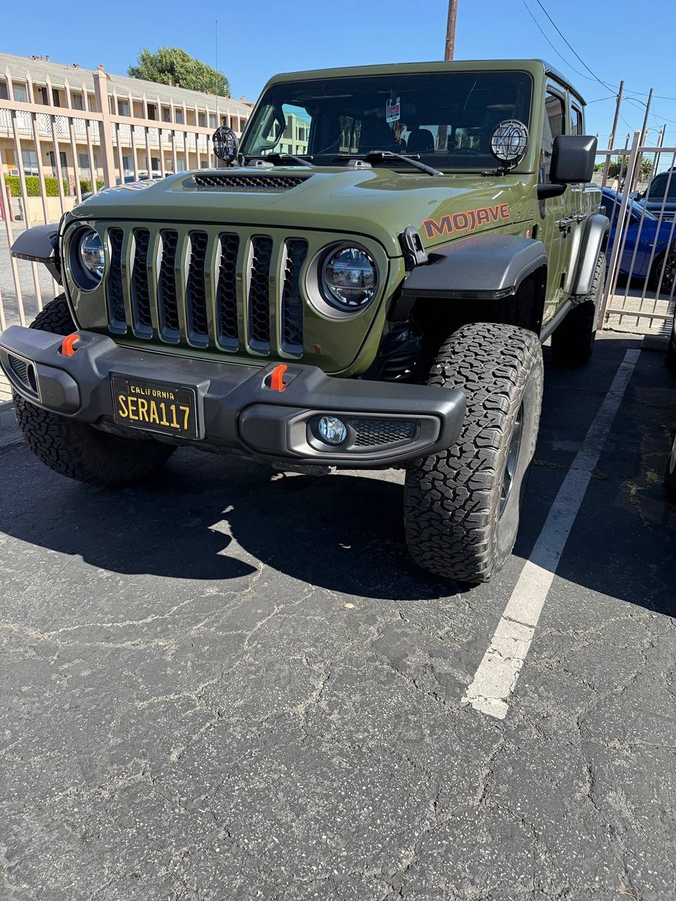

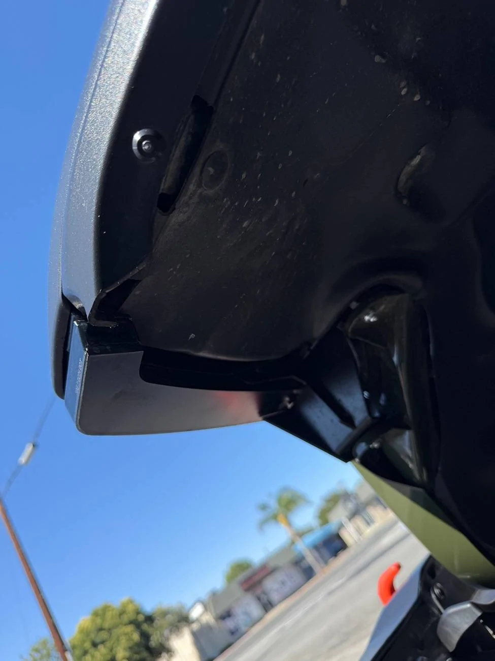

I went with AAL simply because the Rugged ridge kit, my first choice, was on back order for to long and I eventually just canceled it and ordered from AAL. Took 3 weeks but they shipped asap and honestly really like them. I reused the stock fender liner and after going on a weekend trip and taking the freeways to work I haven’t had an issue with the liner popping out of place. I used a heat gun to shape them a bit and left enough material on the edge to tuck it under the fender light.

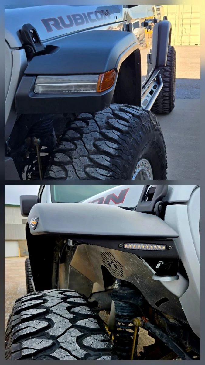

When I went up to 38's, the tire, when slightly turned, would catch the front lip at full stuff. I had to add a bumpstop spacer to keep it from contacting. When I can find some shorty metal fenders I like, I'll get some, but for now I just went with the MetalCloak chop, so I can pull that bumpstop spacer back out.
