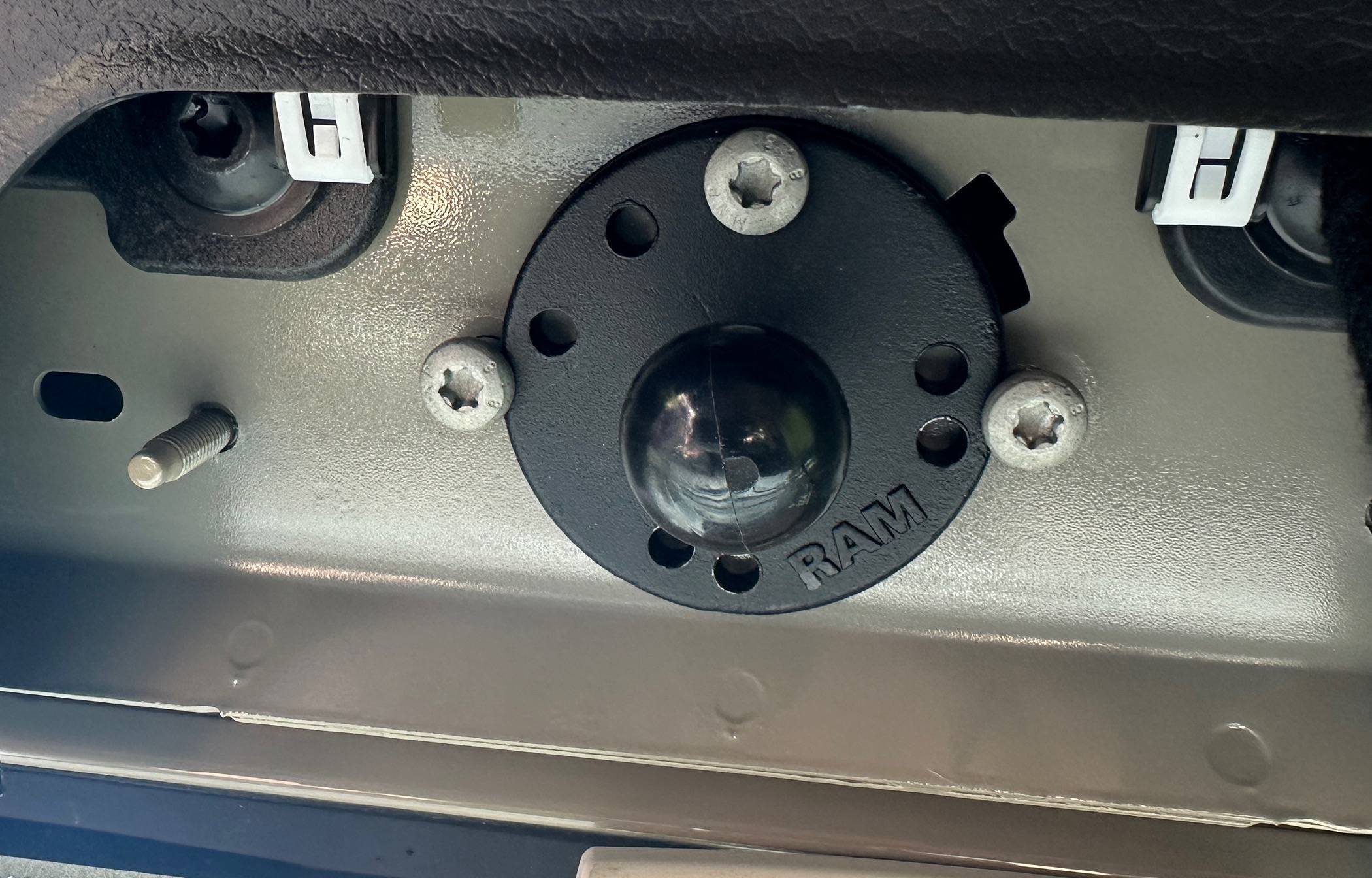

I uninstalled the oem mirror and mounted the RAM ball in its place utilizing the T30 screws that held the oem mirror mount in place.

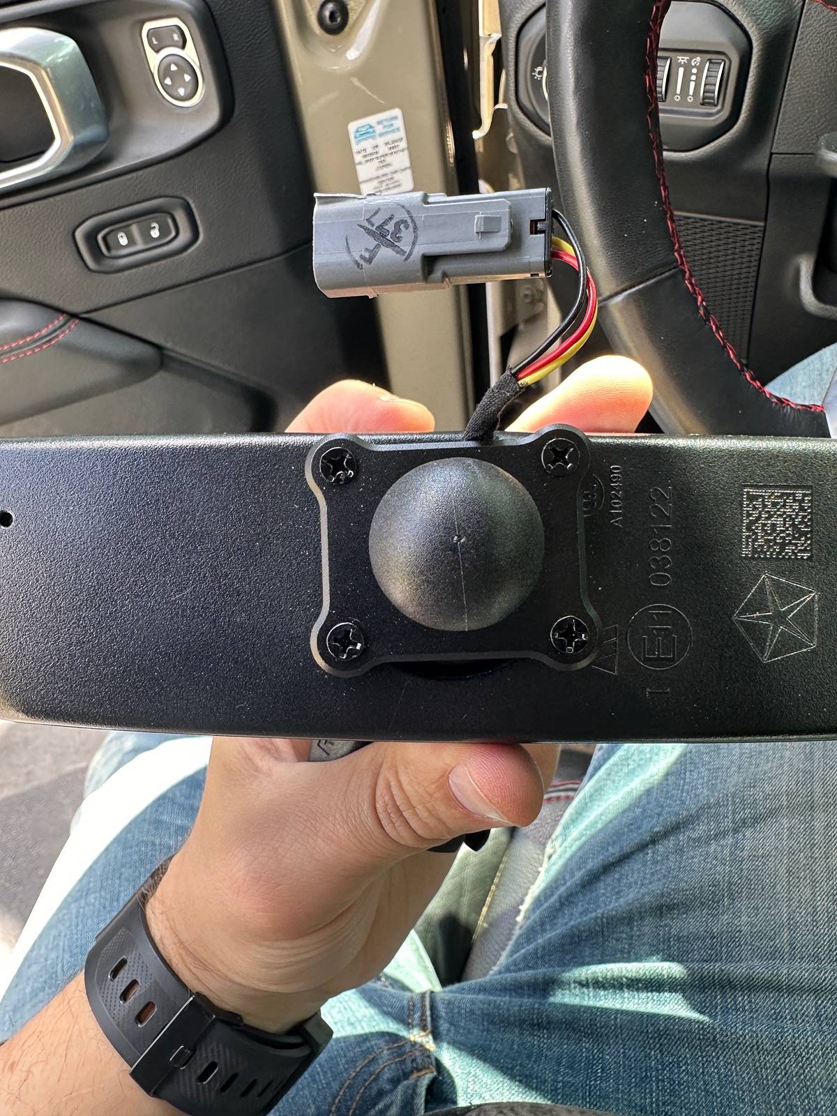

I then mounted the other ball to the back of the mirror:

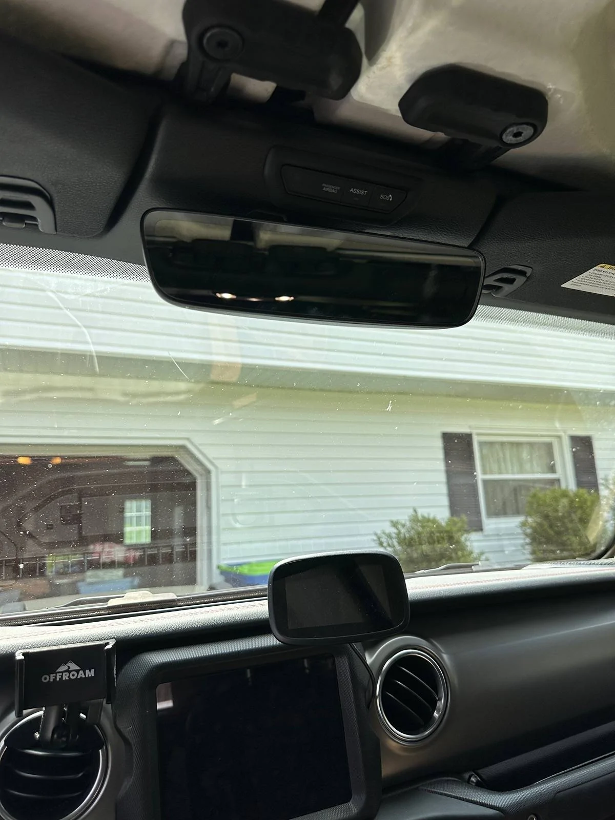

And connected them with the screw piece and it looks like this:
I am going to clean it up a bit but it’s so much better than it was. Hope this helps!
