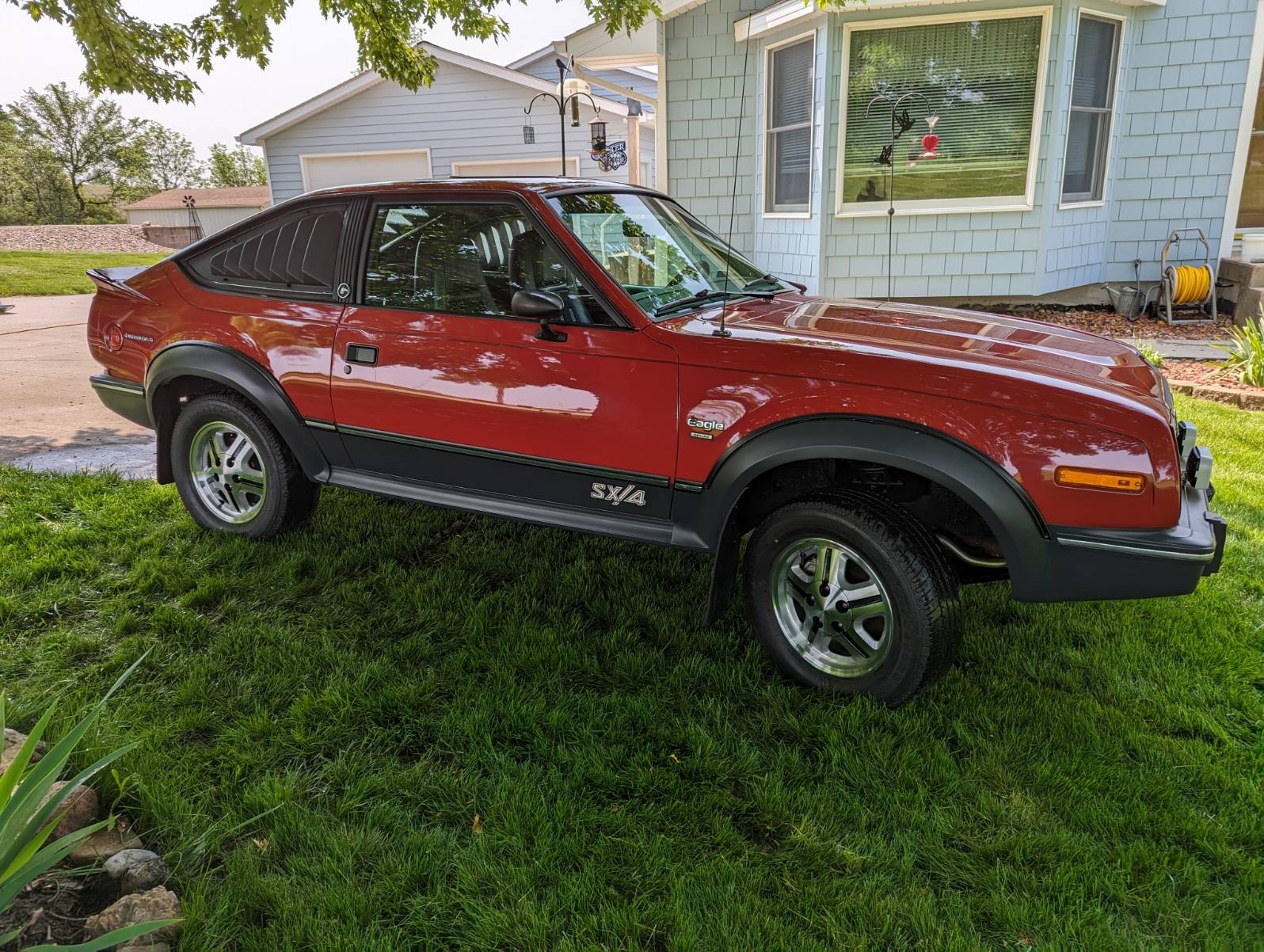

All cleaned up, show ready. Following my neighbor to a nearby car show. He's not a slow driver but I found myself falling behind - then realizing that my foot on the gas pedal wasn't doing anything. push in clutch, tach drops to ZERO.
Going up hill at the time but was able to coax it close enough to a convenience store (yeah, out in the sticks) driveway that I could push it up the hill, across the highway over to the end of their driveway.

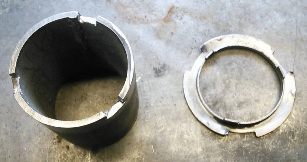

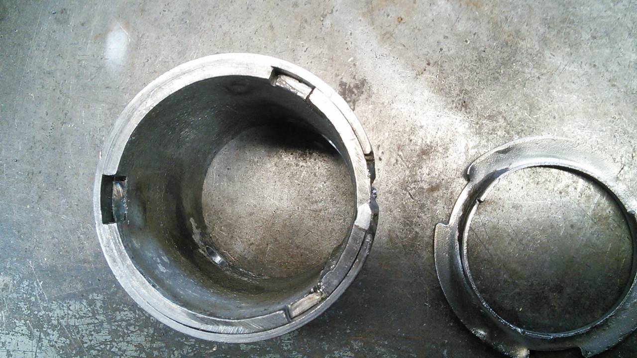

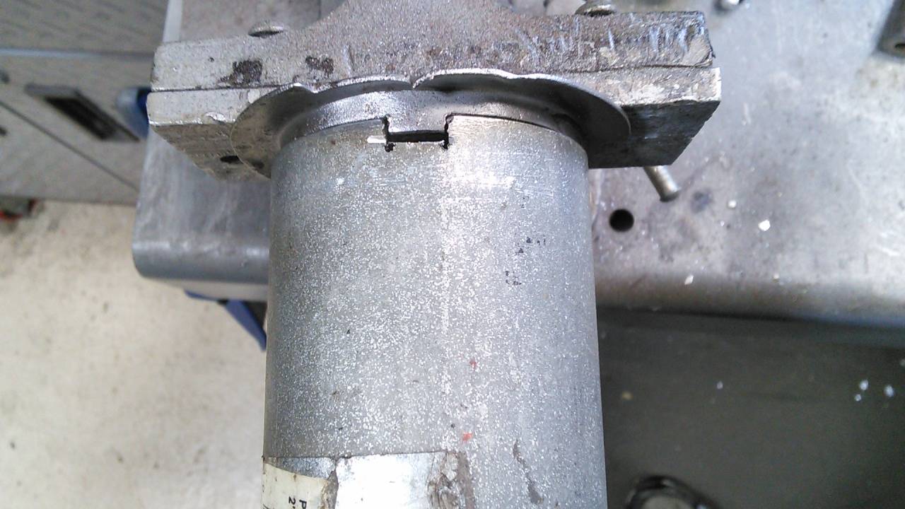

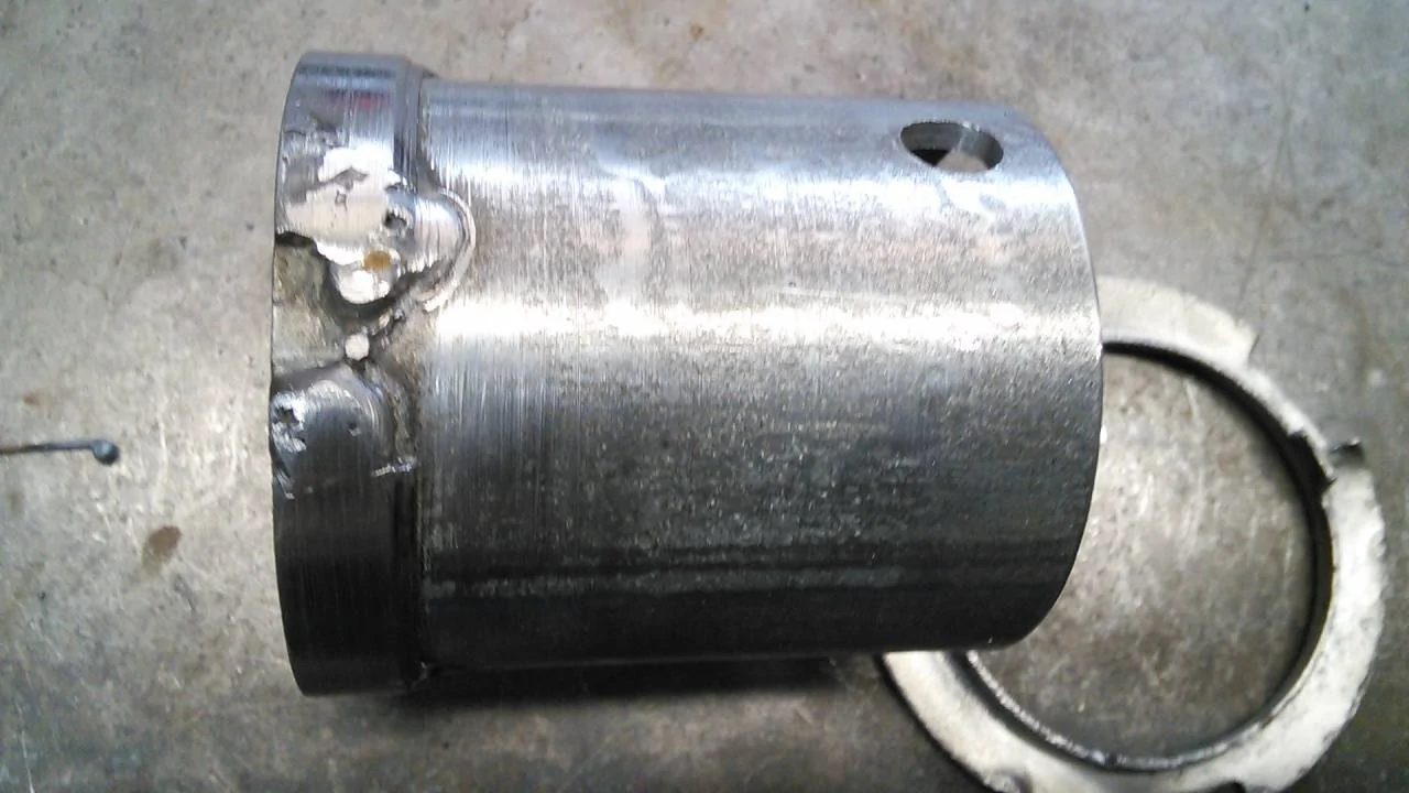

So, I made a tool - a "socket" to fit the sending unit lock ring so I could turn the ring and unlock the sending unit to remove it with the pump.
That made it simple - an hour making the tool, 10 seconds to remove the lock ring, another 3 or 4 minutes to take the sending unit and pump out and bingo - the electric pump was no longer attached to the sending unit pipe.
I decided to order a new pump while I was doing the repairs because it's getting really hard to get them. I'll keep this one as a spare and install the new one. After all, the pump has been in there since 2011. And in 5 years or so, I may not be able to get a pump like this again.
I cut a piece of water pipe on the chop saw, and cleaned up the ends on the lathe.
I then used my Dremel and a cutting wheel to cut notches to fit the tabs on an old spare lock ring I had on the shelves.
Jeep Gladiator First "breakdown" of the rare bird..... IMG_20230524_151217
Jeep Gladiator First "breakdown" of the rare bird..... IMG_20230524_151304
Jeep Gladiator First "breakdown" of the rare bird..... IMG_20230524_164618
But I wanted a way to keep this "socket" aligned on the tabs, prevent it from slipping off.
So I used the lathe and using another piece of that pipe, made it thinner and cut a ring off. I slit the ring and expanded it on an exhaust pipe expander.
I slid it over the socket and welded it in place.
Jeep Gladiator First "breakdown" of the rare bird..... IMG_20230524_163238
Jeep Gladiator First "breakdown" of the rare bird..... IMG_20230524_163209
I then drilled a hole clear through near the other end so I could put a punch through it for leverage turning it.

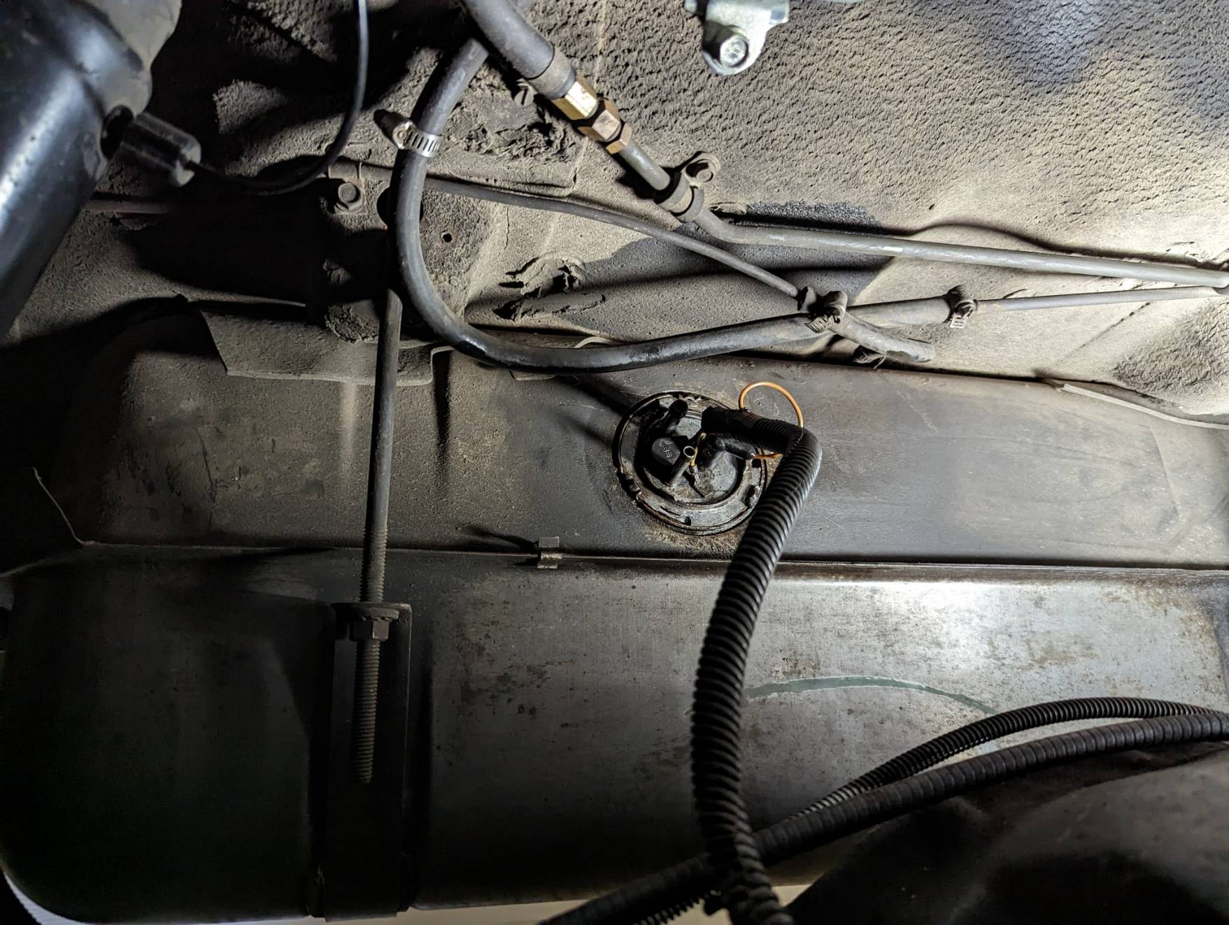

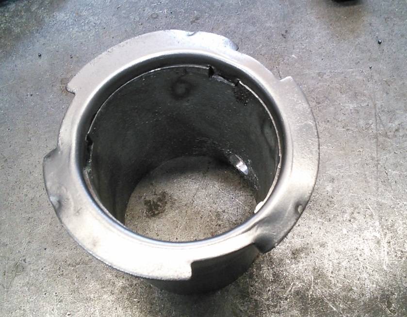

This is the lock ring I need to remove to get the sending unit out -
Jeep Gladiator First "breakdown" of the rare bird..... PXL_20230525_154252390

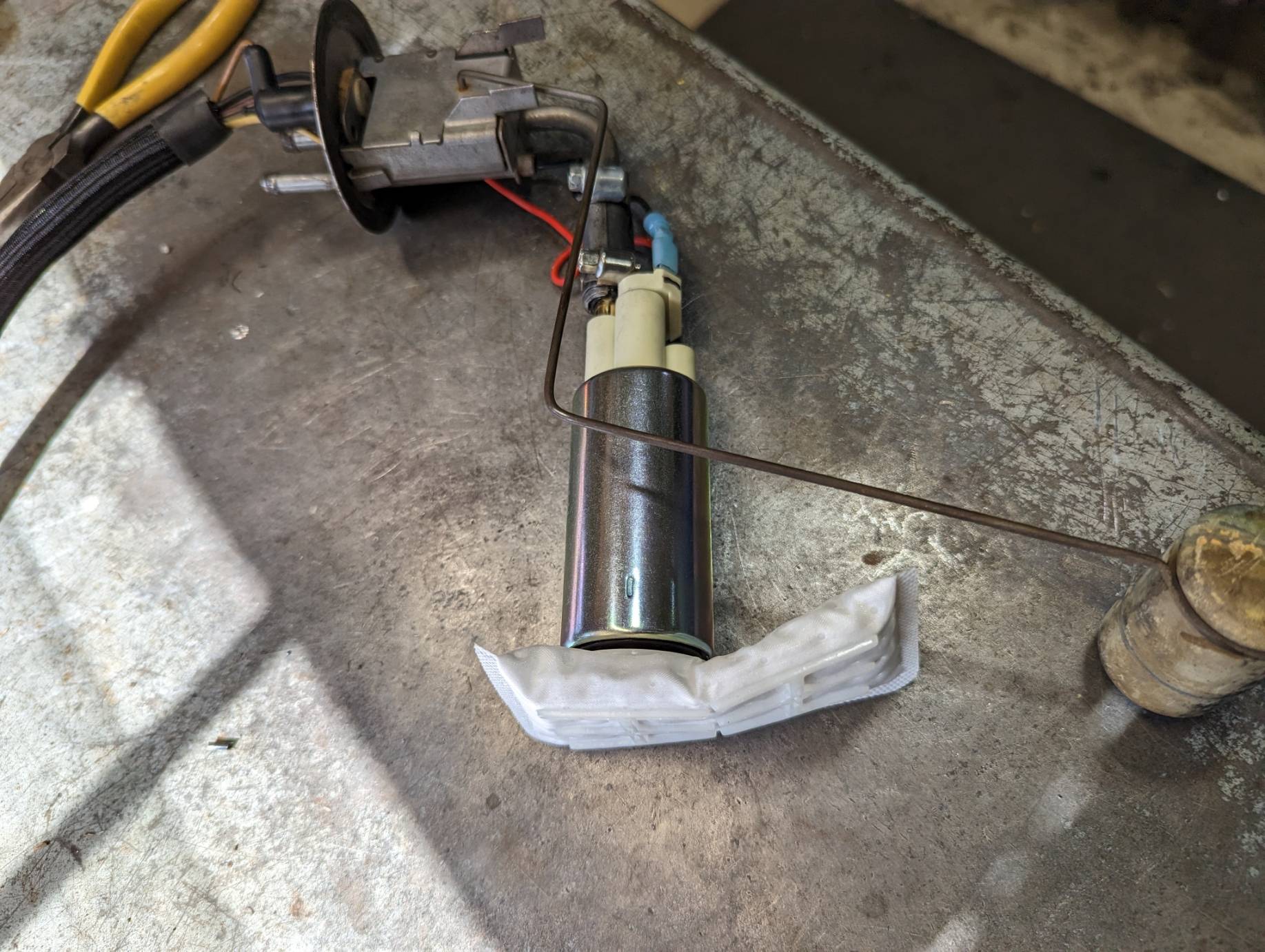

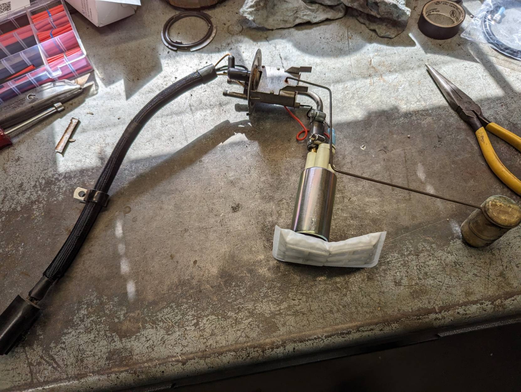

Lock ring removed, I worked the sending unit (and pump) out of the tank.
Jeep Gladiator First "breakdown" of the rare bird..... PXL_20230525_160803646

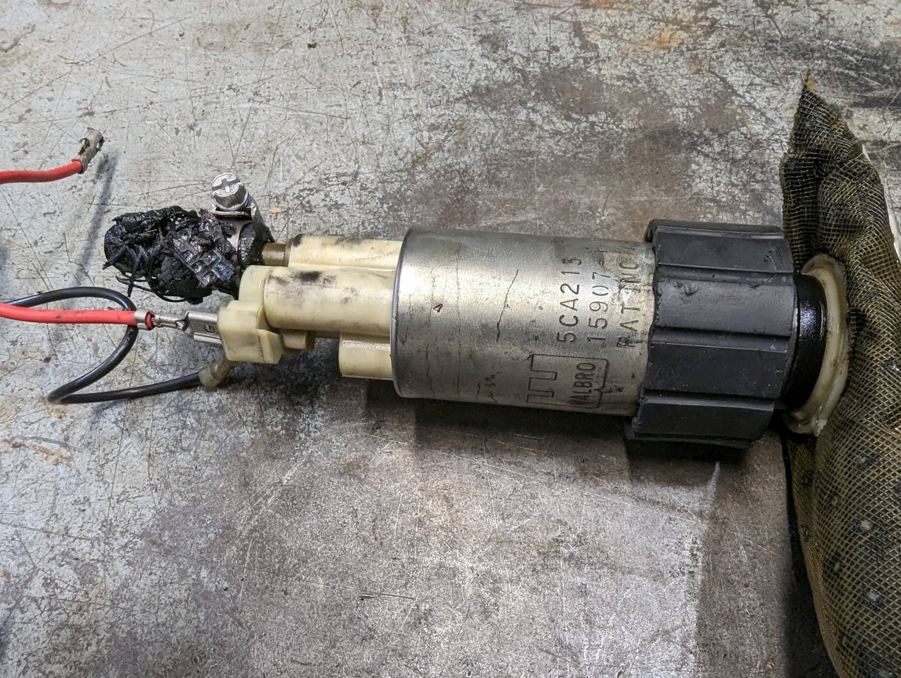

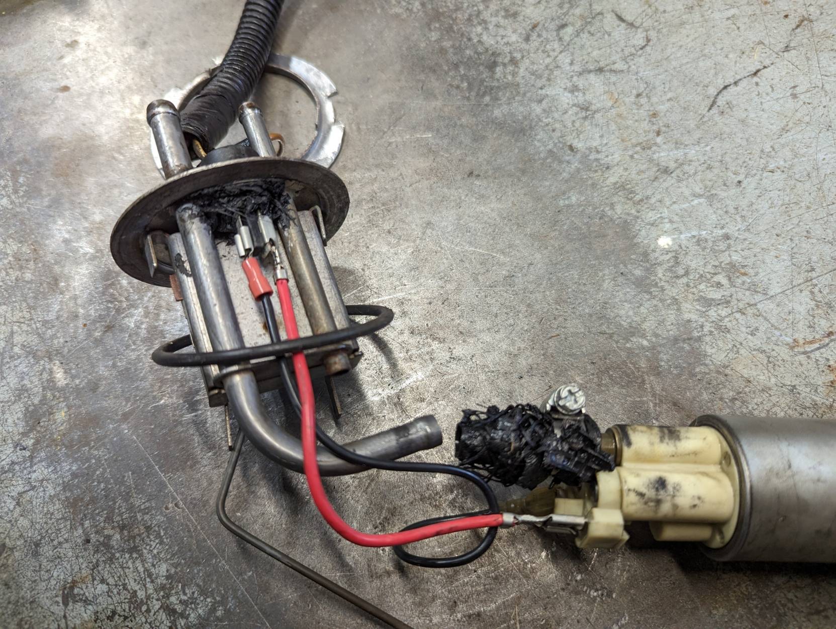

The hose holding the pump to the sending unit tube was MUSH, rotted. The pump had fallen off and was just blowing gas around in the tank.
Jeep Gladiator First "breakdown" of the rare bird..... PXL_20230525_161652264
Jeep Gladiator First "breakdown" of the rare bird..... PXL_20230525_161755290
Come on, Jeep people - you know what this pump was originally for, right? Clue - decades ago, it fueled a 4.0 and gee, today it's powering a 4.0 in the car pictured below..

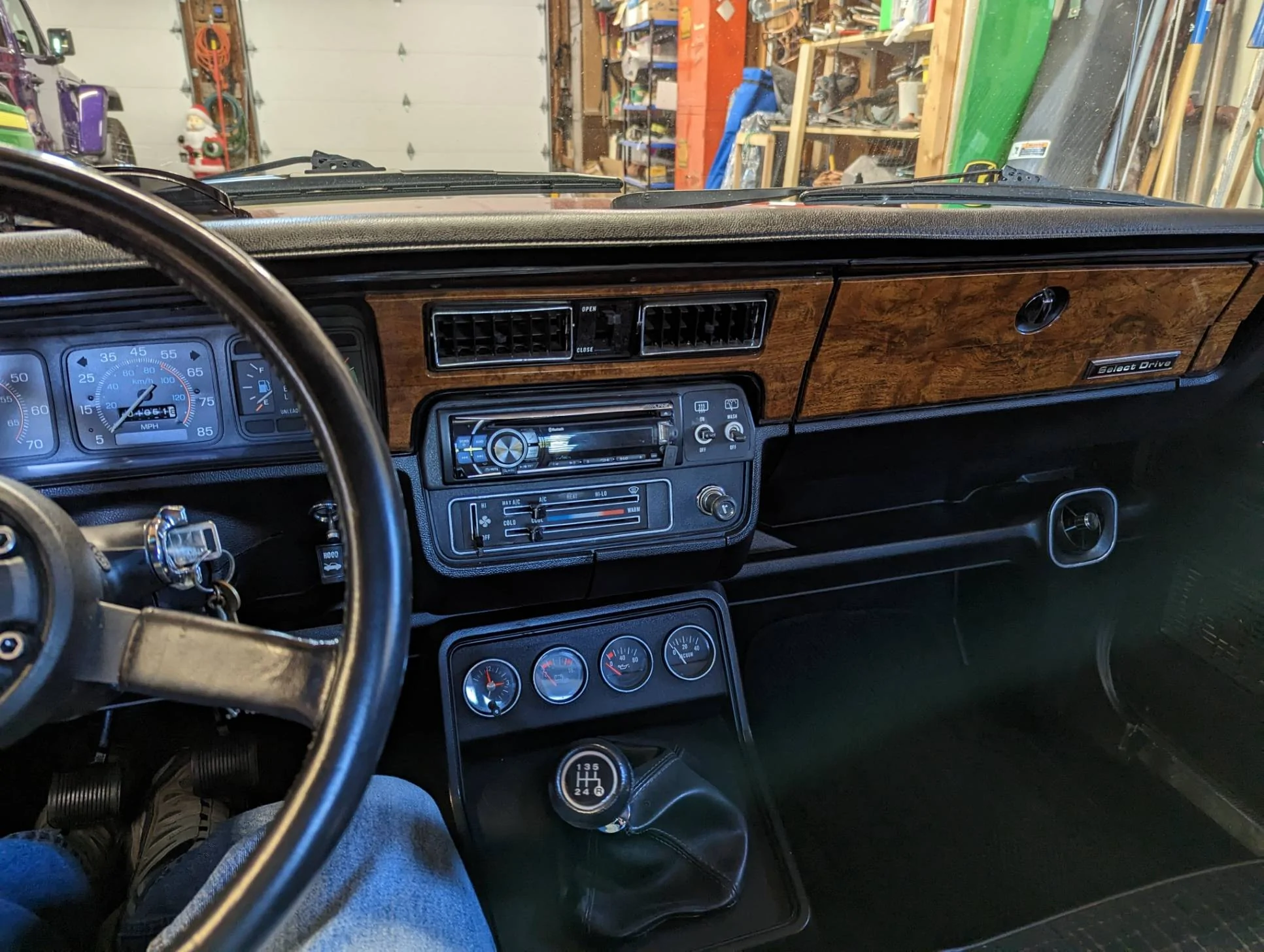

That looks awesome! How bout some interior photos?
40,500
54,020

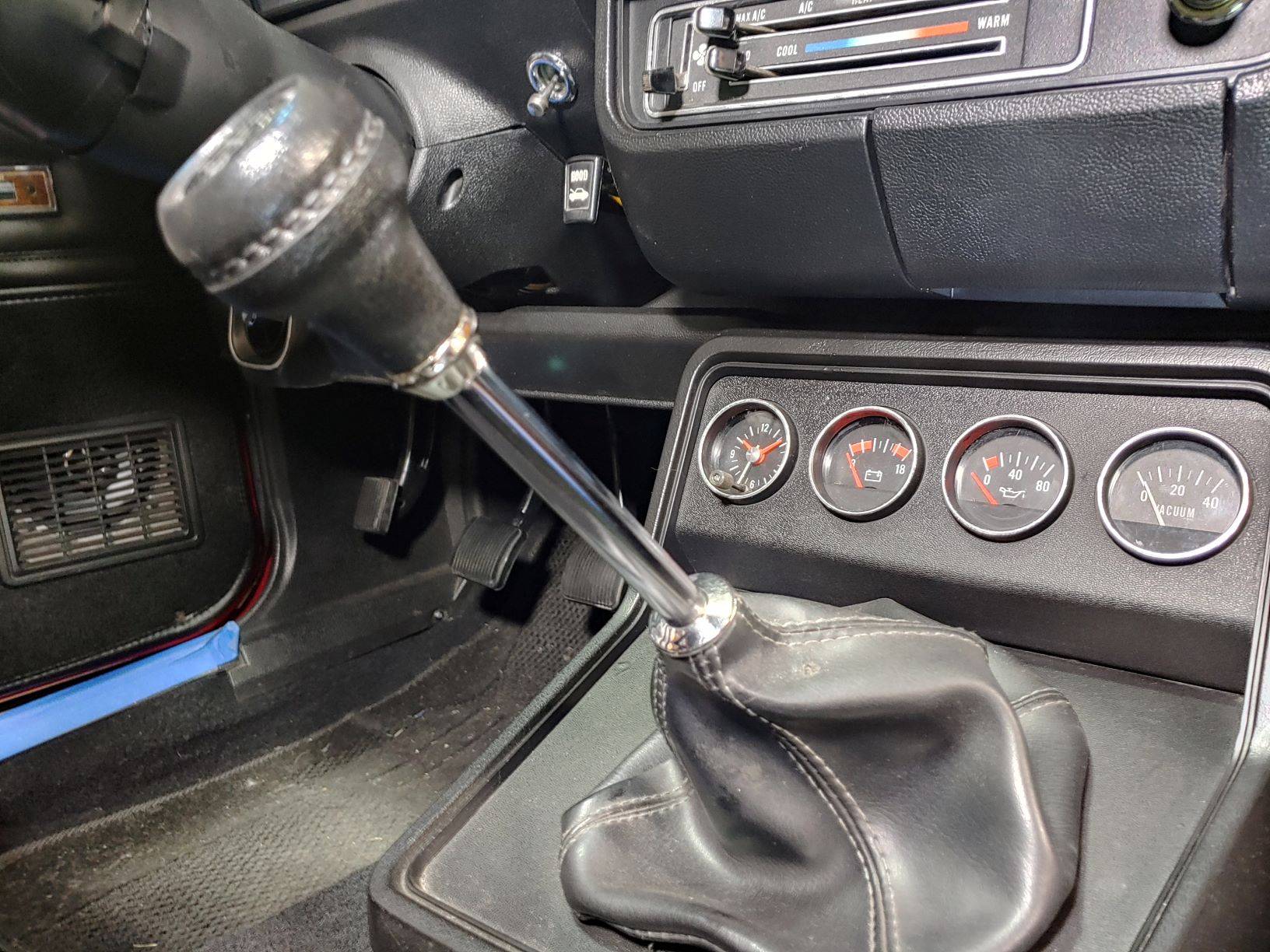

All of the cluster gauges are NOS (new old stock), I restored all of the console rally gauges.
Steering wheel was in original AMC packaging when I traded for it a few years ago.
Jeep Gladiator First "breakdown" of the rare bird..... gauges-2
Blue tape on sill plate is to prevent scratches as I get in and out. Those knurled aluminum sill plates can't be bought any more. I got a pair of some of the last ones a few years ago.

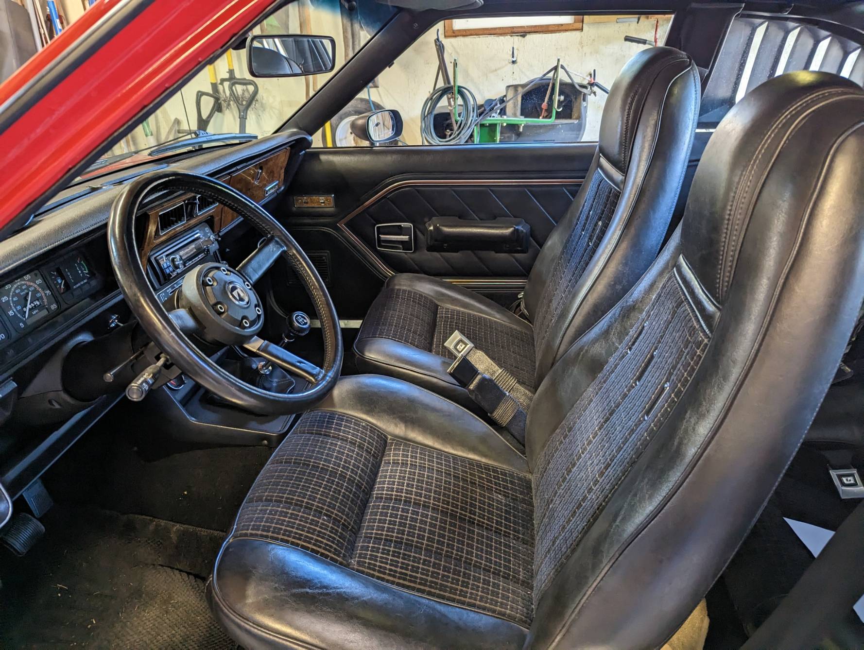

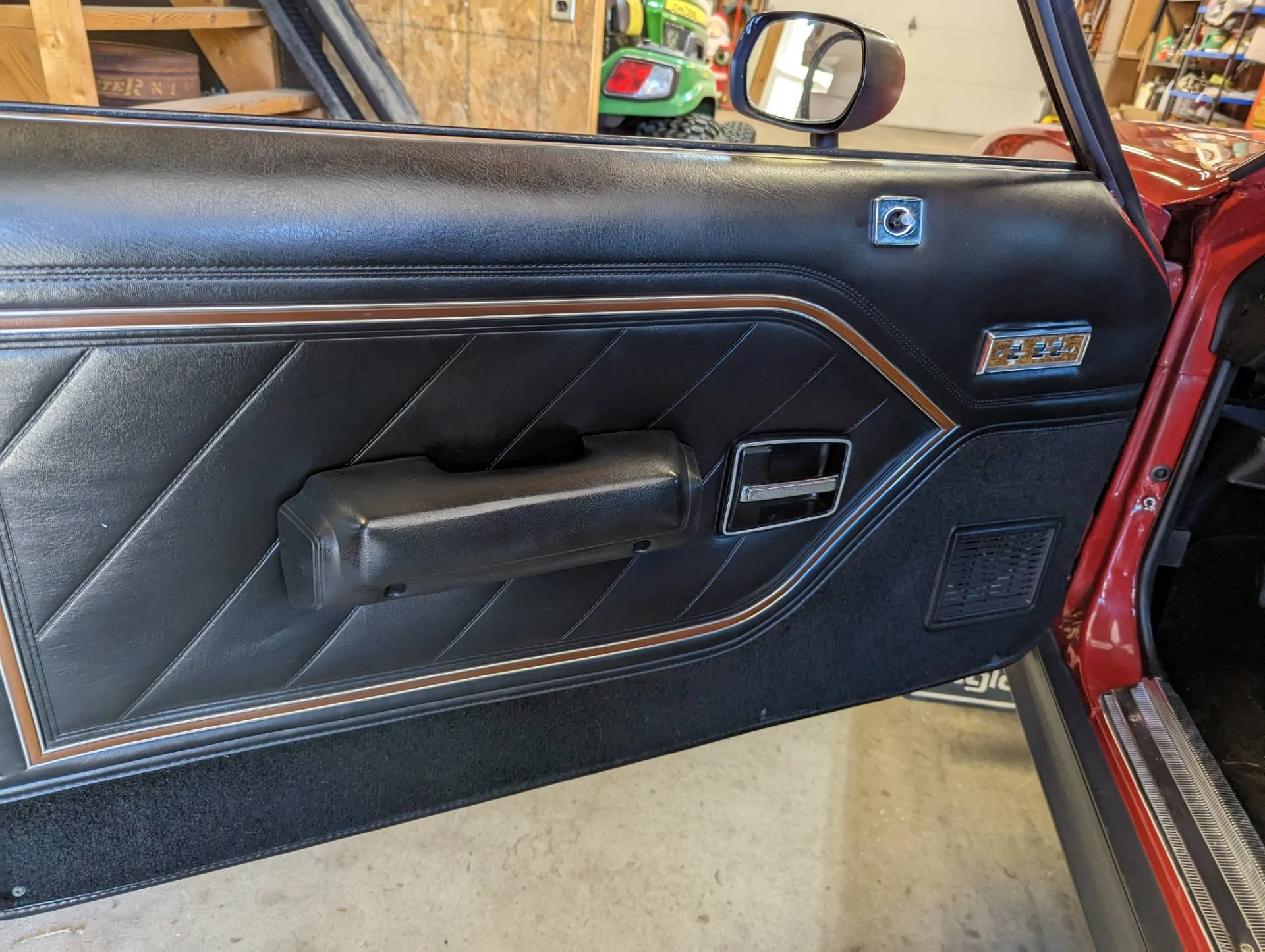

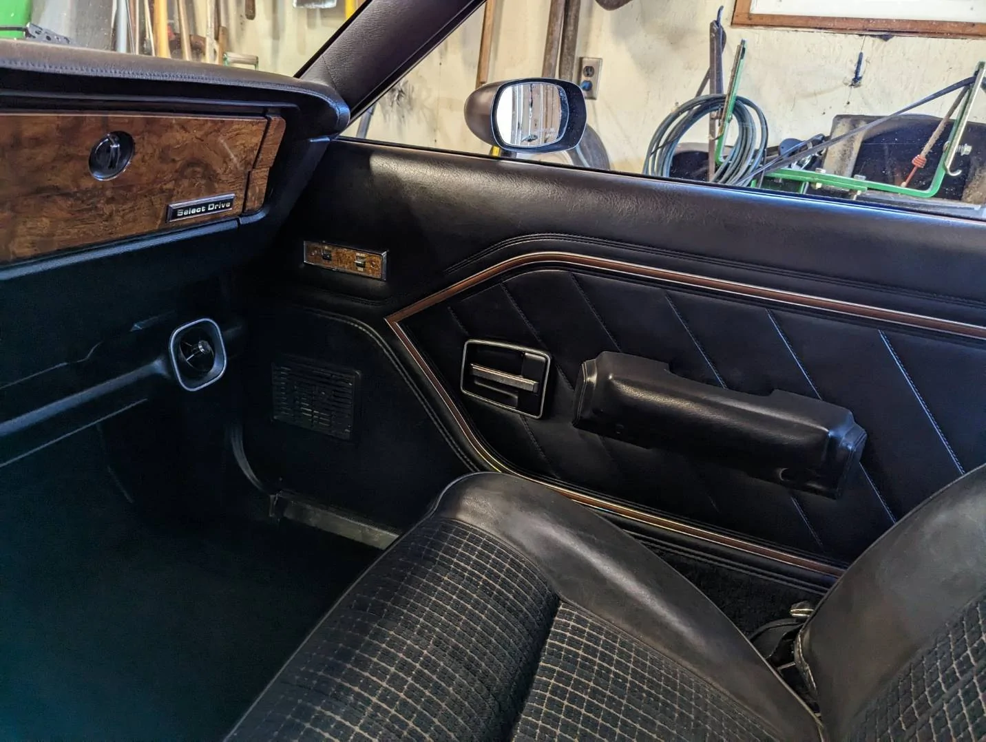

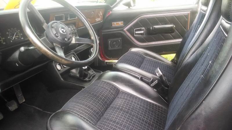

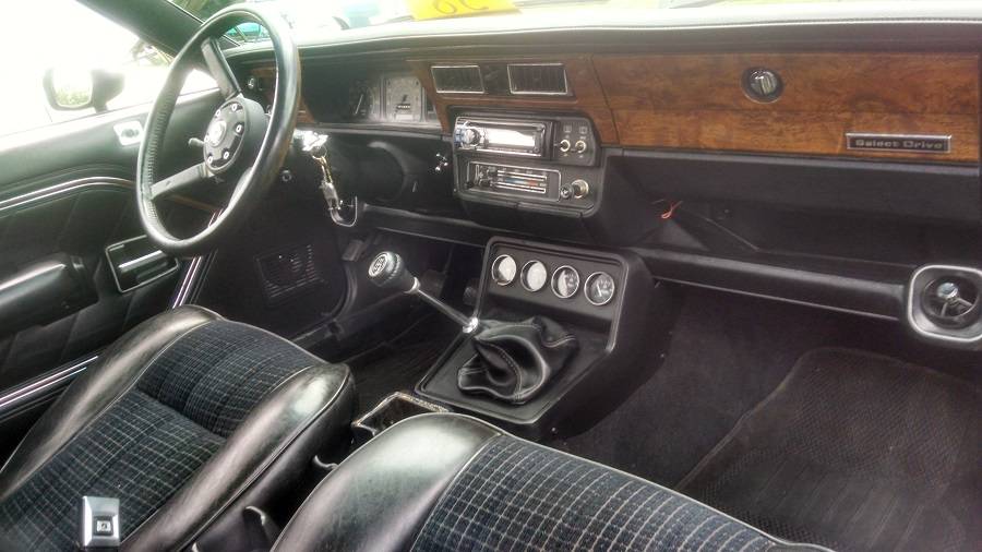

And some new pics of the interior since I didn't have anything recent. And I can't figure out how the heck the driver side sill plate got a DENT in it! Dang!!
Power windows and locks I installed myself from a collection of Eagle and Jeep parts.

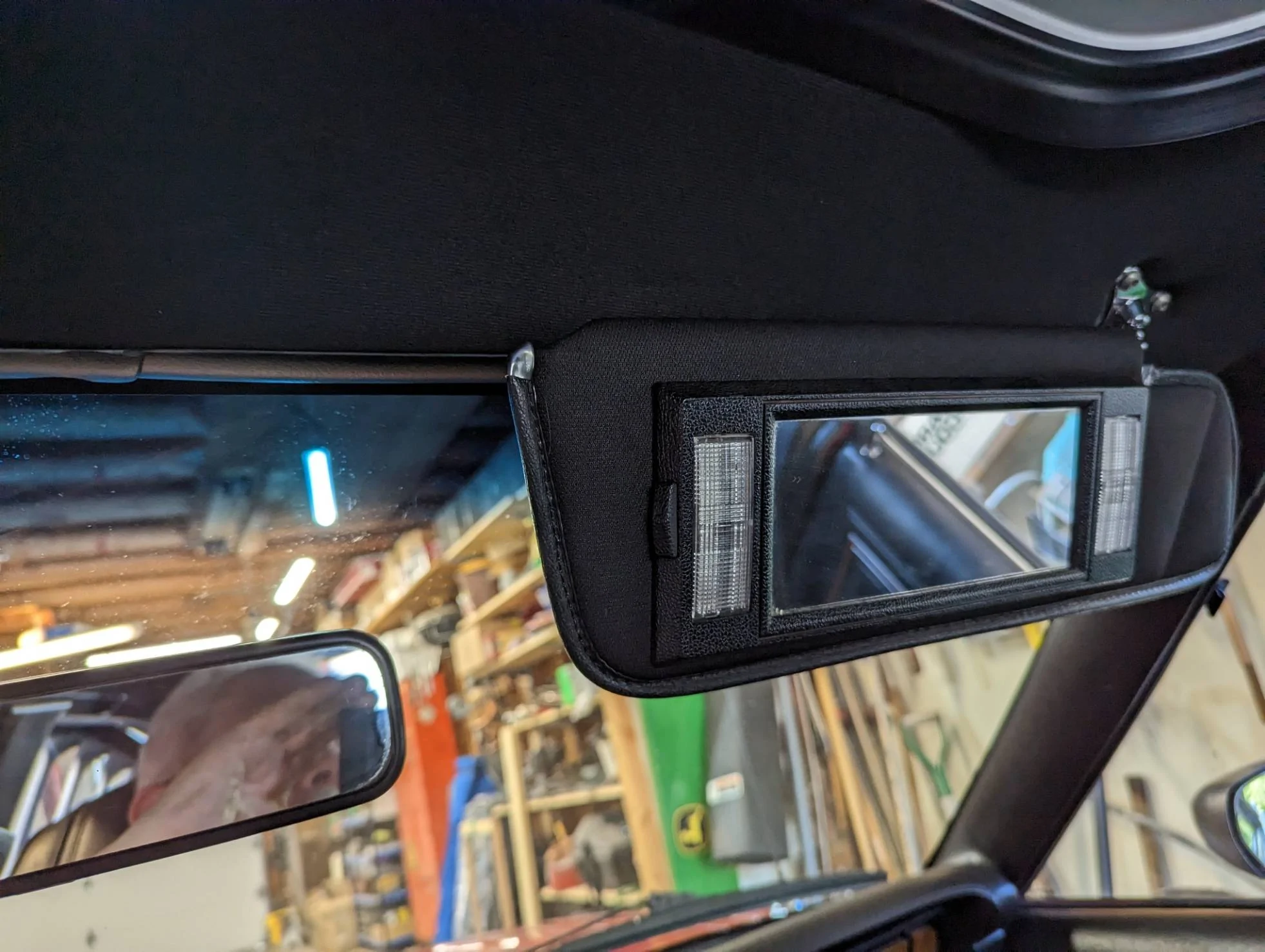

I had the visors professionally reupholstered 4 or 5 years ago.
