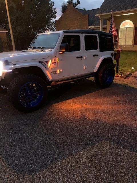

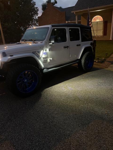

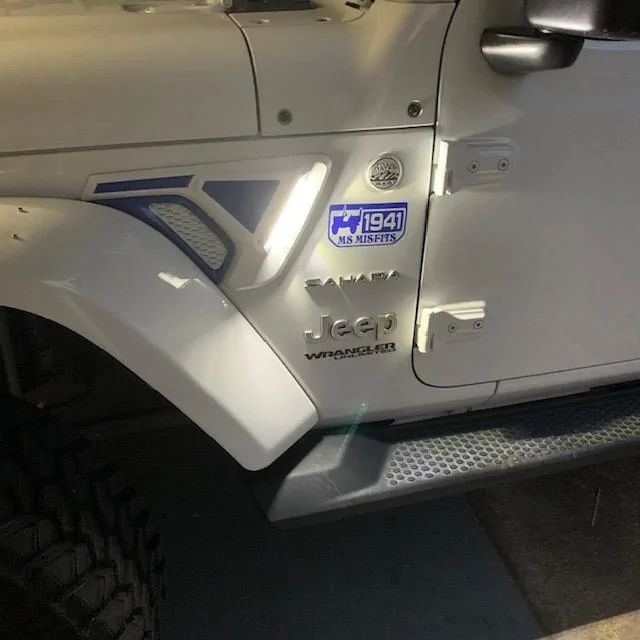

Here is a cool mod from a customer, color-matched to the Jeep's theme:
Jeep Gladiator First Look: Sidetrack LED System for JL and Gladiator! 15862975_3477303088967400_479936852902924520_n-jpg
Jeep Gladiator First Look: Sidetrack LED System for JL and Gladiator! 5824859_3477302998967409_4165127521362513421_n-
Jeep Gladiator First Look: Sidetrack LED System for JL and Gladiator! 5843751_3477303005634075_2042612217560239631_n-
