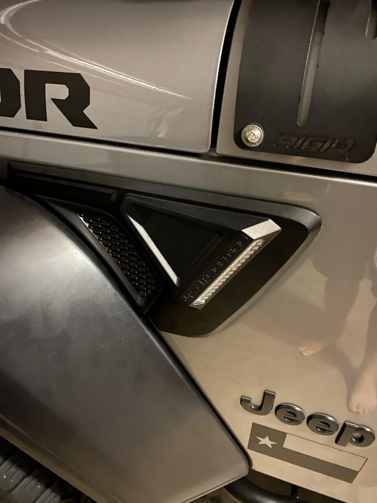

My wires were plenty long enough. I could reach the driver's fender harness from the top under the hood. The passenger side I was able to go up from underneath. I just folded back the fender liner, and didn't remove it completely. The white wires I combined together and extended them, ran them into the cab on the driver's side, and soldered them to the tan/white bed light wire in the passenger kick panel.
Just to confirm...you did not have to remove the fender liner at all from driver's side?
Nope, just removed the 2 retainers at the bottom rear of the liner and 1 10mm bolt, and pulled it up out of the way.

Update, I struggled much less with the passenger side. I just used something pointy and firm to poke through the thick gasket and feed the wire through. Unfortunately, the drivers side just wasn’t long enough. I was able to get both sides mounted and turn signals working. The courtesy lights aren’t working yet though. Its doable, just not as straight forward as the instruction video may lead you to believe.
I would’ve happily paid $100 for someone to install.

Just finished the install. They really should throw in enough fender clips to put the liner back in. The clips are ruined when you punch them out. I had to go to the parts store and get something until I can order new ones that go in the Jeep. Note to future buyers, get enough body rivets to re-install At this price point a $3 pack of hardware and printed instructions are not to much to ask IMO

If you guys are talking about the little rivets that go around the edge of the fender flare, you do NOT have to take those out. ONLY the little christmas tree clips along the underside of the fender flare. There are [I think] three along the top, two in the front, and two in the very back bottom, followed by the three small bolts. The liner will then come right out. I made the same mistake and realized after pulling one of the rivets!
