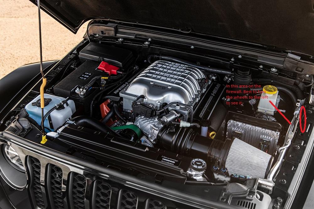

1. For a Gladiator Sport S, the drivers side firewall does not match the install video. There is a small rubber grommet/plug about the size of a quarter below and to the far right of the master cylinder. It just pulls right out. The tricky part is the fishing expedition. Just puncture the center of the grommet/plug with a small hole and work the white wire through it. Once you've gotten the wire inside the cab, it just plugs right back in. The picture is not my jeep, just a representative sample to point out location of the grommet.
Jeep Gladiator First Look: Sidetrack LED System for JL and Gladiator! Jeep Gladiator Engine Compartment
2. Fishing through the passenger side is a MF. Coat hangers do not work (to flimsy). Advice, get a real fish rod like the one in the video and drill a small hole in the end just large enough for the white wire - after a few attempt without this method, I was finally successful.

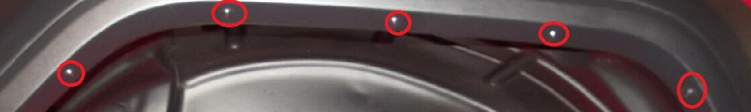

3. The plastic rivets on the outermost part of the fender do not remove like the video. You have to push the center in with something (I used a cold soldering iron) then they can be removed and basically rendering them useless.
Jeep Gladiator First Look: Sidetrack LED System for JL and Gladiator! Gladiator fender
You'll need something like this:
https://www.quadratec.com/p/performance-tool/41pc-rivet-tool-kit (I have no affiliation with this supplier, this just happens to be where I found what I need)
At the end of the day, it took me about 3 hours to complete the installation on both sides. Also, be sure to test them before you put everything back together as the tap is hard to see (for me) and I thought the wires were plugged in but the actual metal part was outside of the wire splice tap.

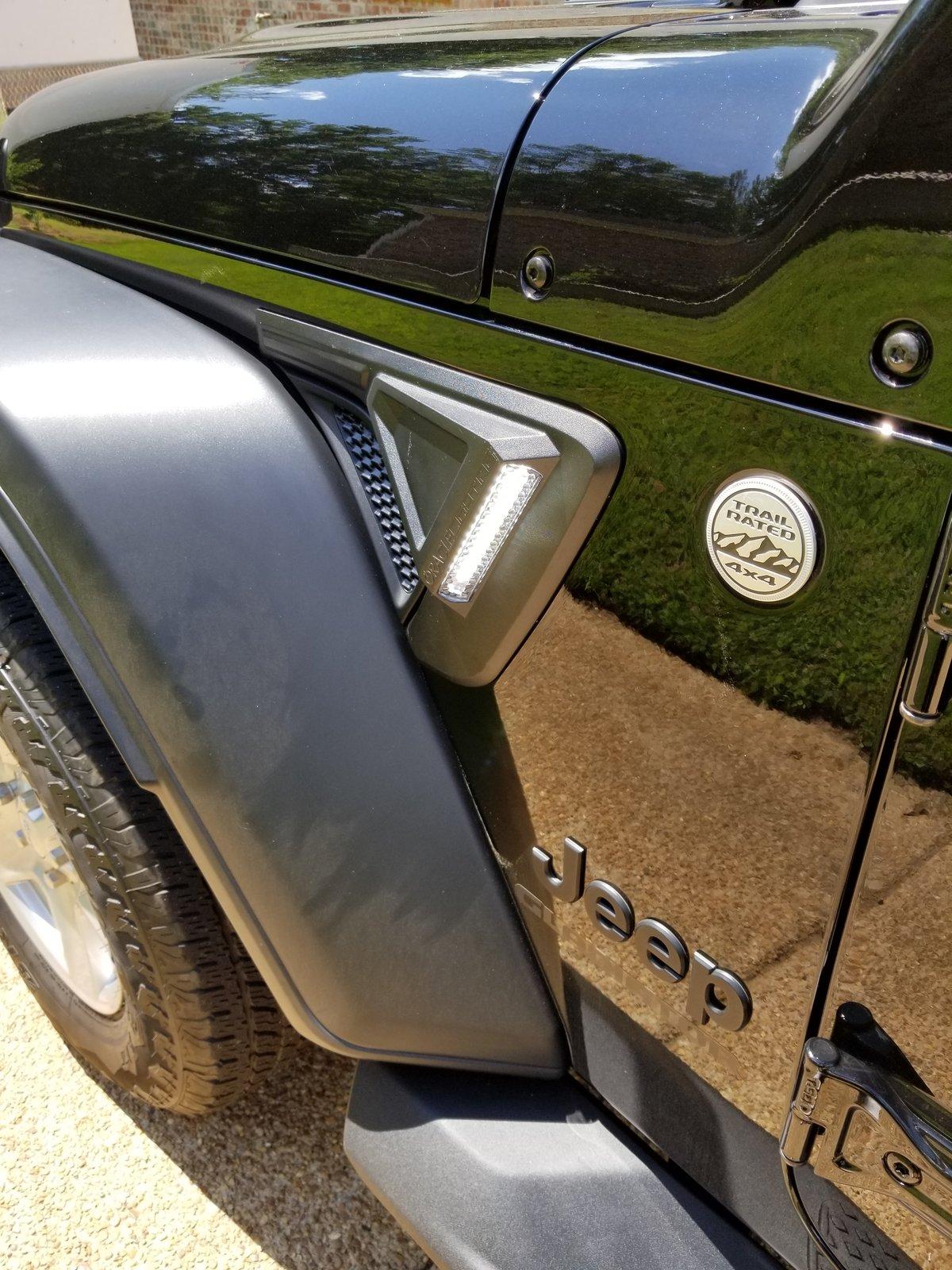

Definitely adds a cool touch to the JT. Love the look and added extra visibility of these lights. Thank you!
Jeep Gladiator First Look: Sidetrack LED System for JL and Gladiator! KIMG3085.JPG
So perfect! Glad you are enjoying :rock:
