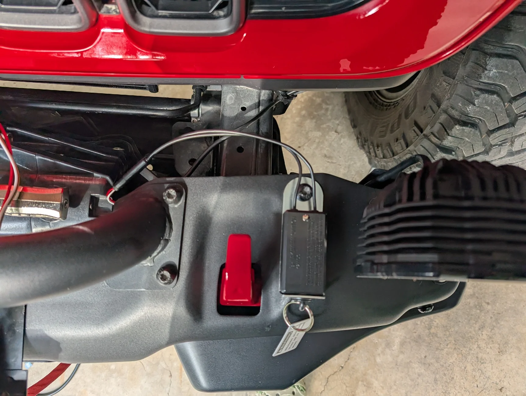

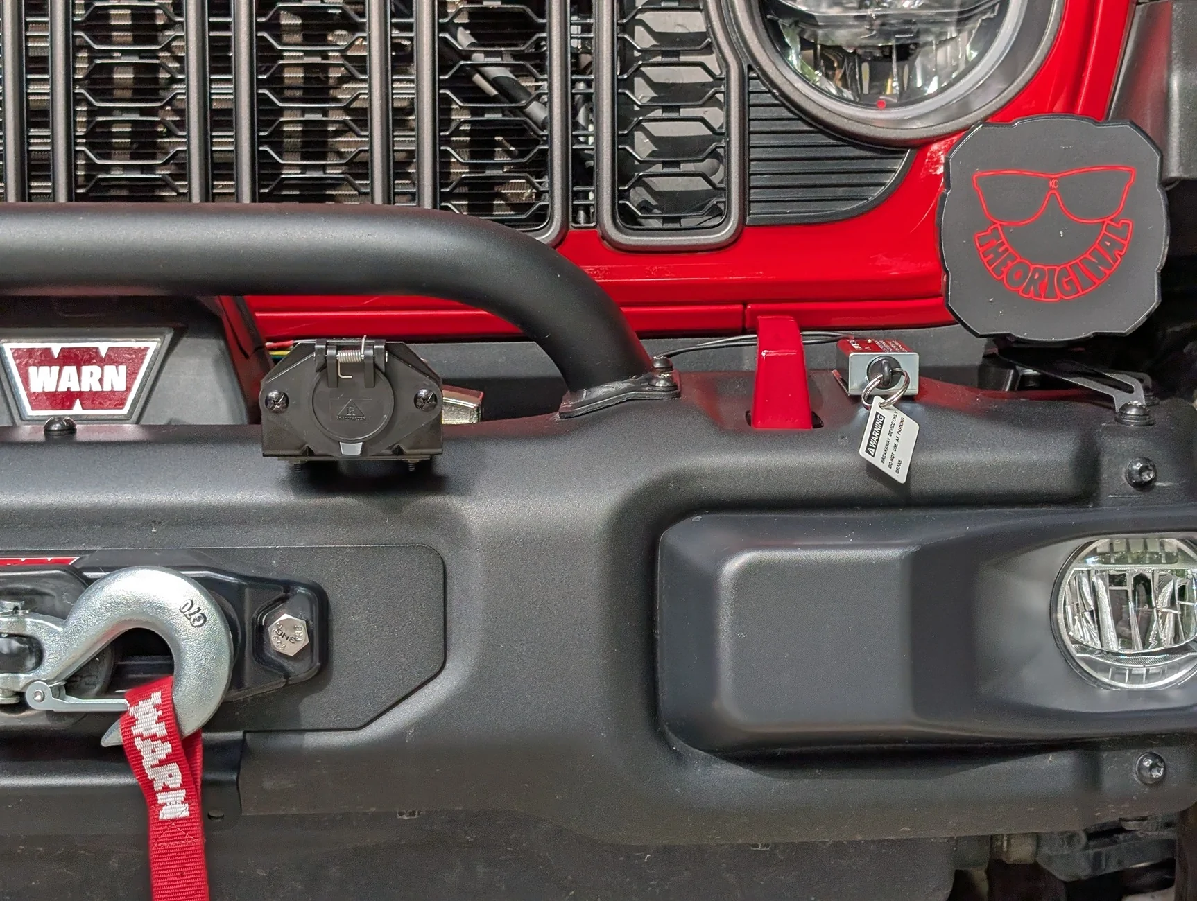

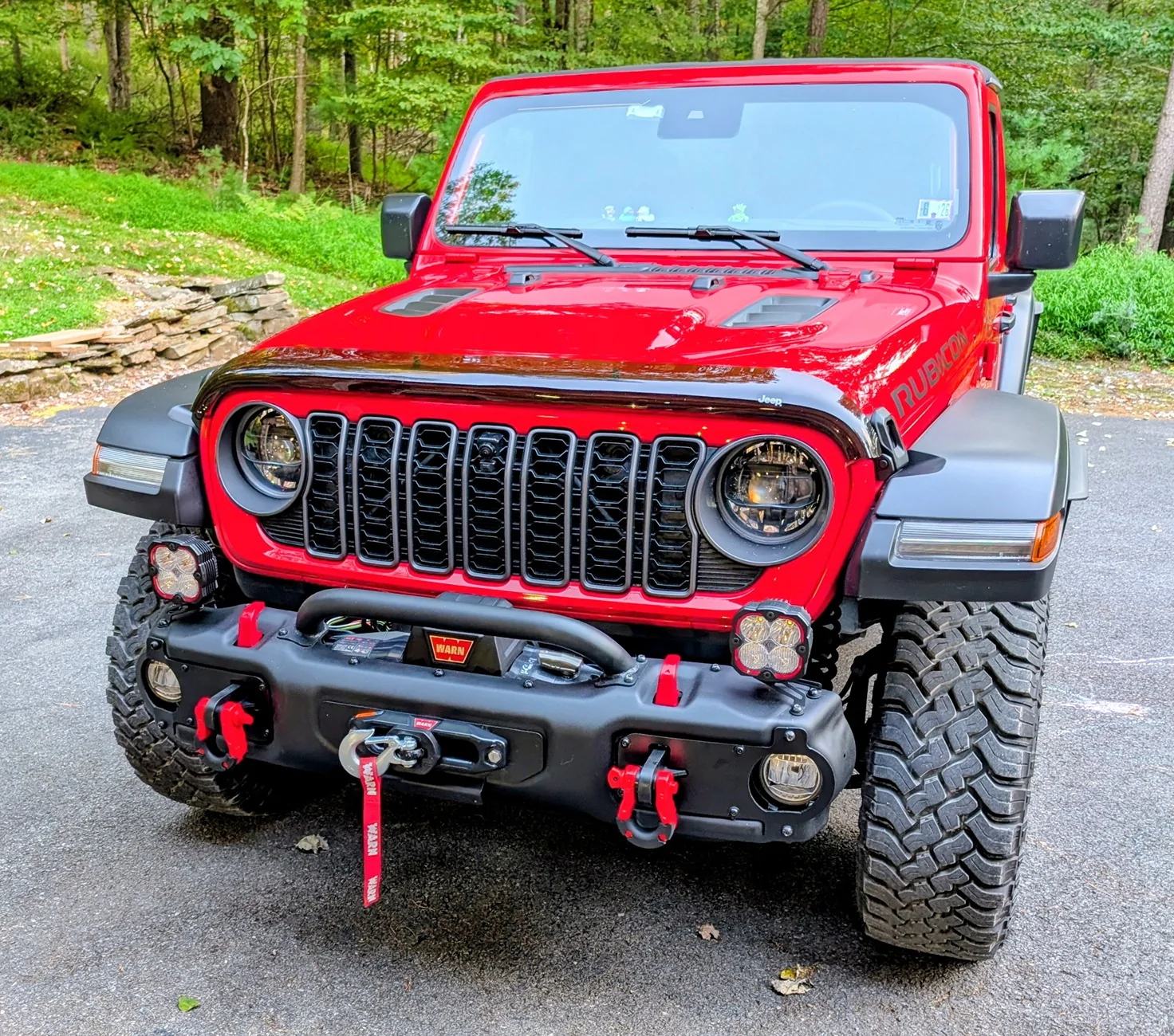

This post outlines a solution for flat towing a Jeep Gladiator while retaining the factory Rubicon steel bumper and addressing common electrical issues encountered with LED taillights.
Towing and Safety Chain Connections
To maintain the factory Rubicon steel bumper, which I chose to keep due to prior investments in winch plates and light mounts, I selected a this towing setup.
Tow Bar Connection: I will be using the HK Offroad D-ring shackle tabs, which are approved for flat towing. It is important to note that additional components, such as specific ends, must be purchased to ensure compatibility with Roadmaster tow bars. The full list of required part numbers is provided below.
Safety Chains: A common issue with using D-ring shackle tabs for the primary tow bar connection is the lack of a suitable attachment point for safety chains. To address this, I acquired the Flat Tow Brackets for Quest Series Front Bumpers from Rockslide Engineering. Although these brackets are specifically designed for RSE's bumpers, they mount directly to the vehicle's frame horns using existing factory holes. This provides a secure and reliable point for connecting safety chains.

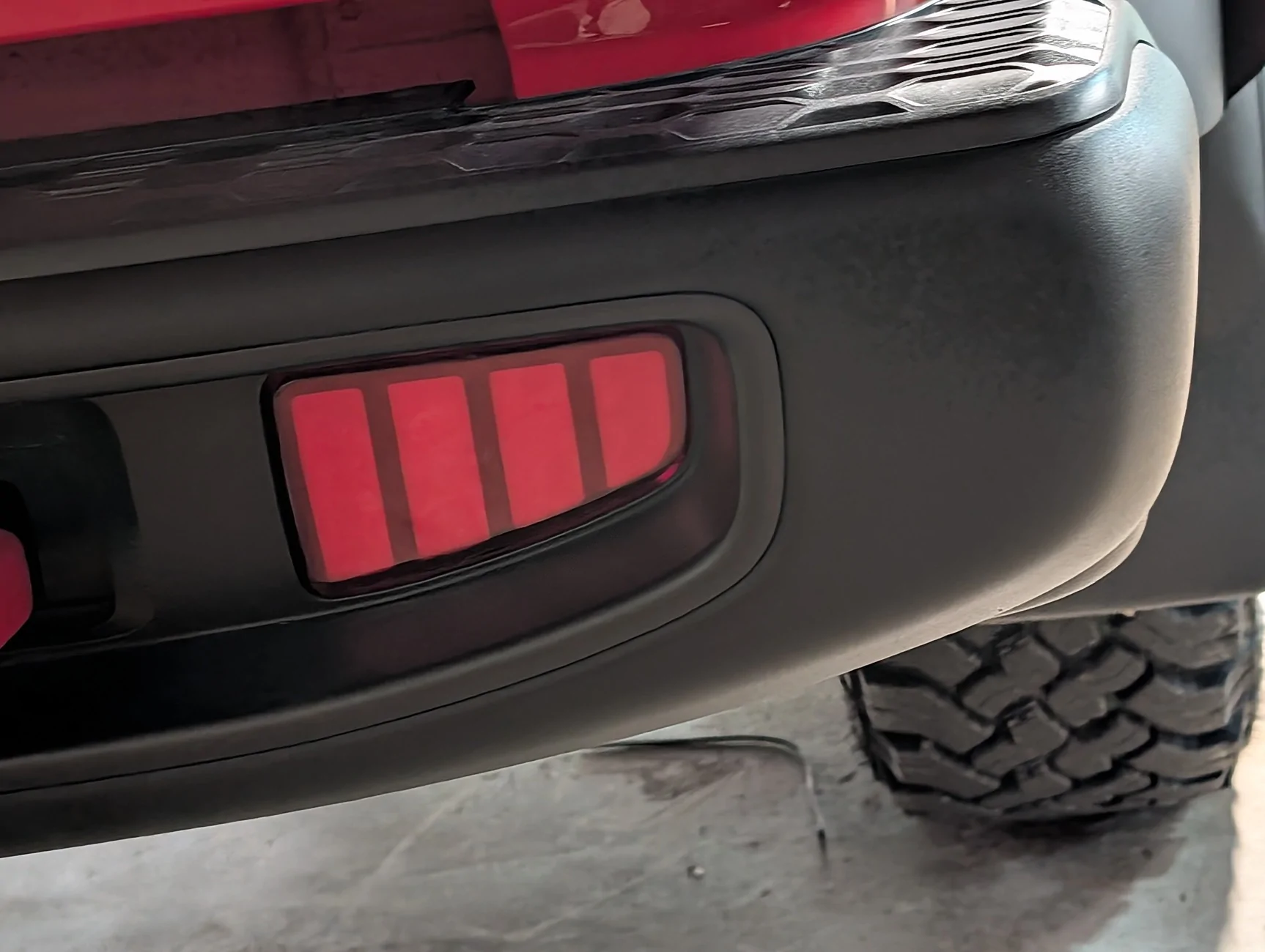

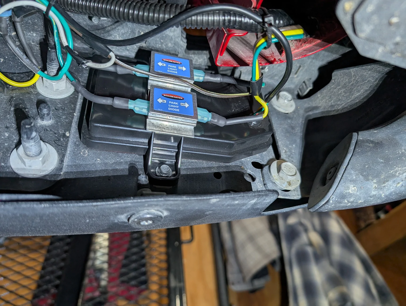

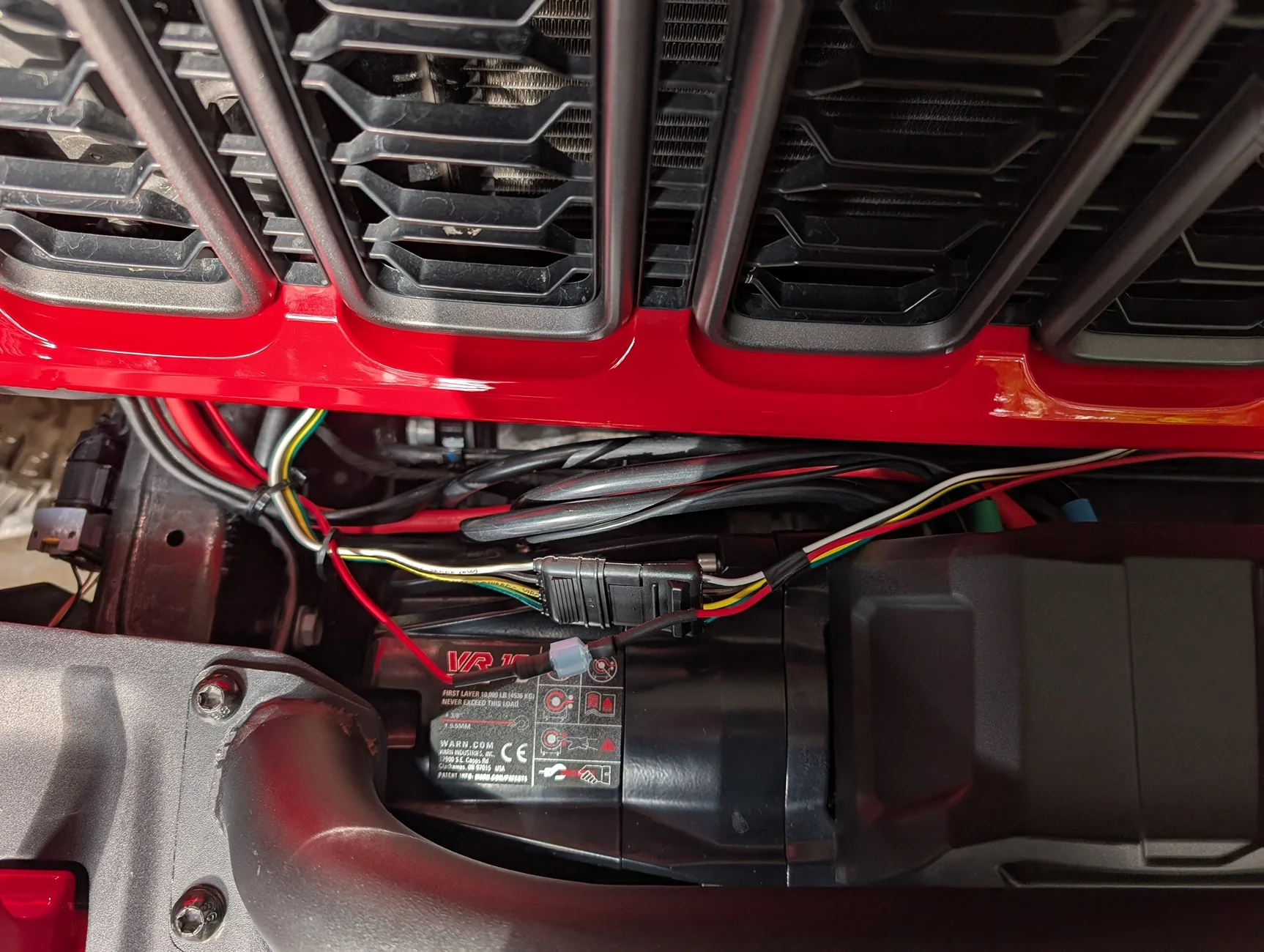

Addressing the LED Taillight Electrical Issue
Gladiator models equipped with factory LED taillights can present a unique challenge during flat towing, particularly when a supplemental braking system is in use.
The Problem: When the vehicle's brakes are applied simultaneously with a turn signal, the Jeep’s computer-controlled brake lights override the turn signal, causing the turn signal to not flash. This occurs because the supplemental braking system's signal to the LED lights "wakes up" the Jeep's computer, which then commands the brake lights to turn on, taking precedence over the turn signal. Many people may be unaware of this issue as it is difficult to detect during static light tests.
The Solution: To resolve this, I installed a separate set of aftermarket lights in the rear bumper, replacing the factory reflectors. These lights were wired to the existing Curt wiring harness I purchased for flat towing. Diodes were added to the circuit to prevent power from the Jeep's main lighting system from back-feeding into the Curt harness. These secondary lights are now dedicated exclusively to providing turn signals during flat towing, ensuring visibility and compliance with regulations without interfering with the Jeep’s primary lighting system. I chose to keep the Curt harness for the Jeep's brake lights and running lights as it performs these functions very well.
This setup provides a solution for flat towing a Jeep Gladiator with a factory Rubicon steel bumper. By combining aftermarket components for both the tow bar and the safety chains, along with a creative electrical solution for the LED taillights, I have created a reliable and safe flat-towing system. I have not yet installed the shackle tabs or mounts for safety chains; I am still waiting on the D-ring shackle tabs.

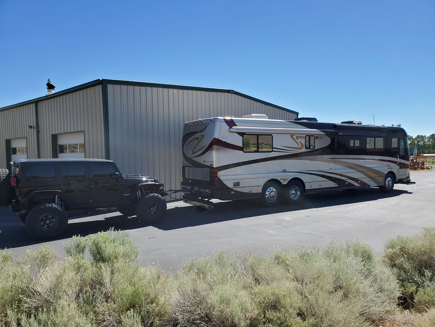

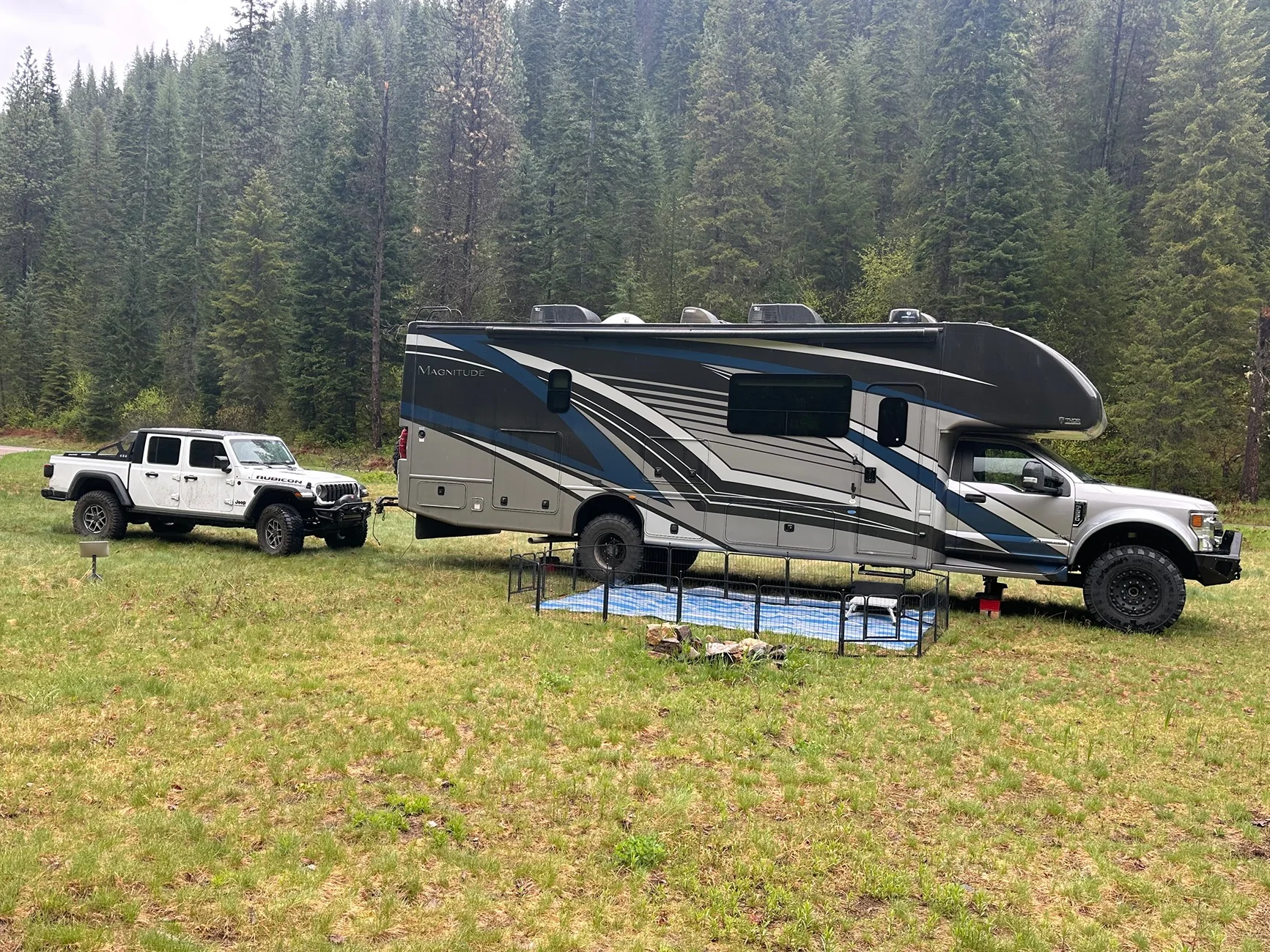

Nice write up, this will help folks thinking about towing a Jeep behind a motorhome.
I have towed my 4 door Jeep and now my Gladiator behind our Thor Magnitude that has been modified with a lift, 41” tires and all the goodies that go with it for several years with no issues.
Like you, I am also using the Roadmaster Nighthawk tow bar with D-ring connections at the end, and like it better than the Blue Ox we started with. Unlike you, I swapped to an aftermarket front bumper with D-ring mounts for the towbar attachment points, but is similar to your setup.

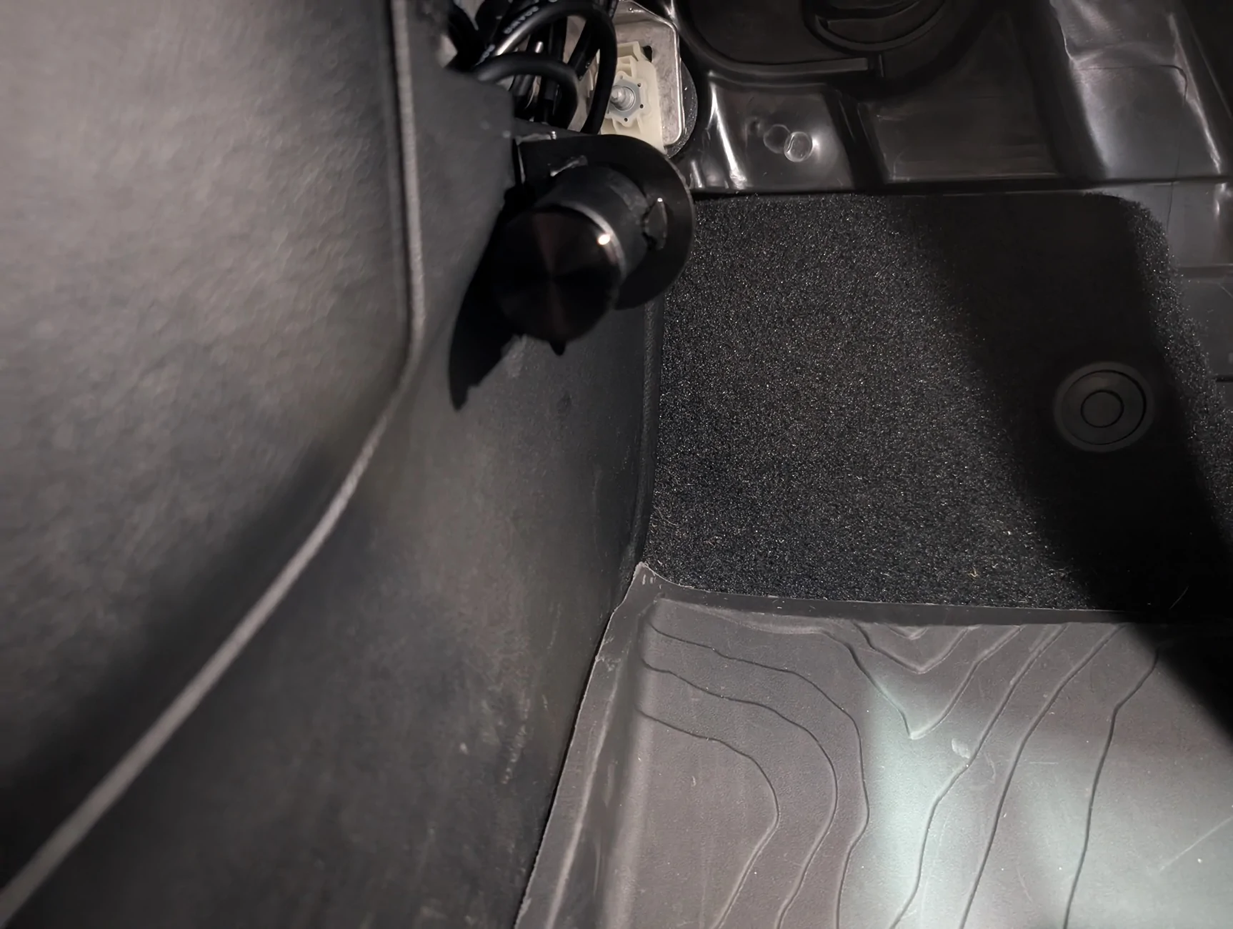

For lighting, I used a harness I bought off Amazon that attaches to the factory harness to use the stock lights for turn signal and brakes. I also added a 6 pin trailer plug to the front bumper for easy connection to the tow bar. I had to fabricate an attachment point for my safety cables, but wasn’t a big deal since I have a well equipped shop.
Overall, flat towing a Jeep is really easy, and I have flat towed everything from a cj2a to my current Gladiator…they all flat tow great. We’ve gone down the wrong muddy road before and needed to turn around, and with our setup, we can disconnect the Jeep in 2-3 minutes, make the u-turn in The Beast, and have the Jeep hooked up again in another 2-3 minutes. This gives my wife great comfort, as she knows that no matter where we go…even the wrong road in the rain…we can self rescue.
We’ve had almost 15 RVs ranging from tongue pull, off-road trailers, class A, to our current Super C, and this one is by far our favorite. I just wish we would have figured it out sooner…we would have saved a ton of money…

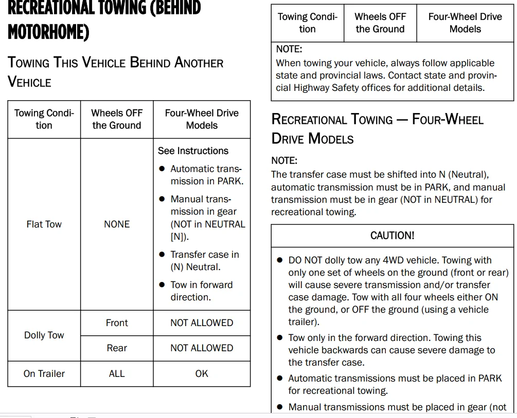

Is your gladiator an automatic or stick? I would like to know, I have an automatic and would like to flat tow too?
It is an automatic, you can flat tow an automatic gladiator because it has the transfer case allowing for neutral in the transfer case.

Yup, both an auto and manual can be flat towed.
Auto = transmission in park, transfer case in neutral
Manual = transmission in first, transfer case in neutral.
with an Auto, when I disconnect, I have to shift the transmission to neutral, shut off the Jeep, shift the transfer case into 2H, start Jeep, shift transmission into Park.
Check the owners manual - it's all spelled out.

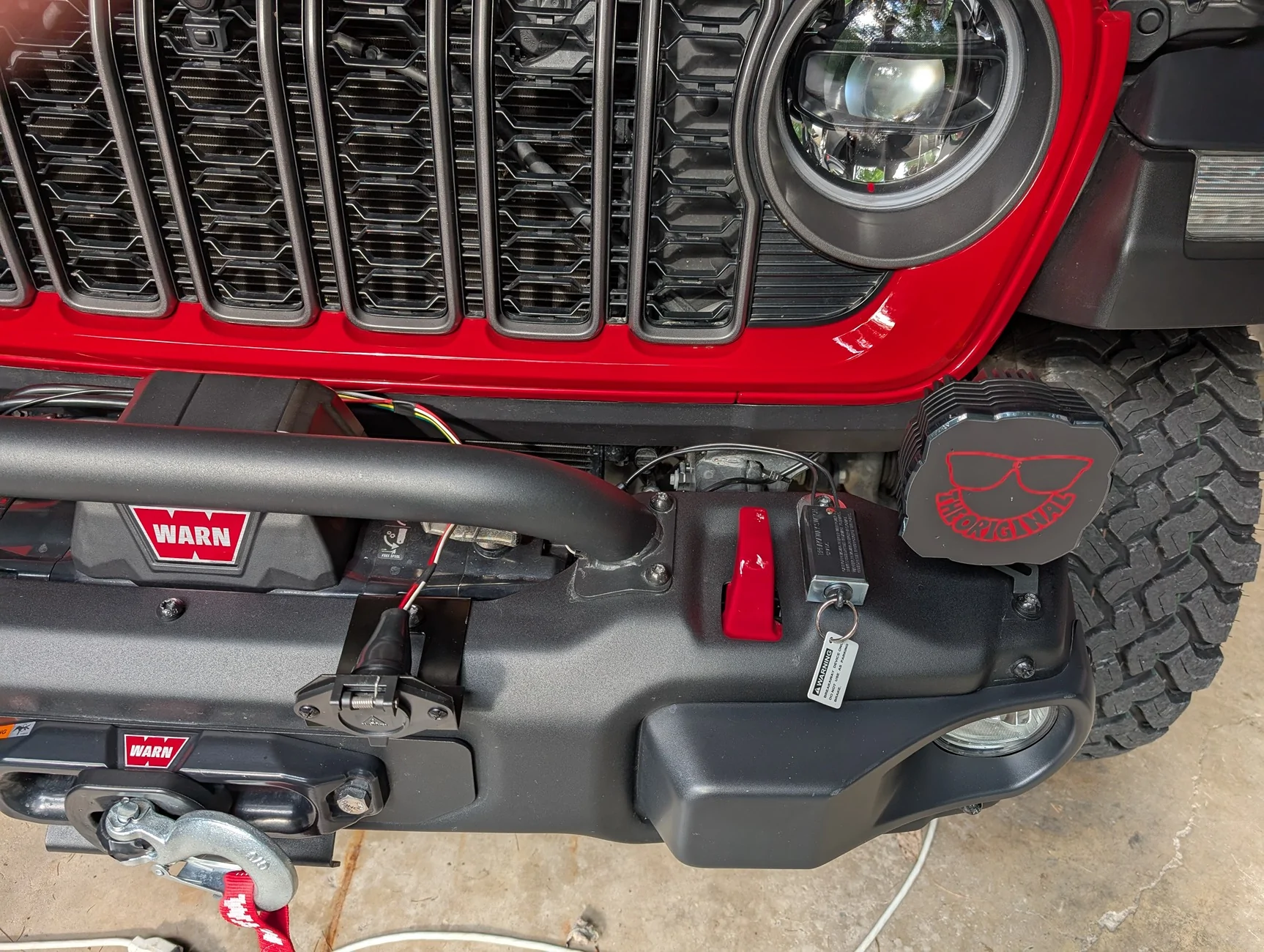

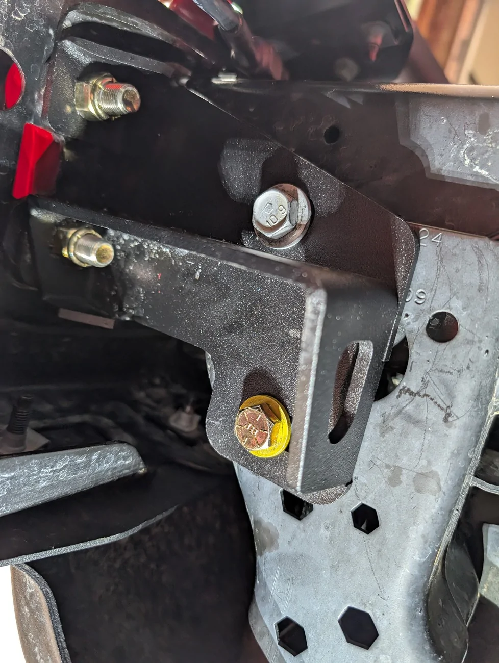

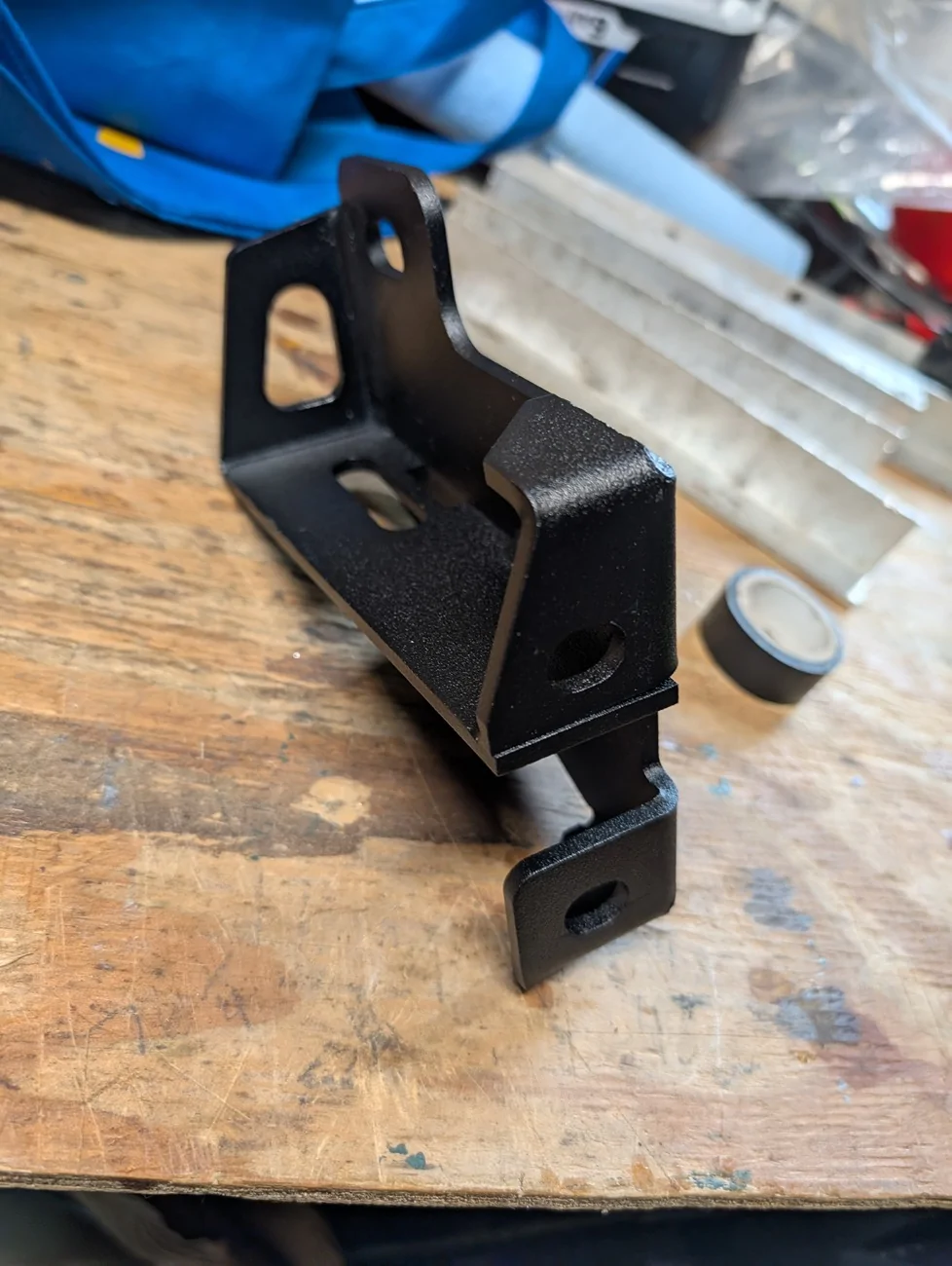

I finished the install of my Shackle tabs, I went with the HK Offroad D-ring shackle tabs on my factory steel Rubicon bumper. I was very happy with the results. The install took some time, but was straight forward. Because of larger hardware you need to enlarge some holes from 1/2 to 9/16. I was wondering how it would be to enlarge the holes in the factory hooks, but it went easy. I bought a reaming bit and some cutting oil. Everything that needed enlarged went well just using my Dewalt cordless drill.
While everything was apart I also installed the Flat Tow Brackets for Quest Series Front Bumpers from Rockslide Engineering. Woohoo perfect, they simply replace the frame horn support on the outside of the frame. Bolt right up and are very heavy duty. Provide an excellent spot to hook the safety chains.
Jeep Gladiator Flat Towing a Jeep Gladiator with a Factory Rubicon Steel Bumper PXL_20250830_231936256~2
Jeep Gladiator Flat Towing a Jeep Gladiator with a Factory Rubicon Steel Bumper PXL_20250907_203039482
