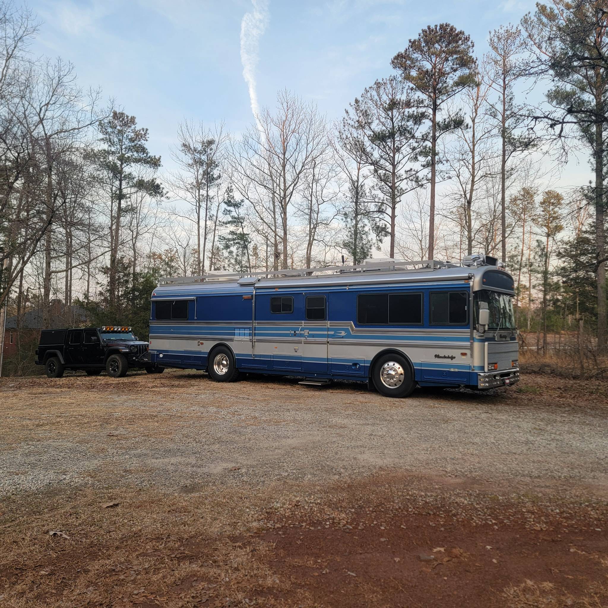

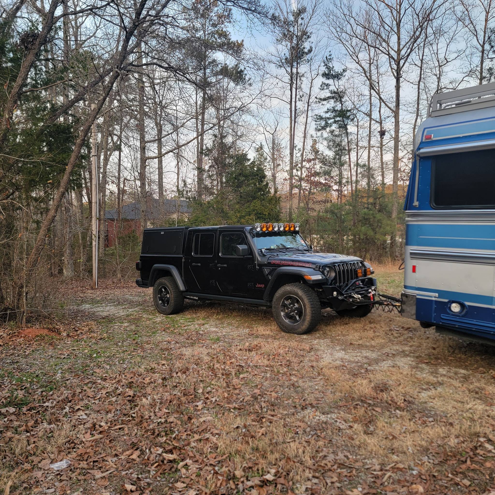

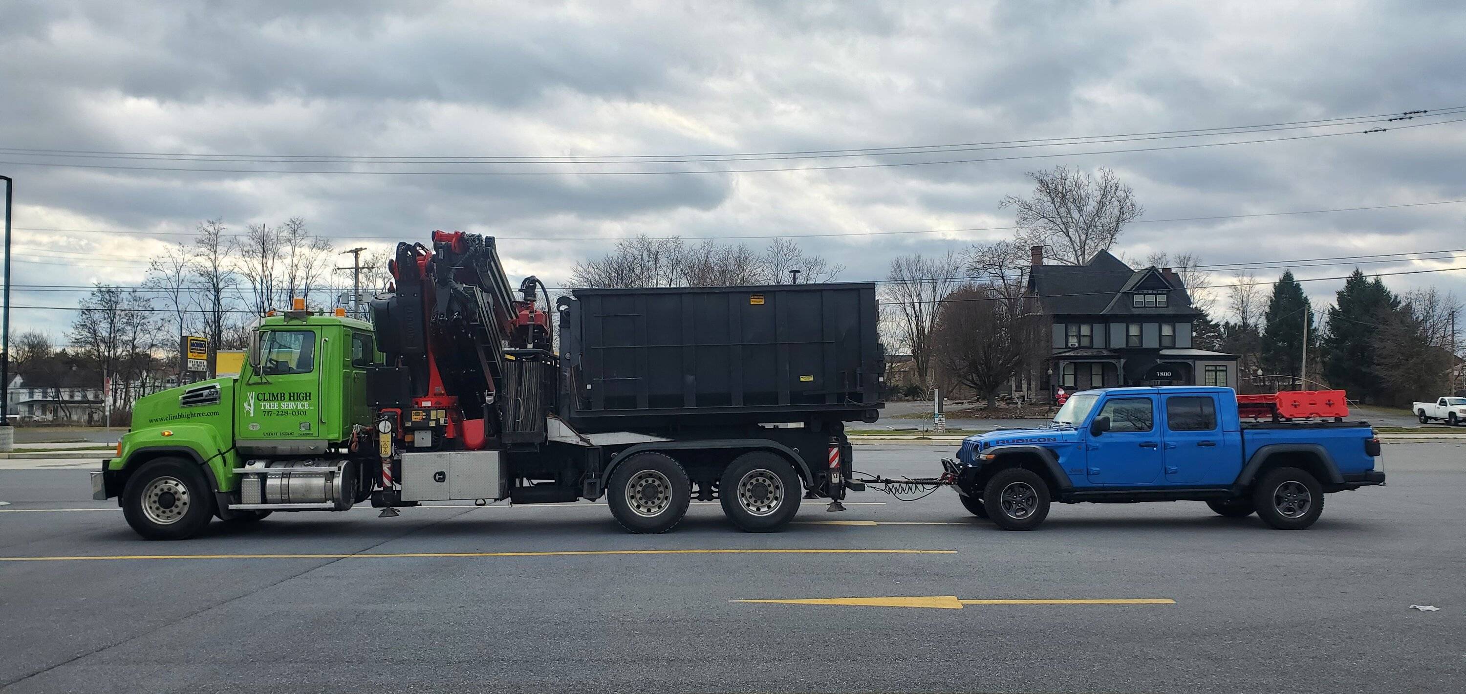

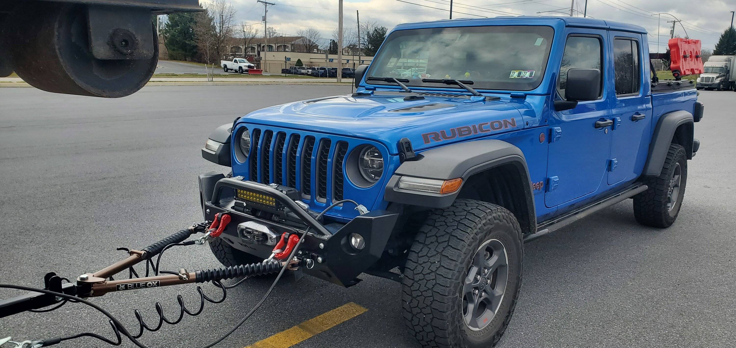

Sry I can't help with your specific issue. I have a rubicon and I do flat tow it, but I went with a bumper from Rockhard 4x4. I didn't feel like messing with adapter plates etc. Plus I wanted a winch bumper anyways.
Jeep Gladiator Flat towing Jeep Rubicon 20221218_113554
Jeep Gladiator Flat towing Jeep Rubicon 20221218_113616
I hope someone in here can help you. I just wanted to show another option to the whole setup.

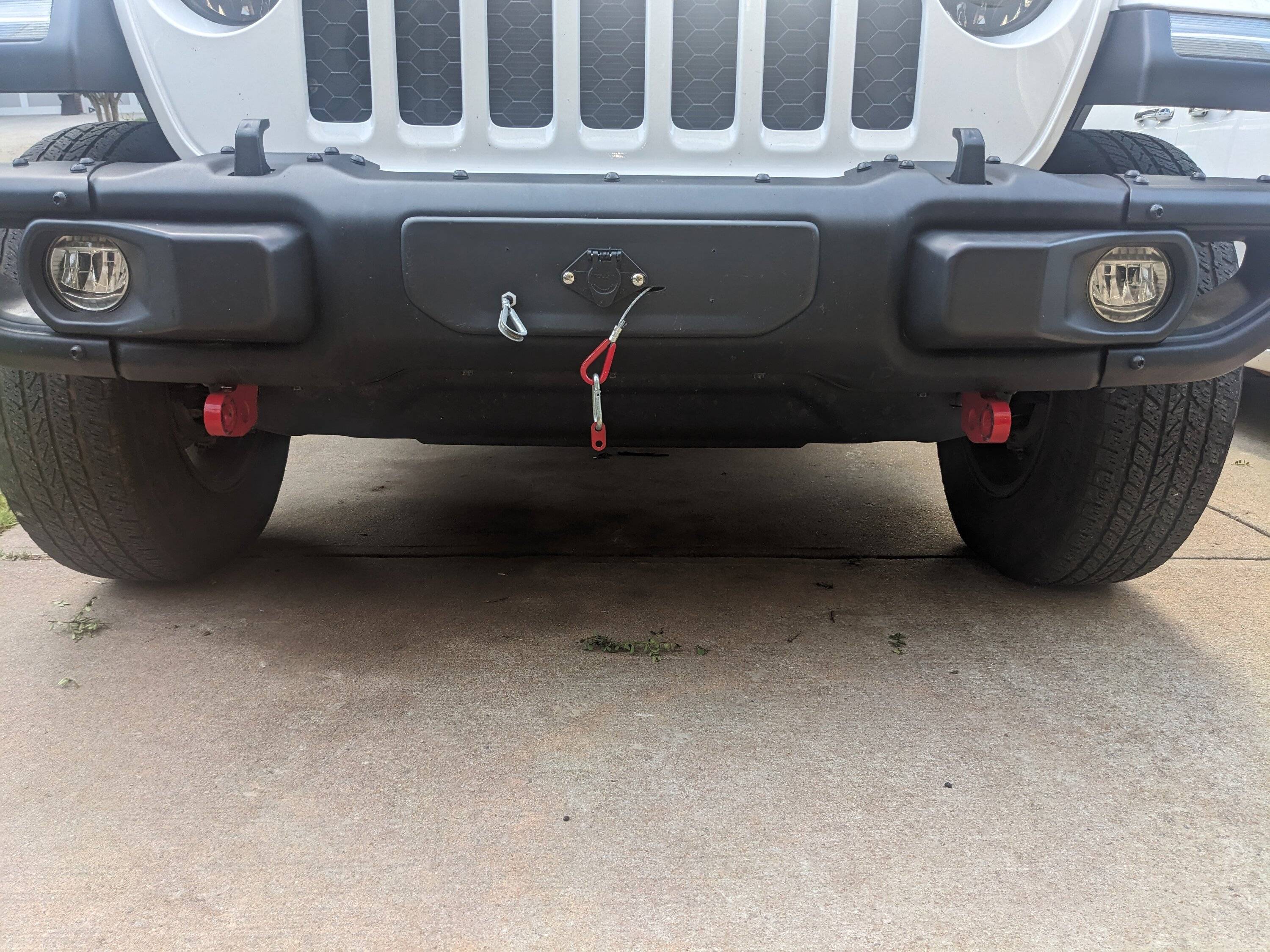

I flat tow my sport s with the metal Mopar bumper and is the same as your Rubicon bumper. I installed the Maximus tow loops and had to notch the bumper and skid plate. All I needed was a grinder with a cut off wheel and made easy work of the notching. Just be sure to paint the area you cut with some spray paint to prevent corrosion.

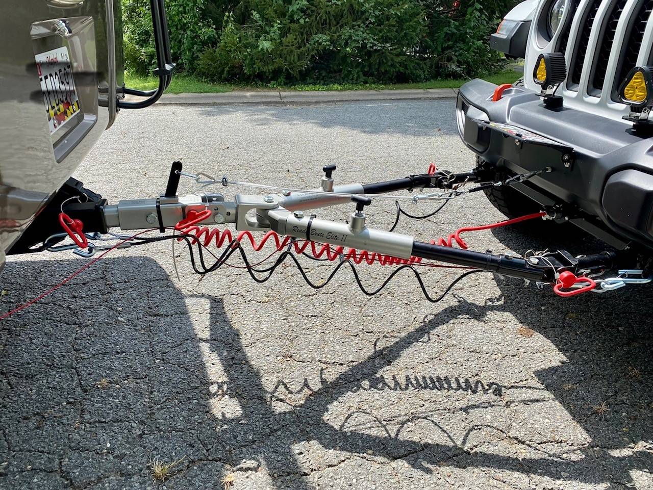

I have a roadmaster base plate, and use a Ready Brake Tow bar system – NSA Ready Brute 2.

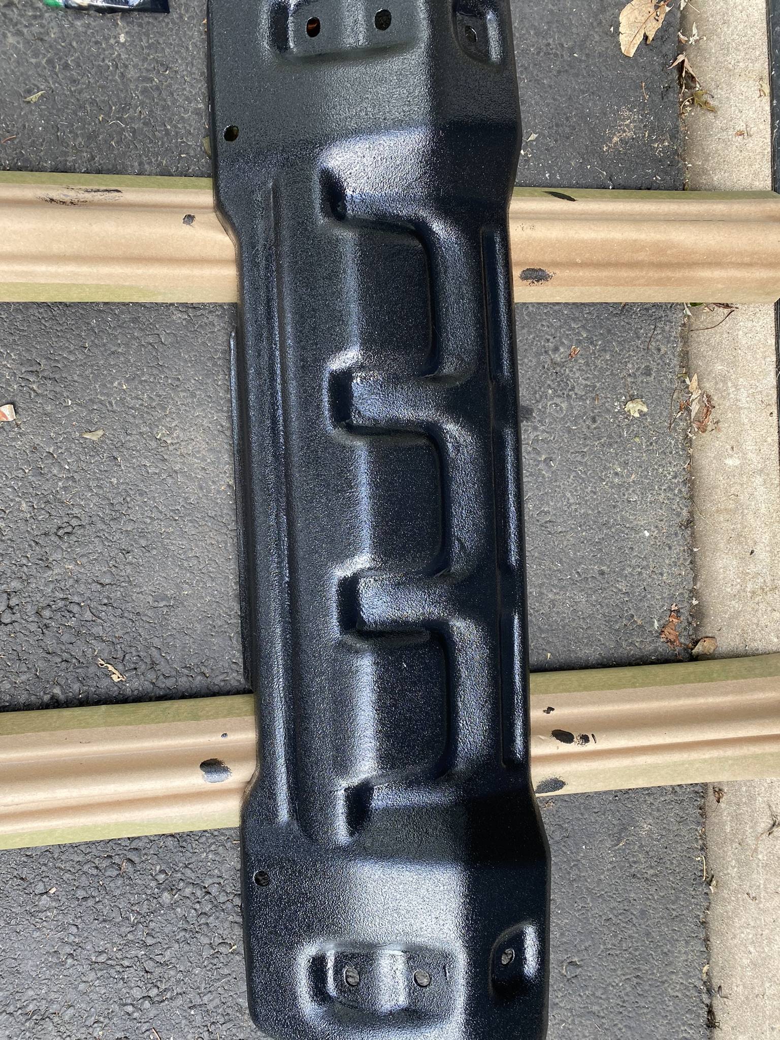

Not sure how different the Mojave is from the Rubicon, but my set up is on a 2023 Mojave. I had to cut slots/groves about 3/4" wide by 5 inch's long on the skid plate to get things to fit. As mentioned use an angle grinder or a sawzaw with metal blade. Measure twice, cut once. You can test fit and trim if needed. I then scuffed and painted my silver skid plate with rust-oleum bed liner (can from walmart), 3 coats. It blends in so nice, you cant tell I cut the skid plate. Sorry wish I had better pictures.
