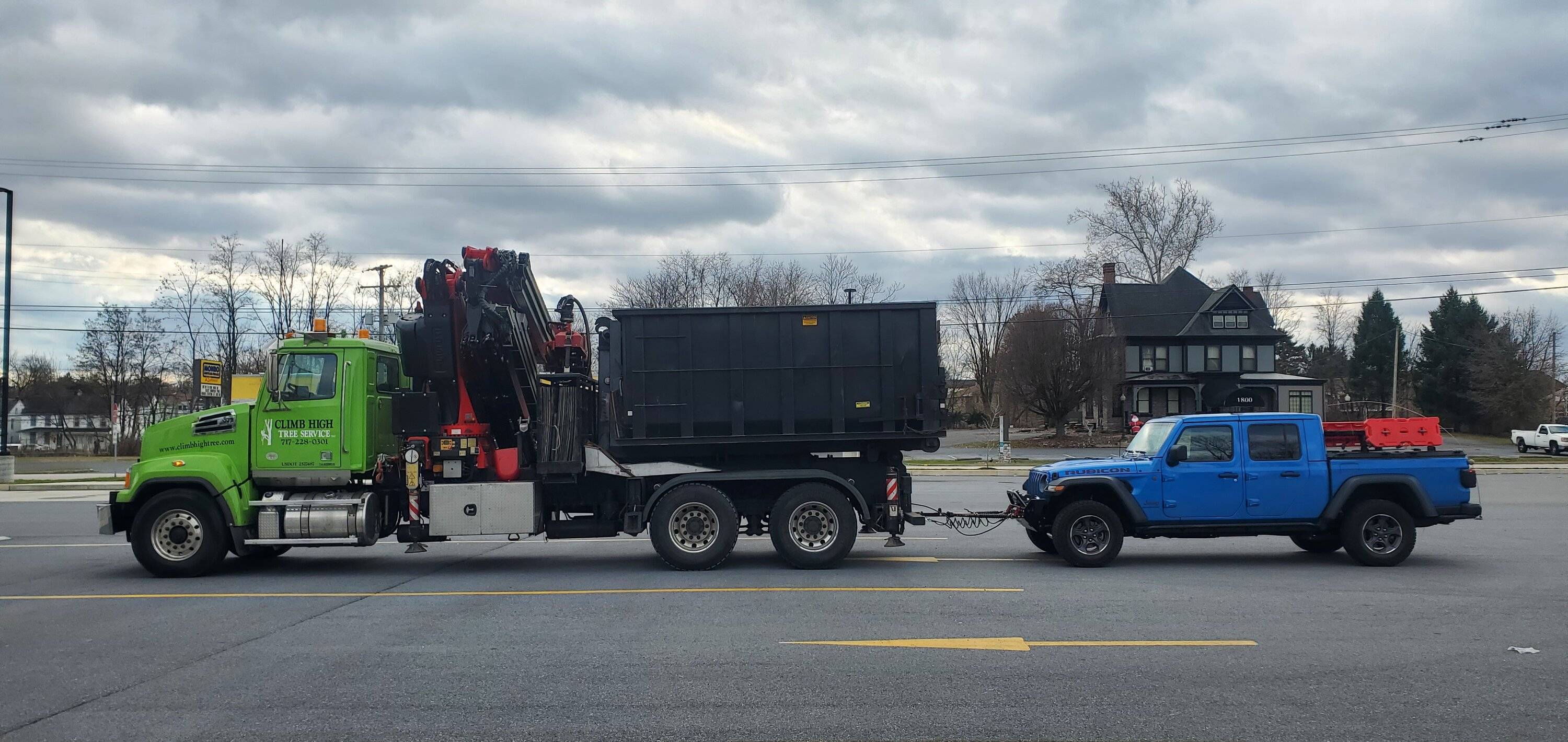

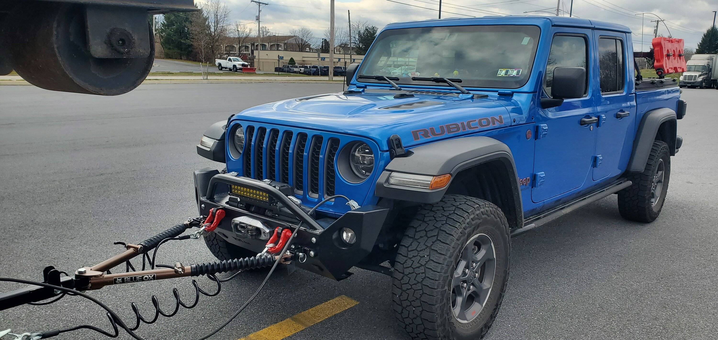

I flat tow my Gladiator at times. The steering wheel doesn't lock. Ignition in the off position. Transfer case in neutral and transmission in park. There is a step by step procedure in the owners manual for doing transfer case and tranny

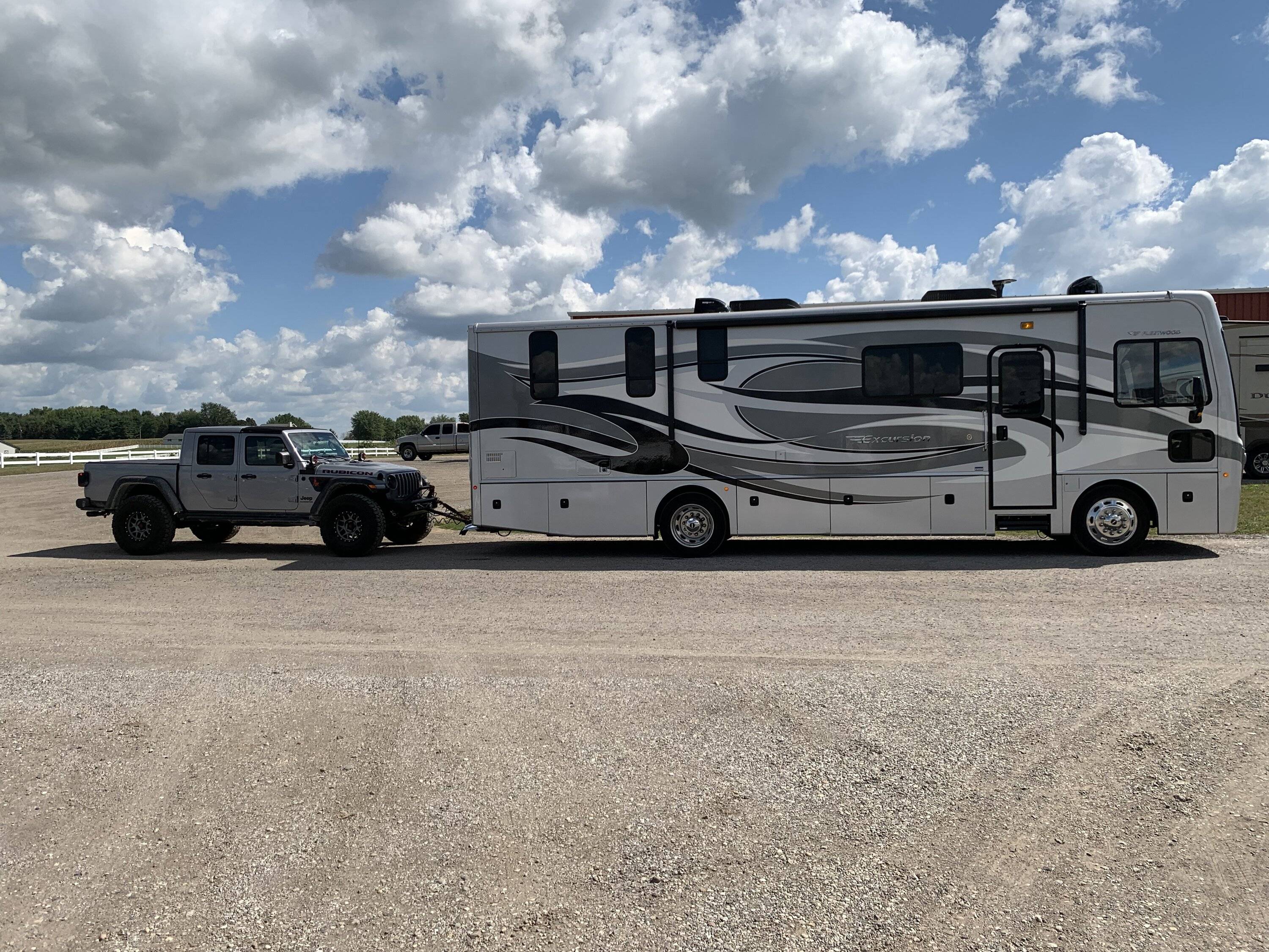

Along drive it killed my battery, depends on the health of the battery, but it happened. I have a backup plug-in charger for the heck of it, but that setup from cool llc keeps me topped off.

I towed it last week, four hours each way and it was fine. But I gather from what I've read so far that on longer trips I'll need to find a solution to keep it charged.
Nice setup!
