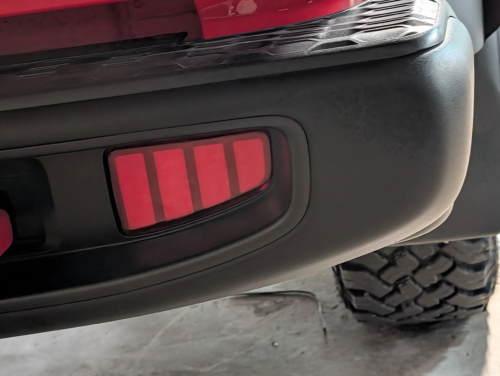

Yes this is definitely correct, I tried it and they come on and override the turn signals. In the end I replaced the reflectors in the rear bumper with lights that included turn signals. I wired the turn signals to the wiring harness from the motorhome and used diodes so it doesn't feed from the Jeep. So they are now dedicated turn signals that only worked when flat towing.
Could have used the Cooltech system but really didn't want to cut into the factory harness if I could avoid it.

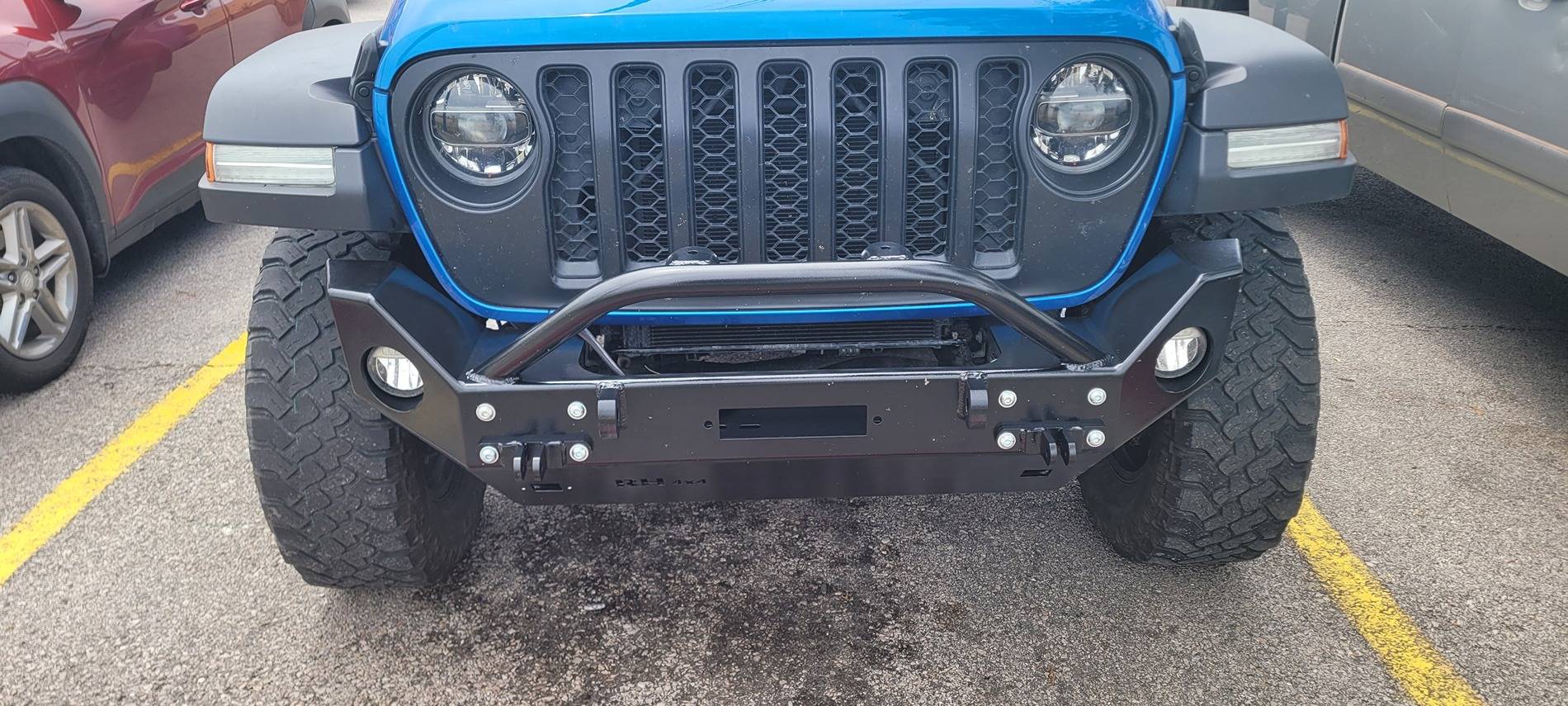

Just mounted my Rock Hard 4x4 bumper with Blue Ox attachments this week. Still have to finish up wiring the socket for lights but have the CoolTech wire harness installed and the RVi battery charger hooked up.
ANY issues with your Rock Hard 4x4 Bumper set up?
None at all. Although the deal on my Class A fell through so I haven't had a chance to pull this thing around yet. The bumper is awesome, I have a winch mounted on it now as well as some additional lighting. The only thing I wish it had was some small cable retainers or points to attach the fog light wiring to. Other than that it's been great.
Great to hear.... I am looking at the same company bumper for flat towing. Cant decide between that or the invisible base plate..... trying to have the cleaner set up and no impact to off roading.
To me it seems even simpler...just put light assemblies in where your reflectors go in the rear bumper then simply wire them (running new wires along the frame from the front to the rear) like you would a utility trailer. There'd be zero connection to the Jeep's wiring harness, and this way you get running lights, brake lights, and turn signals running from the flat4 connection on your motor home. They'll be powered through that connection so there's zero drain on your Jeep's battery.
I thought about this solution, the only issue is you would not have side marker lights when driving at night. Seemed dangerous especially in this day and age of distracted driving. Could rig up some side marker lights in the back but the curt solution worked well enough, only issue was turn signals when braking with LED lights.
