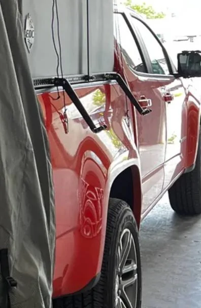

It might be better to mount tracks on the outside of the door and get the Harker EDC table arms/mounts.

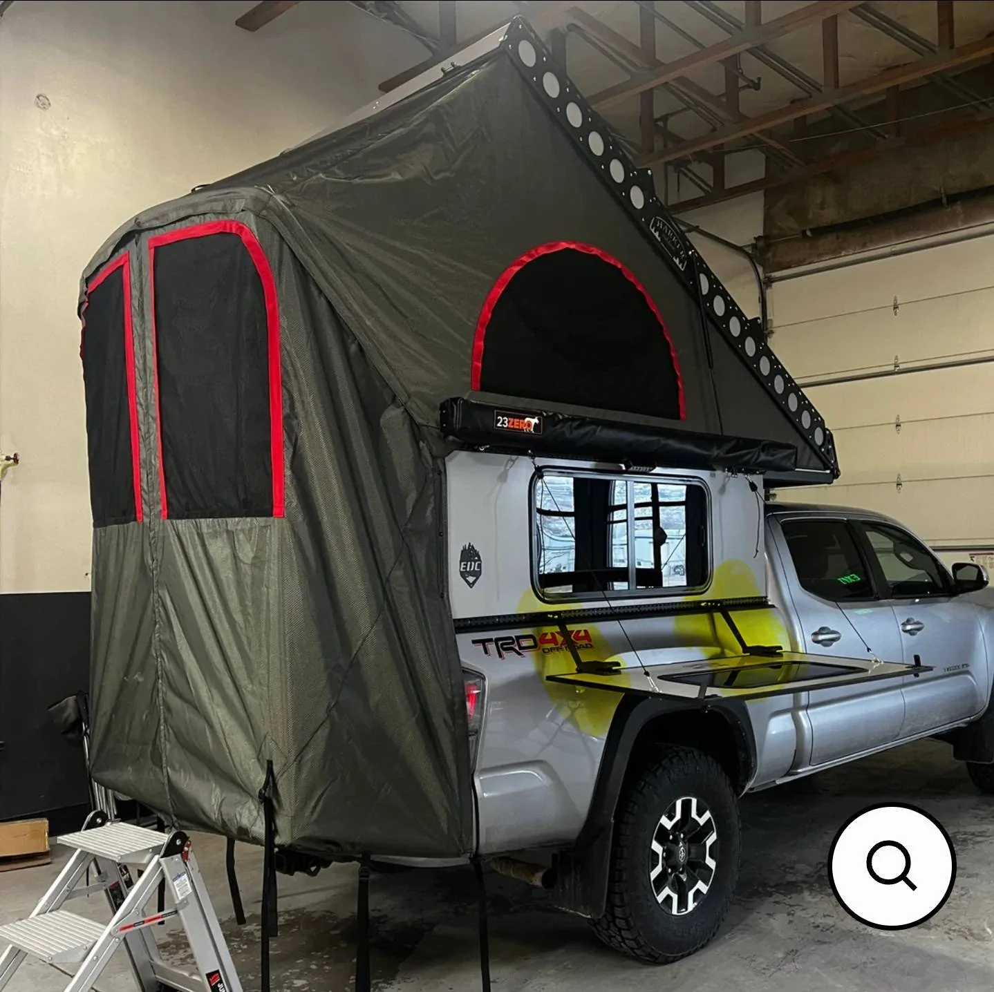

Or something along these lines would work too...
Something like this might work but it needs to go lower, and it also needs to flip up to be usable inside as well.
The Harker EDC method really isn't going to work. I will have water and LP lines going to it so it has to be usable in place, not removable and stored generally in the bed.
I want to think a hinge system like the SmartCap idea would work, but with longer hinges. Then they could mount to the inside lip of the canopy itself as well.
