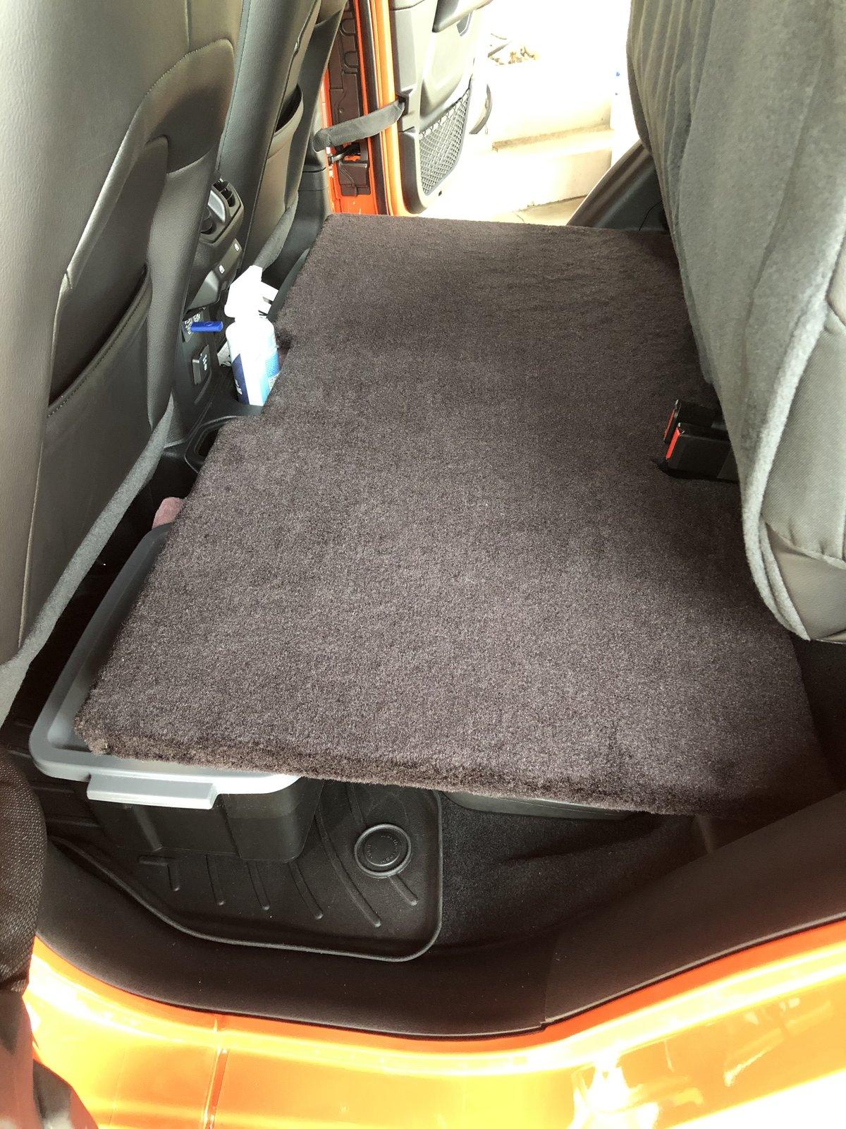

Not sure if this is what you are looking for.
I made a simple "package platform" out of plywood. I already had the locking factory under seat storage.
Jeep Gladiator Flooring insert? IMG_1132
I used 2 Rubbermaid Roughneck 3 gallon black storage totes for the front support that I ordered from here:
https://www.doitbest.com/shop/stora...roughneck-3-gal-black-storage-tote?SKU=608254
You can go larger, but I wanted them small enough that I can easily move them if I was going to have rear seat passengers. Plus, they are just to hold tie-downs and an air compressor, etc. My main objective was creating a "flat floor", not so much the extra storage (although there is also space next to the totes on the floor that you could put stuff).
The plywood I cut down to 2' x4' and then made a small cutout on the front edge so I can still use the rear cupholders as I often throw a spray can or spray sanitizer in them. So, I didn't want to block the holders. I covered it in some old auto carpet I had laying around.
I did later add two small lengths of a 2"x3" (maybe 12" long each) that I screwed to the underside of the platform where it sits at the Rubbermaid totes (so the boards rest on the tote lids). I realized that the rear OEM storage box lid goes up at an angle, so the platform would rock some. So I attached the pieces of 2"x3" to stop the rock. I originally just put two rolled up towels on top of the totes that did the same thing -if you don't want to bother with the 2"x3" boards. Its easy to see what I mean about the rocking the first time you trial fit the plywood.
I've since moved this set-up to my Rubi that has just the under seat storage bin (non-locking).

I was just looking for something quick and easy. I had the plywood, carpet and containers laying around (I had blue containers that I later swapped for black).
Anyway, it takes 30 seconds to pull it out and throw in the bed. Another 30 seconds to move the containers to the bed or just one side (if only putting one side of seat down.) I've had it in place between the two trucks for 1 1/2 years. I love being able to just throw crap in the back on a deck. It's especially handy at the grocery store.
If you do find a company making a more refined solution, please update us.
