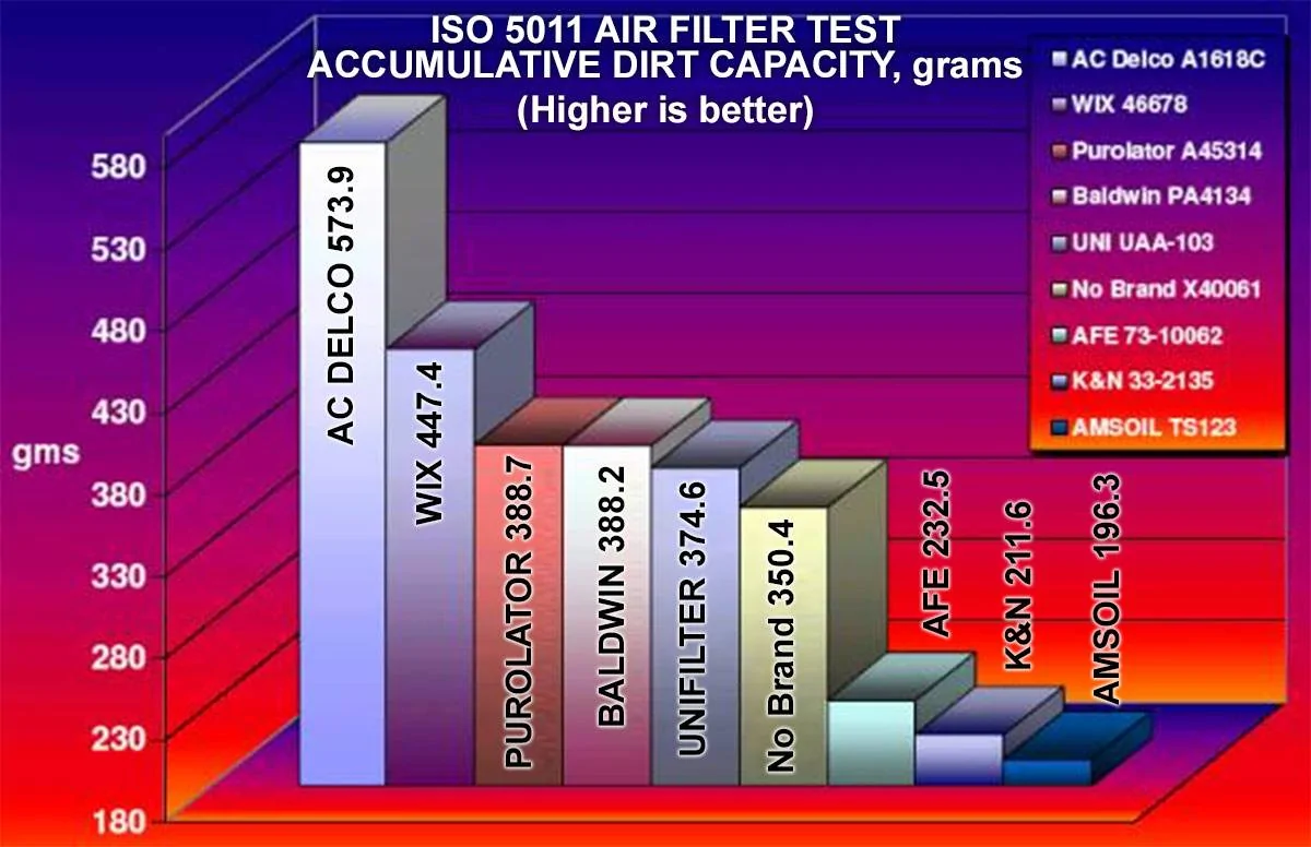

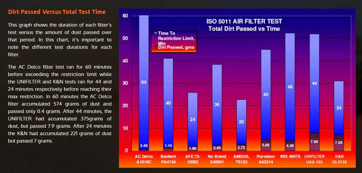

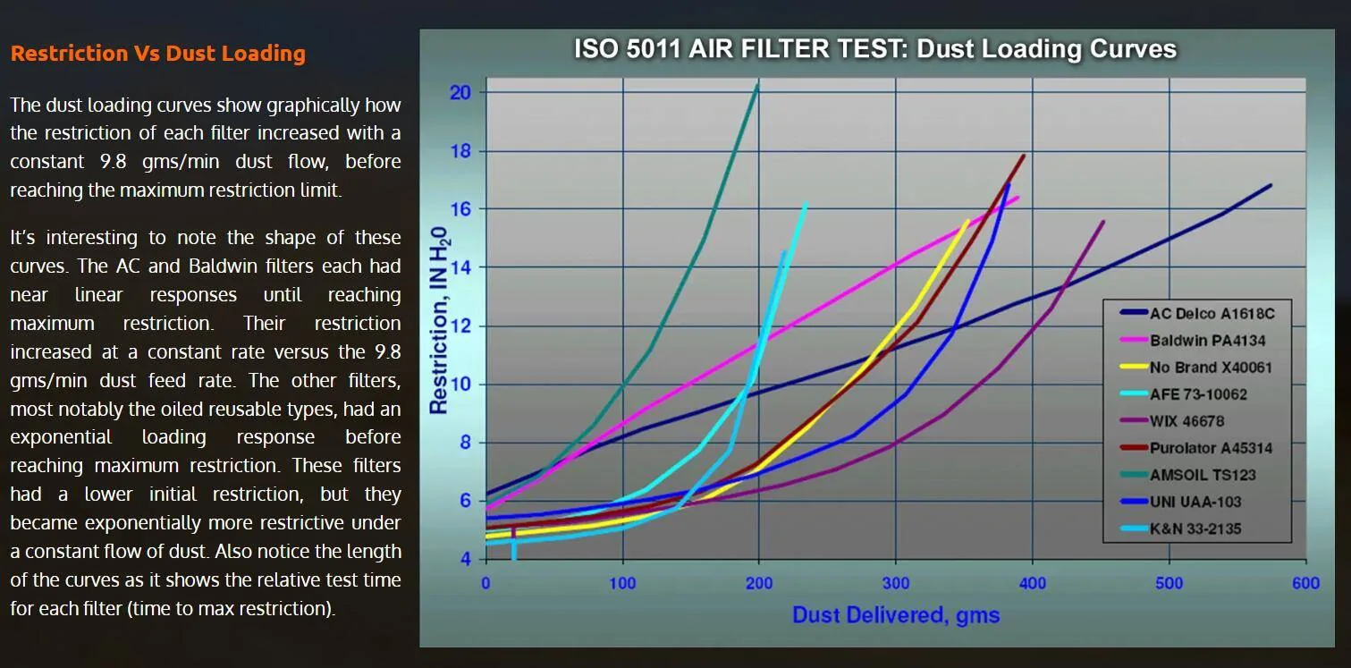

The problem is - "you can't tell by looking", and, the K&N is the second WORST at cutting air flow. It can't handle as much dirt before cutting air flow down below acceptable. So - sure, it will run, but it's also cutting air flow faster than a good paper filter.
It's open wider at first, but fills up faster and closes down flow faster than anything except the Amsoil in these tests.
In other words, I bet to maintain the same airflow as mine, you would have to clean yours several times before I need to replace mine. Yours will cut air to the engine a lot faster than mine. You just won't realize it's doing that.
I think AC Delco ran this test. There’s no filter better than them in the whole world?
40,465
53,921
nope, an independent tester. Many of us in the classic car world know those filters hold up.
There's better out there, for sure - but to test every possible filter? These are tests of the most common/most popular.
I believe Project Farm did something themselves, it wasn't as scientific using real world dust particles and high-end equipment meeting ISO standards, but comes up pretty much the same.
There's a guy who tested the K&N on a Ford on the dyno, and showed there was no performance gain unless you ran 6,000 RPM all day long. And at that, you'd need to constantly clean it because they plug up quickly. The amount of dirt they can handle is far far less than other filters.

The ISO5011 test is the gold standard in air filter testing. It's used by every major vehicle, engine and filter company in the World to design and rate their air filters.

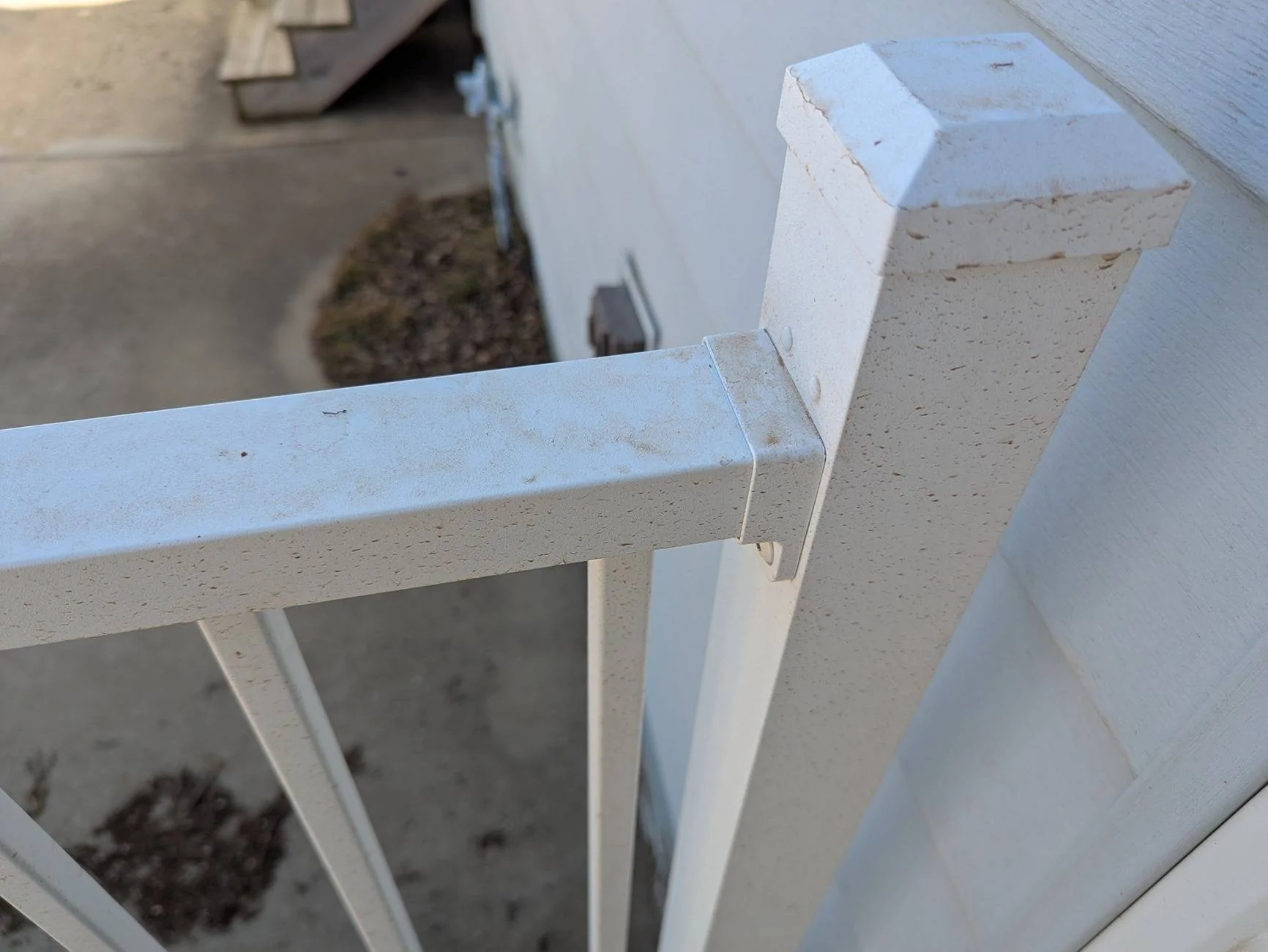

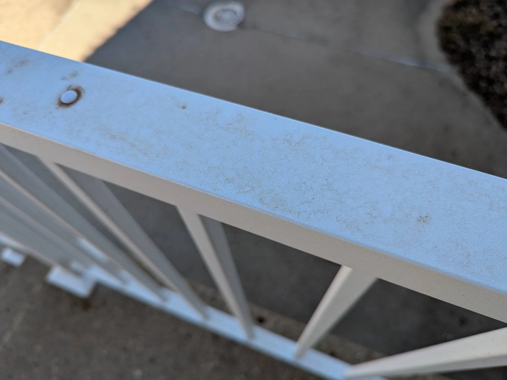

Comparing "bore scope" images would be worthless - you should know - because of all sorts of other variables - oil used, oil change interval, heat of oil, heat of engine, lengths of drives, frequency of drives, loads on the engine and more.
We would need to consider the types of dust we typically run into based on where we live, time of year and so on.
This railing was clean as can be - pure white, before our last rain. Seriously, this came down with the rain - wow:
Jeep Gladiator Fluid & Filter Preferences Explained - Jeep Gladiator 3.6L V6 PXL_20250325_201823744
Jeep Gladiator Fluid & Filter Preferences Explained - Jeep Gladiator 3.6L V6 PXL_20250325_201819127
That was in the air, washed down with a single 1/10th inch of rain.
Anyway, the point is, yeah, we could compare images of the bores - but what's that going to show? A whole lot of various conditions that added up to get to where each was.
