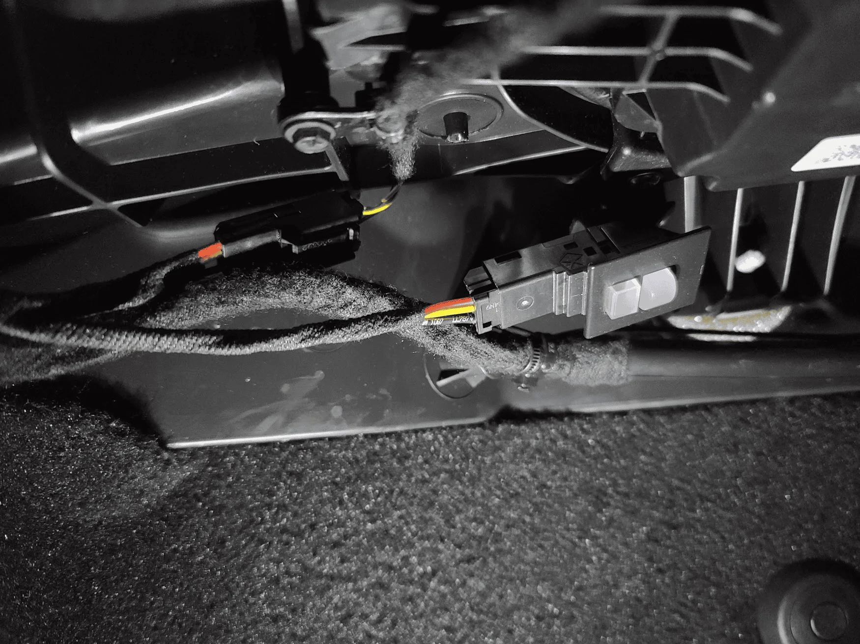

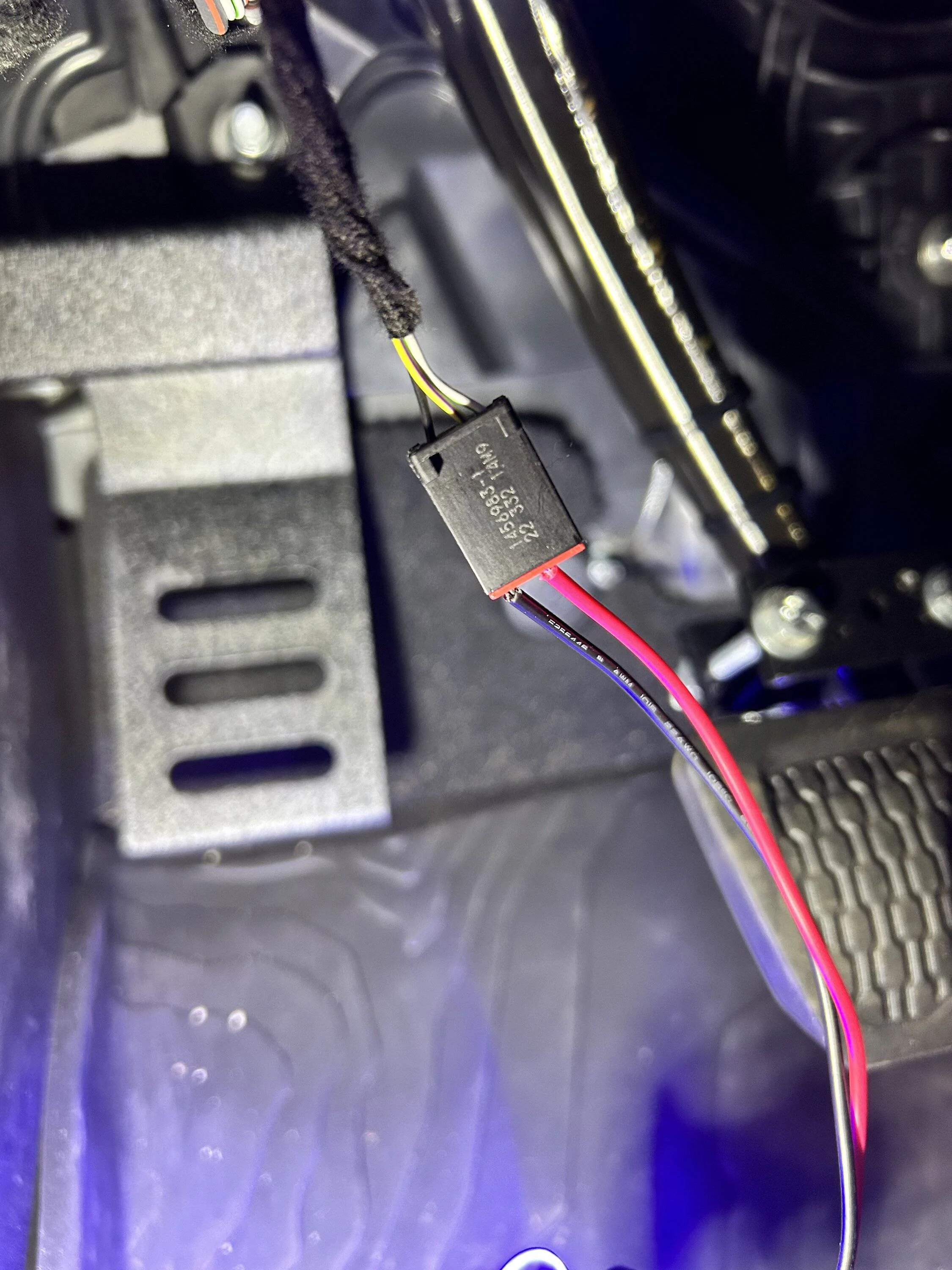

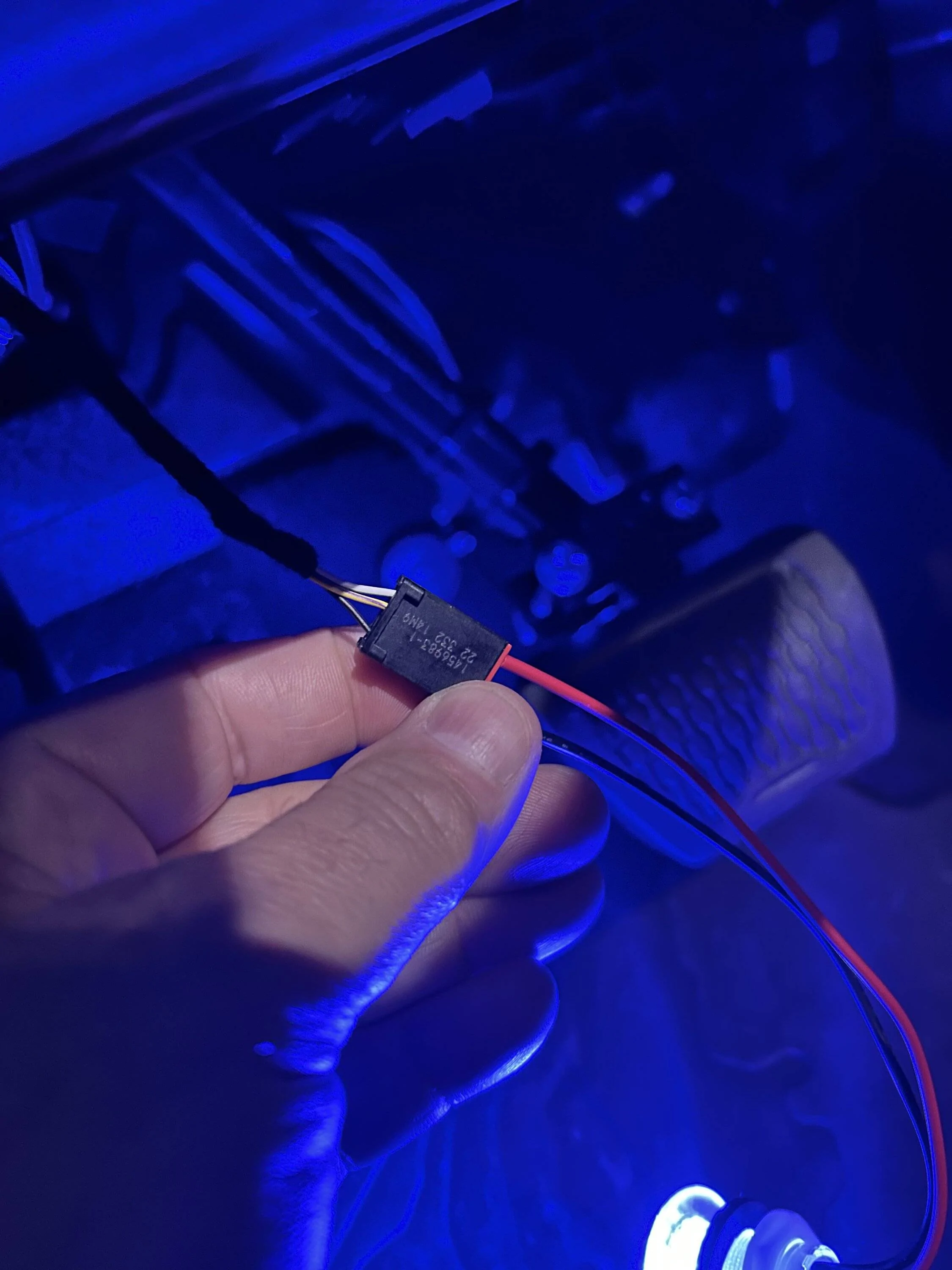

My wiring:
Purple or black is the ground. It was hard to see.
Yellow wire w/ purple strip on my Mojave is the courtesy light and goes off when you start the motor
White wire w/ green strip. On my Mojave is the ambient light that stays on when I drive.
This was a test fit, and all is good, I will wire them up in a few days. Eastern Shore of MD is supposed to get a nice storm tomorrow/Sunday, so I wont be working on them, but it will be a fast easy, cheap project. Thanks

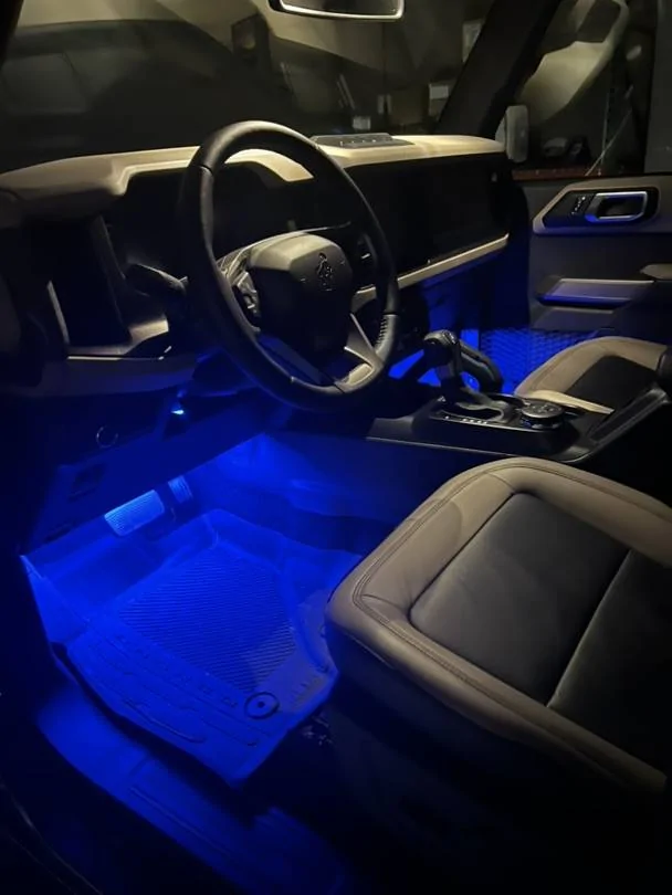

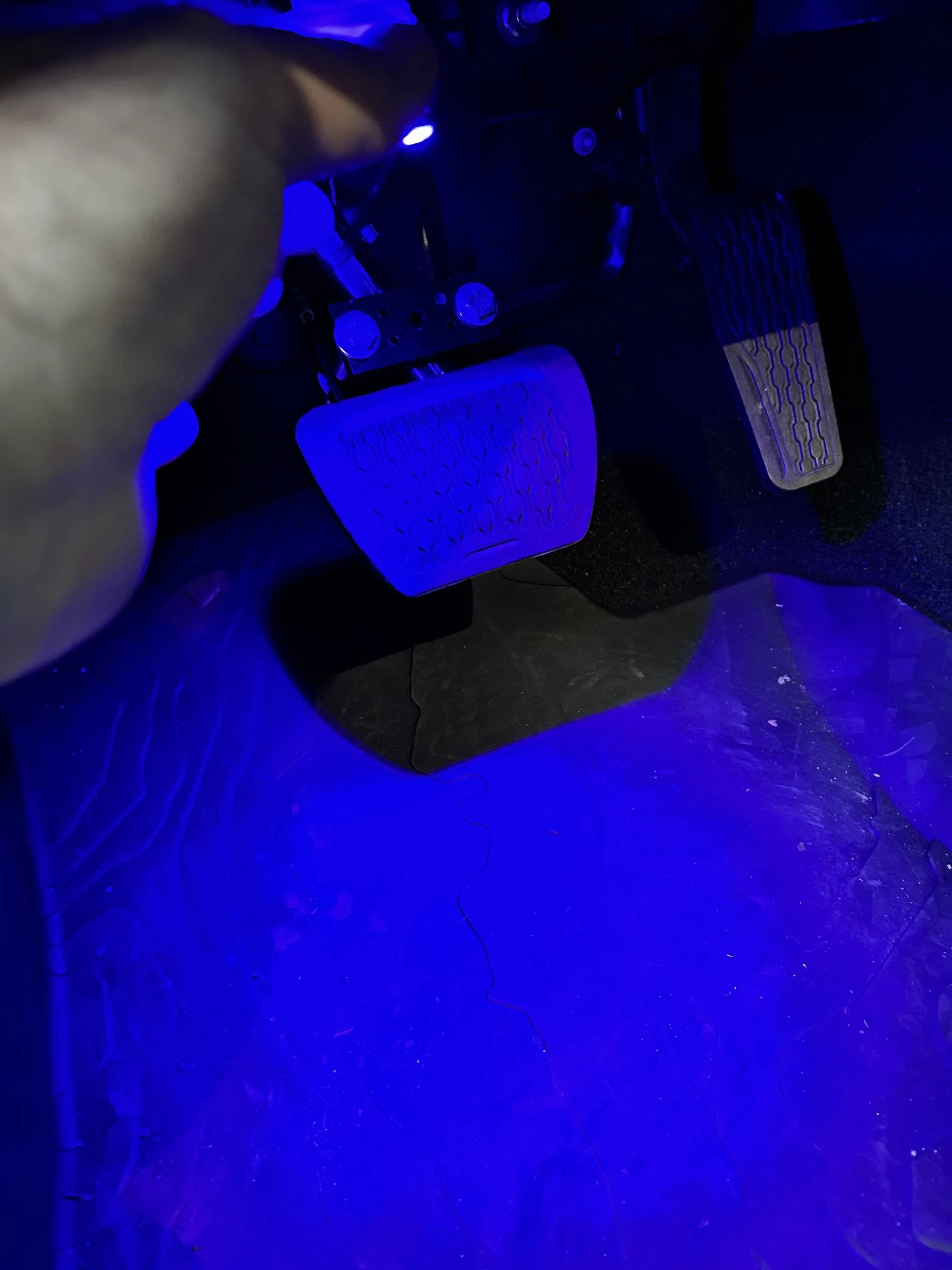

These are the lights I went with for $16
https://a.co/d/5ZfHTaD
Jeep Gladiator Foot well light bulb Plug
Jeep Gladiator Foot well light bulb Plug Ambient light setu
Jeep Gladiator Foot well light bulb Blue Light
