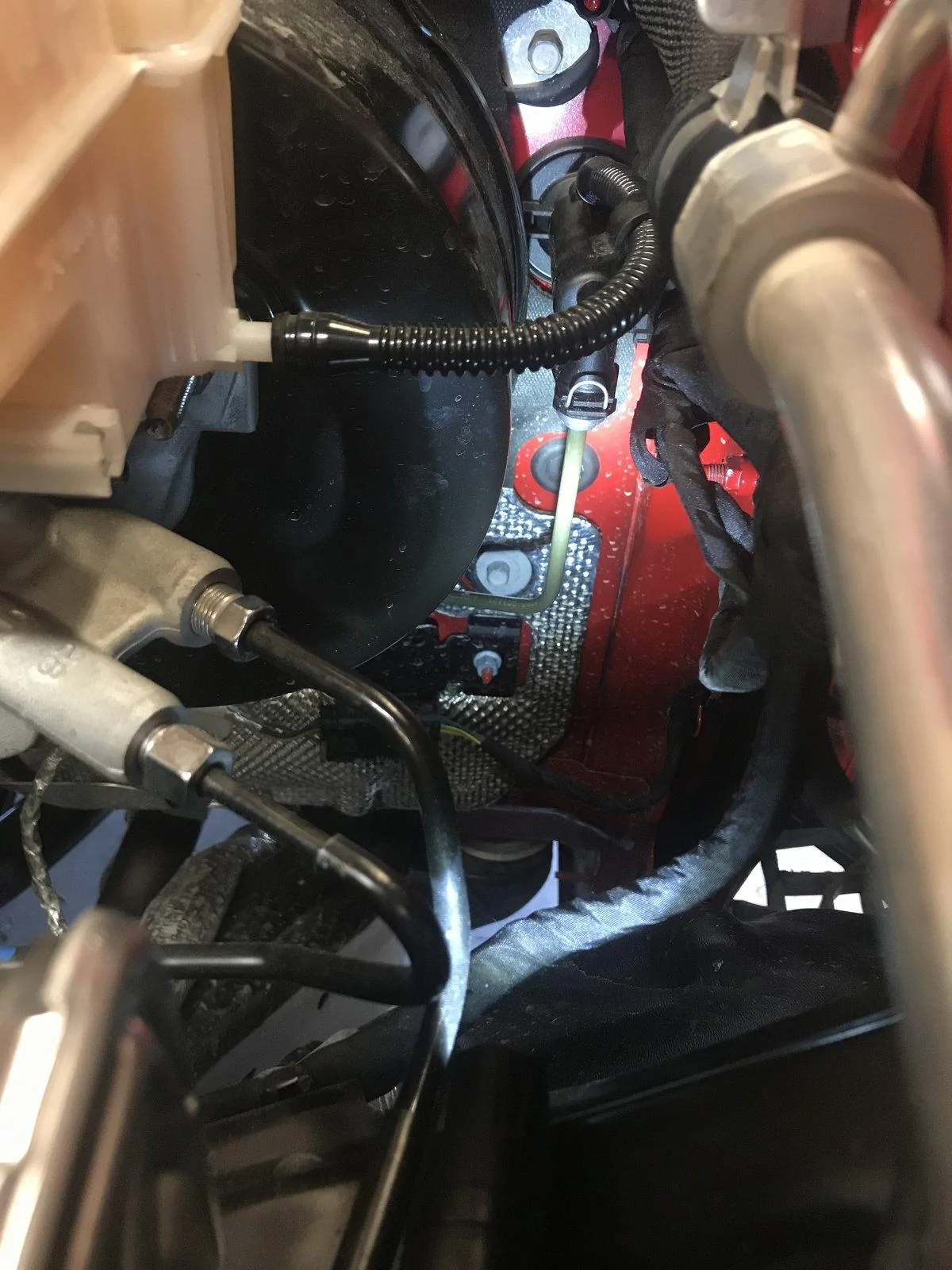

After searching i couldn't find much luck with a driver side wiring hole (manual trans) the auto guys use the clutch master hole and i don't blame them. but i found a grommet under the clutch master that didn't seem to go anywhere but after sticking my bore-scope inside the hole and not finding a wiring harness i poked a needle in and found it on the inside. cutting the plastic sound deadening out of the way sucked and taking pictures sucked even more but ill post a link to the youtube video i too trying to show where it comes out.
Ill try and get a better picture Tuesday now that wires are run.

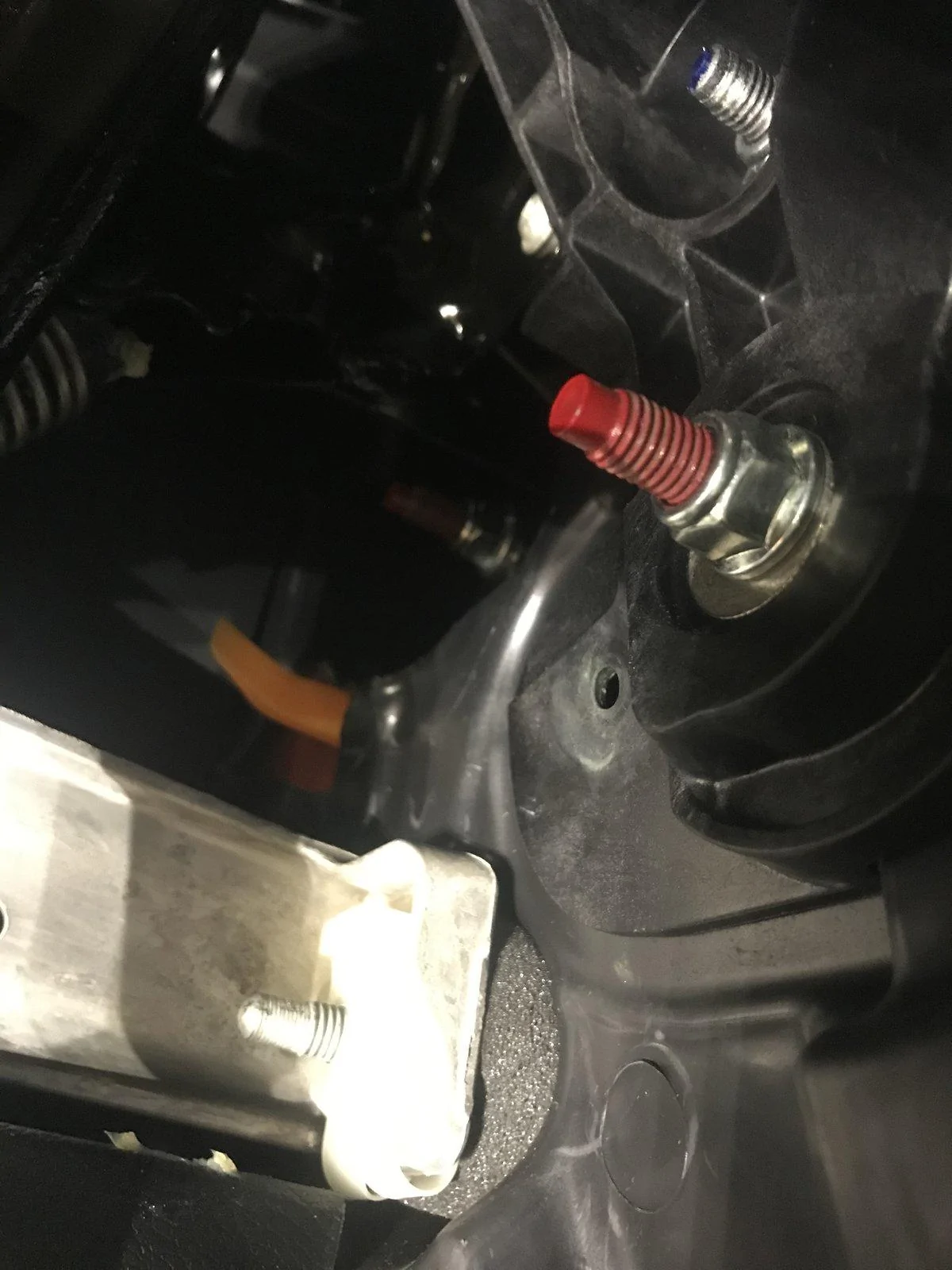

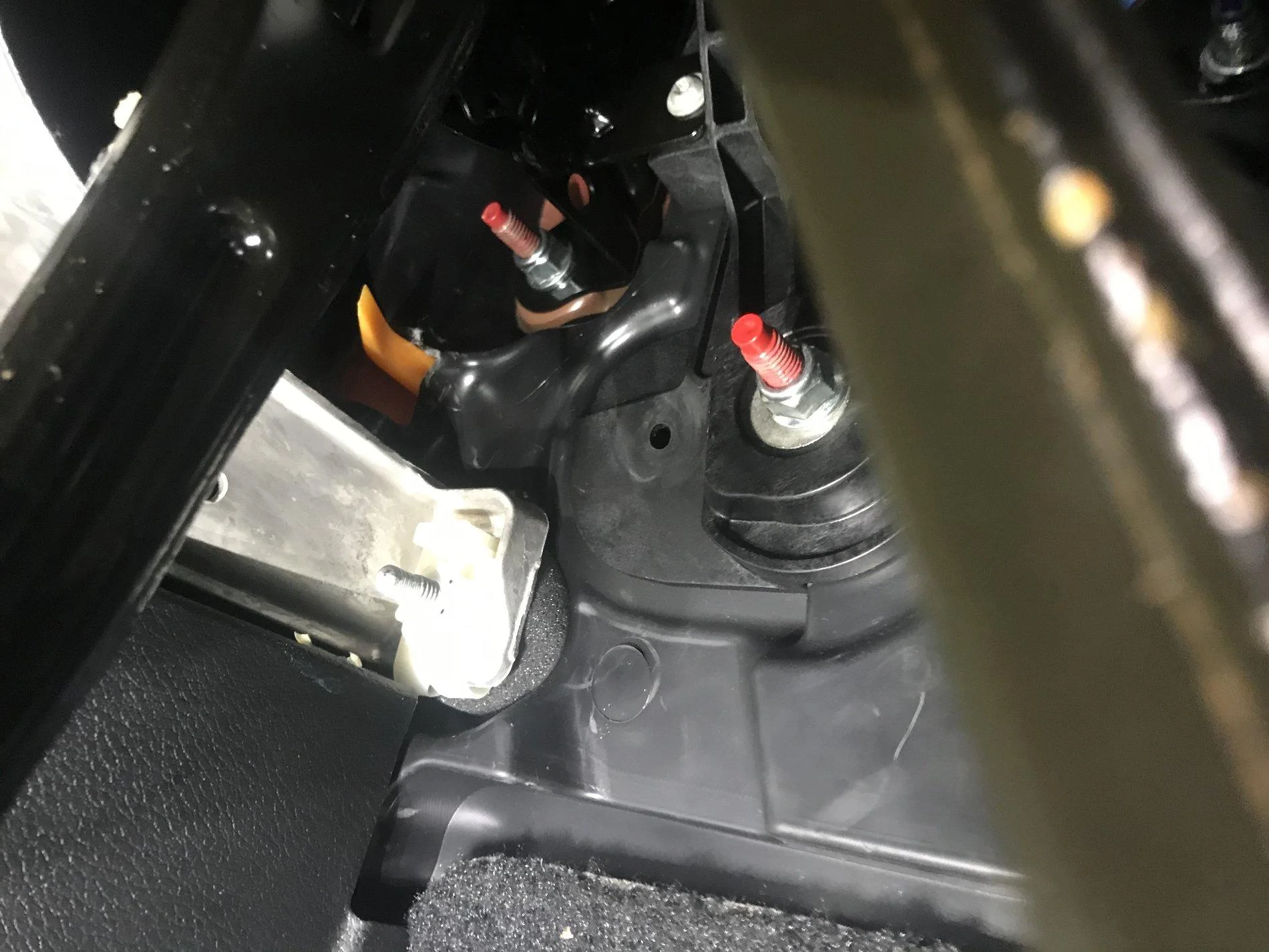

The orange trim tool is stuck threw the hole
