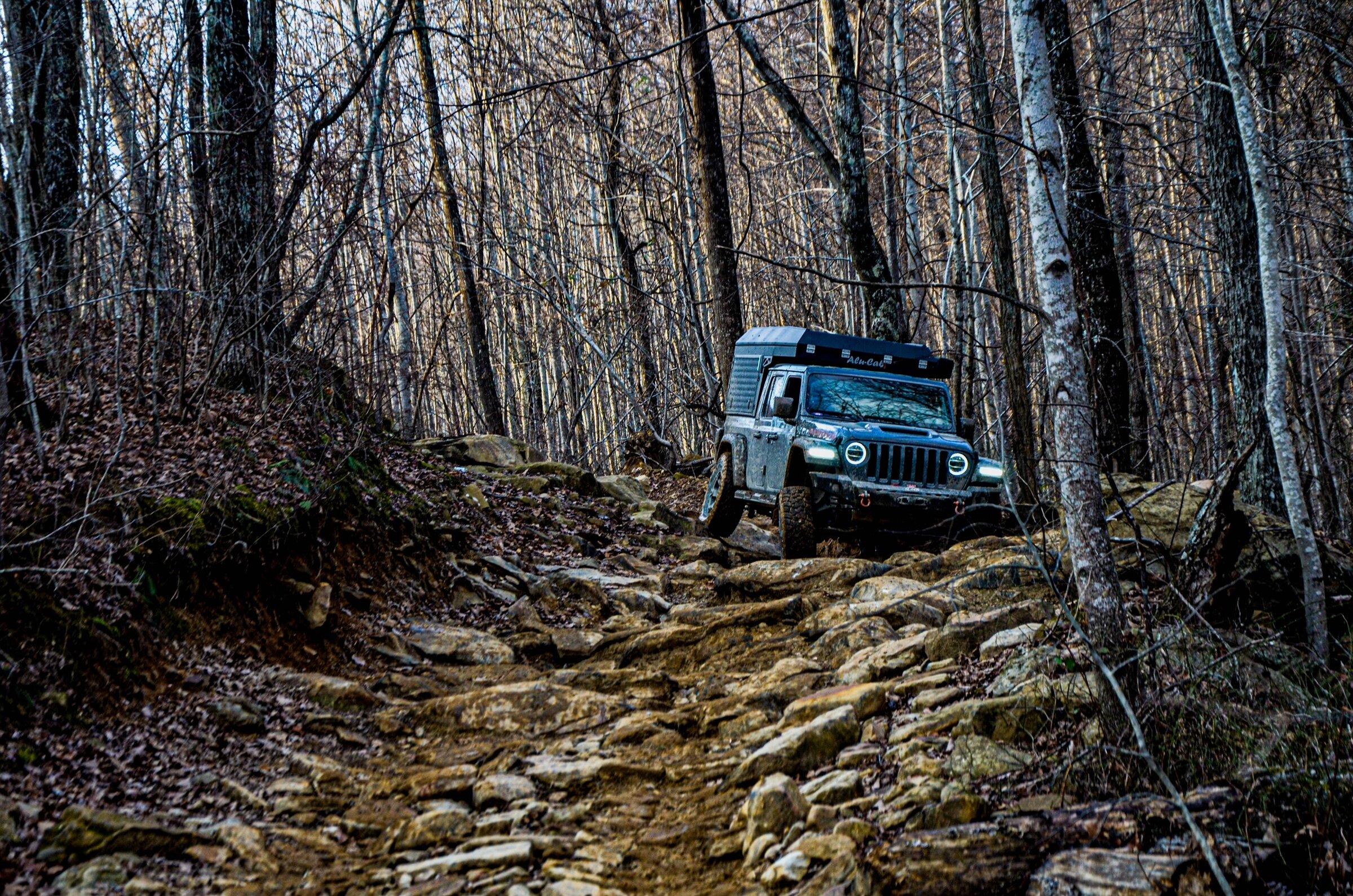

I have them. They are decent. I am not completely happy with the adjustment scheme. They do not have rebound and compression settings like most shocks, but high speed and low speed settings. They make a difference as you adjust them but not not sure of how the combination of the two interact. Also I feel my wheel and tire combo, use up most the capability of these shocks as they come from the factory. They seem to work best when being pushed offroad with bigger dips and bumps. On road with heaves and such, not much different from 2.0s

Thanks for the reply, im located in Australia so we dont have alot of options down here.
I really like the look of them but just wanted the info.
Did you have to change and links or bars?
how high are you sitting on the pic?
whats the wheel offset/ tyre size?
so sorry for all the questions
btw Nice rig.. looks awesome, love the way it sits.

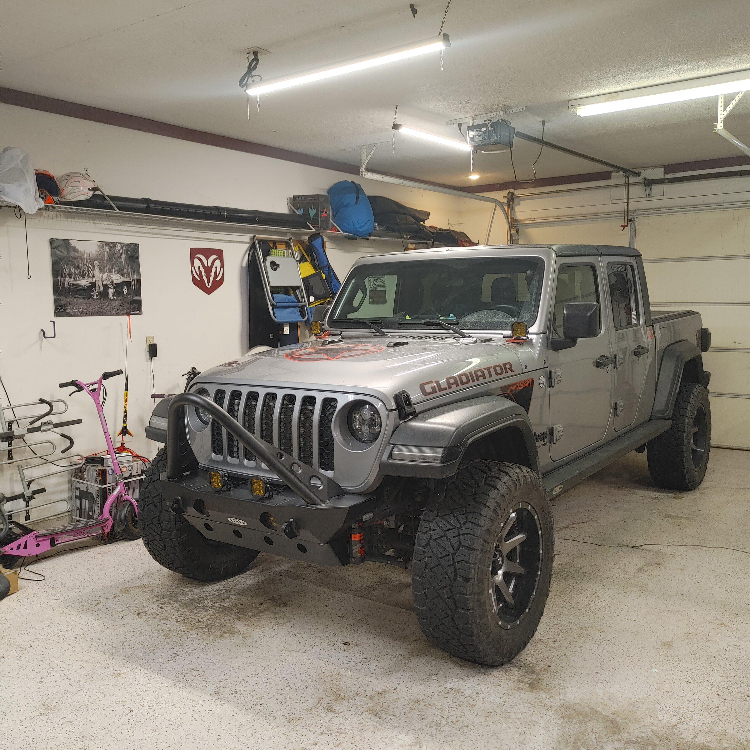

I am sitting on a Mopar 2.5 inch lift. I changed out the track bars for the Yeti, steer smarts, adjustable bars. The wheels are Fuel Rampage 20 inch wheels with an -18 negative offset I believe. Not my first choice but they are 2 piece forged wheels, I got for a good deal. The tires are 35x12.5s.
The shocks are solid pieces. I think I was just expecting a bit more by the looks and packaging. Also I may be judging thier on road manners to hard. I am used to spending that kind of money on my road car shocks ,and having dramatic improvements. I believe these offer that just in the offroad, operation.
