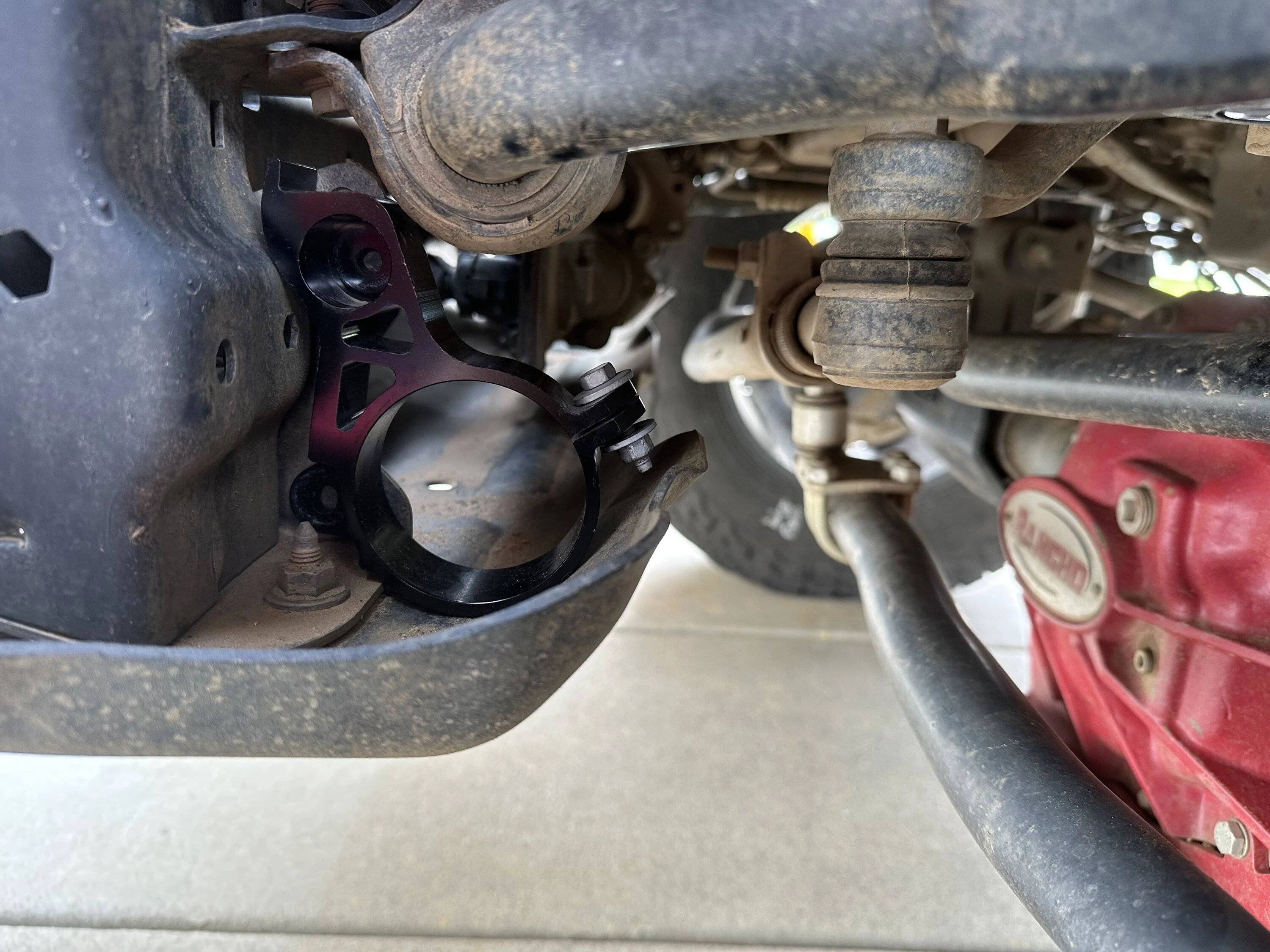

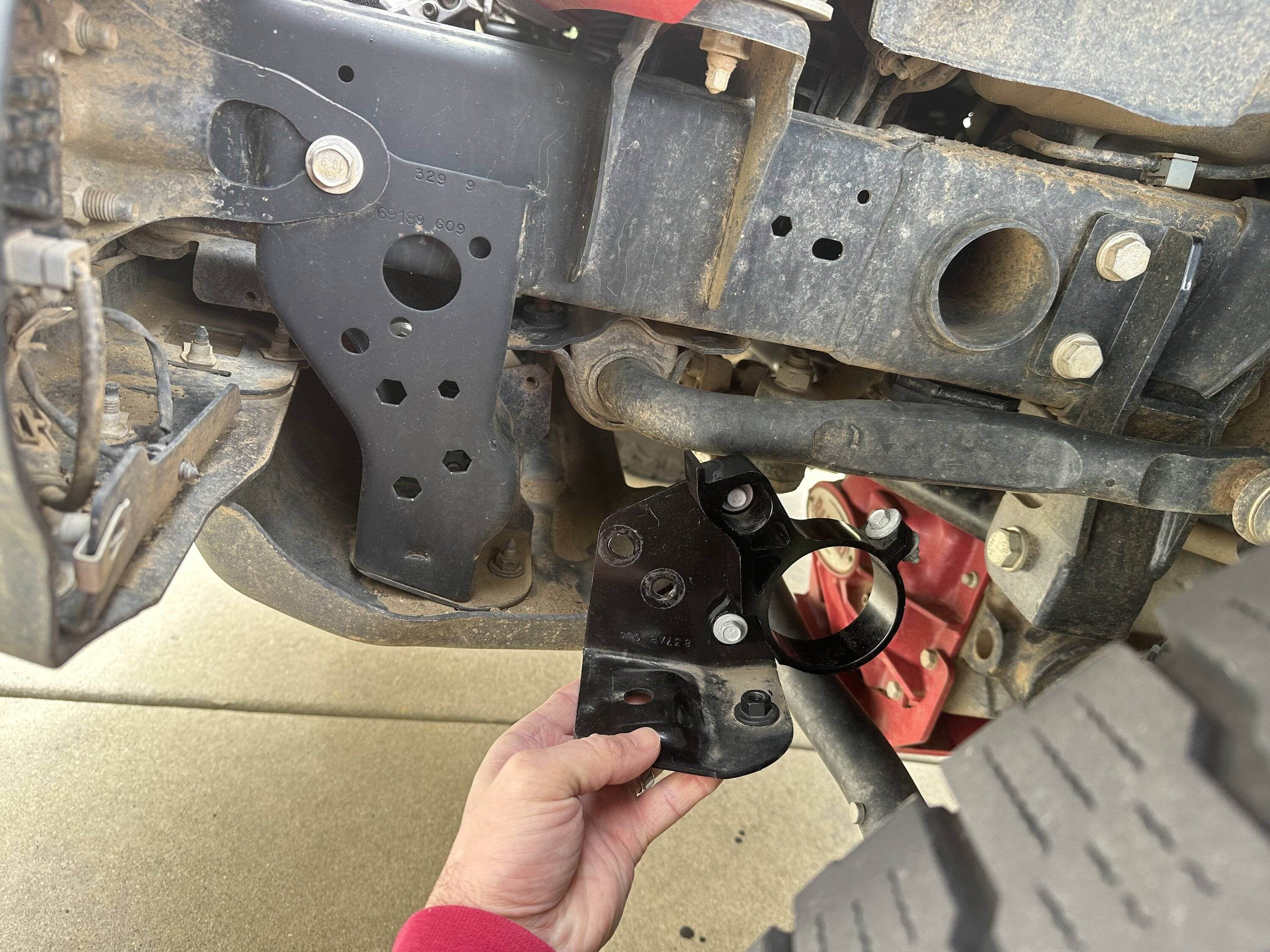

I just mounted some Mojave shocks on my rubicon. (Part of) The stock Mojave mounts fit just fine.
Are you sure the fox 2.5 have same size reservoir? I know the “2.5” part but might be slightly different; anyway, the reservoir mounts could probably adjust enough for a slight variation.
The Mojave brackets are two pieces, a horizontal part I believe goes between skid plate and frame horn; the vertical reservoir bracket can be used by itself with two m6-1.0 bolts, and at least on mine the nuts were already welded on back of the frame horn so I didn’t even have to source any nuts (the m6 bolts were provided with the takeoffs).
I didn’t want to unbolt my skid and have a janky fit, I just used the vertical brackets and seems perfect.
