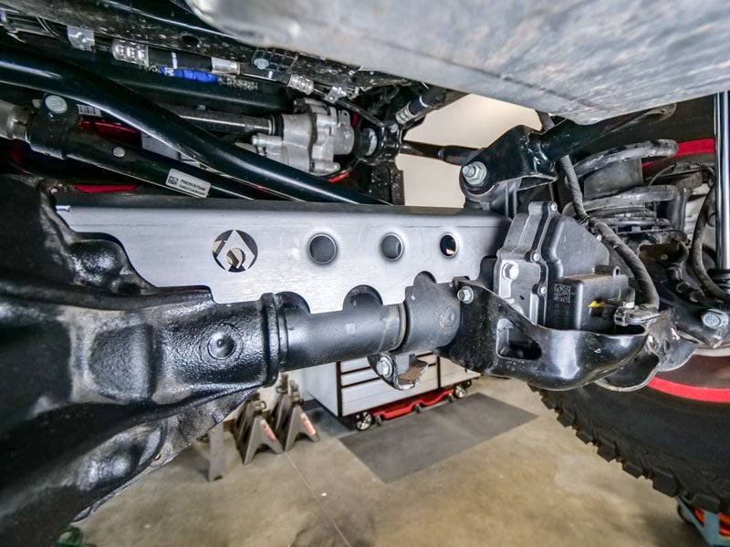

Artec - ~1/8” designed for strength and light weight:
Jeep Gladiator Front axle truss options IMG_3010
Barnes4WD - $80 3/16” says ~2” lift. Bridge over FAD
Jeep Gladiator Front axle truss options IMG_3013

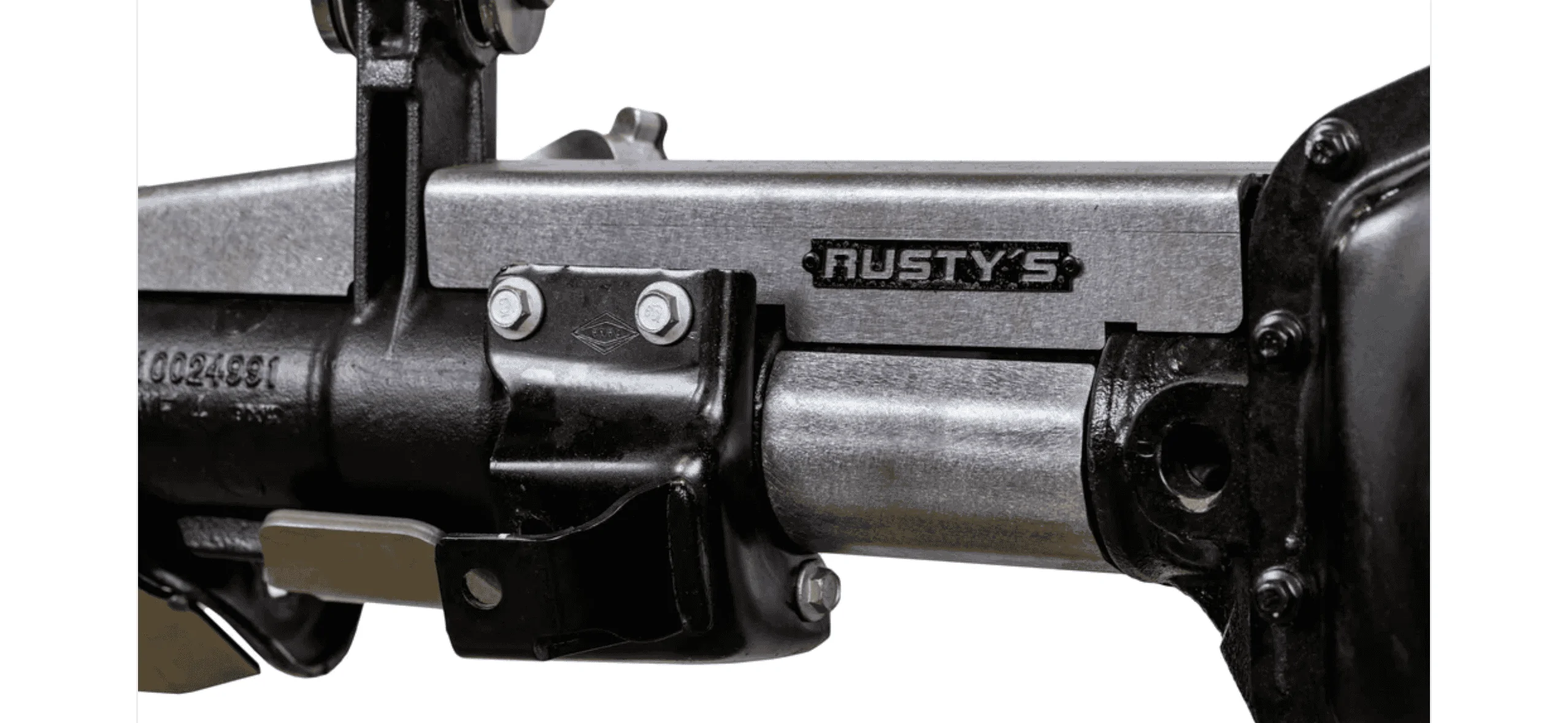

Rustys - $179 3/16”. collar under center axle tube, no lift description
Jeep Gladiator Front axle truss options IMG_3014

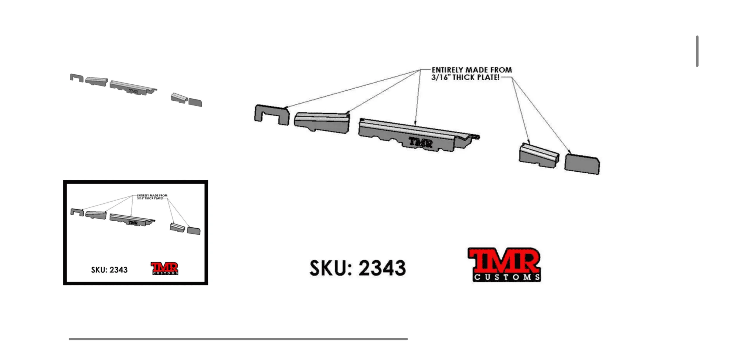

TMR customs - $119 3/16”. Says 1.5” lift
Jeep Gladiator Front axle truss options IMG_3016

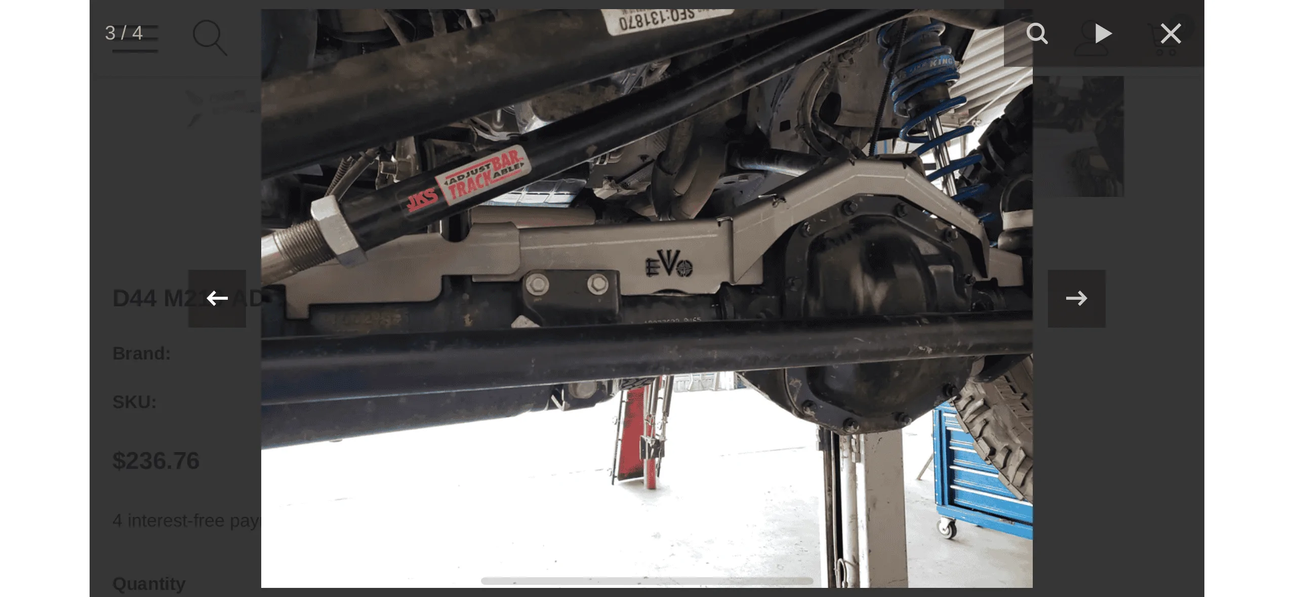

EVO - $169. I believe 1/4” (description is for C gussets.. full kit says 3/16 for gussets and 1/4” for truss). Hoop goes over diff, does not specify clearance.
Jeep Gladiator Front axle truss options IMG_3017

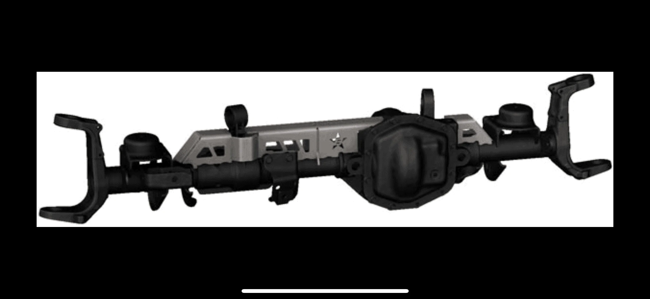

I'm bumped for full stuff and the slightest rub on the inner plastic fender on 38s and I think the Artec truss would crash into my oil pan on a hard hit. I have a friend that has one, so I may have to hit him up for actual installed dimensions.

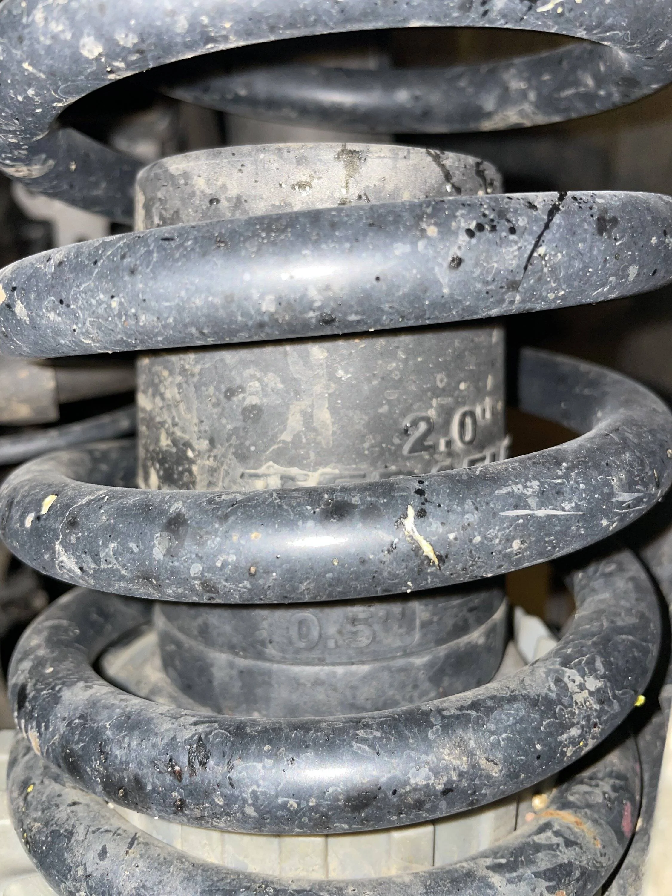

I think I have a total of 3” of bumpstop. Its what the teraflex install recommended and its at least 1” too much I come no were near rubbing or binding ifaict. When flexed out at the off road park there is quite a lot of room between axle/truss and oil pan. Idk where the amount needed would be but maybe the coil binds enough before it
3" may very well be more than you need to keep the tire out of the fender. The Tera coils are lighter/longer than I usually install on my builds, so they may very well bind with less bump. Just have to test and see.
I run 1" bump spacer combined with a Metal Cloak durospring front bump cushion which I think adds about 1" by itself.

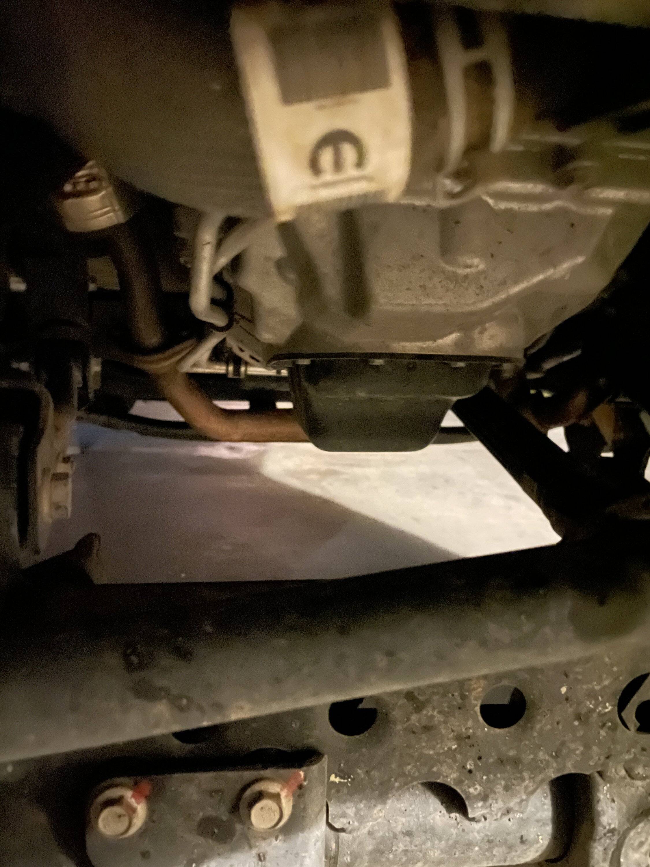

Also just to check does your pan look like this with the recess for axle to snug into?
Jeep Gladiator Front axle truss options 9D43C24B-27A8-45B6-9EE6-8269F69C4BDC

Ok makes more sense now I was trying to do the angles in my head and figure out how the axle move back far enough to contact the oil pan. So assuming with short arms the upswing caused by enough compression brings the axle back in enough to make this a potential issue? Would long arms help here in the sense that would have less of an effect of axle moving back on up swing? Good thread learn new things everyday.

My truck is diesel, so different pan, but it does have a rounded notch to help clear the axle tube. From the pics I could find online of the installed Artec truss combined with some measurements on my own truck, it was closer than I wanted to guess on.

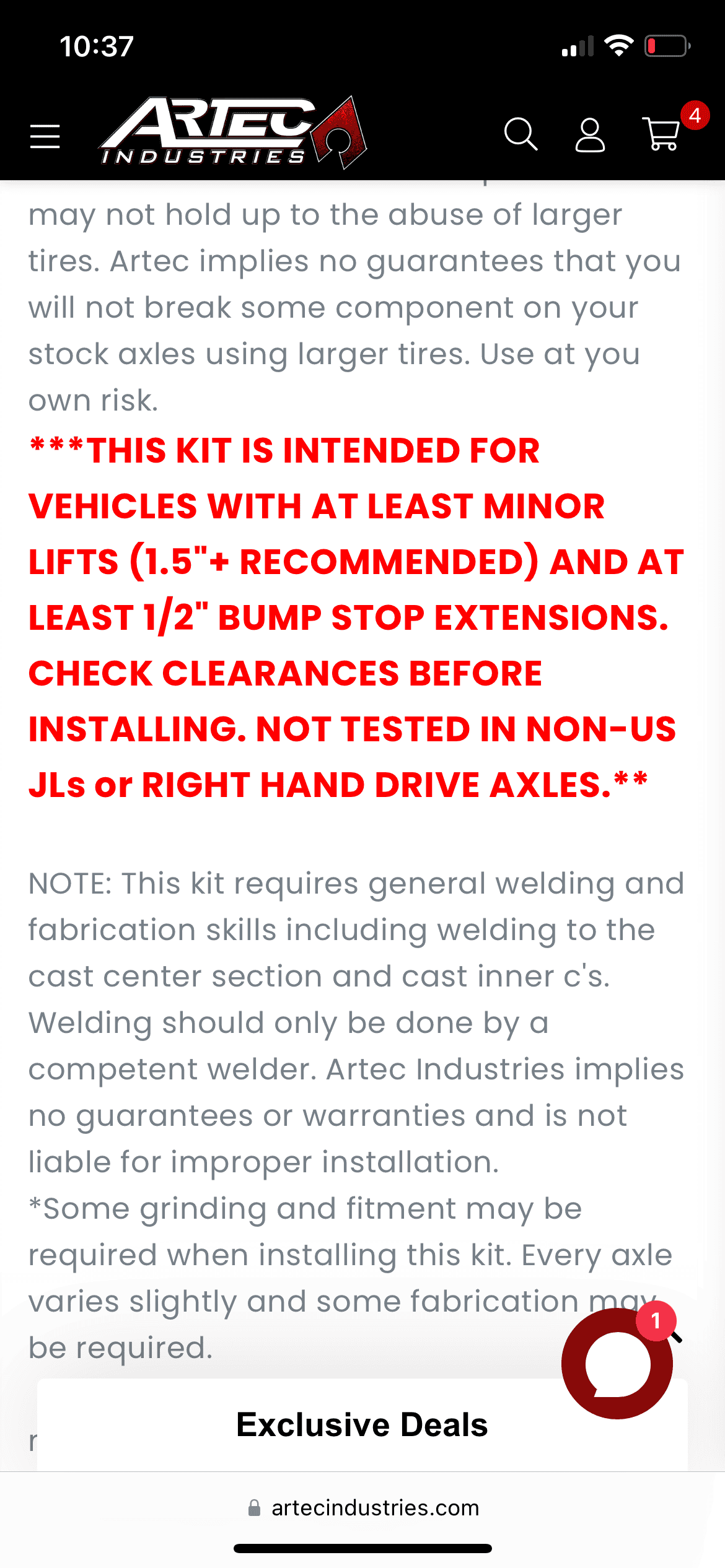

because I have the artec wanted to do some research seeing I can’t sleep worrying about blasting my oil pan ?
looks like they have some basic reqs which are 1.5” of lift and 1/2” of bumpstop. So I reckon with what @CrazyCooter is already running you’ll exceed those both. It says JL but this is from the JT page assume its same for both.
The amount of lift is kind of irrelevant, but the actual bump travel vs oil pan clearance is whats important. Again, the gas, diesel, XR, and 392 frames all have different length bump stop tubes and bump cushion configurations. Then the Mojave has the air bumps. I could only assume this was done because of actual axle to oil pan clearance.
