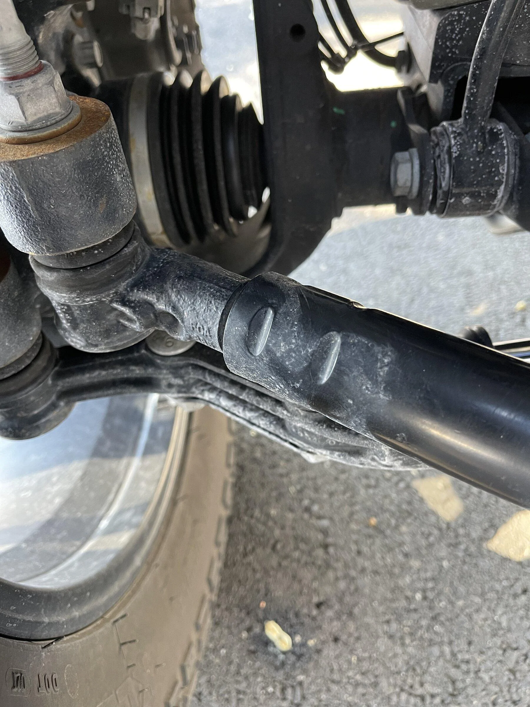

That is exactly what I did. I sent the clip to the owner of the dealer I bought it at. First go around they said there was no issue. I give them they had Covid shortage, whatever. He responded right away and got me in in a day so I’m all for giving them the chance to work on it and hopefully it rides like it did when I got it. I actually loved the ride for the first 2k miles and then the whole thing went haywire. I’ve chased tires ideas and a few other things and no fix. Place I got the wheels and tires do service as well and the one mechanic, who has a Jeep, found that issue.
Dealer says it’s not right and they will replace it and check everything else out so I can’t ask for more at this point so I will see how it is when they are done with it.

I would also insist that they put a torque wrench on every single bolt that's suspension or steering related. I did this myself and found a lot of it loose, especially my ball joints and steering gearbox bolts.
