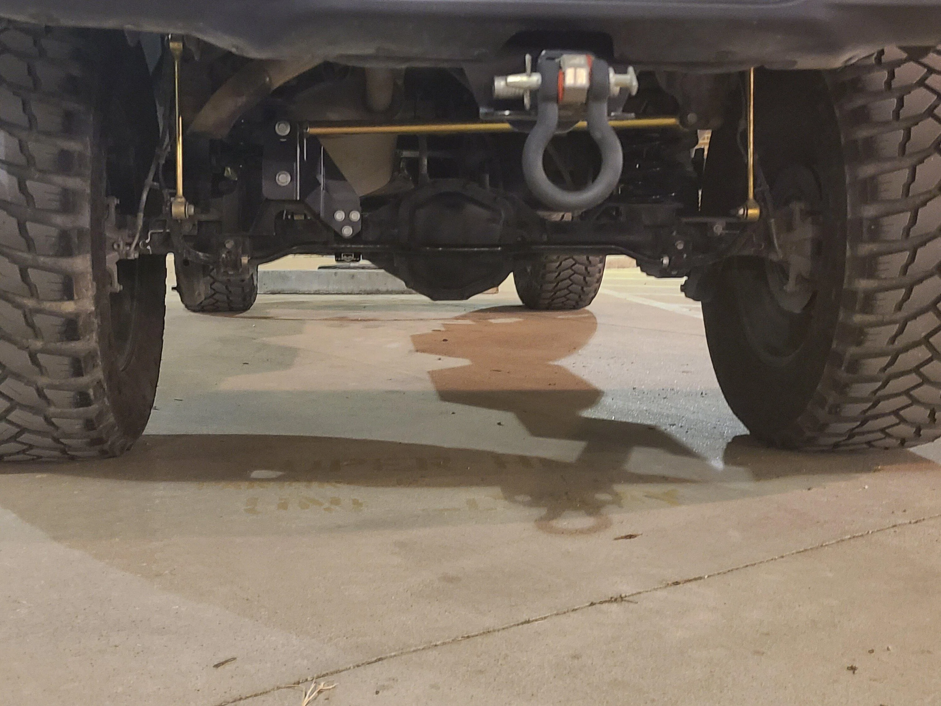

Didn't read every single reply. But did you upgrade your rear sway bar? I have the helwig I get no bounce.
