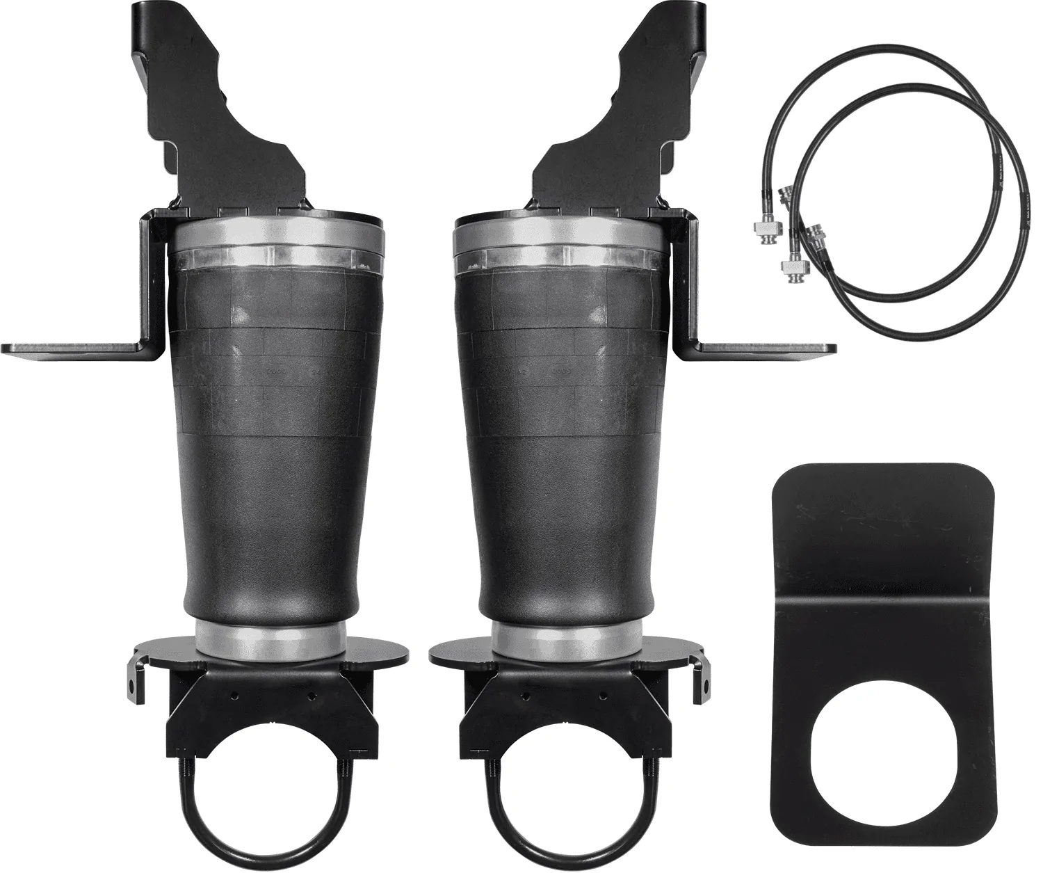

On a 4" lift spring?
Yes, the interesting thing about the way they engage the airlifts on our jeeps, you can use the small airbag that comes for stock height with the taller springs. It will stiffen the portion of the spring it engages with. It doesn't touch both top and bottom even on stock suspension.
A taller bag would be ideal, and a trailer shop might be able to help you get a set of airbags that fits better, or you might be able to order them from one of the airbag companies. You would just need to build your own kit.
