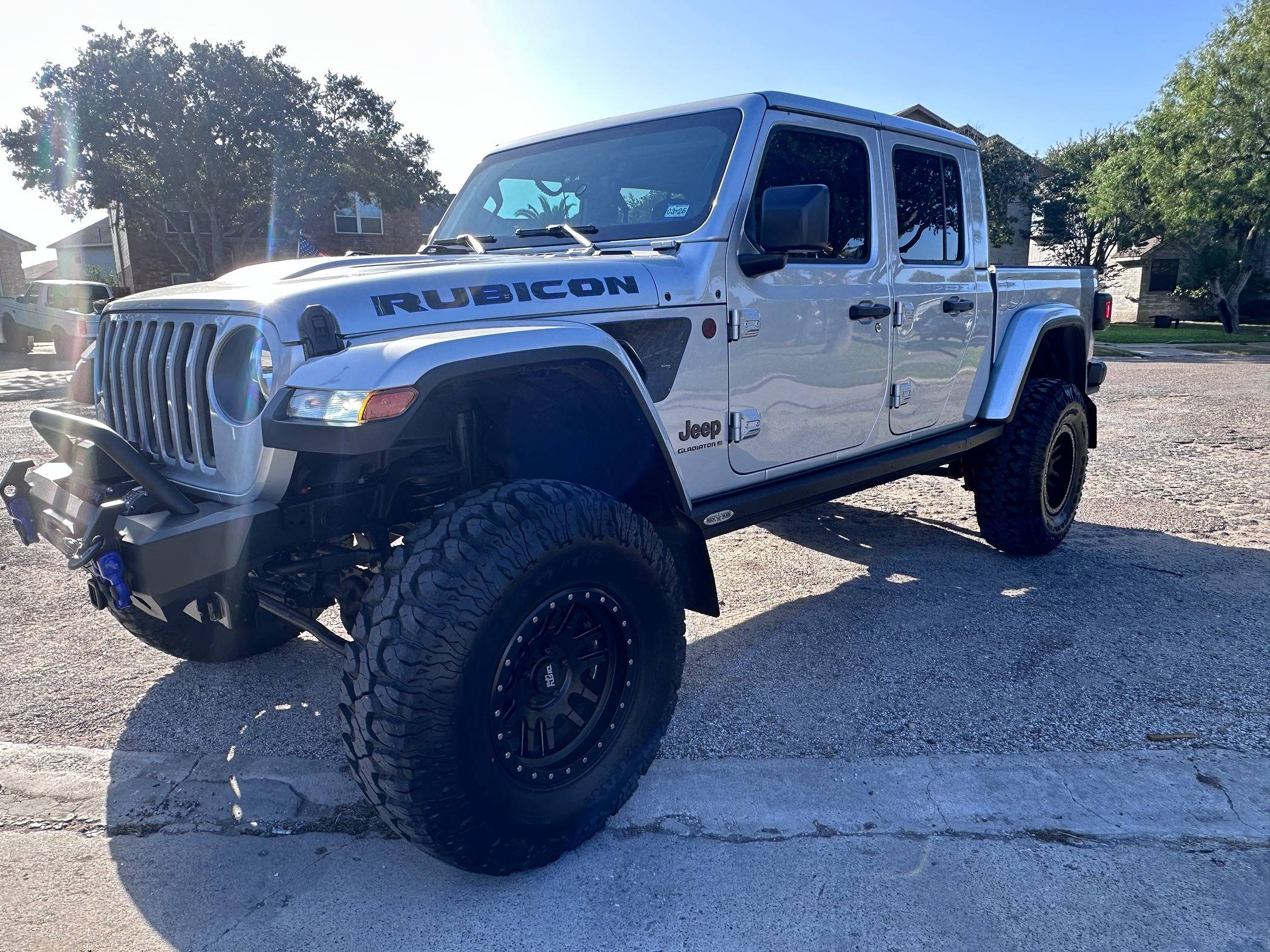

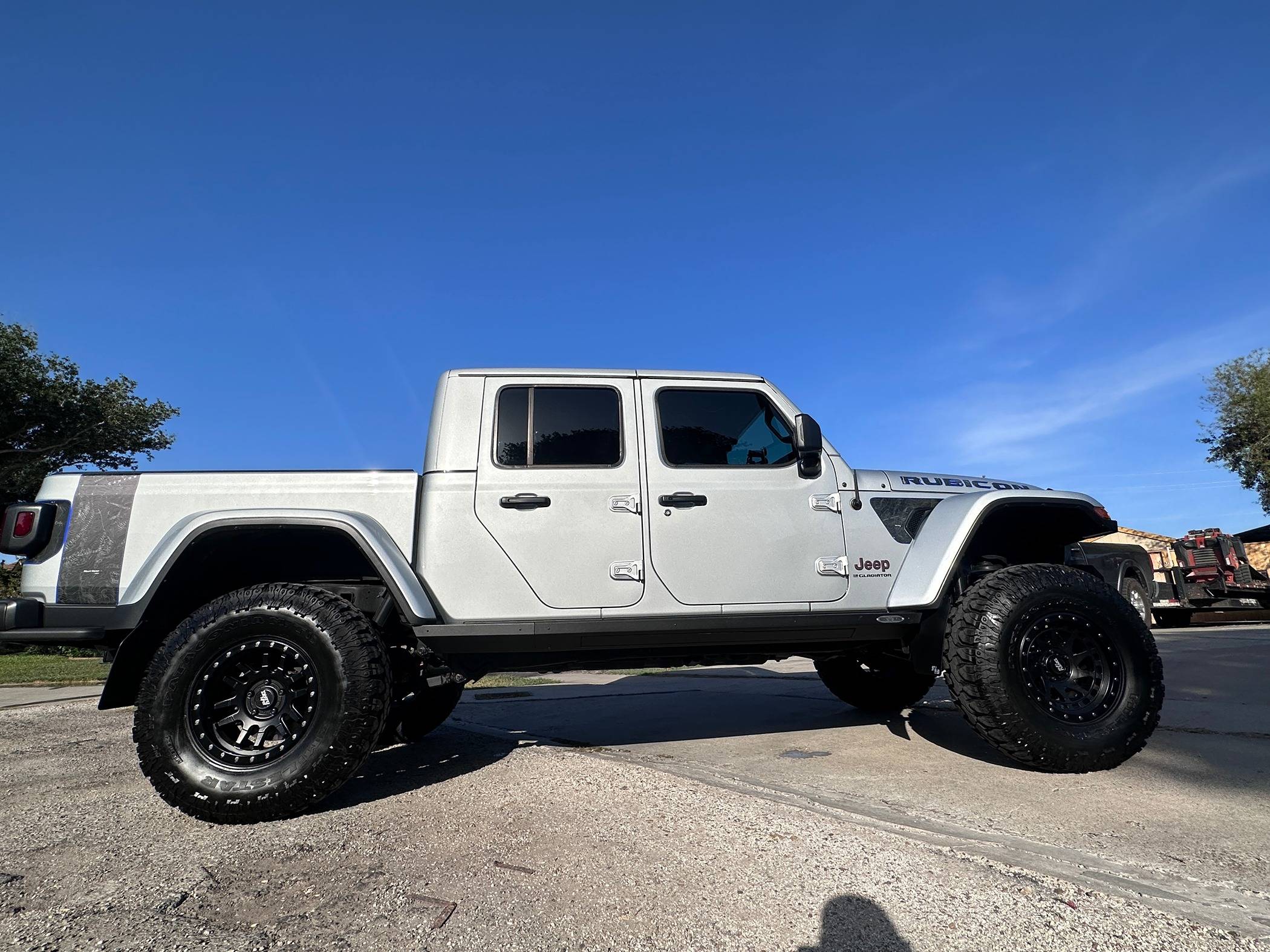

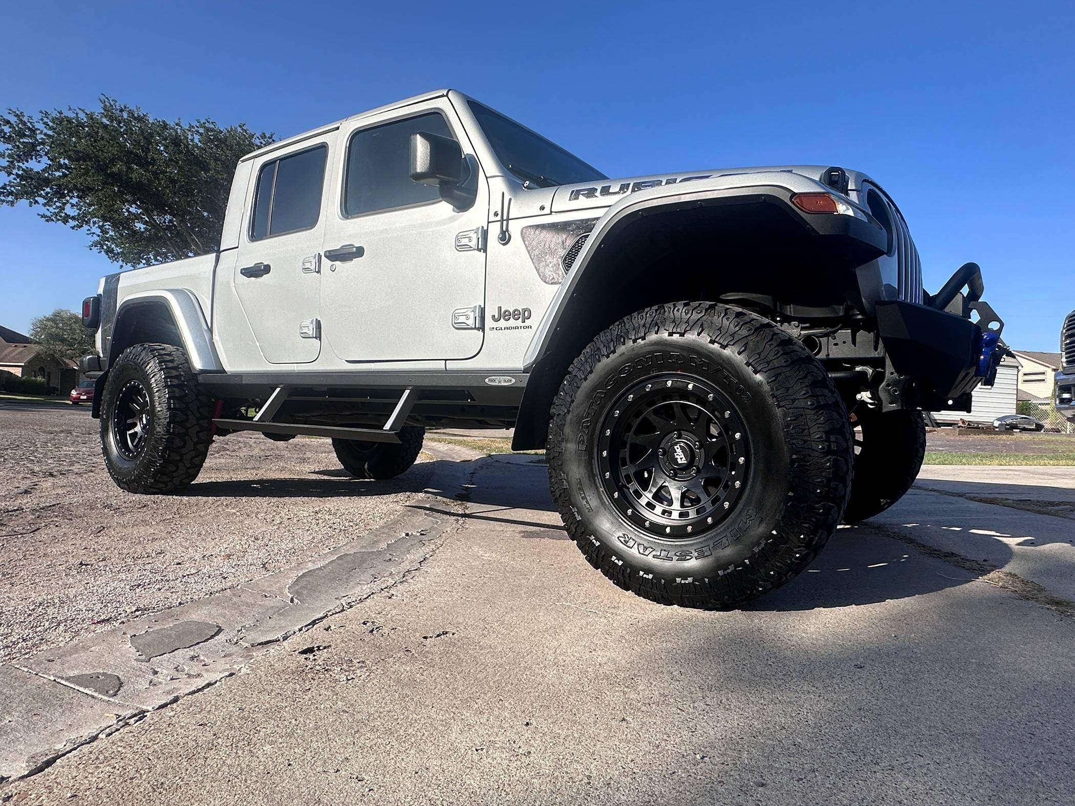

I put a 4.5" lift on my 2023 rubicon with 37/12.50.17 and had it alignment done by the only 4x4 shop here and now i have a pretty bad chunking noise in the front if I get above 15 mph in 4x4 I'm sure the pinion angle is the problem. Any ideas?? I've never done any alignment stuff my self not that i can't just need to know what and how to do it. I have every tool known to man.

I installed a full 3.5" clayton overland lift with full control arms and both track bars, new shocks, Falcon Shocks Nexus EF 2.2 Steering Stabilizer, synergy front track bar sector shaft brace front bumper and 13,000# winch and 5.13 gears. When i got the kit i went with claytons HD rear springs being i carry a loads sometimes which the springs ended up being 1.250" taller than the regular non HD springs that comes with the kit. So without a load in the bed the the front was way to low for my liking. So i added a 1" spacer to the front springs to get it back to some what level just a little lower in the front around 3/4"+/- which seems to be about right. So that put it at a 4.5" lift to the best of my math skills which i like the look. But i also don't have a lot of confidence in the company that aligned it either!! I would like to get rid of the spacer and find springs that are the right length any ideas on what springs would work as well. For as where i tested it was on my ranch RDs both dirt and rock rd as to why i went with the HD spring I carry a lot of deer feed at times. I travel over a ton of dirt RDs on 50,000 ac ranch.. Thanks for any help
Jeep Gladiator Front end noise when in 4X4 IMG_4605
Jeep Gladiator Front end noise when in 4X4 IMG_4606
Jeep Gladiator Front end noise when in 4X4 IMG_4596
