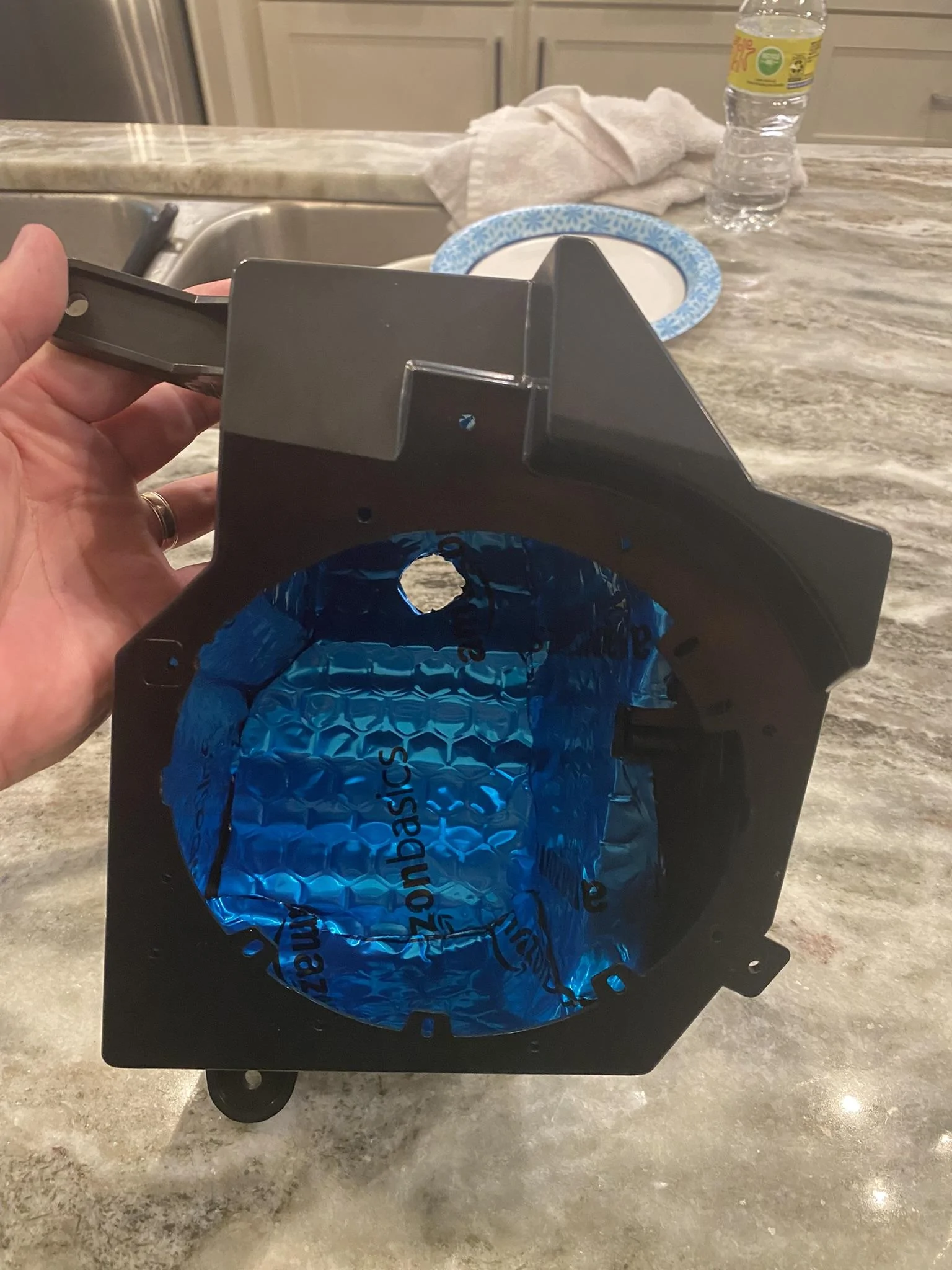

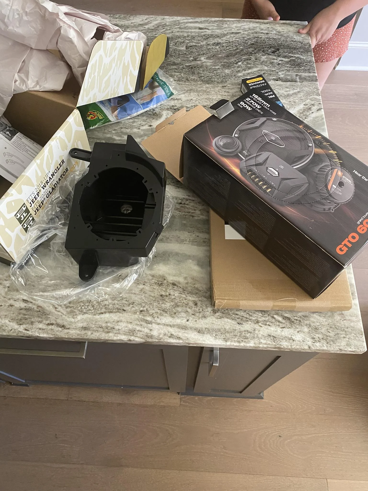

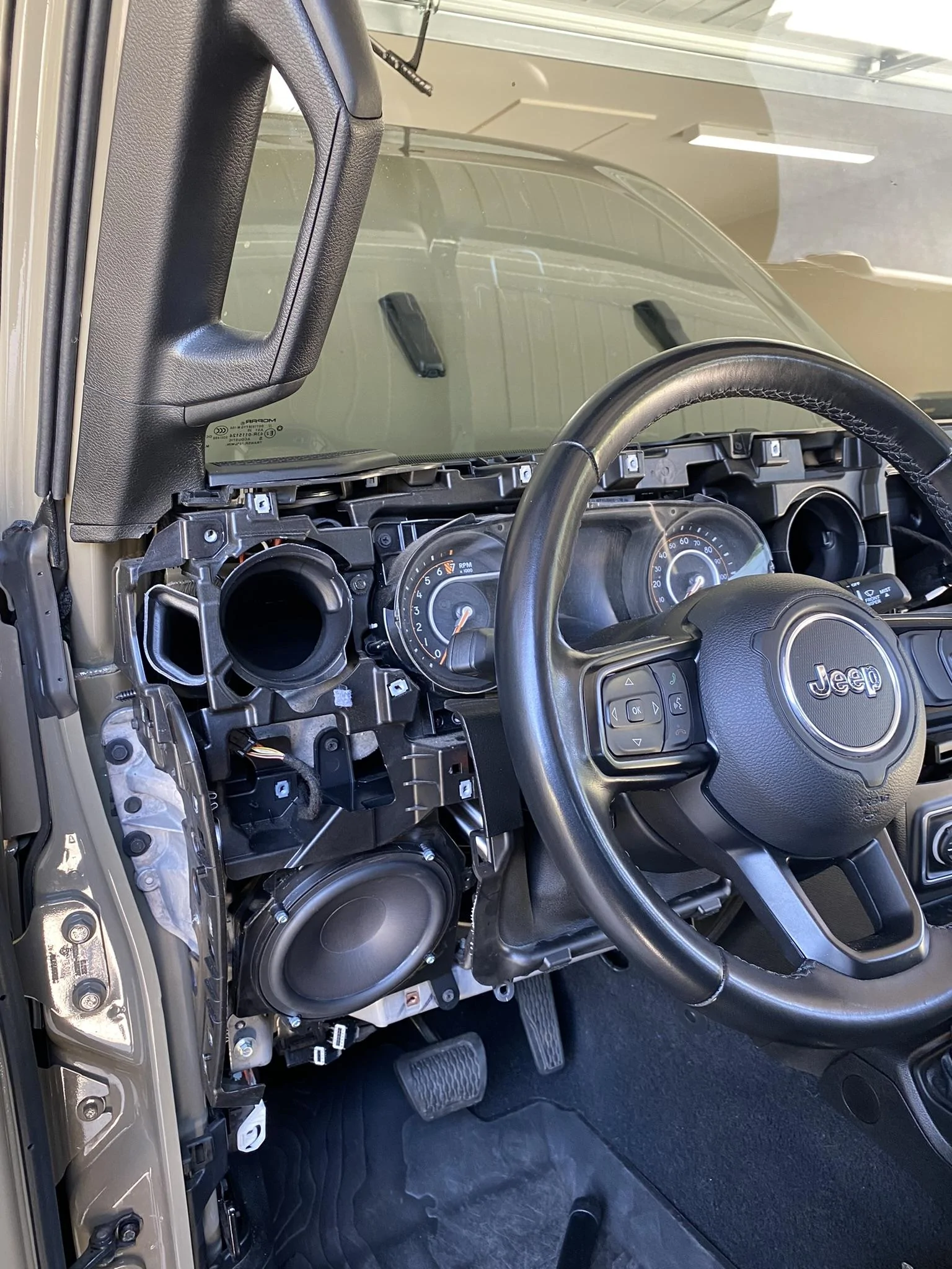

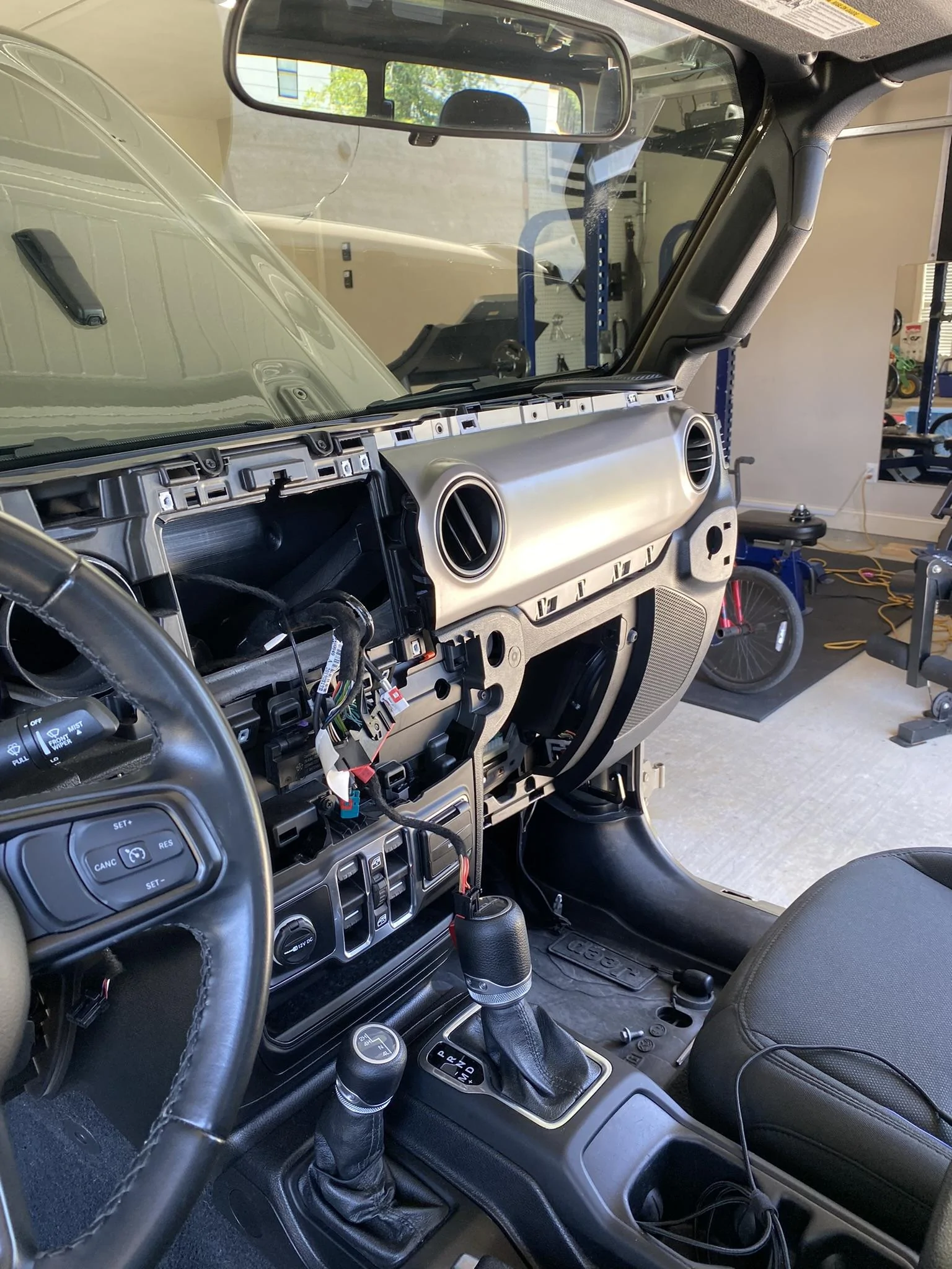

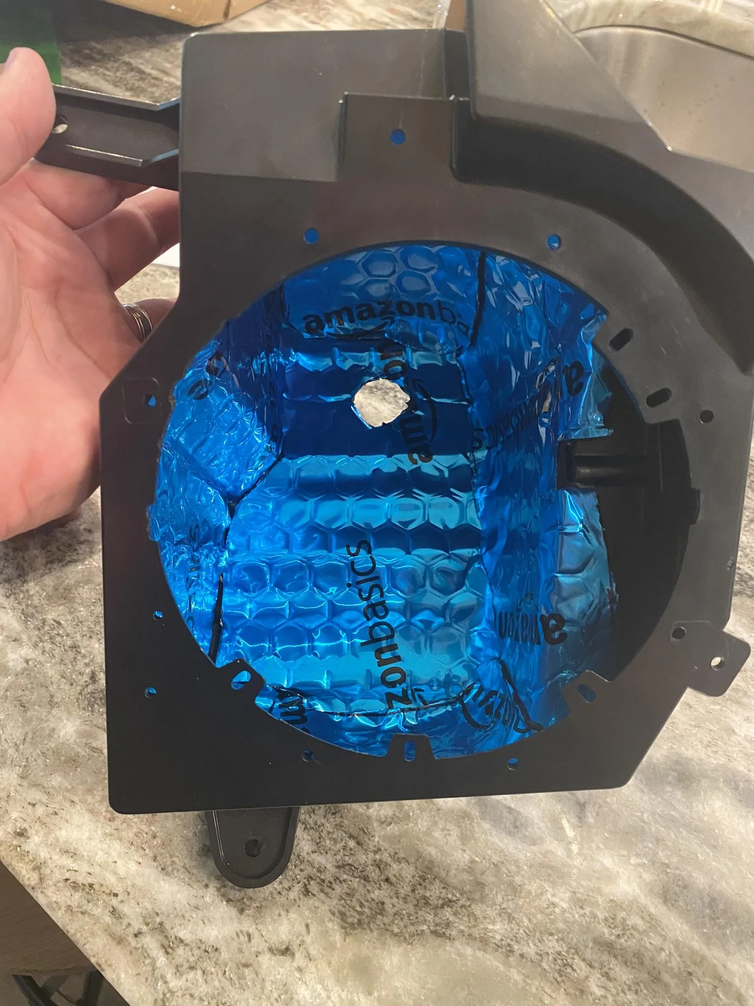

I put some jbl 6.5’s in there , I put sound deadening material and baffling inside.
What’s weird is the factory speakers are ported to the front .. Metra pods are not ported. I also took black window caulk and sealed around the whole Metra pod to make sure I had no air leaks. On the back you have a rubber gasket that about 1.5 inches in diameter . Sometimes I reach my hand back there and take it .. I’m undecided if it sounds better ported or not.
