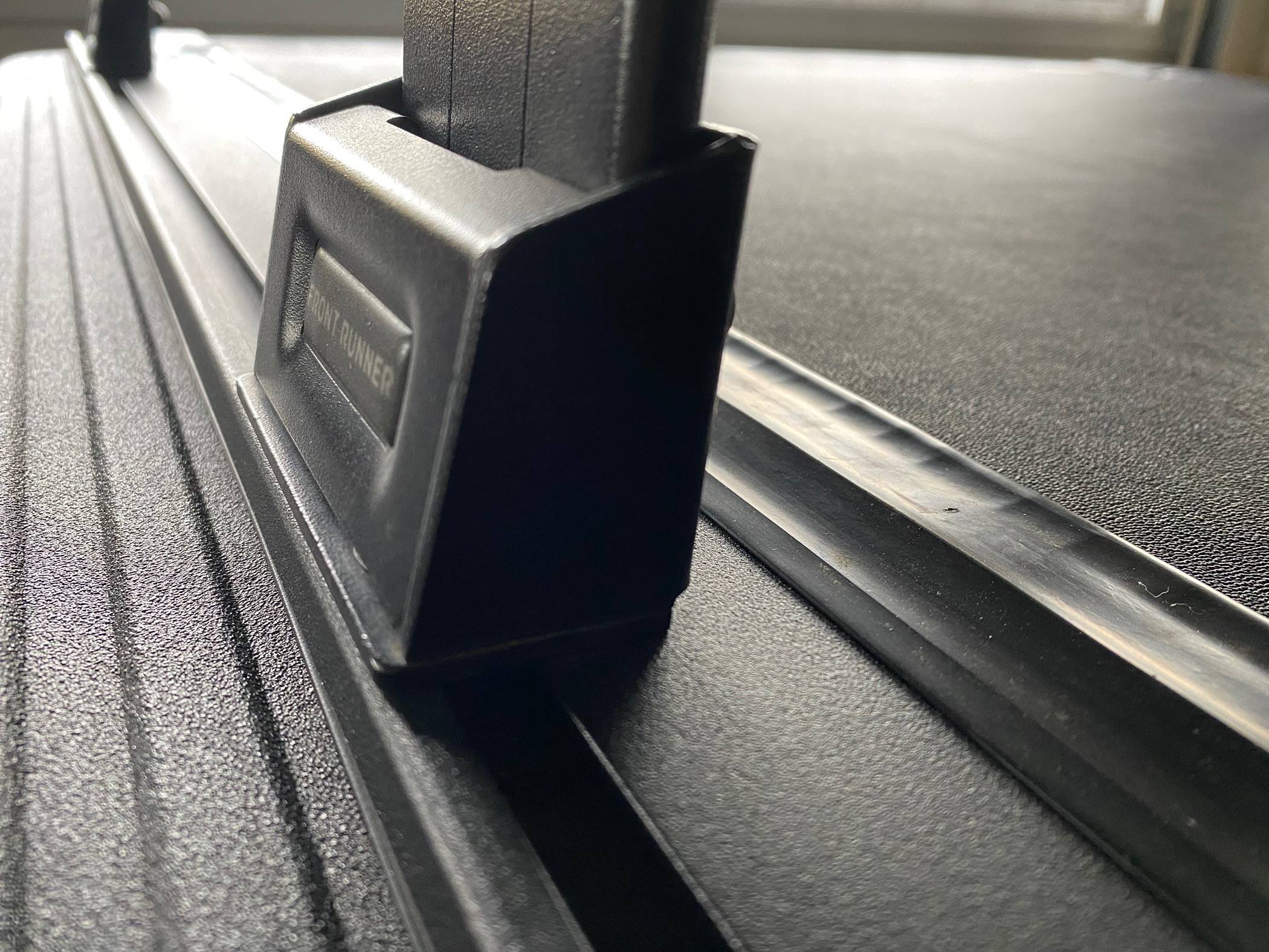

If you zoom in, you will find the feet installed in this manner:
Jeep Gladiator Frontrunner Slimline rack with Bak X4s IMG_3078

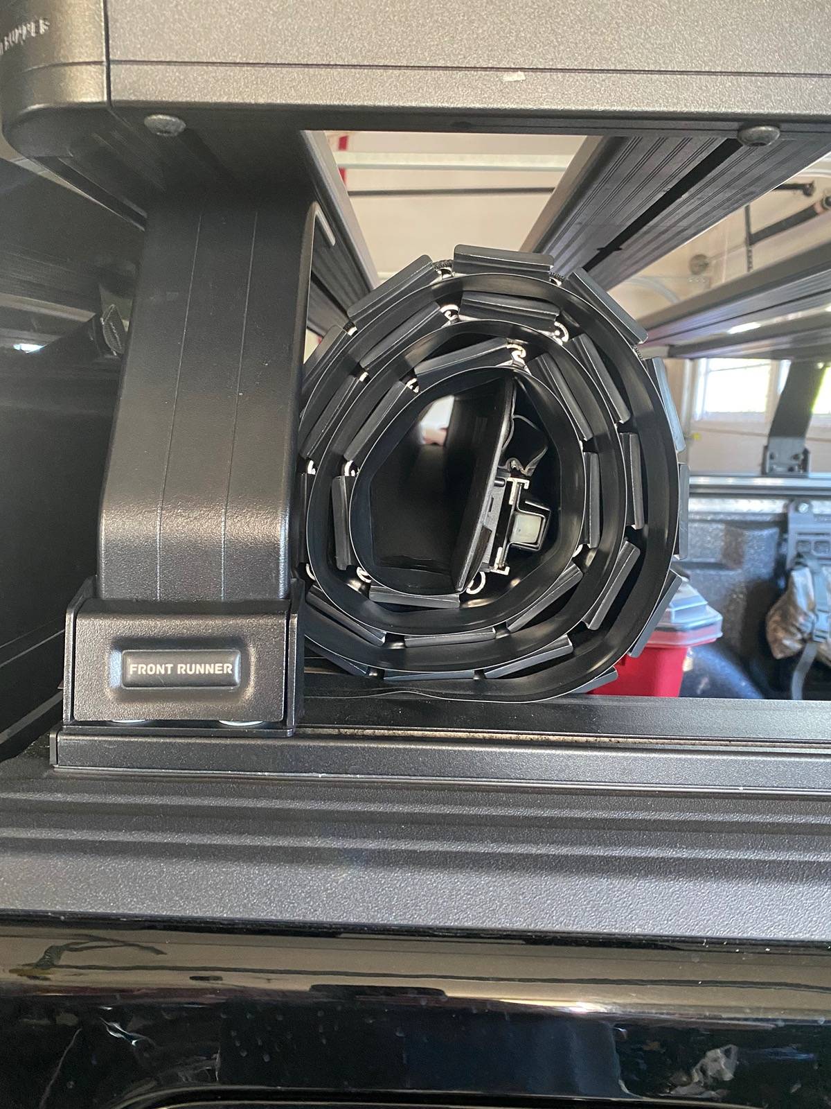

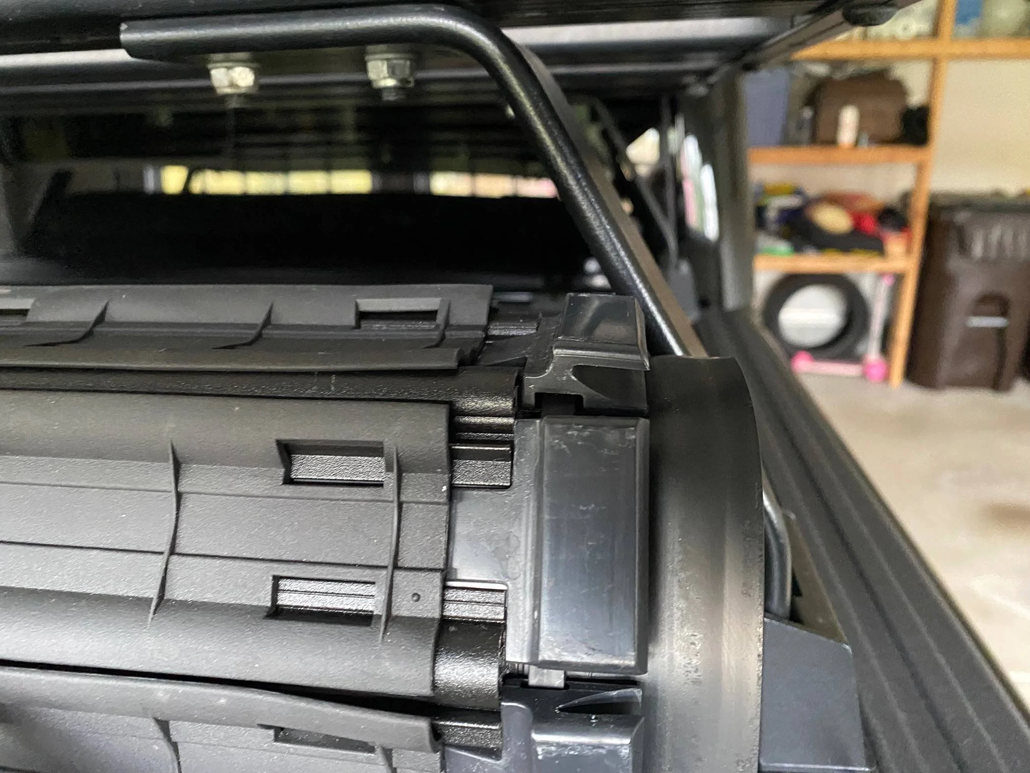

the problem with that is the Bak cover won’t go past the second set of feet, as shown here:
Jeep Gladiator Frontrunner Slimline rack with Bak X4s IMG_3079
Jeep Gladiator Frontrunner Slimline rack with Bak X4s IMG_3081
I sketched out a lot of ideas about creating taller feet, longer legs, or even trying to bend these legs in a bench vise to straighten out some of the way they angle in. Fortunately I thought about it a lot prior to making any of those changes because the light bulb above my head finally lit a little brighter and it turns out simply reversing the feet works perfectly.

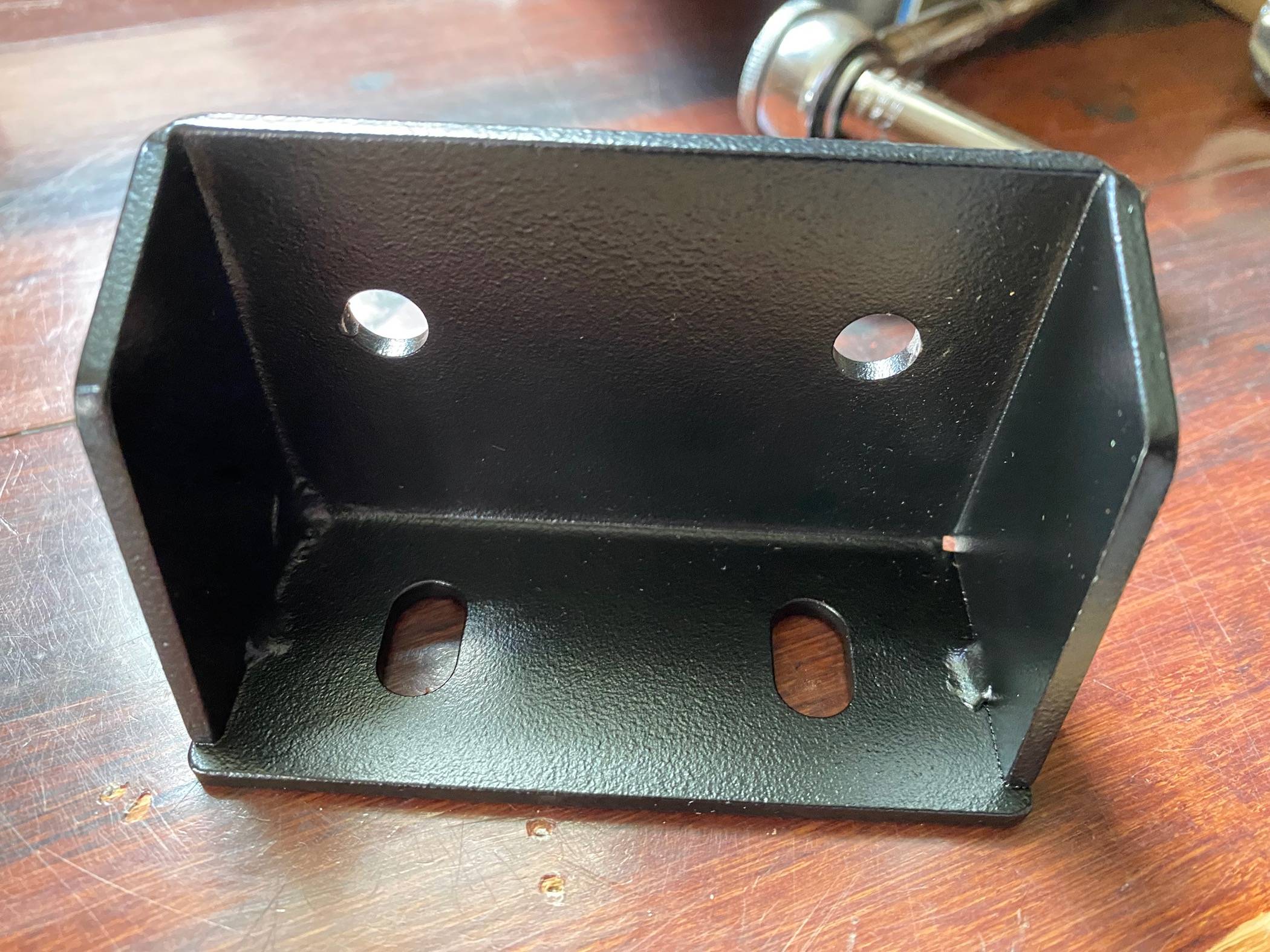

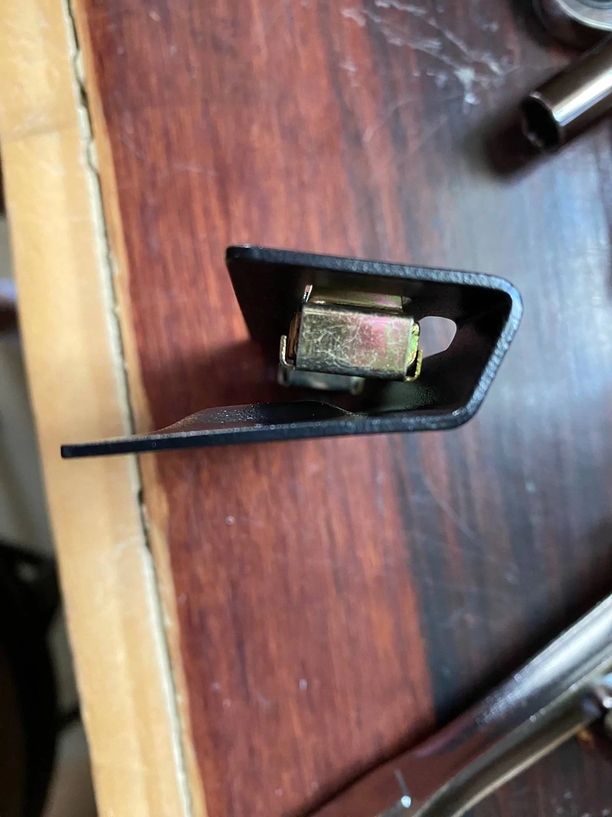

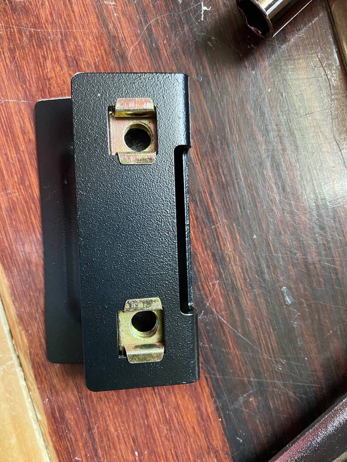

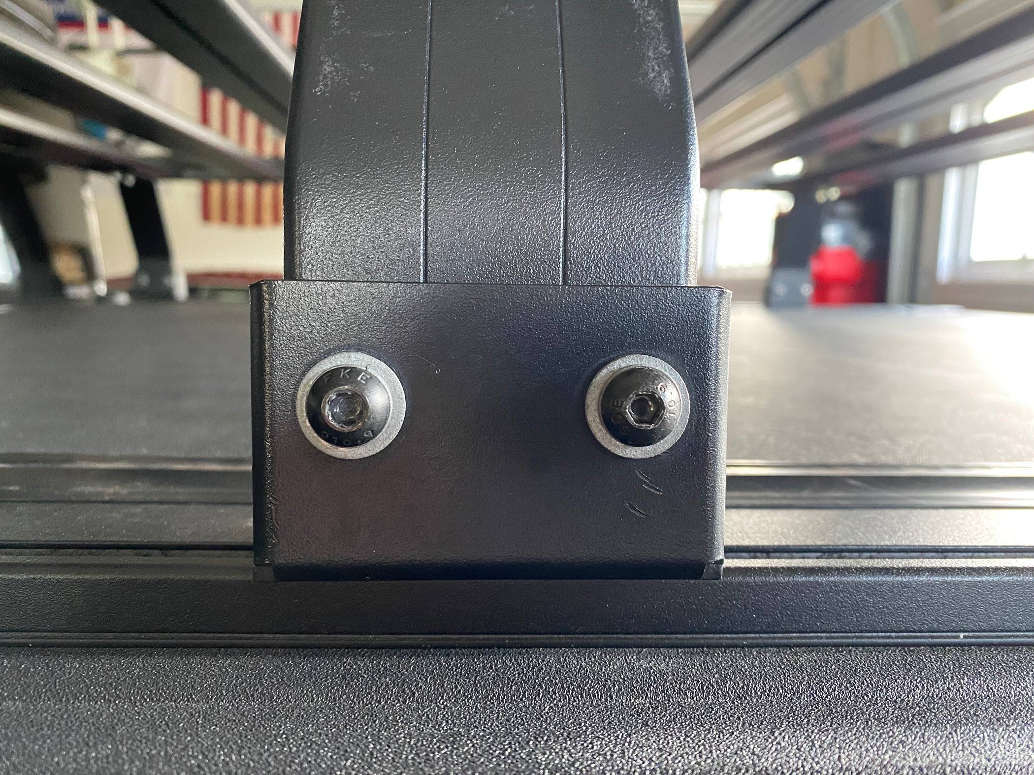

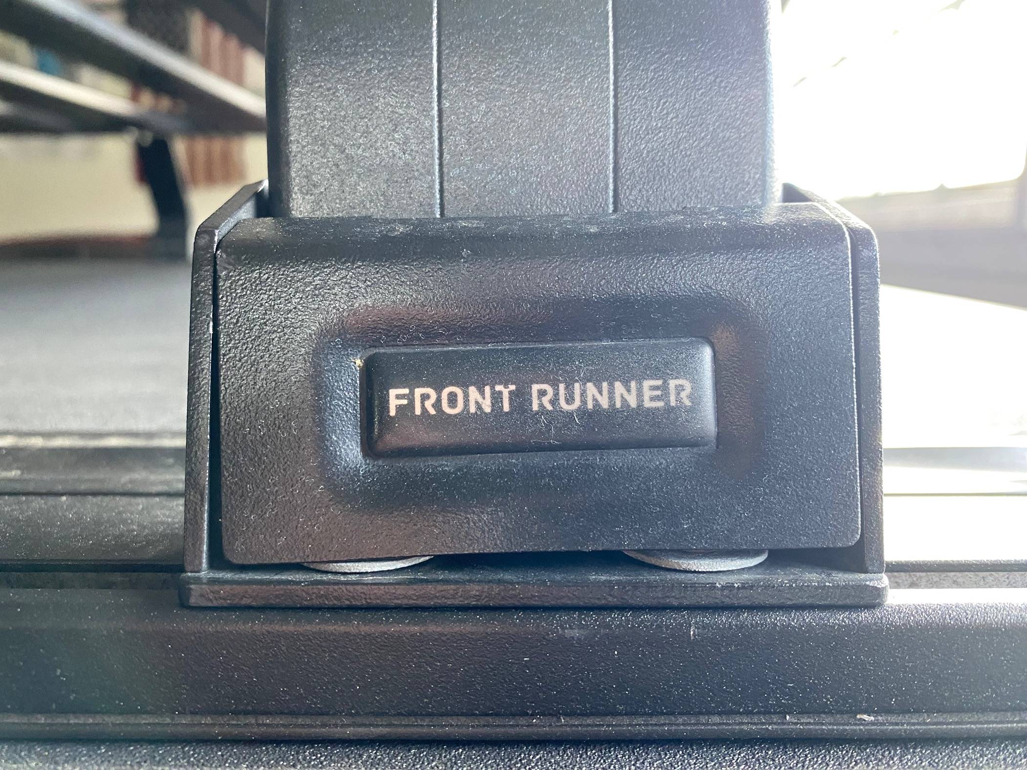

I’m not crazy about the little cover on each foot with the nuts captured in it because I can see it trapping water.
Jeep Gladiator Frontrunner Slimline rack with Bak X4s IMG_3100
Jeep Gladiator Frontrunner Slimline rack with Bak X4s IMG_3101
Jeep Gladiator Frontrunner Slimline rack with Bak X4s IMG_3102
I’m thinking I will just leave that cover off and use the open bracket, using nylock nuts to secure the leg. Despite going to multiple stores last night, I was unsuccessful finding the nuts and bolts in black stainless steel, so I had to order them. When I get the new hardware I will throw some additional pics in here of the finished product and also show the clearance between the cover and rack with the cover rolled up.

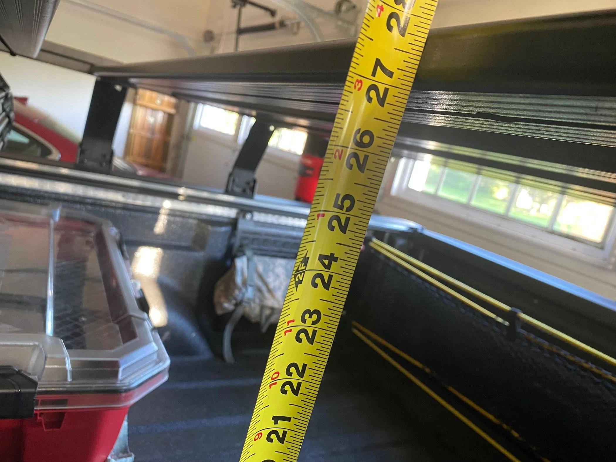

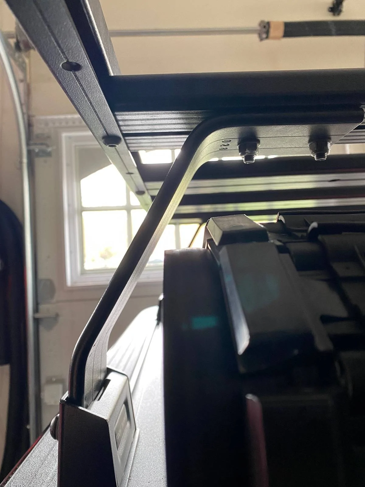

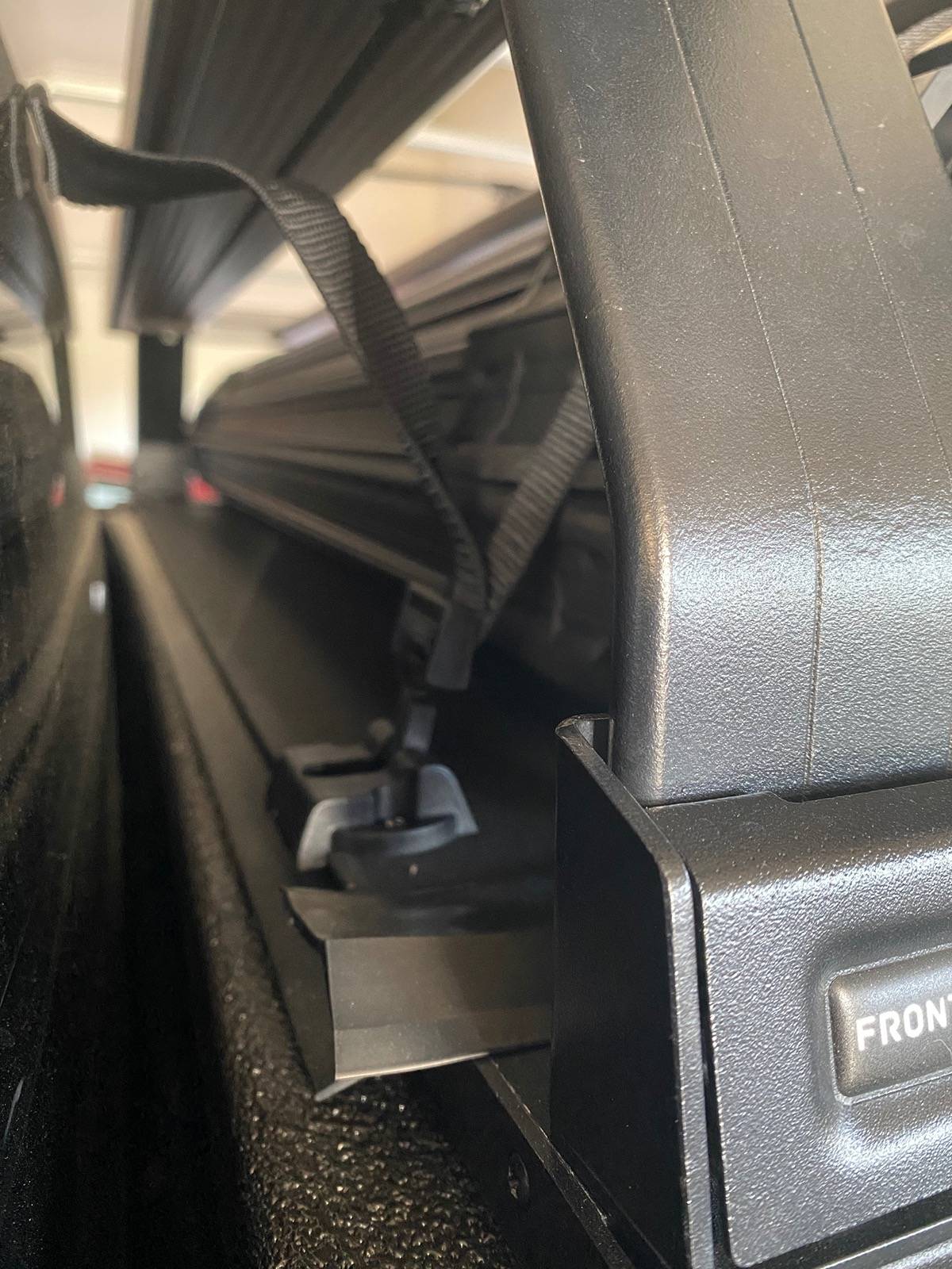

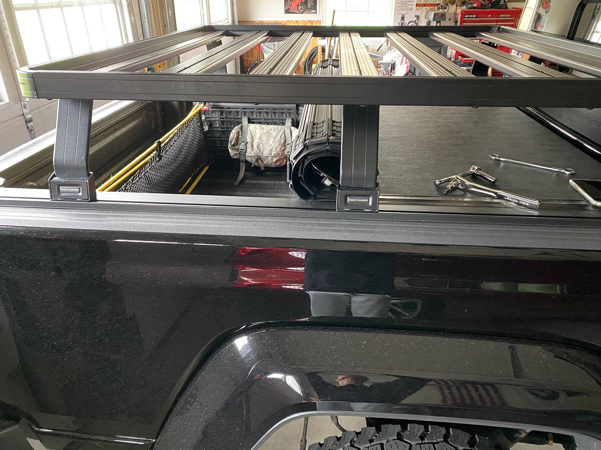

A couple pictures as promised. I did not bother reversing the front brackets because the cover rolls almost all the way up to the cab (see pics below) and it seemed like a lot of work for very little reward.
A couple measurements that I thought some might find useful:
-floor of bed to bottom of rack = 27”
- top rail of bed (or top of closed cover) to bottom of rack = 9”
