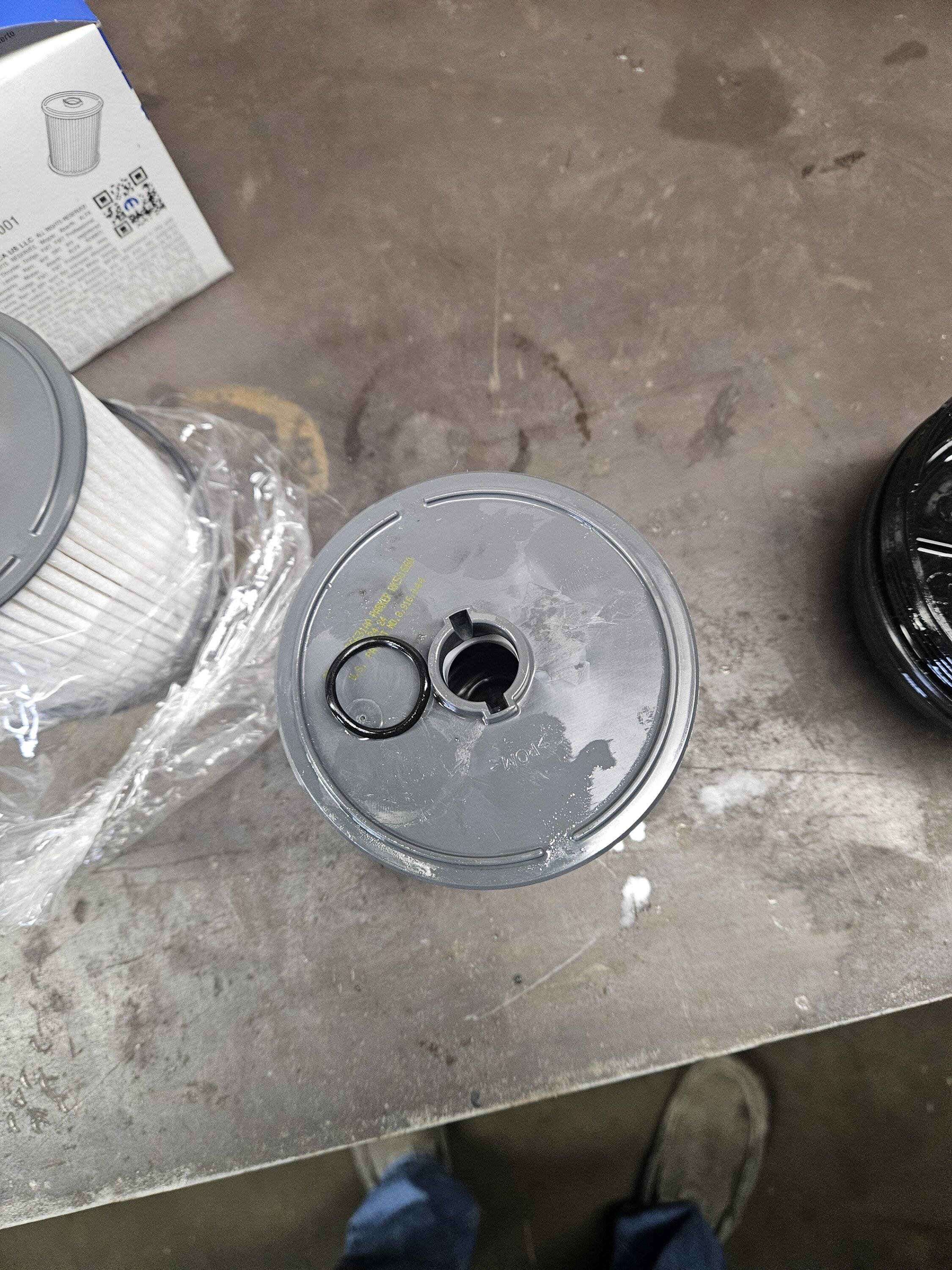

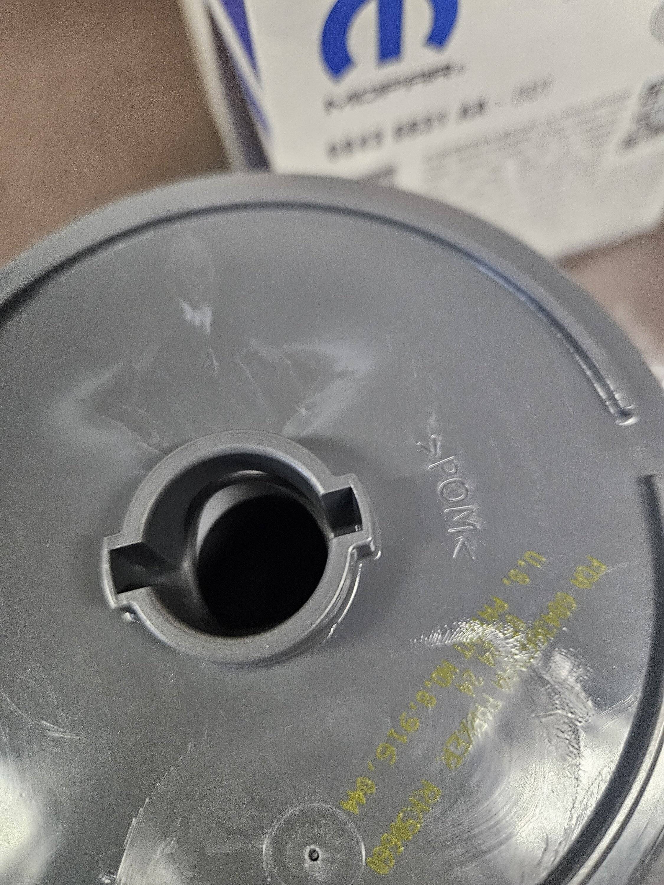

Changed the fuel filter today. Got the old one out and pushed the new one in place. Something don't feel right. So I removed the new filter. Found this o-ring sitting on top of the filter. Where does it go to? It goes in the top of the filter. It was in the new filter. I must have dislodged it when I removed the filter. It's a pita to put back in place.

Good catch.
How did your old filter look and how many miles on it?

Old filter looked good. No metal participles on it. It's got about 14,000 miles on it. Bit over-do. LOL
