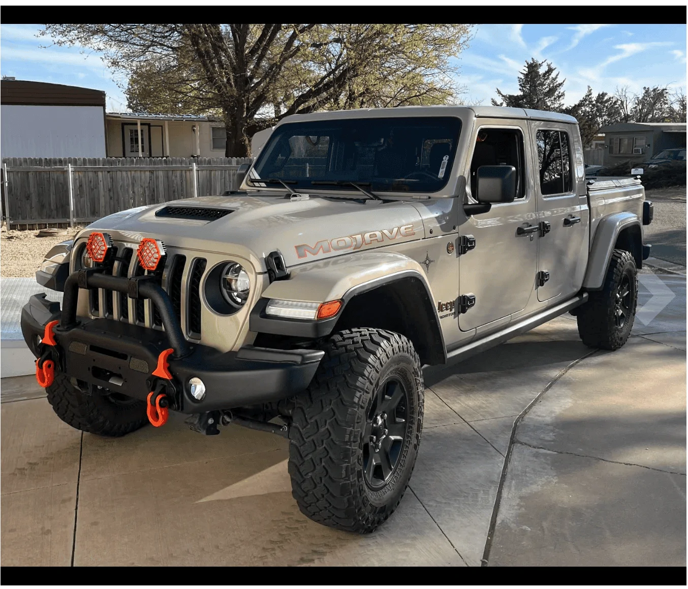

Anyone know the brand and model of this bumper?

I like it, but it looks like they lost the skid plate.
I like any bumper that doesn't have the maker's logo laser cut out of it.

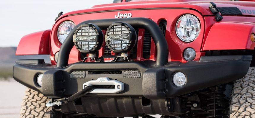

AEV built for a JK.
Probably put on with brackets.
I have one sitting in my yard. I didn't know that it could be mounted to the JT. I need to figure out what's needed.

That bumper looks so good on the JT.

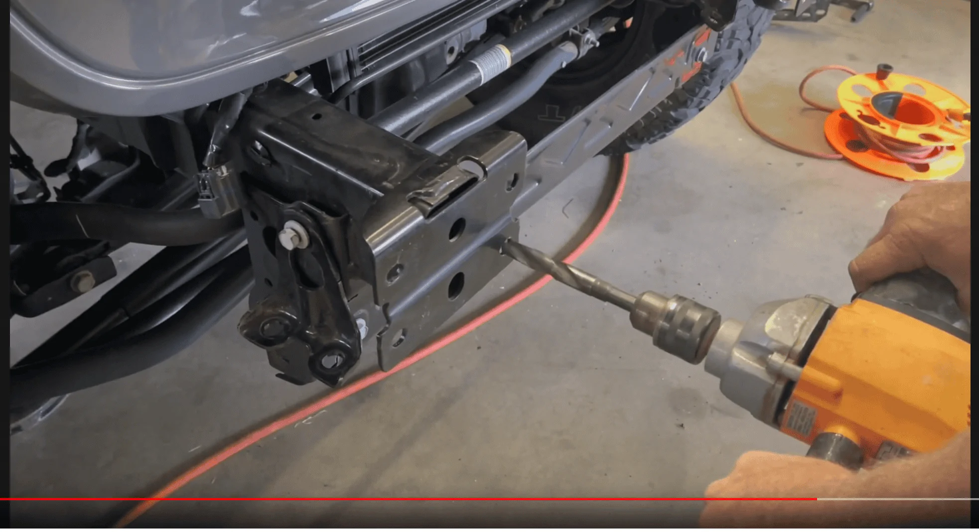

AEV built for a JK.
From what I can remember, they more or less bolt up. Just need to make one hole larger on the frame side, but the dimensions are pretty much the same.
Do you happen to know if the winch plate works as well?
That I'm not sure about, most videos that I've seen people only mention fitting the JK bumper. I know that the most common issues that people have with any winch plate is it contacting the Rubicon's electronic sway bar motor.
I'd say test fit it, if there's any clearance issues, I bet they can be solved with an angle grinder/cutoff tool.
