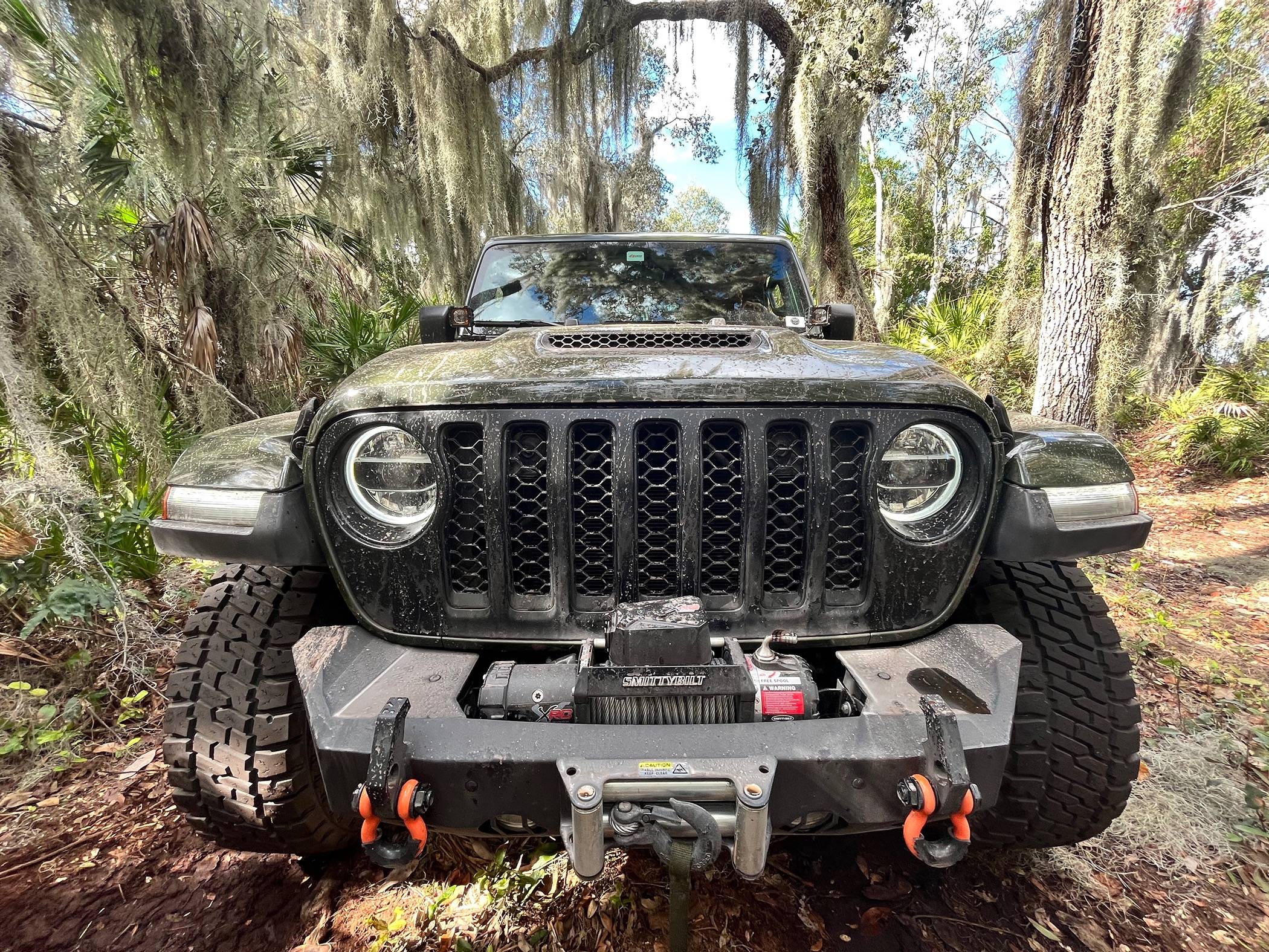

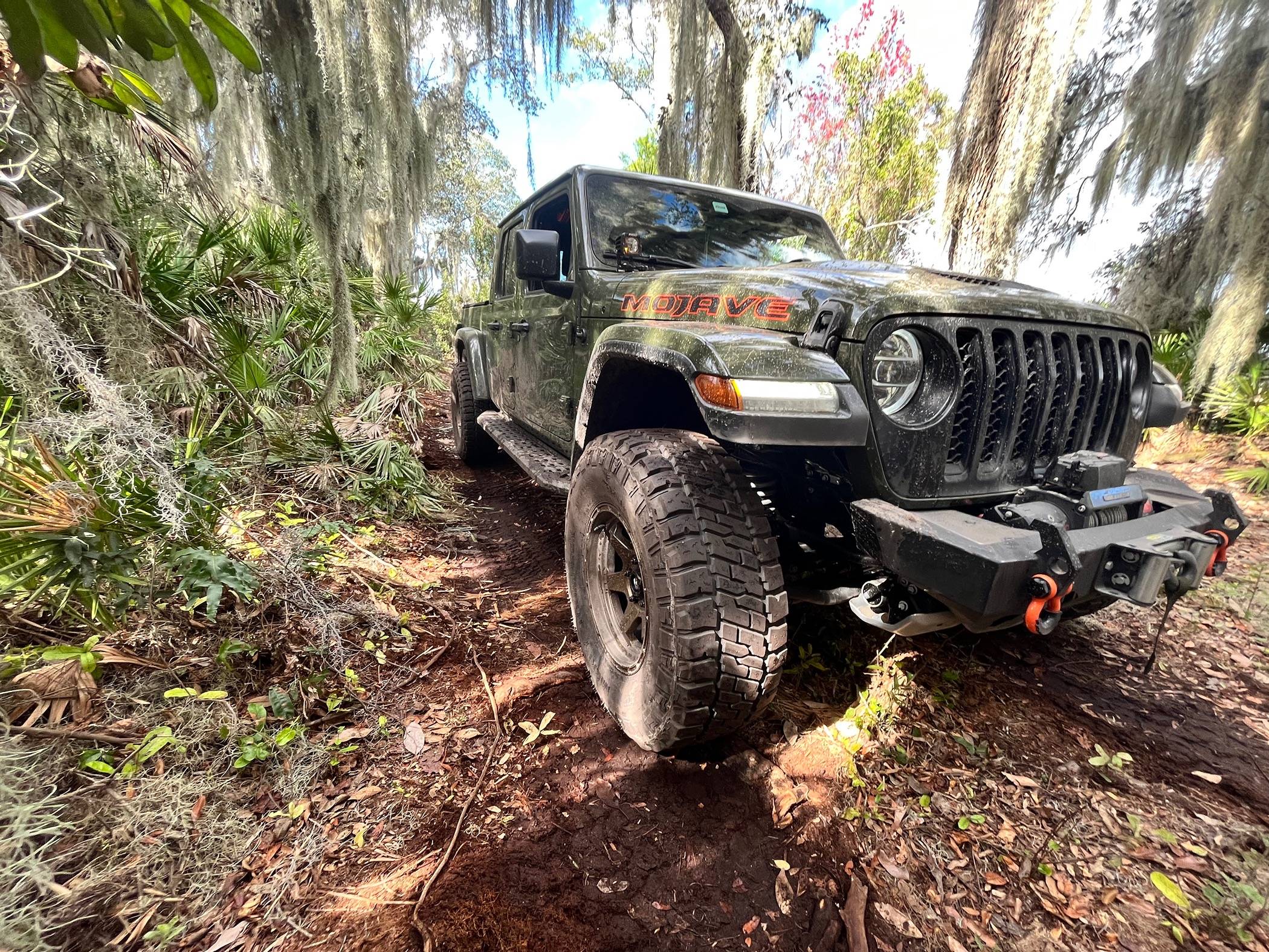

For me, I love the look of a stubby, weight was important as well and needed to clear a winch without obstructing the radiator much. I found that the rugged ridge stubby worked best for my needs and accepted the factory fog lights as well. Little to no rake at all.
Jeep Gladiator Stubby vs. full-width front bumper IMG_9935
Jeep Gladiator Stubby vs. full-width front bumper IMG_9934

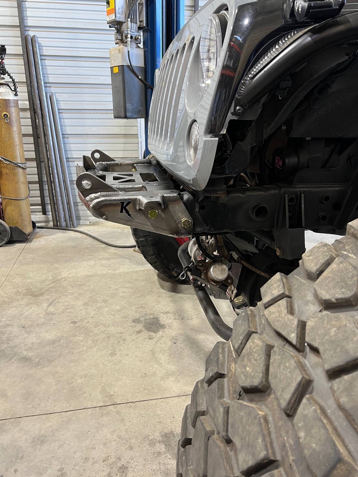

Greetings all and thanks for the TONS of useful information on this forum. I’m a new member here (please be gentle) and absolutely LOVING my JT. Have had several Cherokees and a Grand Cherokee but this is my first adventure in this end of the pool and the more I learn the more I need to learn. Looking to change out the factory Mojave bumpers and just wondering if there is an advantage one way or the other between a stubby front bumper and a full-width, or does it just come down to personal preference like so many other mods? Thanks is advance!
Stubby bumpers are absolutely the way to go!!! Lots of clearance but still functional with mounting points for winch, lights and recovery points. Plus, it's just a nice look from the front view of the stance of the jeep.
I run a KrashFab bumper. built to take abuse but looks really good. Well built and clearance for wheeling, no more getting hung up on rocks because your bumper is too boxy and hangs down to low, American made.

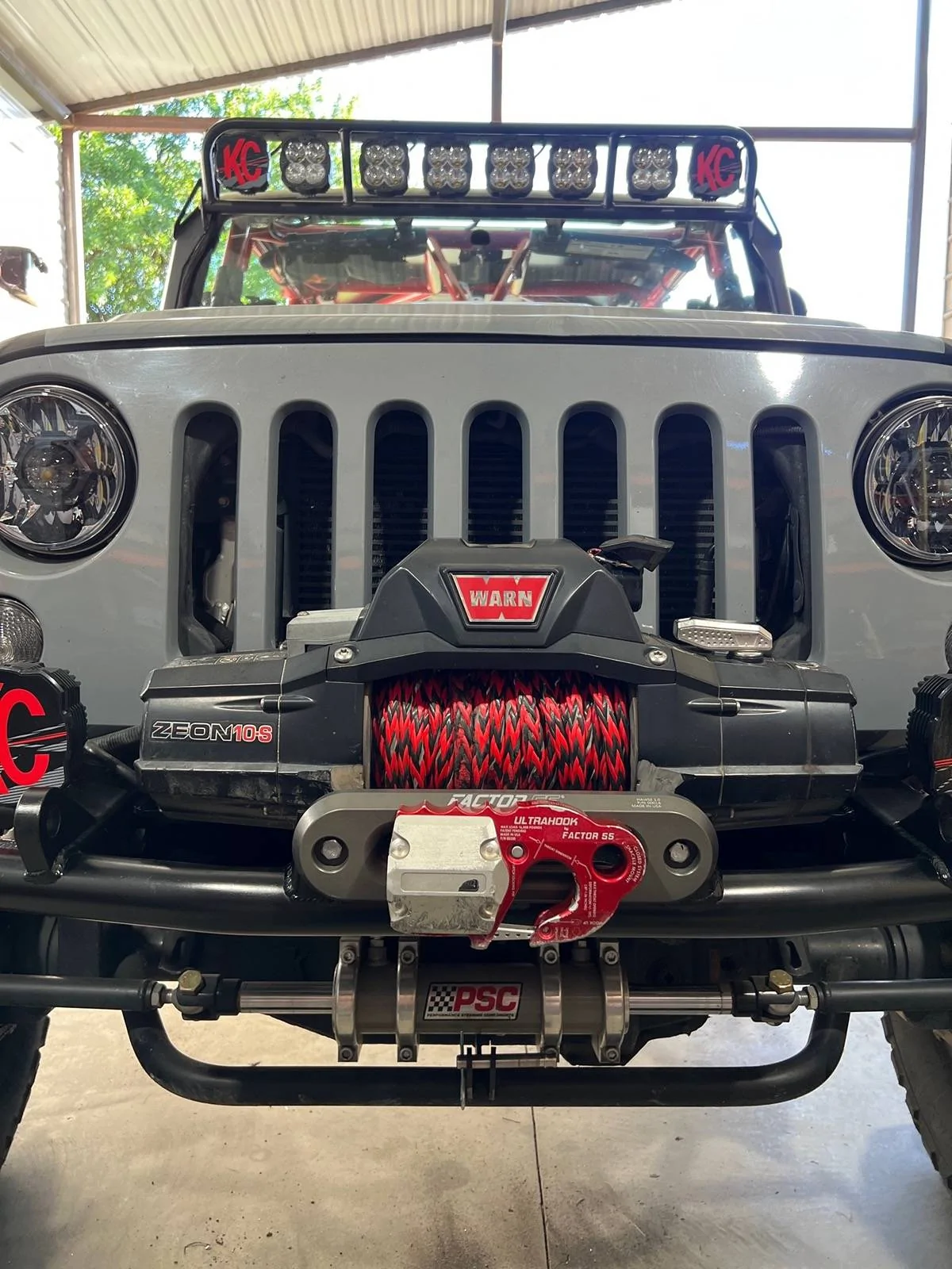

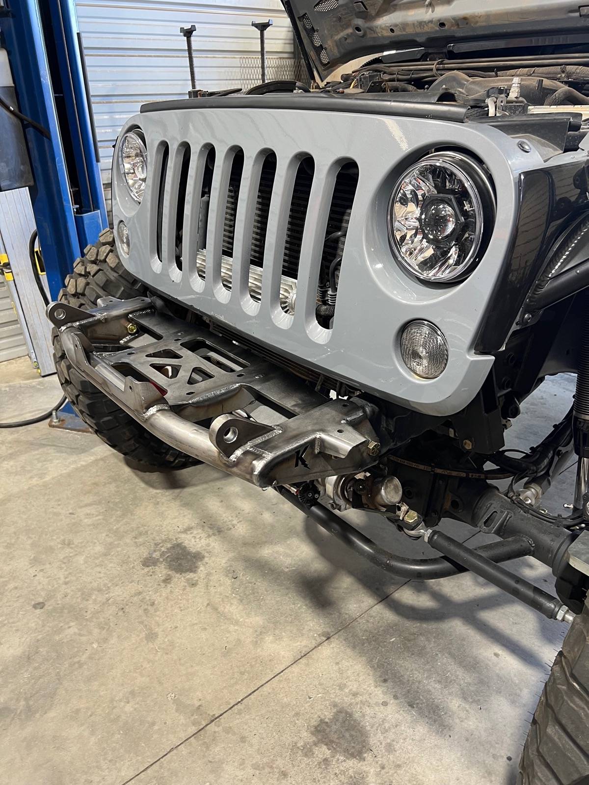

Jeep Gladiator Stubby vs. full-width front bumper IMG_2812
Looks cool but cutting the skid plate mount frame horns and leaving my sway bar disconnect in the wind would have me thinking twice about that setup.
obsessedjeepgirl
Reggye
Mar 13, 2024
90 YJ, 05 TJ, 14 JKU
Fabrication shop
Have had no issues and run it on multiple jeeps that are rock crawlers and get driven on the street.
