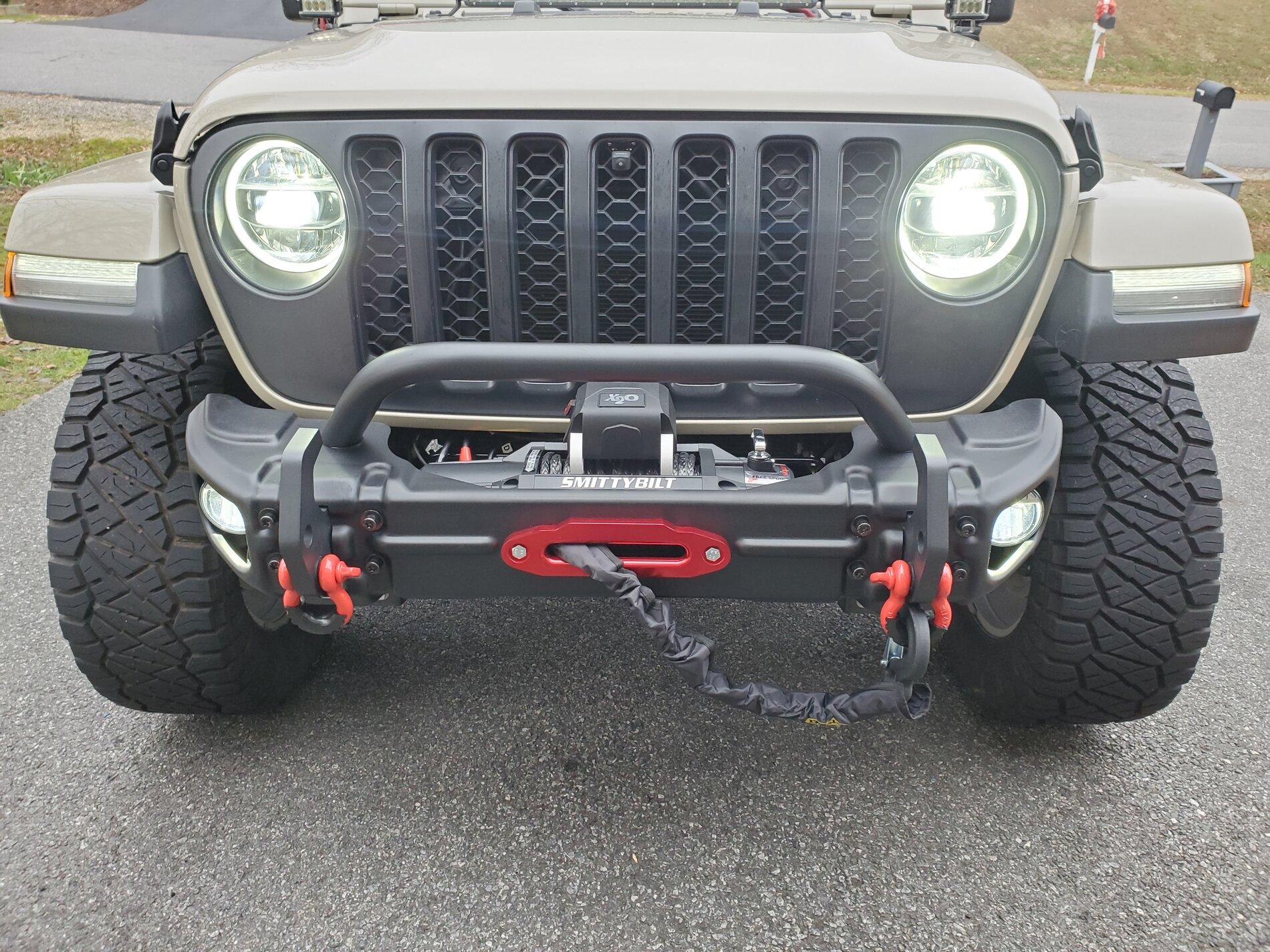

Im running the Arcus with the over rider bar and the X2O 10k winch, except I have the synthetic line. It’s a great looking combination on these Gladiators!
I just installed the same bumper and winch. How did you mount the control box on top? When I put my grille back, I couldn't bolt it back on. It does kind of stick in place but was wondering if your is mounted securely.

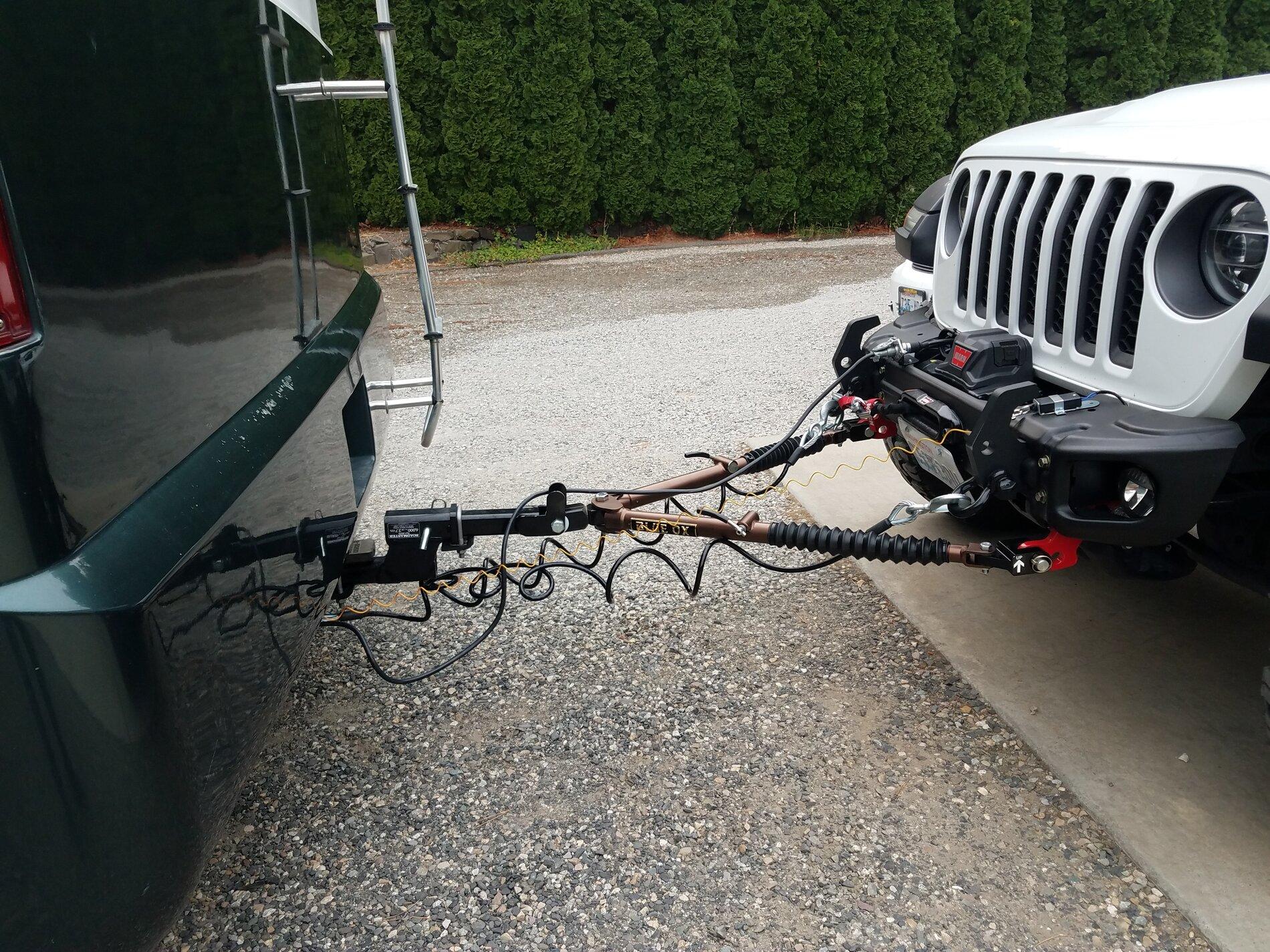

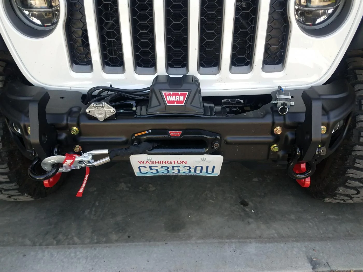

Warn VR series, stock Rubicon skid plate. Installed it with Maximus-3 tow loops for flat towing the Gladiator behind the motorhome. The RR provided bolts were not long enough to go all the way through the beefy Maximus tow loops, so I swapped them out for some longer grade 8 bolts. I later added some cheapo amber cubes. They don't ice up like the stock leds.
Same issue as you, I used some fairly beefy zip ties through the front brackets and looked them through the winch body and tightened them down. There just isn’t t enough space for that control box, which was ok since the rear set screws were frozen and weren’t usable. I have off roaded it once like that and Han no problems.
Thank you. That is what I’m going to do. Thought I may have missed something. Thanks again.

Yes. I put on a RR license plate holder. It fits between the fairlead and the bumper. Need small fingers or long needle nose to get the nuts back on the bolts.
