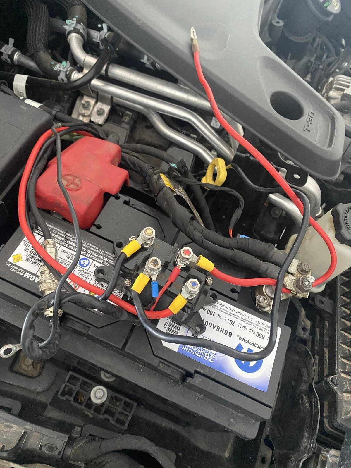

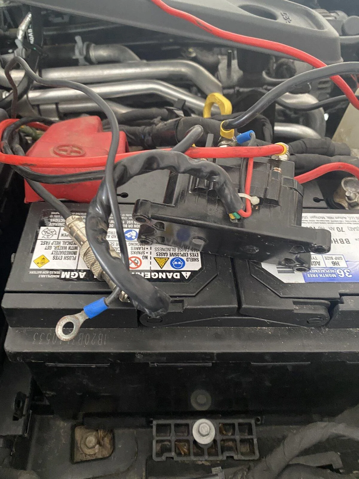

I’m also super curious as to what this was for (my assumption is lights or the winch, or both), super cool of him to leave it on for me, but now I have to figure out what it is and how to use it… I’m hoping this group can help me figure it out…
just have to chase the wires and see where they go
