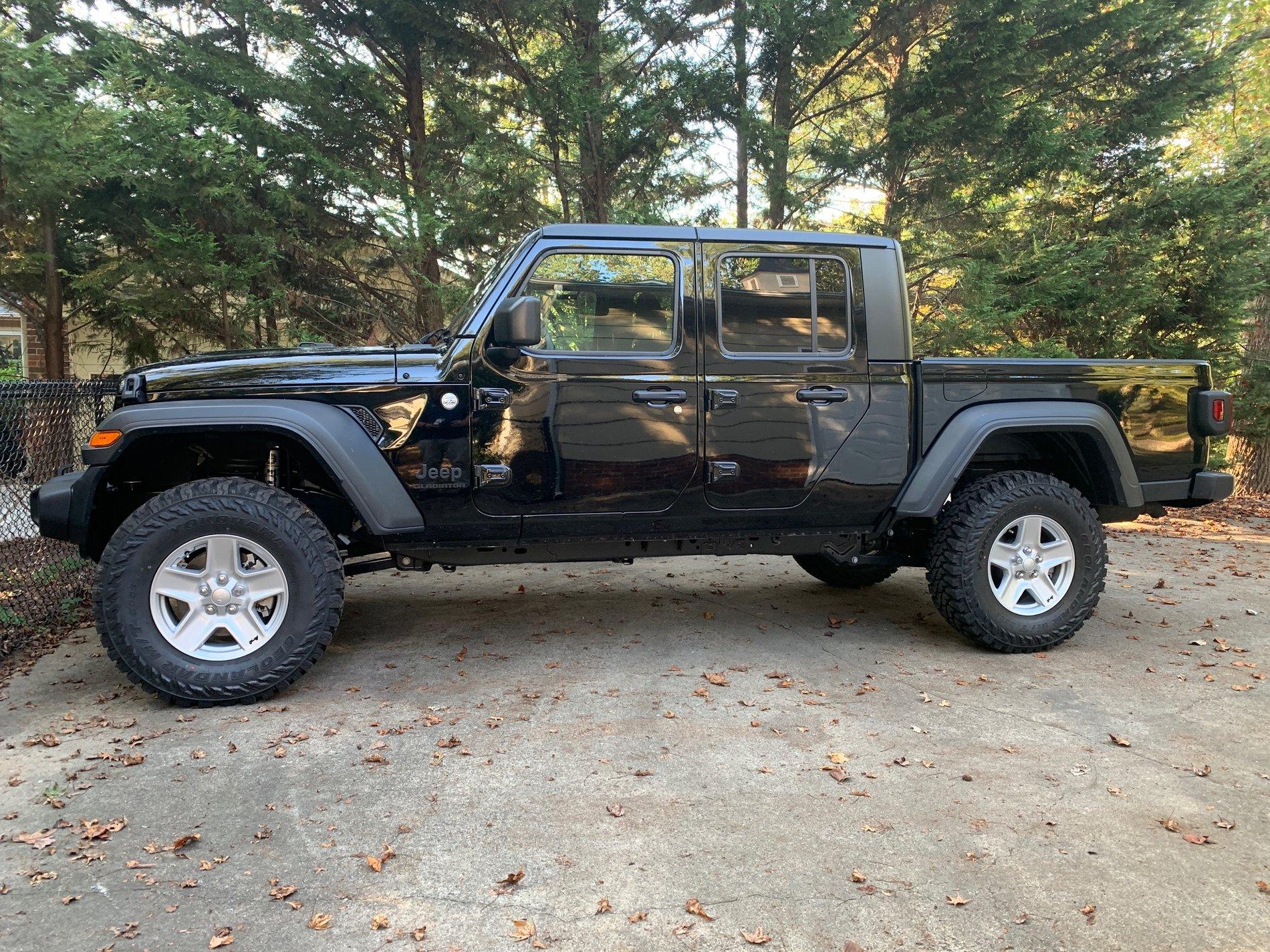

I went with a daystar 3/4 inch rear spacer/ teraflex 1.5 inch front spacer... ran tires and rims off of a LE Rubicon gladiator. Put fox shocks and fox stabilizer on it... flexes without rubbing. This is a mild build but it rides and steers really nice. Installed the parts in about 3 hours in my garage.
Cost was 150 for teraflex kit, 29 for Daystar kit... 200 dollars for take off shocks from ebay…
Is yours a max tow or not?

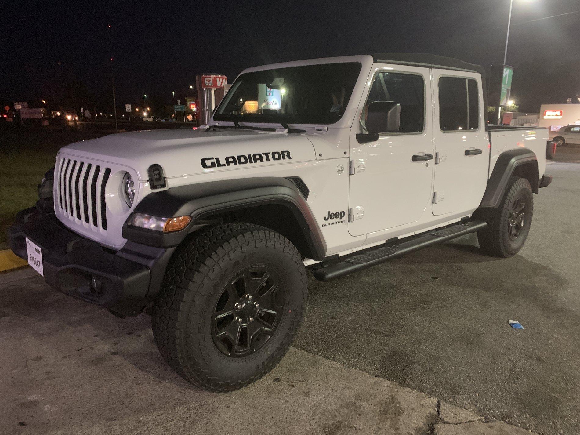

2020 MAX TOW MAX TOW MAX TOW, 4.10s w 1583 payload

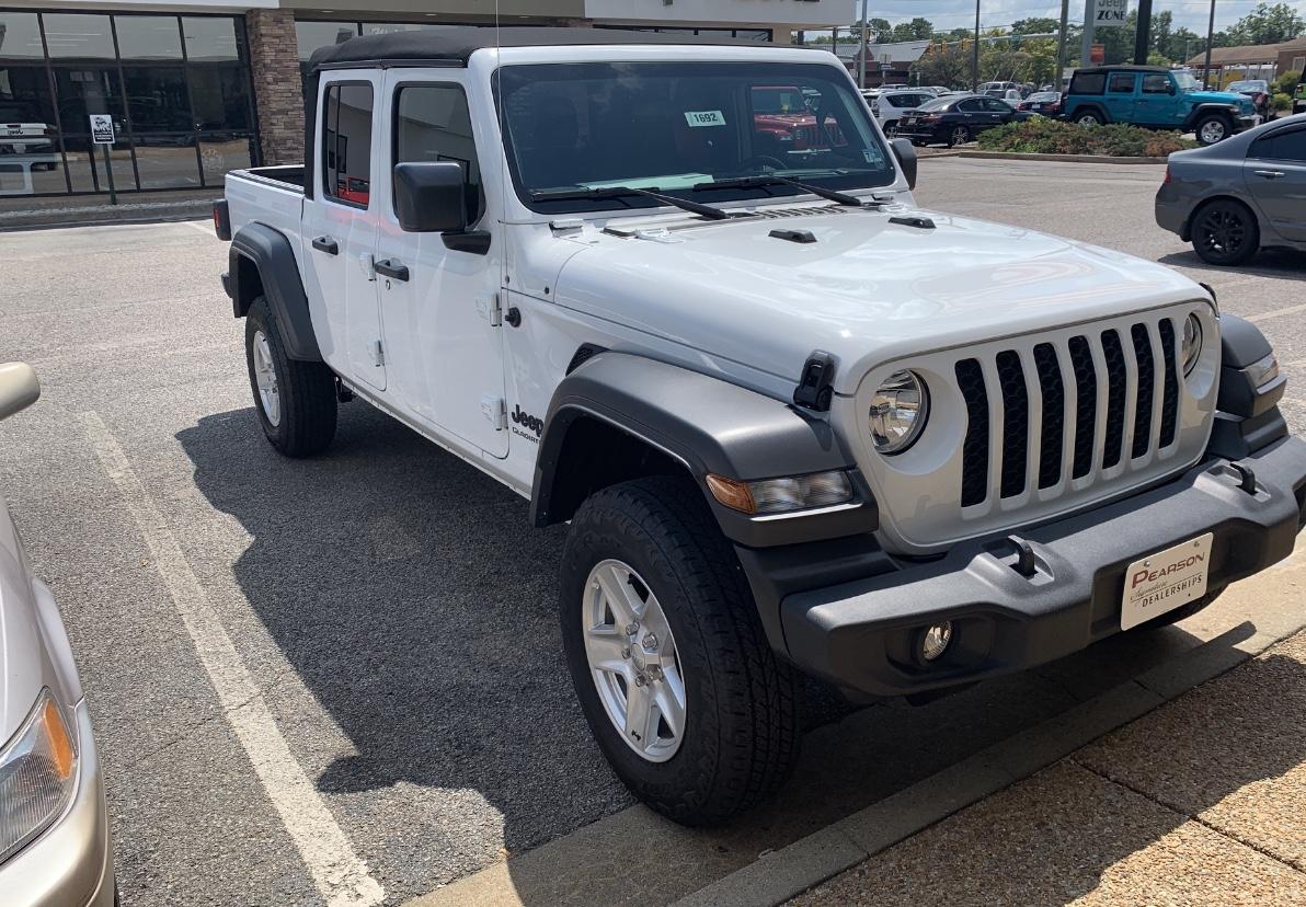

Added some mopar aluminum side steps. These are not the overland ones. Work great for my 5 year old and pregnant wife! Picked them up for $220!!!
Jeep Gladiator Daniel’s super white JT Sport S max tow 3D52FC99-6982-49F5-80CD-AA8BFD377956

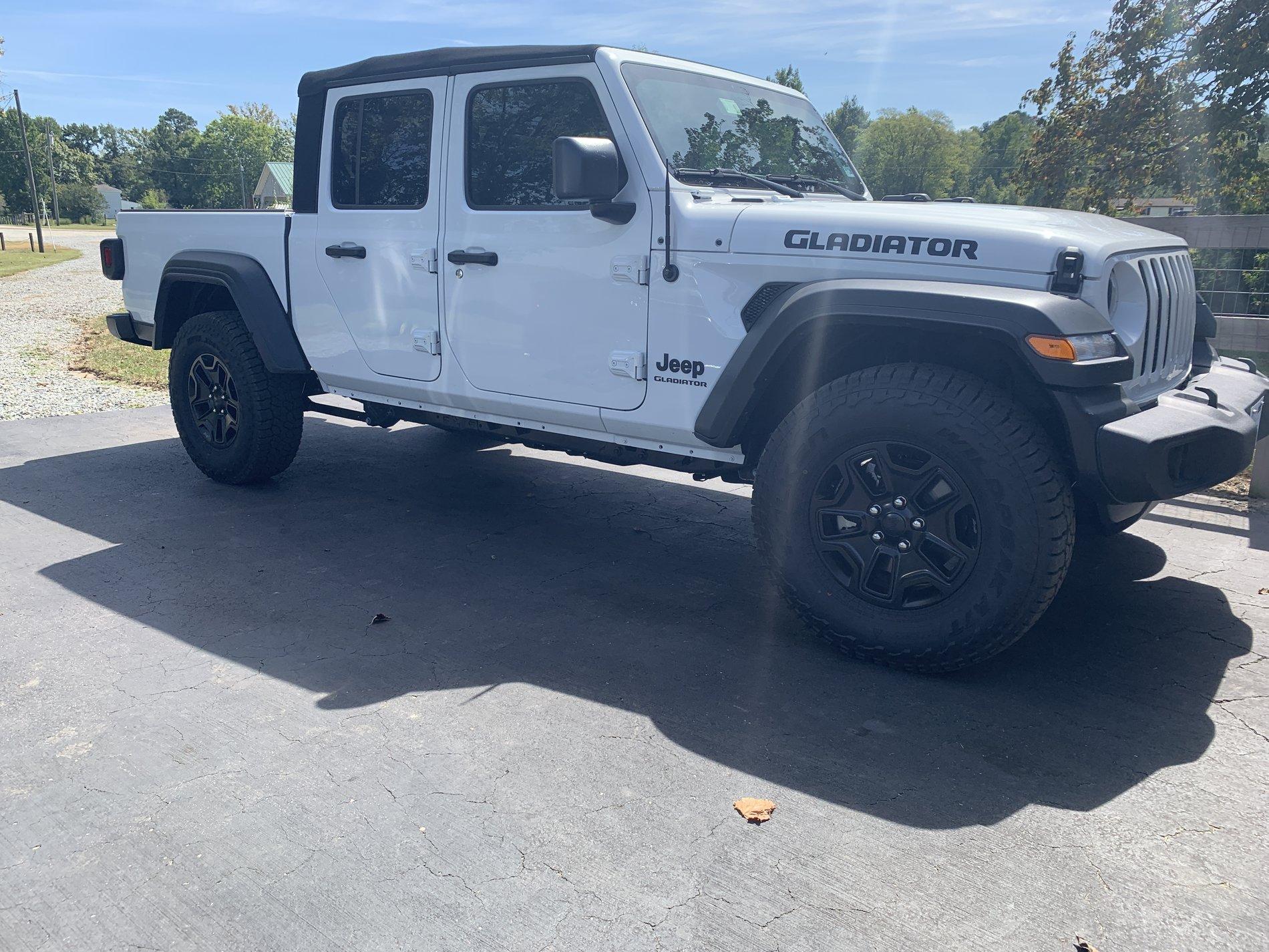

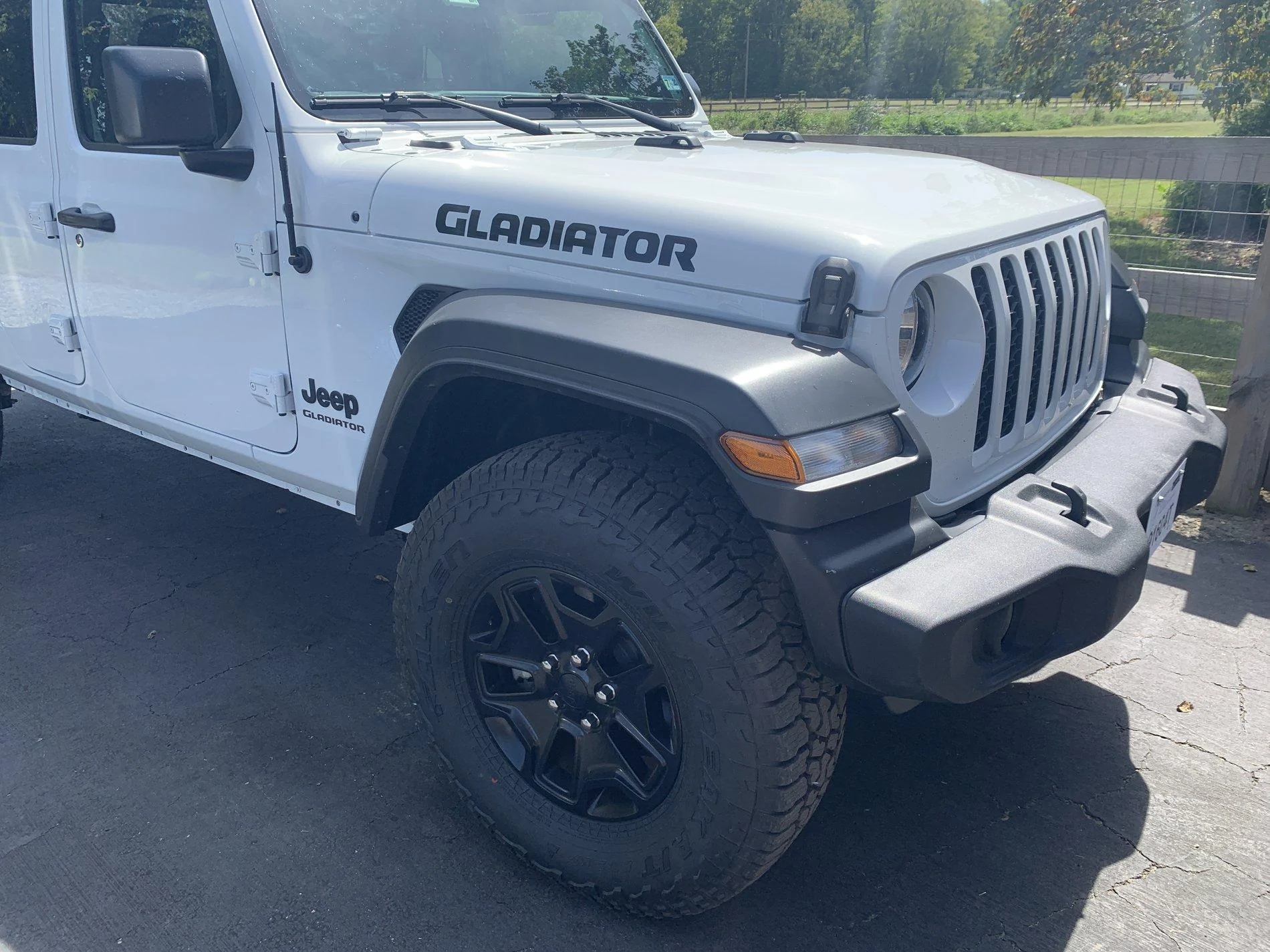

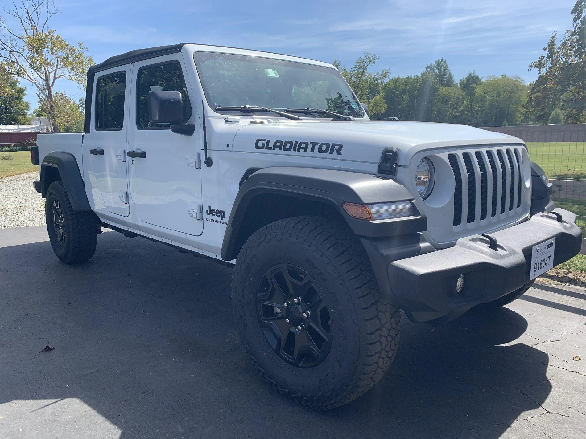

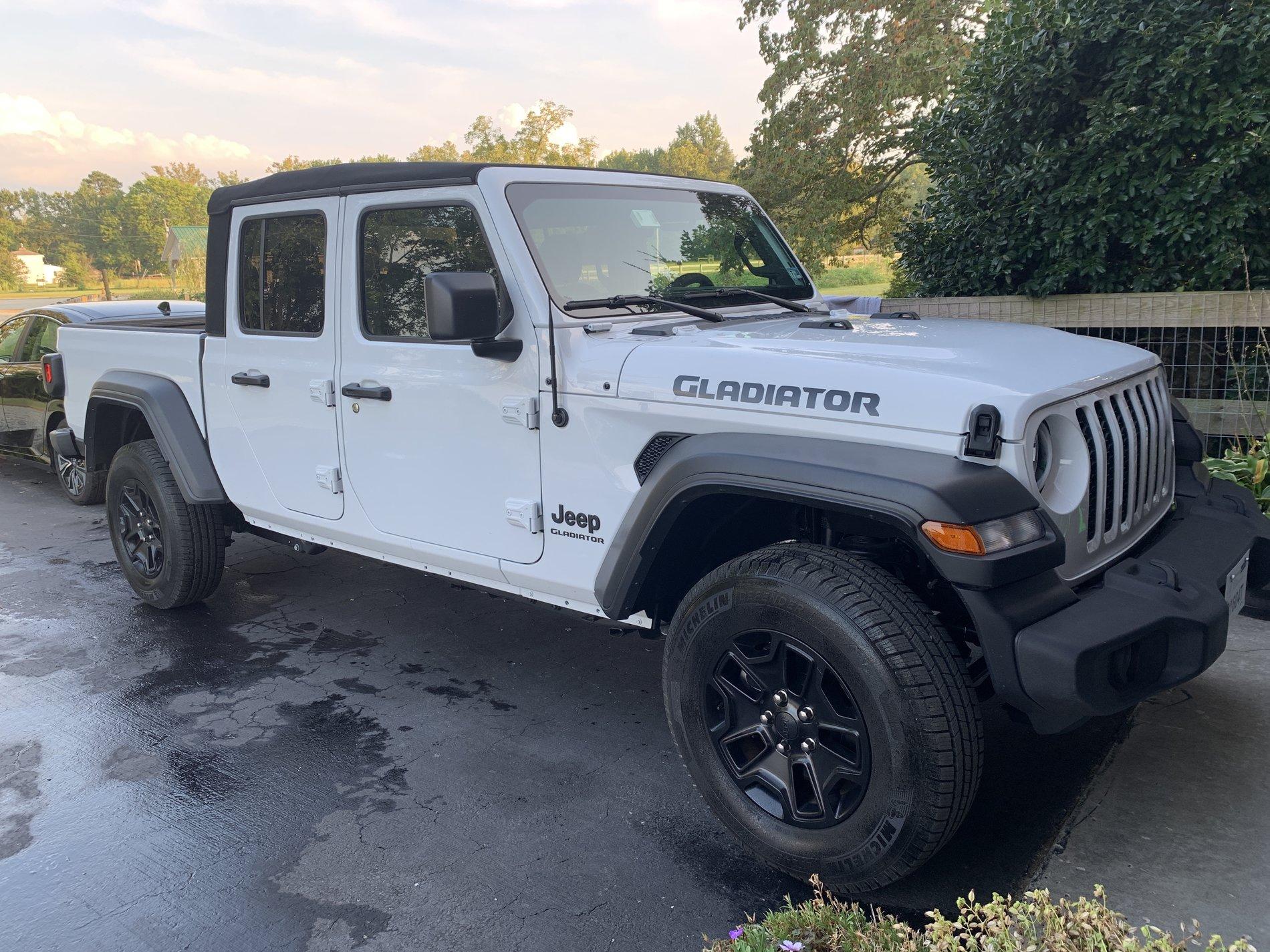

Here is some pictures with the 2” iron rock off-road spacer kit and from rubicon springs. It’s almost level but with 1/2” rake with the nose tad bit down. Install took like 1 hour 45 minutes and it rides about the same. Looks a lot better and proportional in my opinion!
I have attached a picture beside a stock rubicon.
With the 286/75r17’s I have about 9 inches between the top of the tire and the wheel well.
Jeep Gladiator Daniel’s super white JT Sport S max tow FB36B7B9-9229-45D6-9362-7CE1DDFE9BDA
Jeep Gladiator Daniel’s super white JT Sport S max tow 66AB6E77-6534-4852-824C-C242DB65E5B0
Jeep Gladiator Daniel’s super white JT Sport S max tow F2ED8880-CFEA-49F7-BE47-F6387F1F599B
Jeep Gladiator Daniel’s super white JT Sport S max tow 29AB93B6-4F31-4371-8621-2F00956FDF32
Jeep Gladiator Daniel’s super white JT Sport S max tow EA5D8C5A-697C-4A5B-87CA-75C84A3C54E2
