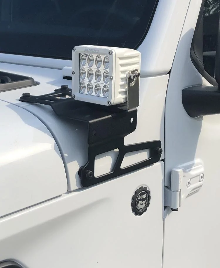

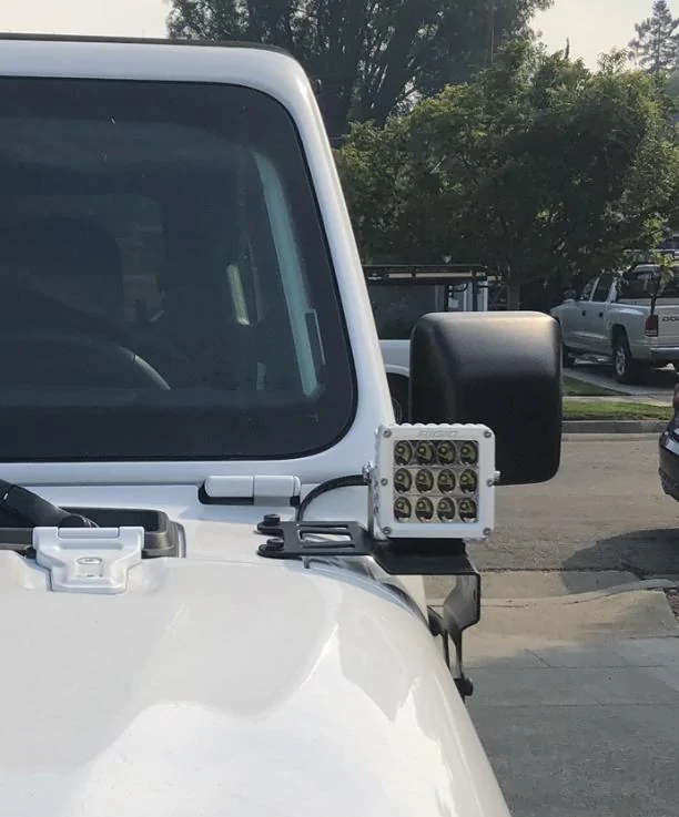

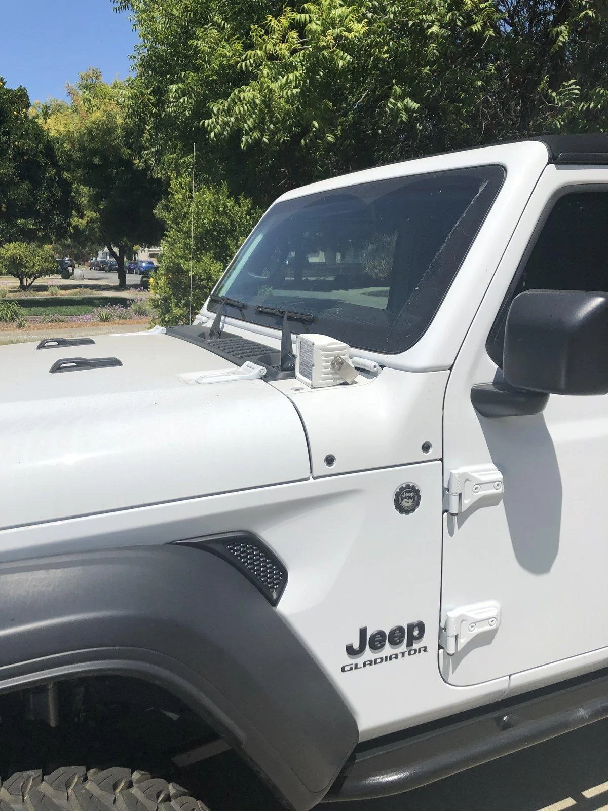

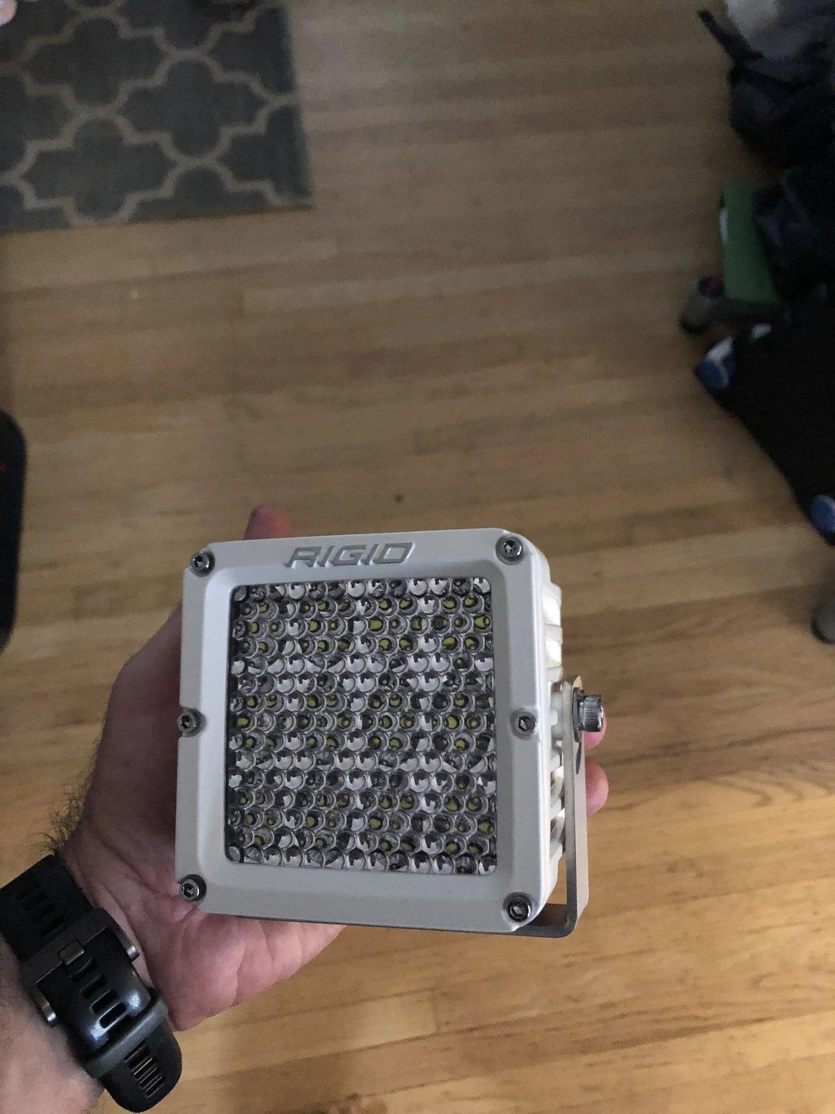

Next mod on deck. Some cowl lights. I got the mopar bracket on order. I bought a small aluminum brack from eBay but the dually XLs are too big for them. So I am waiting on the mopar brackets.
I did a mock up with power. And the hood glare could be annoying. So I wanted a bracket that moved the lights outward a little. I think the mopar bracket will fit the bill.
Jeep Gladiator Greg’s white JT max tow B18B5104-7464-48B3-B437-5FD684DFC472
Jeep Gladiator Greg’s white JT max tow CD355413-0C3A-491F-9DEA-7D71043A9F83

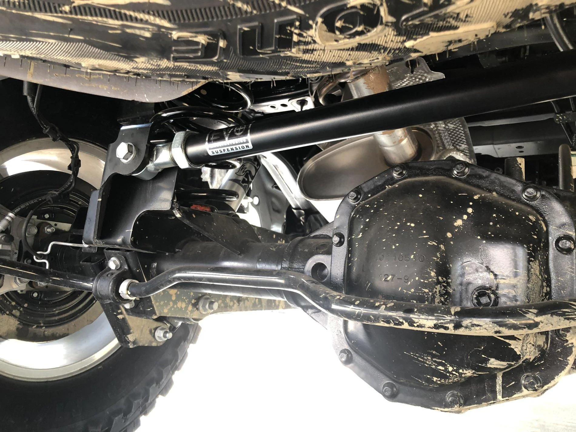

Soooo I put a EVO rear track bar in. I was feeling a little skeptical after measuring for a rear offset. There just isn’t much of a correction needed. And getting an accurate measurement, Forget about it. after doing some trigonometry I settled on adding +1/4 inch. Which is reasonable given my best attempt at the axle offset measurement. This isn’t much. So I wasn’t expecting much of a geometry correction.
That being said, this is a big stiff track bar with good bushings. The original bar is thin and wimpy.
The test drive was a very pleasant surprise, which I’m going to attribute to the increased stiffness and improved bushings.
The rear is more composed. It tracks better over bumps. Less wiggle in the rear. It feels more solid. It was worth the $220!!!
I’d expect there would be an improvement on stock height vehicles too.
Jeep Gladiator Greg’s white JT max tow 5255ED01-6AD8-4F8A-8FEF-22D27701D24F

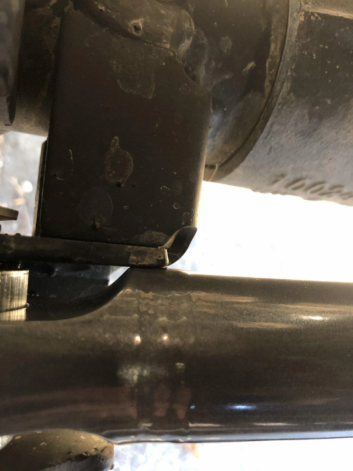

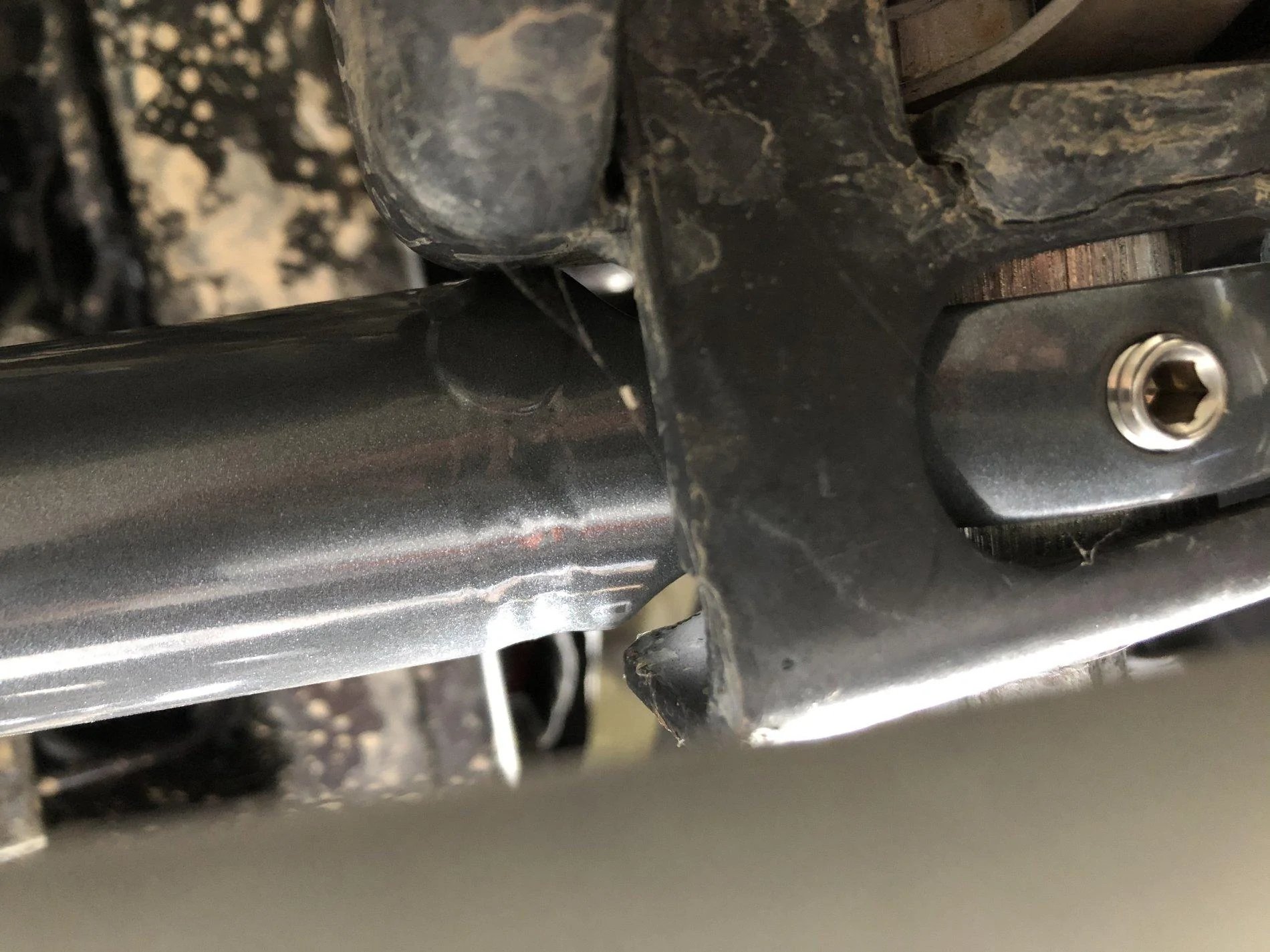

The front trackbar is a bit of a fiasco. I noticed a squeak. And turned out, the trackbar rubs. Synergy fail, they have recently added instructions on how to trim, but It won’t help my interference
Jeep Gladiator Greg’s white JT max tow 90DF9457-041B-4477-9D1B-AAC87D3DA361
Jeep Gladiator Greg’s white JT max tow 32C47AEF-3184-4AA3-9EC7-ED15D9653508

That is definitely no bueno.
Great build so far. A lot of what I am doing is the same (just waiting for the jeep to arrive, 2021 white max tow with factory retro graphics). I too am doing the mopar lift (dealer installed) with 35 General Grabber ATX's on Quadratec white retro rims.
Explain to me the fail of the synergy front track bar. I ordered one after looking at others, but most people said it was great and even the "way of life" who was originally a JK guy showed a install that was so straight fwd and easy and no interference with anything. I was having the dealer install it at the time of the lift (pre delivery to me), but now you have me nervous. I saw nothing on their online instructions about having to "trim" anything.
