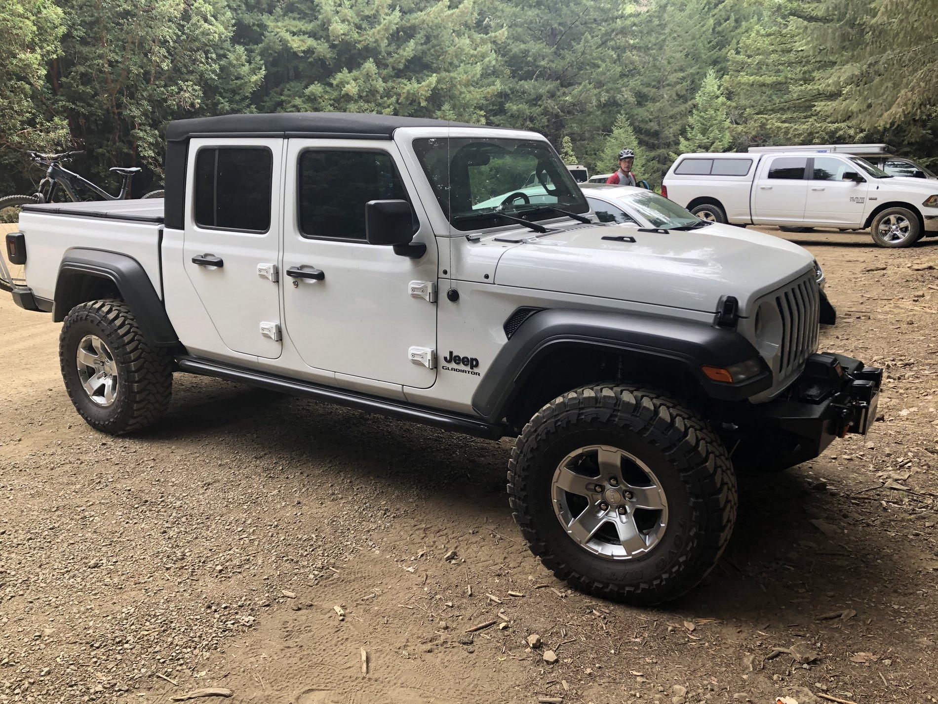

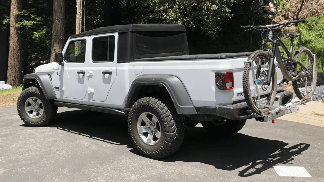

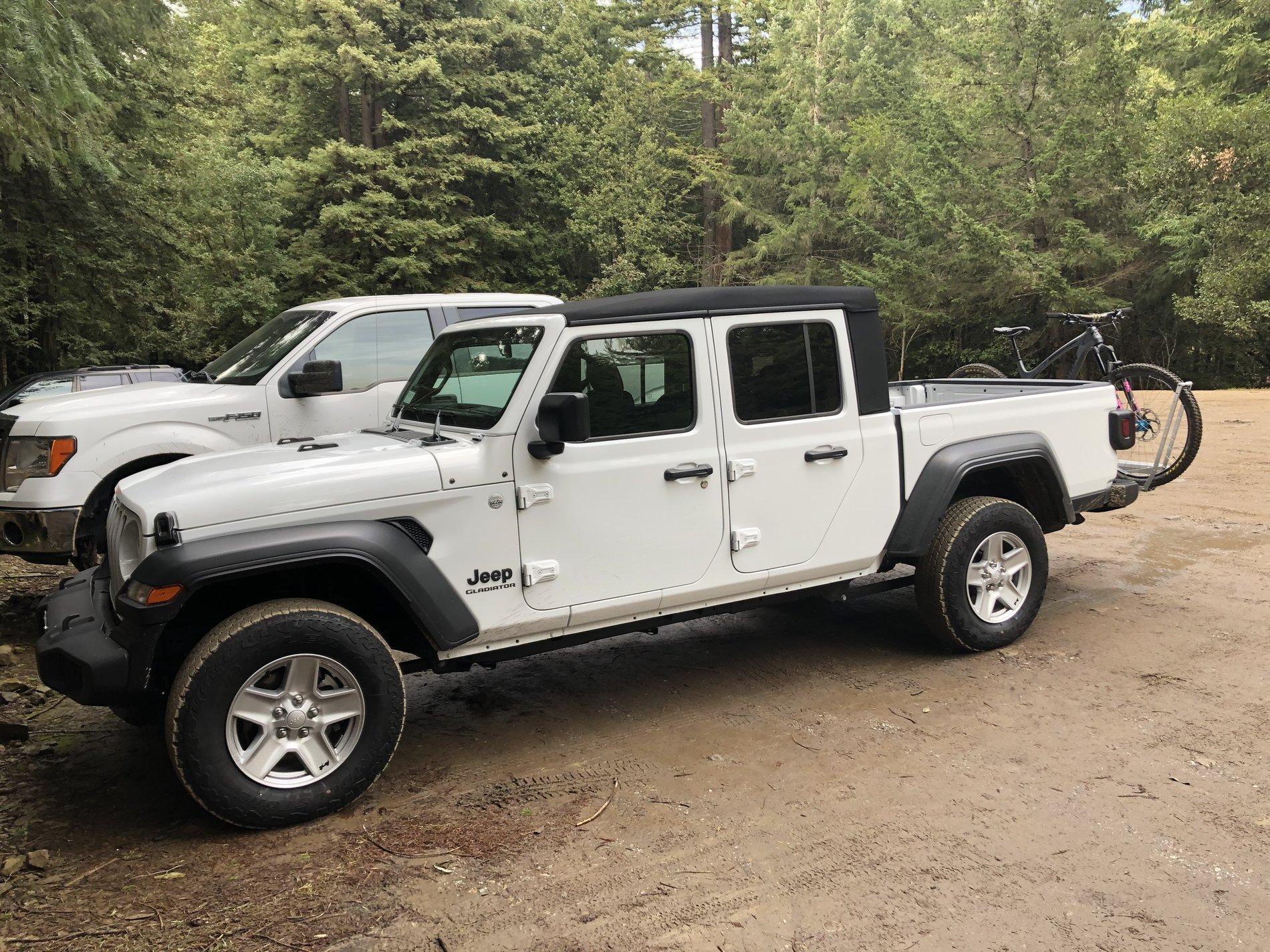

View attachment 72924 My build log. I got a Max tow gladiator with a mopar 2” lift and 35” tires. Nothing wild.
Before
After lift.... 35” toyo MT , mopar gear wheel and Mopar 2 lift
Added rock rails
The lift and tires look great. Did you install the Mopar lift kit yourself? How difficult was the installation? Who did the tire alignment afterwards? Did you have to switch rims for the width of the Toyo's? Sorry for all the questions. We've got your same truck but in red.

This is my build thread. Thus most every question you’re asking is in it.
Read through all your posts. You don’t mention how easy or difficult the Mopar lift upgrade is to do. I’m guessing you’re a mechanic? Wheel alignments can be difficult. All the work you did looks like it was worth it because it looks awesome.

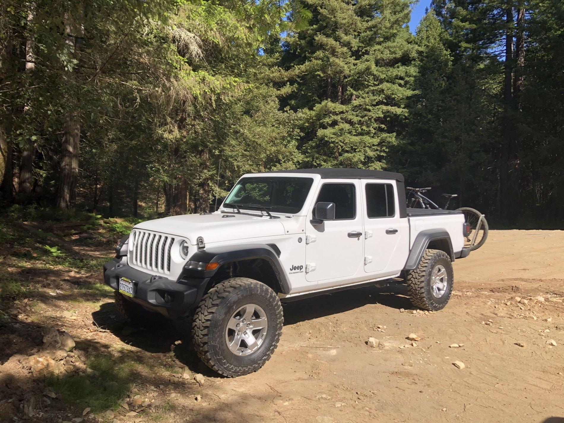

the depth and color on theses wheel looks really good in person. They are silver, carbon grey and a machined lip. Which doesn’t come through in photos. And the bright color makes the wheels look bigger to me.
The only thing I’d upgrade to is some Hutchison rock monsters if I put Dana 60s under it.
