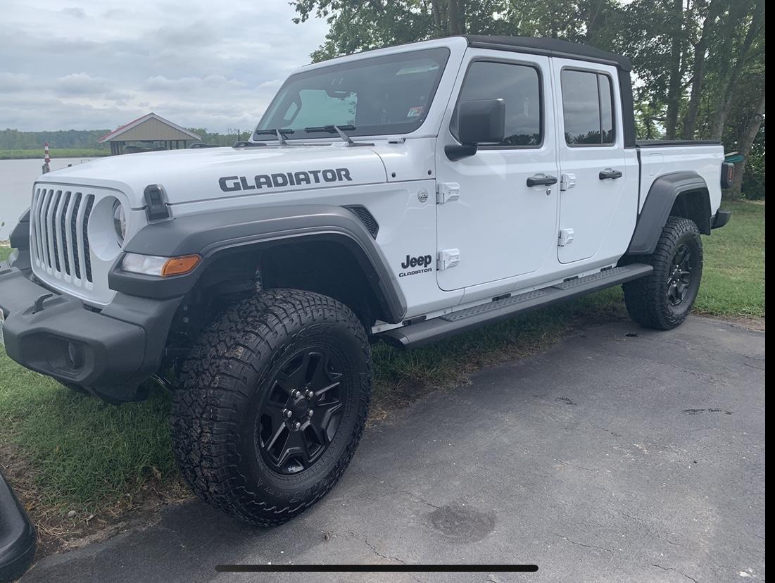

I went with a daystar 3/4 inch rear spacer/ teraflex 1.5 inch front spacer... ran tires and rims off of a LE Rubicon gladiator. Put fox shocks and fox stabilizer on it... flexes without rubbing. This is a mild build but it rides and steers really nice. Installed the parts in about 3 hours in my garage.
Cost was 150 for teraflex kit, 29 for Daystar kit... 200 dollars for take off shocks from ebay…
Is yours a max tow or not?

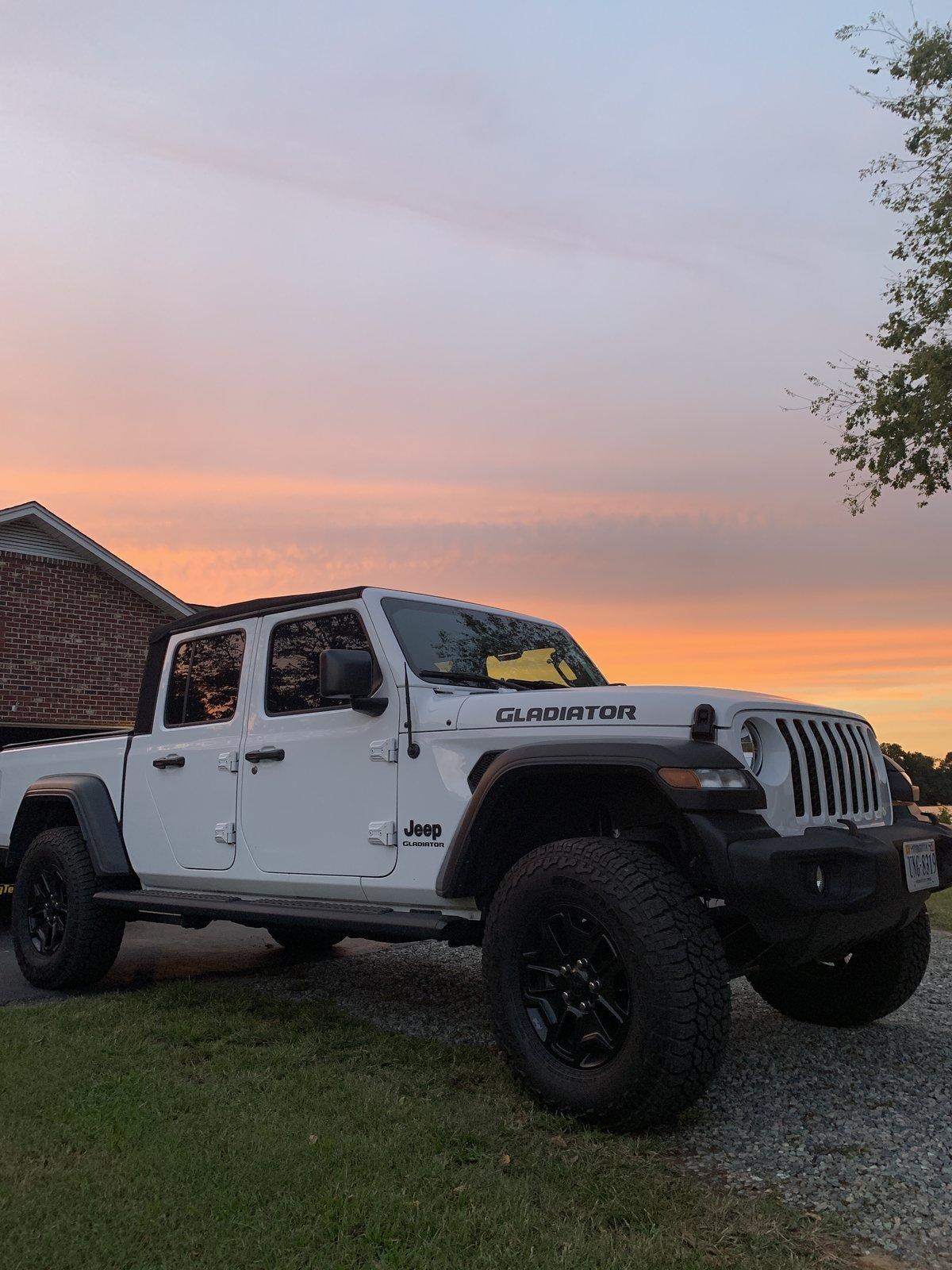

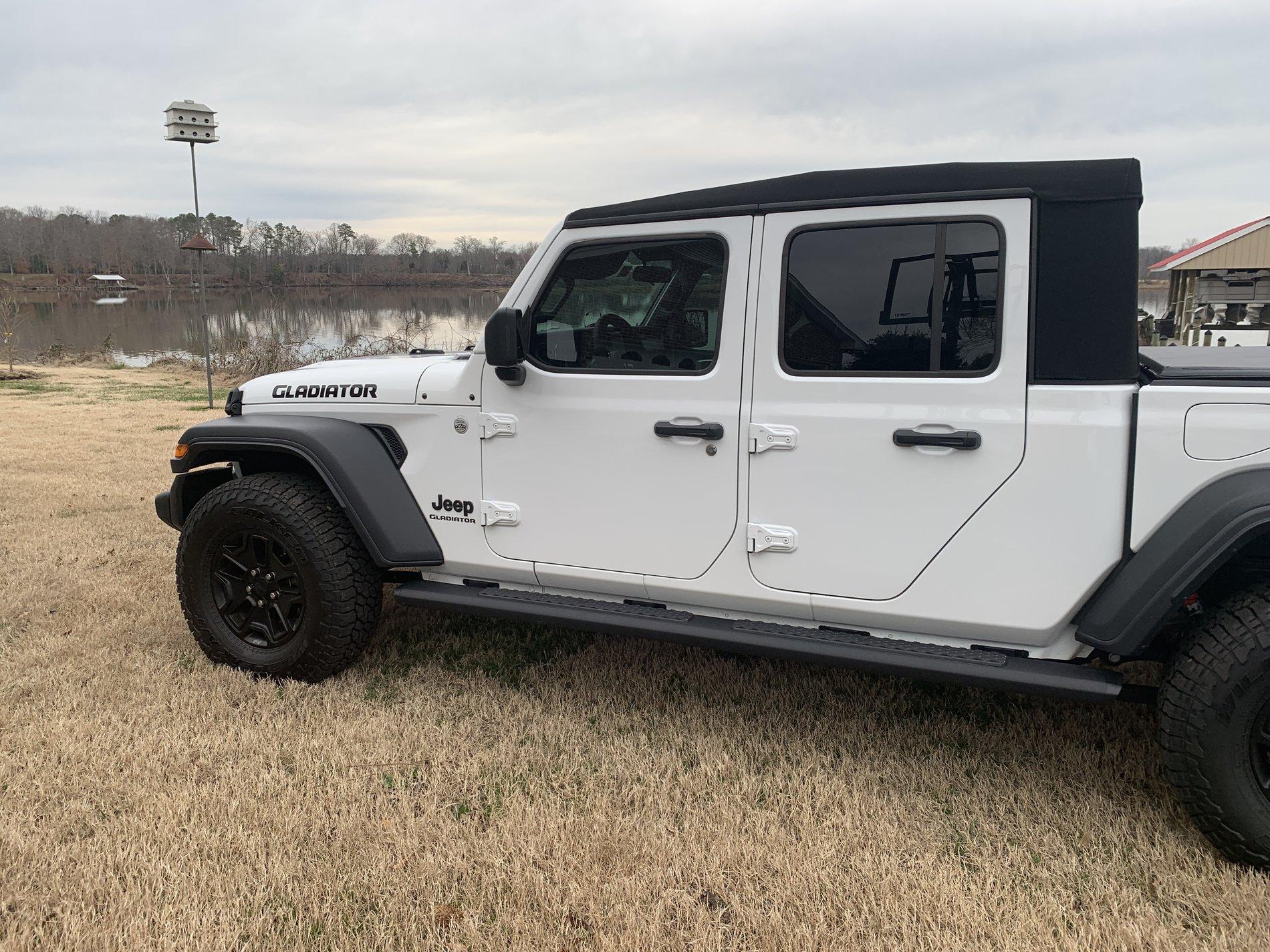

2020 MAX TOW MAX TOW MAX TOW, 4.10s w 1583 payload
Added some mopar aluminum side steps. These are not the overland ones. Work great for my 5 year old and pregnant wife! Picked them up for $220!!!

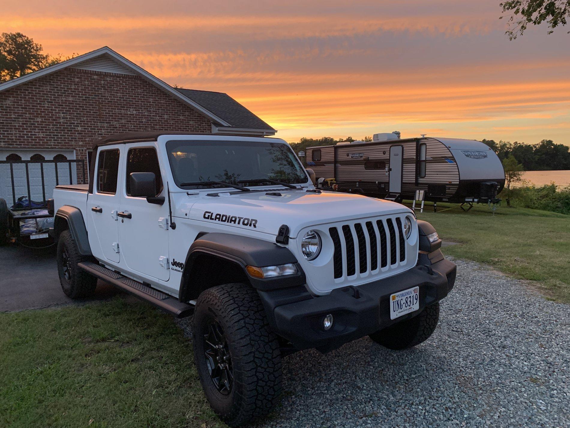

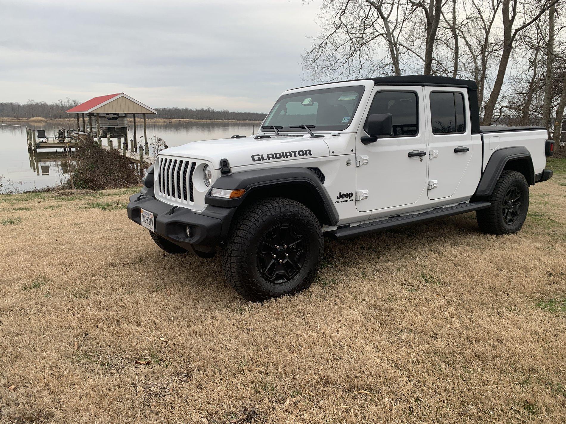

Here is some pictures with the 2” iron rock off-road spacer kit and from rubicon springs. It’s almost level but with 1/2” rake with the nose tad bit down. Install took like 1 hour 45 minutes and it rides about the same. Looks a lot better and proportional in my opinion!

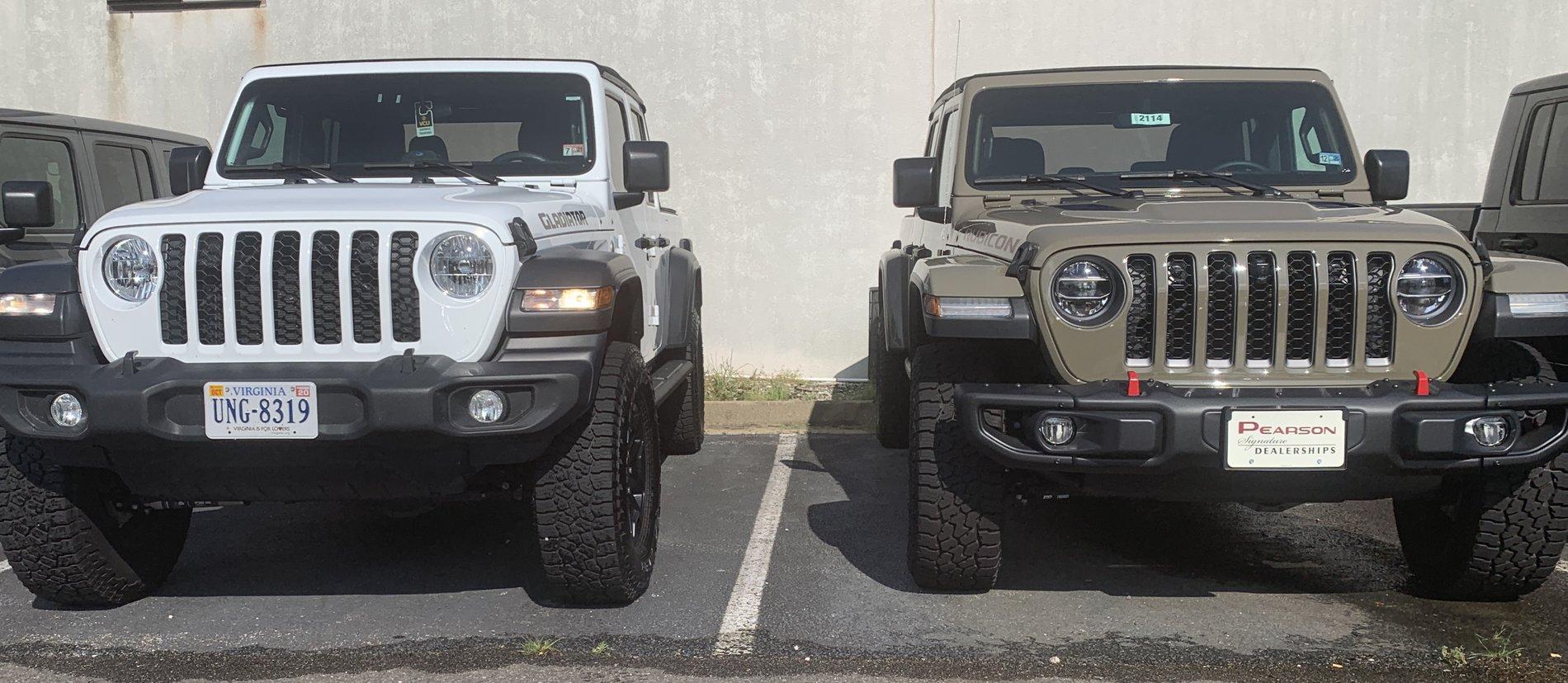

I have attached a picture beside a stock rubicon.
With the 286/75r17’s I have about 9 inches between the top of the tire and the wheel well.
