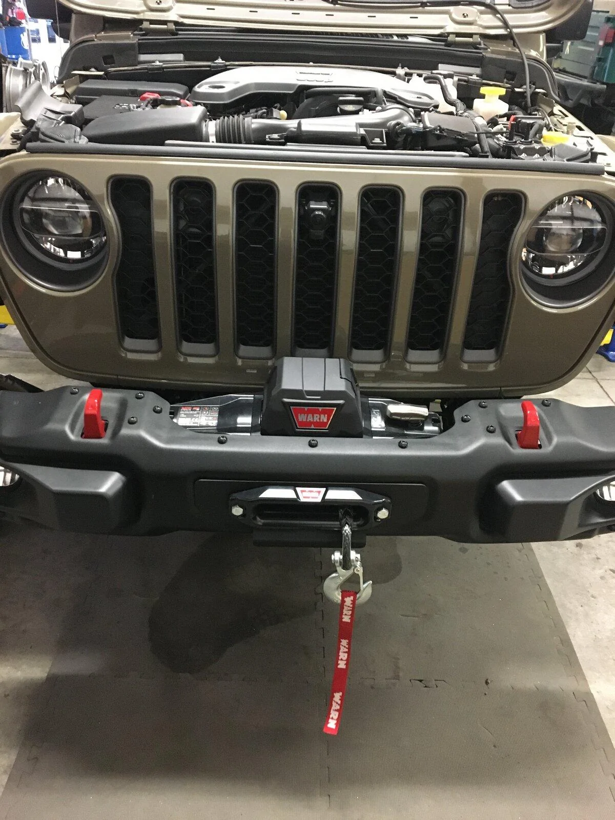

I went with a Warn EVO 10k Synthetic. I have had good luck with Warn in the past. The EVO is a reasonably priced winch with a reputation for quality.
I chose 10k as opposed to 12k because the 10k winds in faster. In most cases I could double the power with a snatch block if needed.
I have a Factor 55 flatlink to install.

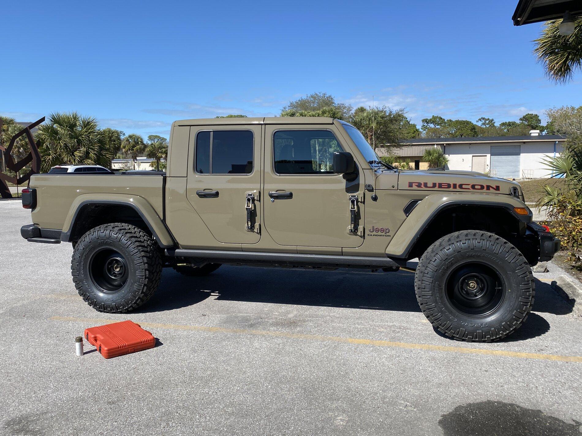

Lift.
I went with a Metalcloak 3.5" Gamechanger. I added 1 3/8" Icon coil spacers to the rear.
I chose Metalcloak due to a reputation for quality and an ability to articulate well. I like the low maintenance joints and quiet operation.
Metalcloak 3.5" lifts look a little saggy in the butt on Rubicon JTs to my eye. With the added coil spacers it sits just right.

Current look:
Jeep Gladiator Gator Green Rocklander Build IMG_0943 (1)
Jeep Gladiator Gator Green Rocklander Build 171419802_1260380601050903_6269460952239305235_n

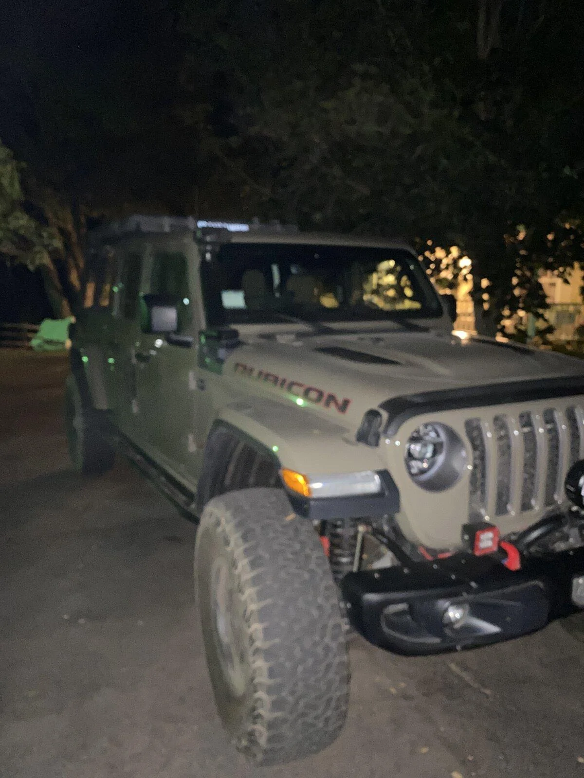

Twins. From. Mine is running 3.5 gamchaner lift method wheels. The semi bead lock low pressure ones 702? Snorkel 37 inch BFG ko2 falcon. Steering stabilizer 10 k superwinch. EXP quadratic 6 inch lights rebel bed rack and a bunch of other stuff
Jeep Gladiator Gator Green Rocklander Build CD236B4A-CA94-4B89-A3B2-EB1A5999C763
Jeep Gladiator Gator Green Rocklander Build 01CE50AC-F698-440A-9AE3-966446BEDAC6

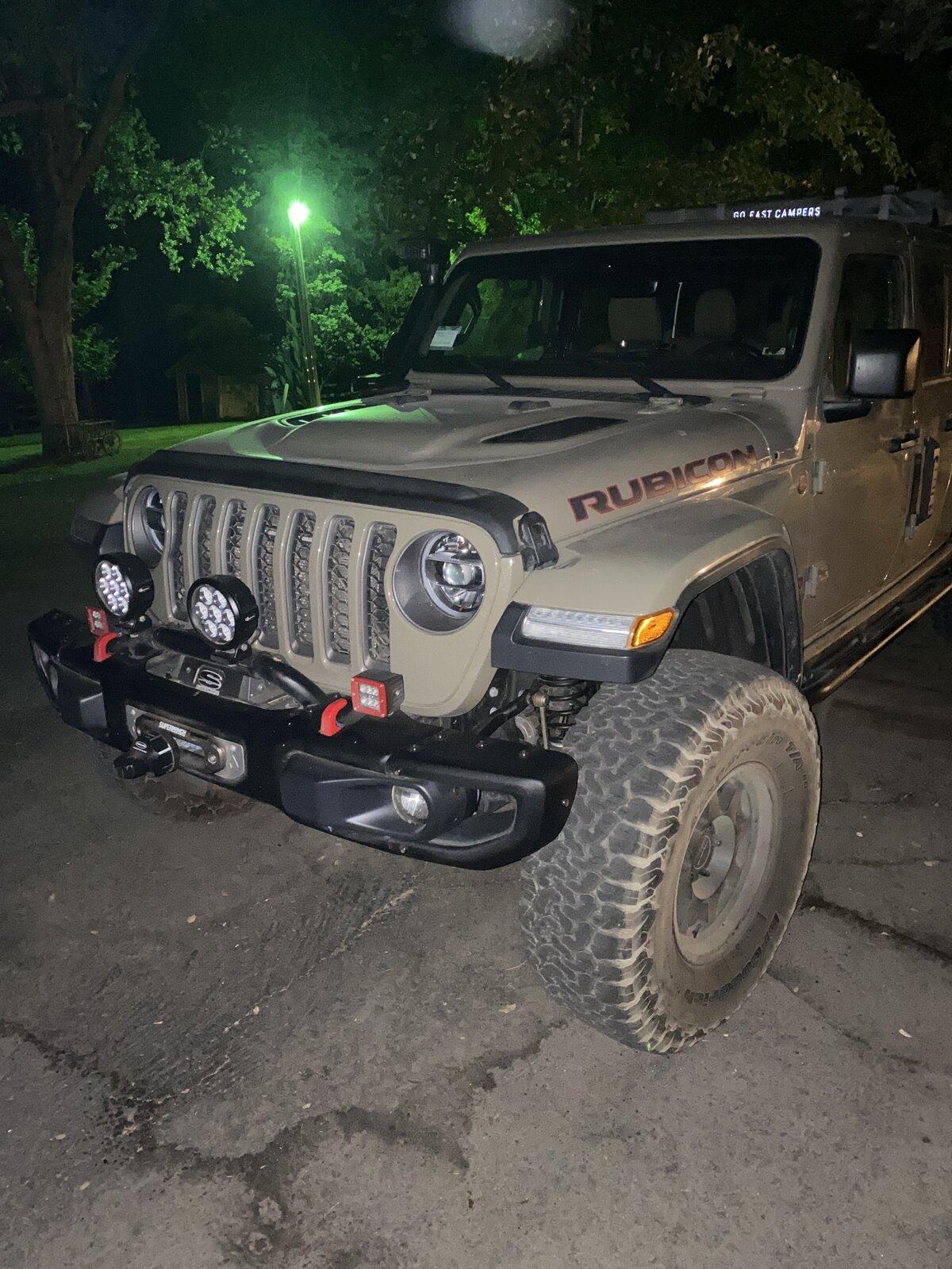

Current look:
--------END EDIT/Original Post Begins------------
Took delivery last month. I wanted a Gator Gladiator so I figured it was time to buy before I couldn't get a new one anymore. Found a loaded one on the lot in Texas and had it shipped to Florida.

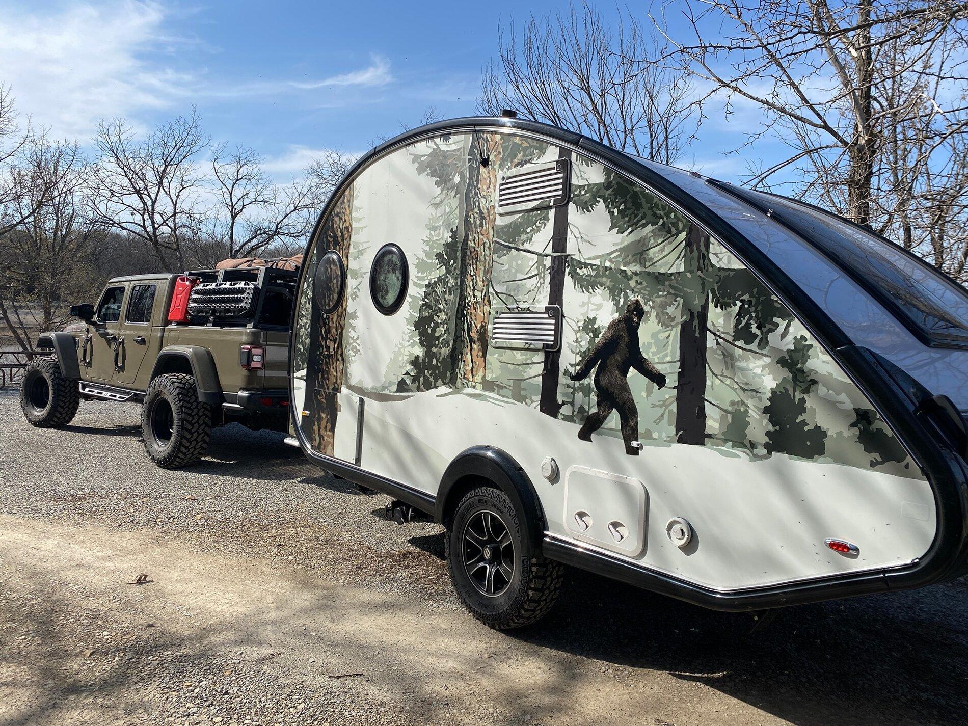

Our goal is to have an off roader that can tow our camper easily. We have a JKU currently that we have taken all around the states a few times. We recently bought a T@B 400 Boondock camper and it's at the limits for the JKU. It actually tows it surprisingly well, but we can't take anything extra along or we will be a good bit over the legal limits. The Gladiator is going to be the perfect fit for us. The JKU will go to our soon to be 16 year old.
We intend to take the camper to destinations and explore from there. It's not an off road camper, but it has a kitchen, a/c, shower, etc. All the comforts of home.
This is as it arrived.
Here is our JKU with our little camper. We are putting flat fenders on the JK at the moment. Also re-gearing.
Looking forward to taking the Gladiator on it's first trip!
We will be in Moab in the spring if this covid crap doesn't shut it all down again!
The Squatch on the camper is stellar. Gator would be my color if it wasn’t for living in TX. Got to have white here. IMHO
Wrong photos
Jeep Gladiator Gator Green Rocklander Build imag
Jeep Gladiator Gator Green Rocklander Build image

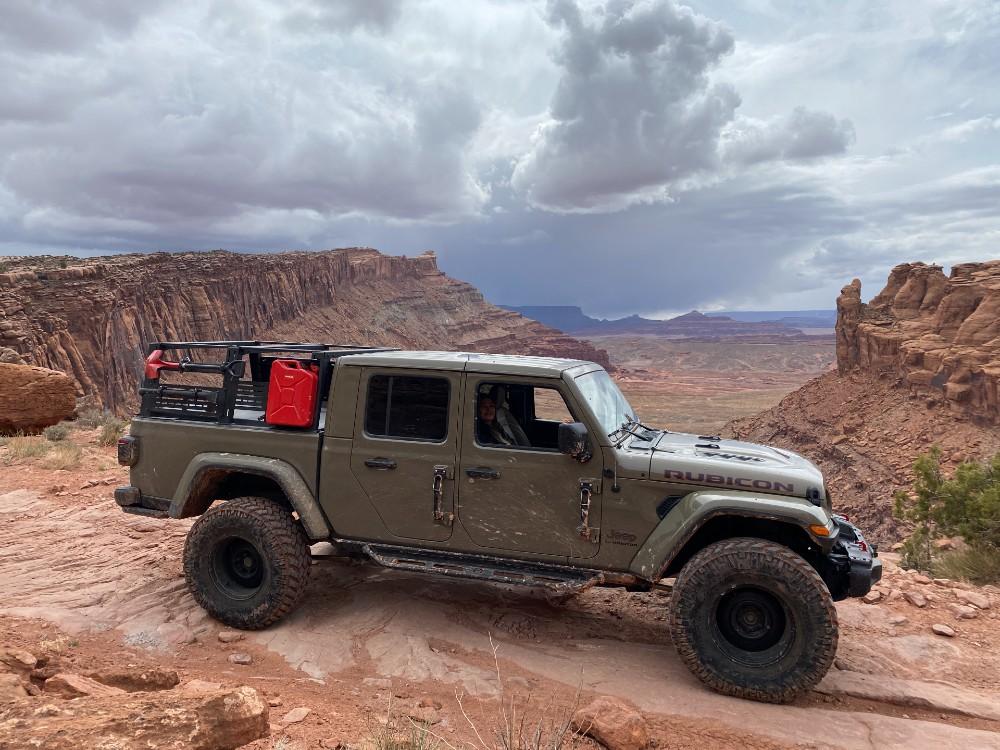

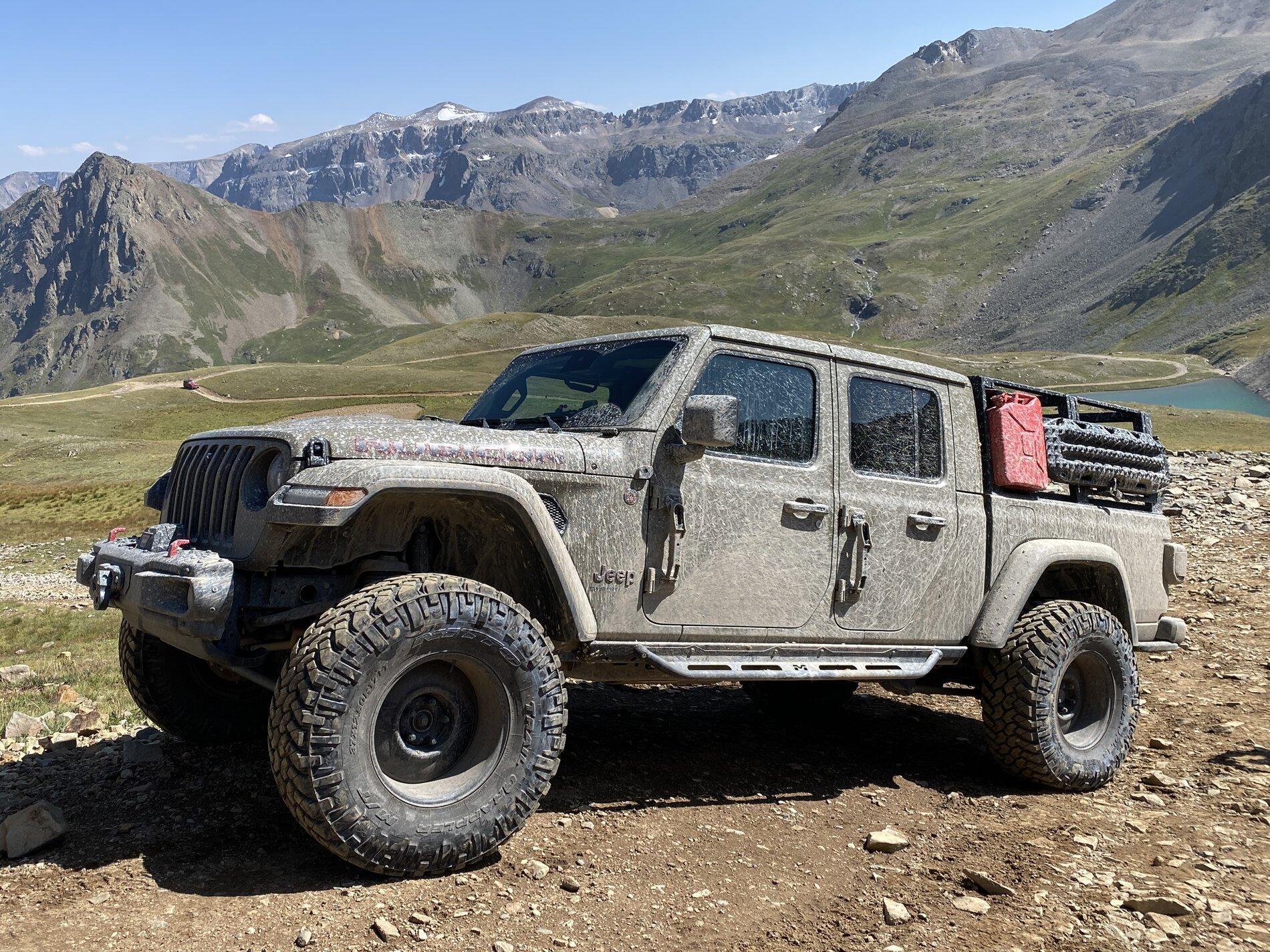

Here is how it looks today at the top of Yankee Boy Basin.
