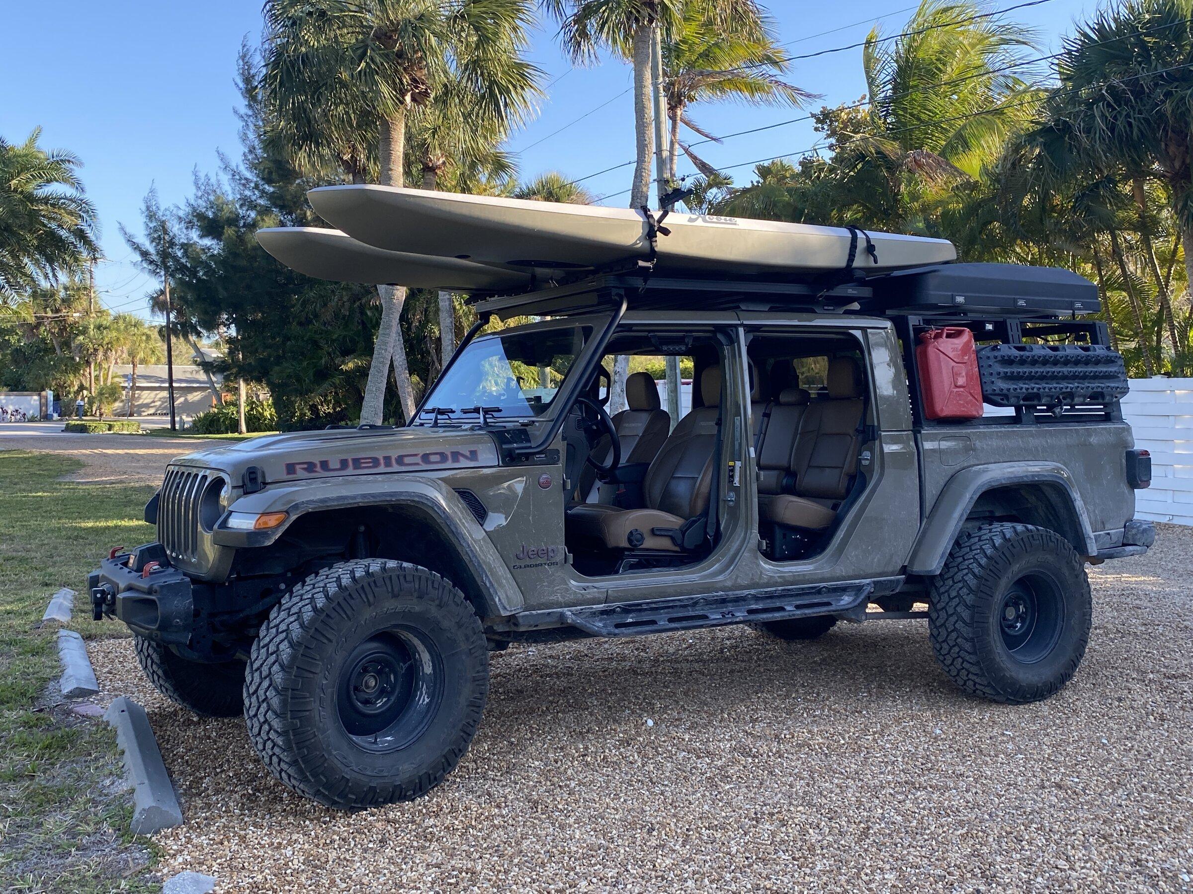

Took delivery last month. I wanted a Gator Gladiator so I figured it was time to buy before I couldn't get a new one anymore. Found a loaded one on the lot in Texas and had it shipped to Florida.
Our goal is to have an off roader that can tow our camper easily. We have a JKU currently that we have taken all around the states a few times. We recently bought a T@B 400 Boondock camper and it's at the limits for the JKU. It actually tows it surprisingly well, but we can't take anything extra along or we will be a good bit over the legal limits. The Gladiator is going to be the perfect fit for us. The JKU will go to our soon to be 16 year old.
We intend to take the camper to destinations and explore from there. It's not an off road camper, but it has a kitchen, a/c, shower, etc. All the comforts of home.
This is as it arrived.

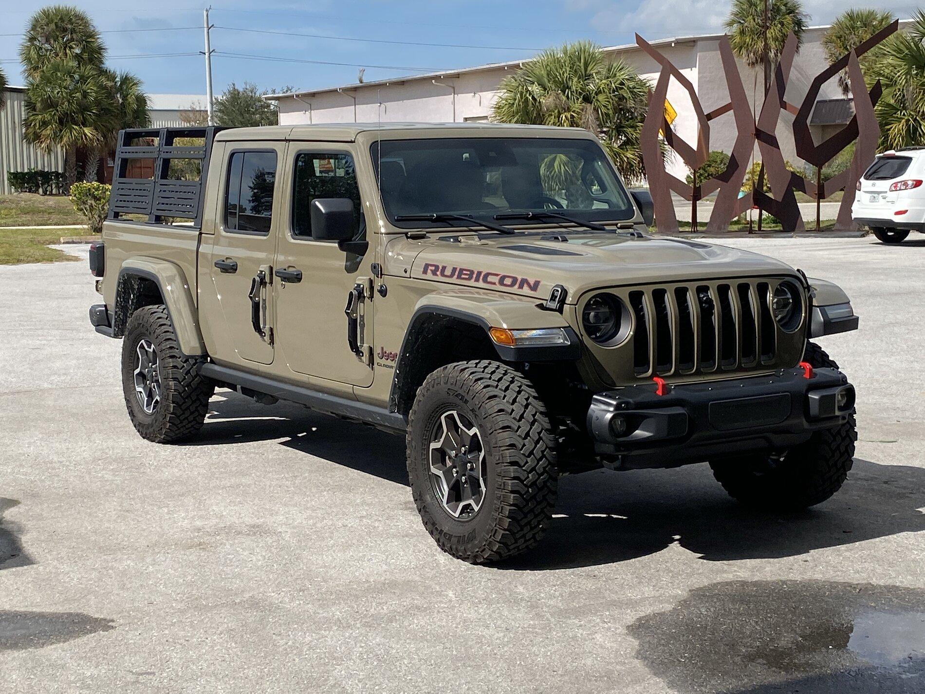

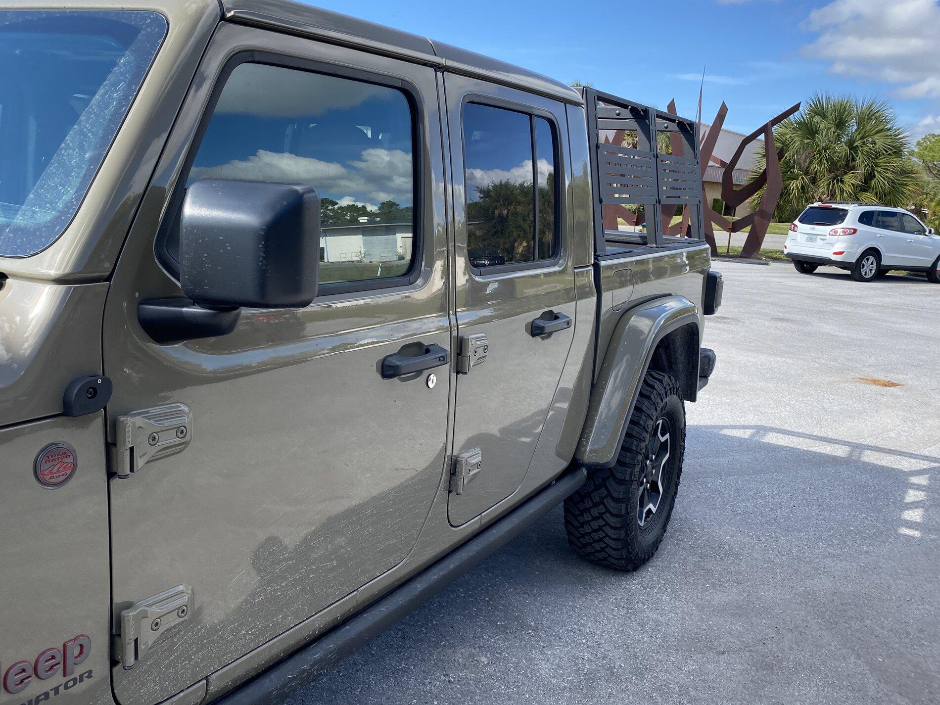

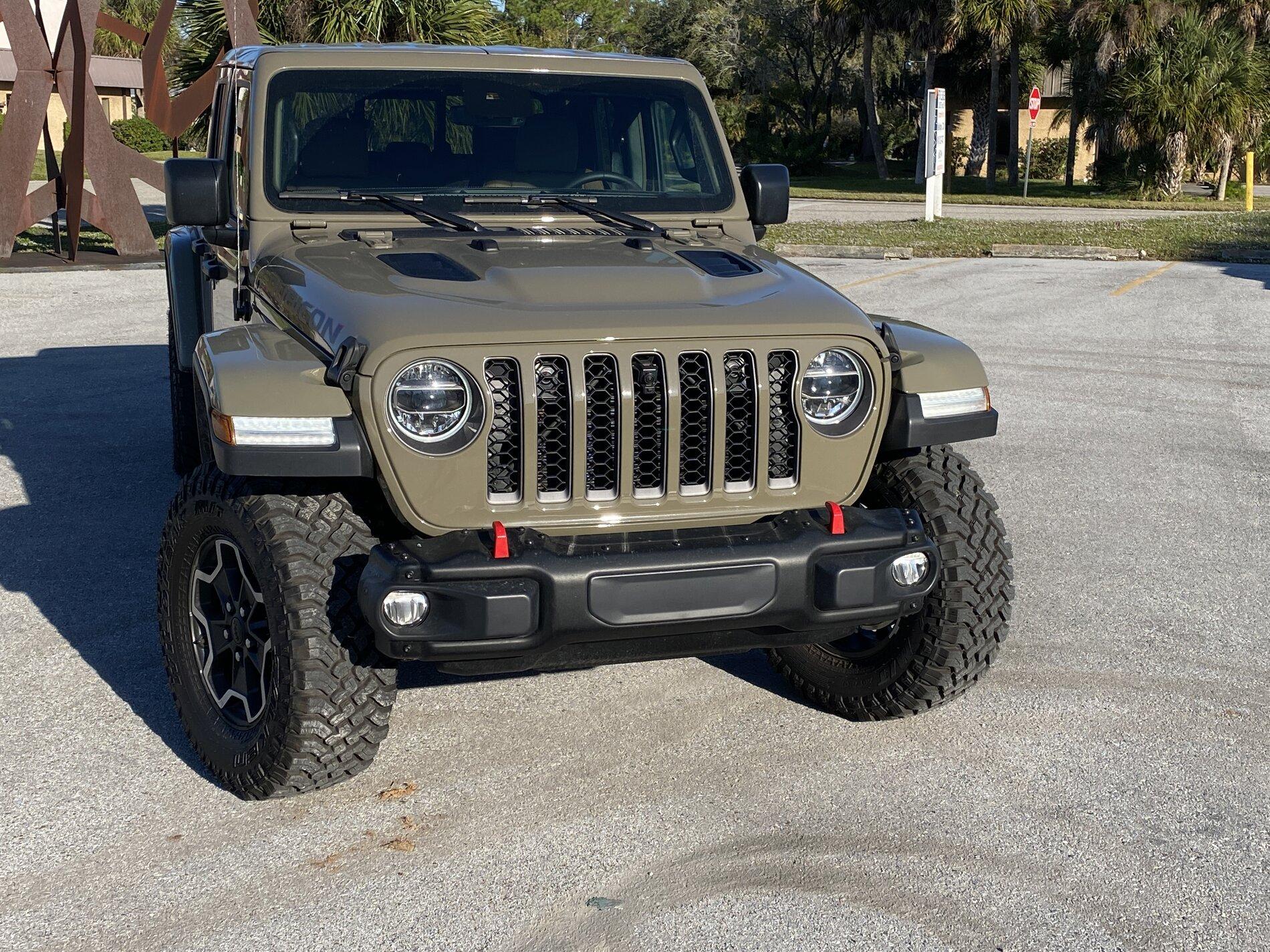

Front bumper wings removed. Very easy job. Just be sure to look at the bolts when you take them out. Two are longer on each side than the others. Want to be sure to put them back in the correct place (the front).

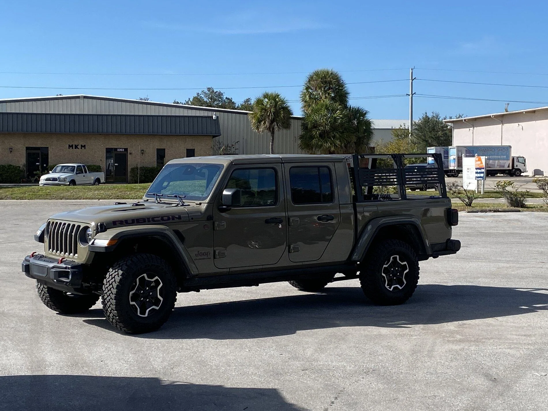

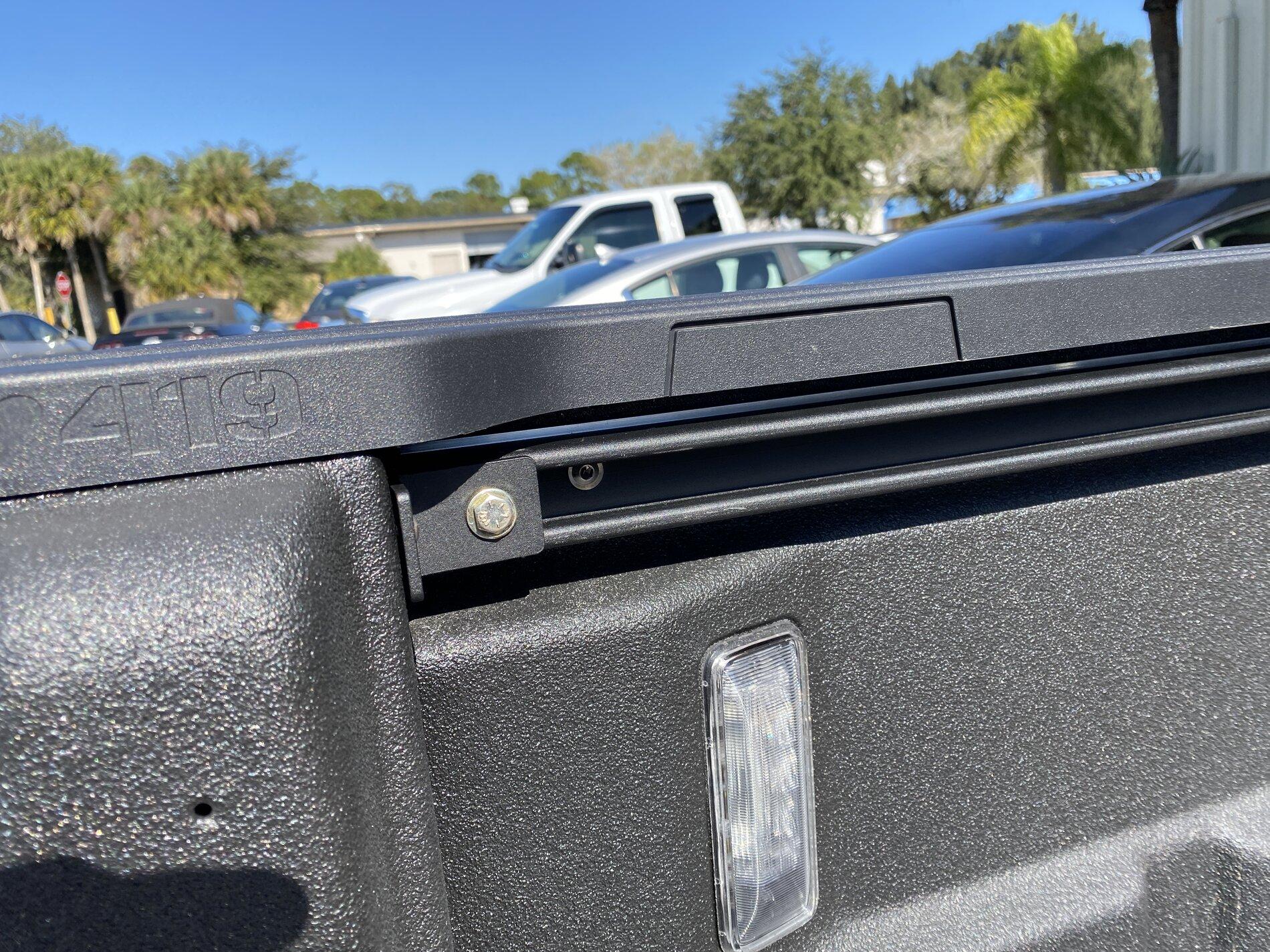

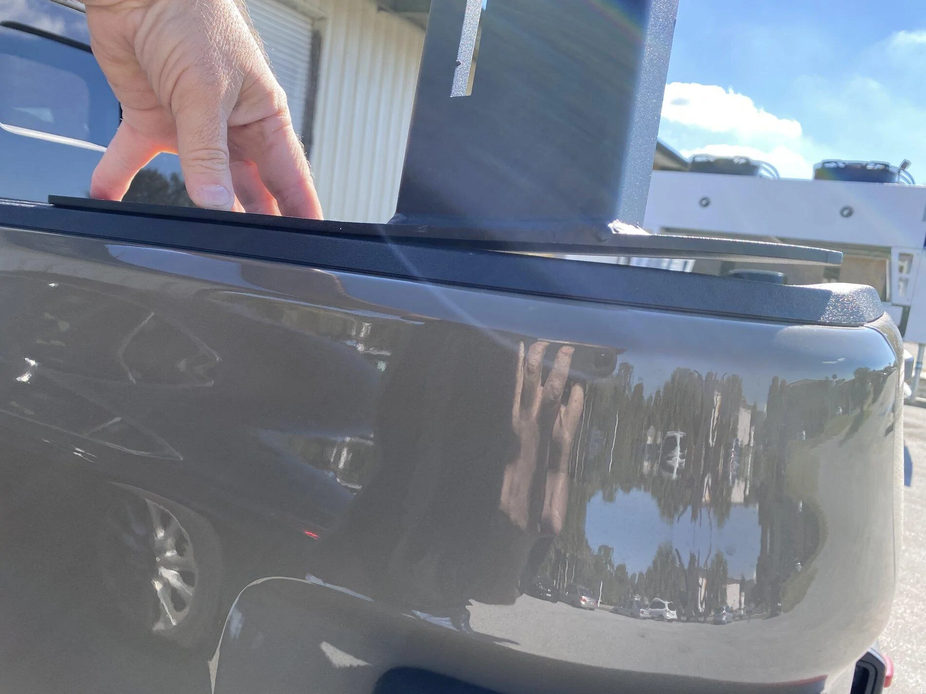

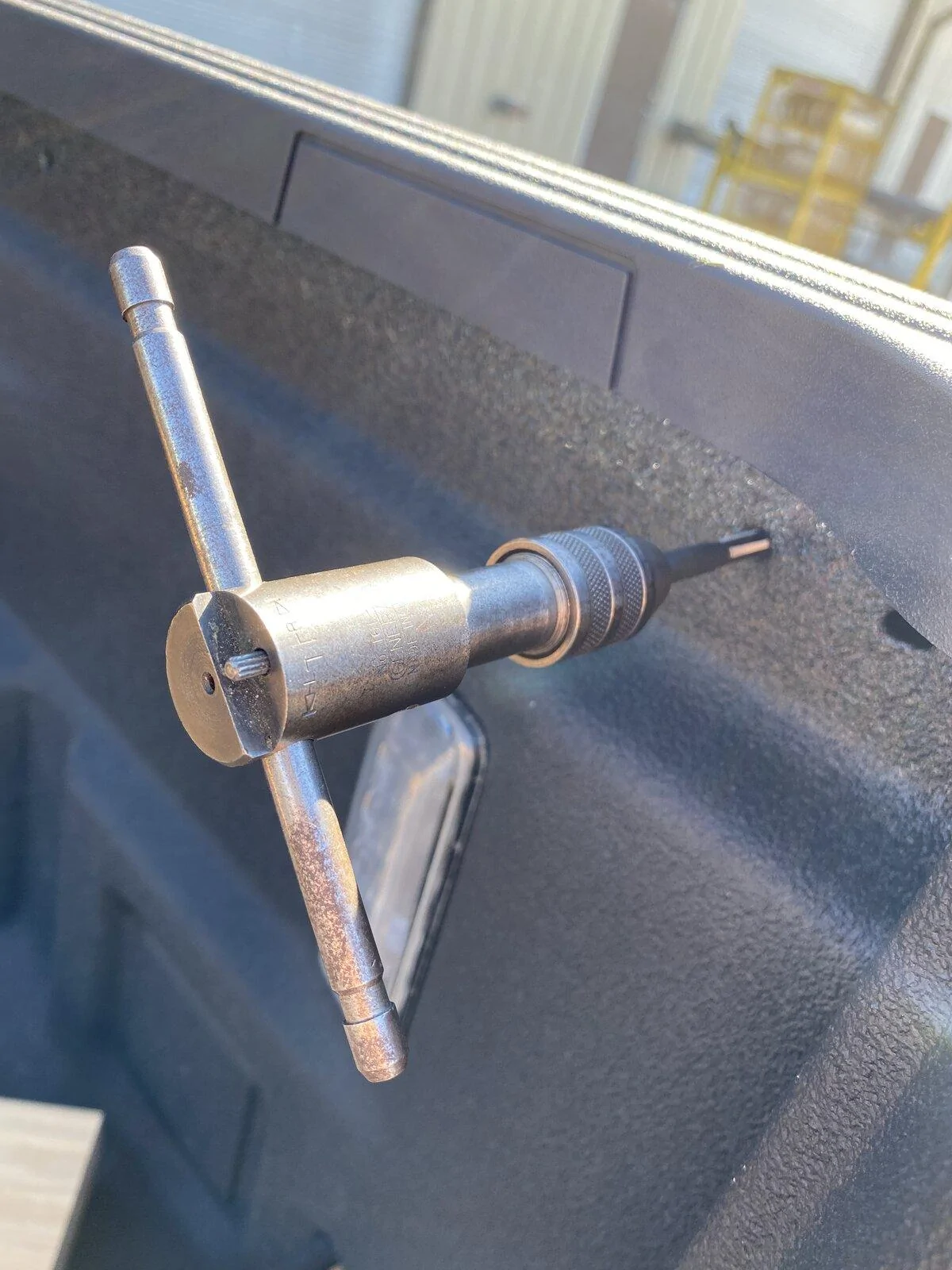

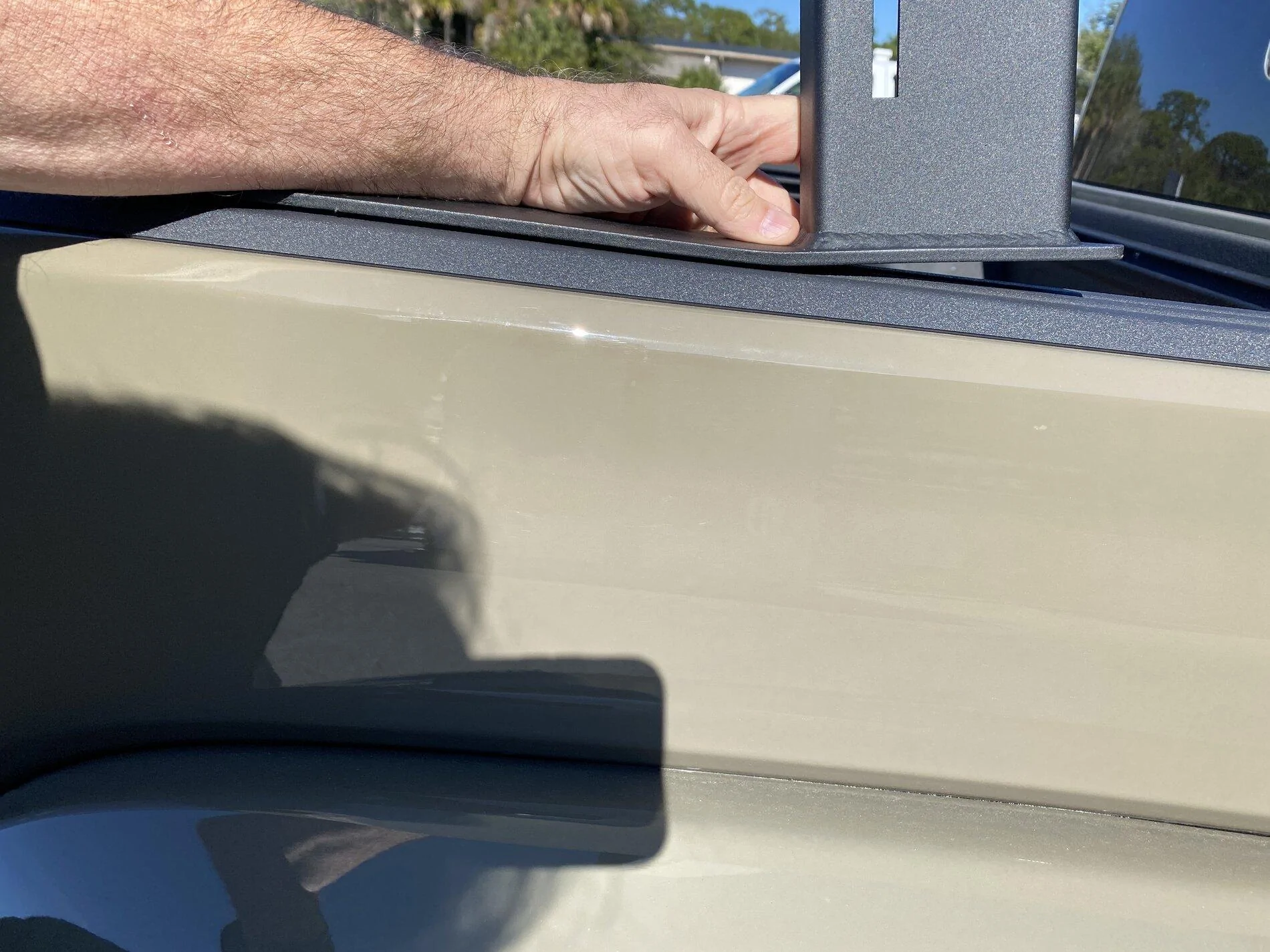

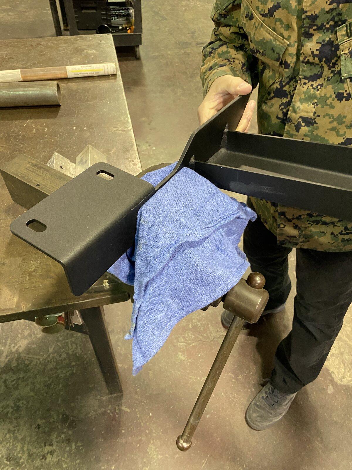

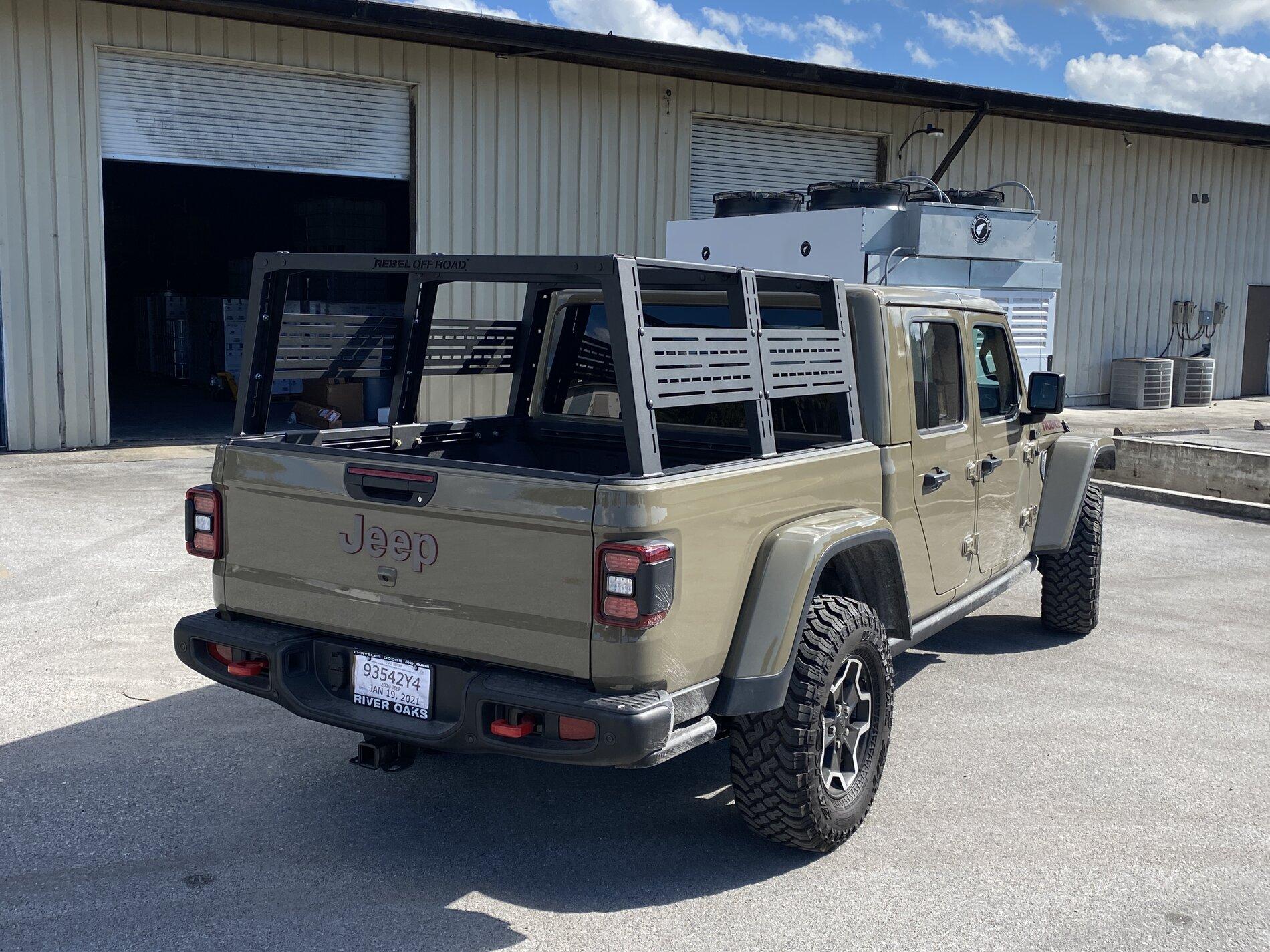

Installed the Rebel Off Road bed rails and full height XPLOR rack.
They were both easy installs. I had to clean out the bed liner that had been sprayed in at the factory from the rail install holes. I chose to use a tap as the instructions called for and was careful to keep it aligned straight. It cleaned out the holes perfectly with no damage to the threads.
The XPLOR rack is an easy install as well. It is a very high quality build and came packaged well. Strangely there were three pieces that needed to be straightened before installing them. They were not damaged during shipping and were packaged well, but somehow must have slipped past QC. It was an easy fix by putting a towel around them and using a vice to hold them for bending back into place. See the pics below.
The instructions are very well written with illustrations to match. The hardware is all packaged and labeled in separate bags. Makes for an easy install. I haven't seen if they put instructions for the install of the standoff mounts for inside brackets in there somewhere. They were not in the main installation instructions. Could be in one of the boxes still. I will check later.
There are only two things I would change about this rack. First, I prefer not to have company logos on my Jeep. In this case I will have the machine shop next door cut/powder coat a plate to fit over the logo cutout. Second, I would prefer the upper corners to angle more like I have seen on some other racks. I will probably just live with that since I love the rack anyway. But maybe at some point I'll have my buddies with the machine shop modify that for a less tall appearance.
Overall an excellent rack. I am happy with my purchase and can recommend it to others.

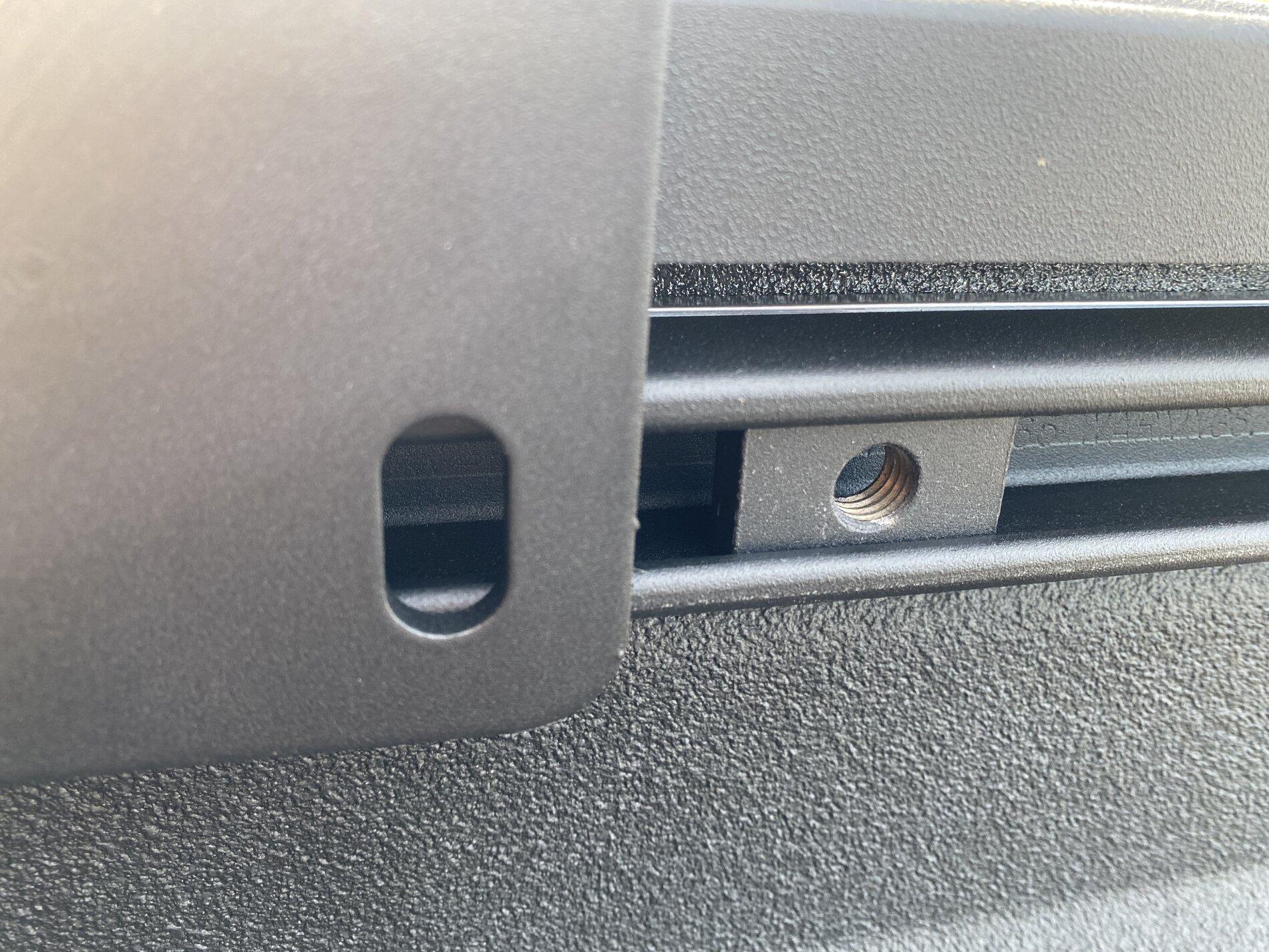

In the picture above you see how the rack attaches to the bed rail. I found it easiest to get the threads started if you get something to put behind the receiver piece to hold it forward. Otherwise it pushes to the back of the rail and it's harder to get started. I just used a small wrench but many things will do.

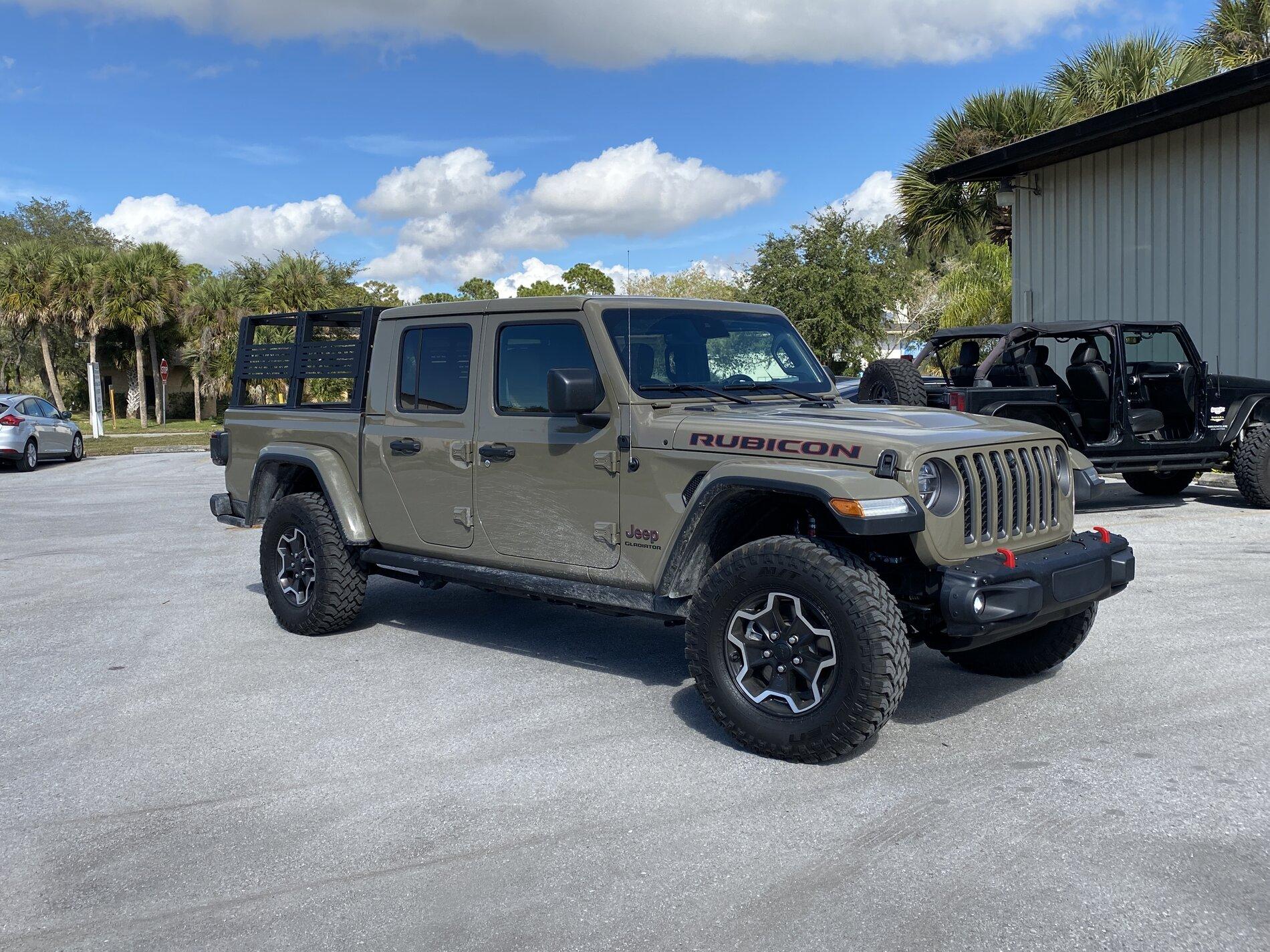

Tires arrived! The wheels are not here yet. Damn these are gonna look good! And get me over bigger rocks!
Nitro Trail Grappler 37 x 12.5 x 17. I have the same but 35s on my JKU and love them.

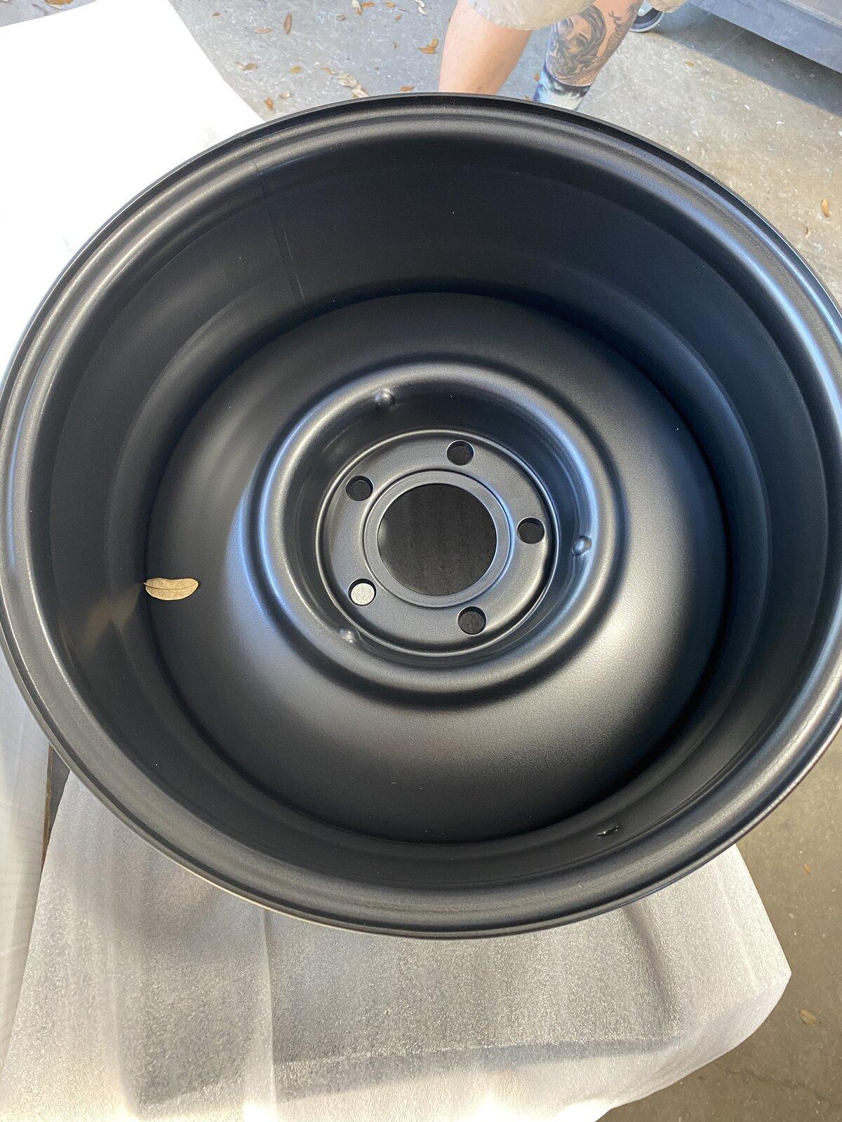

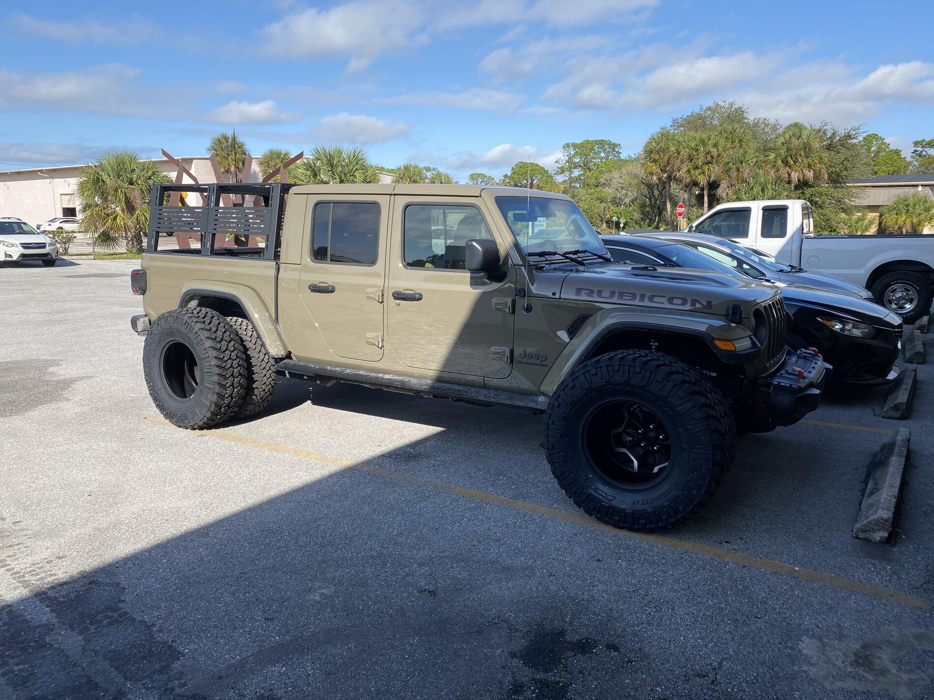

Just a little catch up here. Wheels finally arrived and have been powder coated. I went with Wheel Vintiques Smoothies reversed. 17 x 9 with a 4.25" backspace. They are matte black.
Installed Metalcloak hinge steps to make it easier for strapping stuff on the roof.

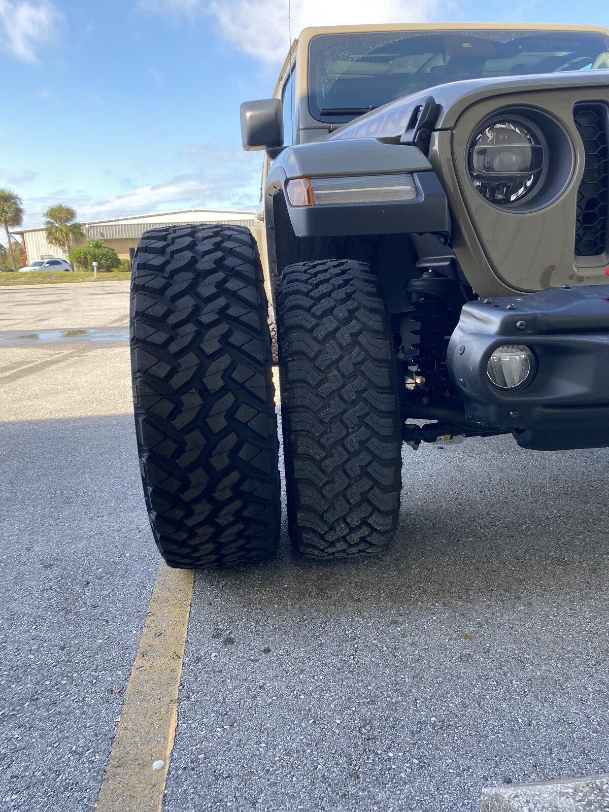

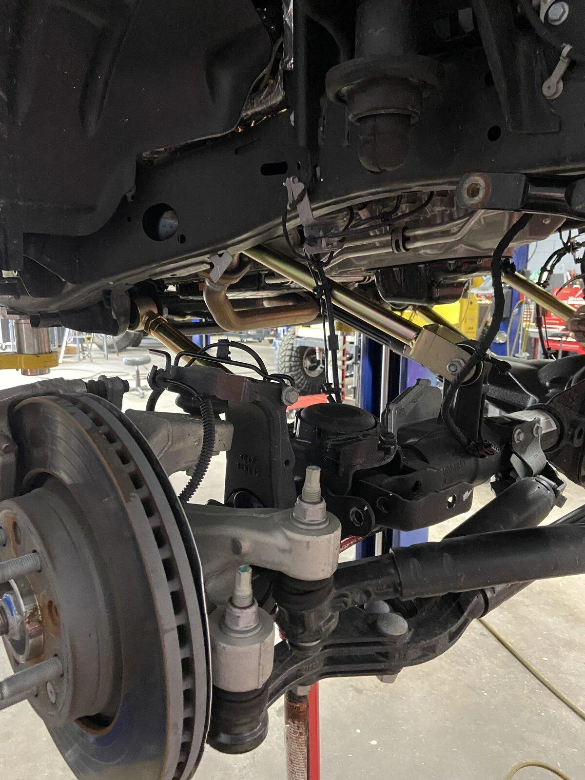

Wheels, tires, and Metalcloak 3.5" Gamechanger lift are going on at the moment.

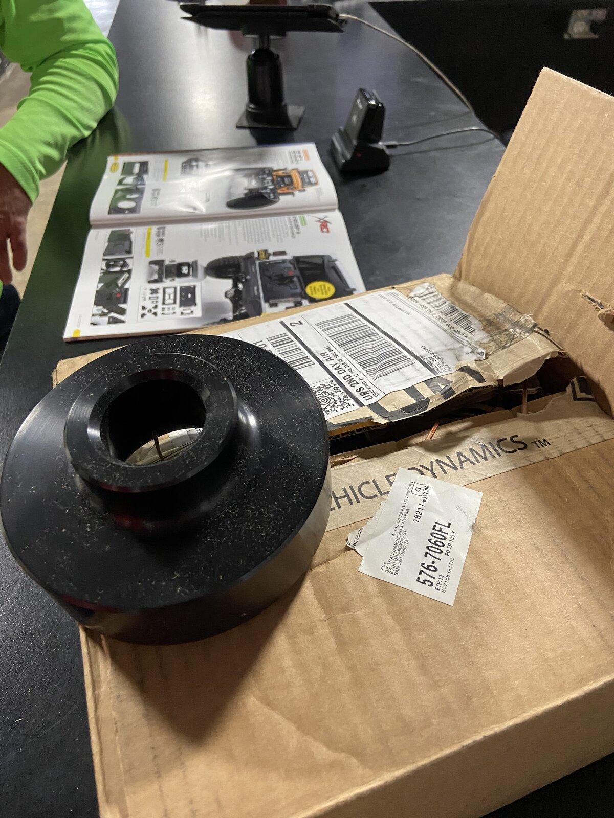

Going to try Icon coil spacers in the rear to compensate for extra weight that will be back there and to keep a little factory rake. If it sits too high we'll take them out when the gears get installed in a week or two.
