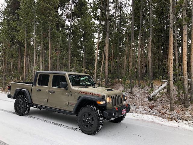

Took delivery last month. I wanted a Gator Gladiator so I figured it was time to buy before I couldn't get a new one anymore. Found a loaded one on the lot in Texas and had it shipped to Florida.
Our goal is to have an off roader that can tow our camper easily. We have a JKU currently that we have taken all around the states a few times. We recently bought a T@B 400 Boondock camper and it's at the limits for the JKU. It actually tows it surprisingly well, but we can't take anything extra along or we will be a good bit over the legal limits. The Gladiator is going to be the perfect fit for us. The JKU will go to our soon to be 16 year old.
We intend to take the camper to destinations and explore from there. It's not an off road camper, but it has a kitchen, a/c, shower, etc. All the comforts of home.

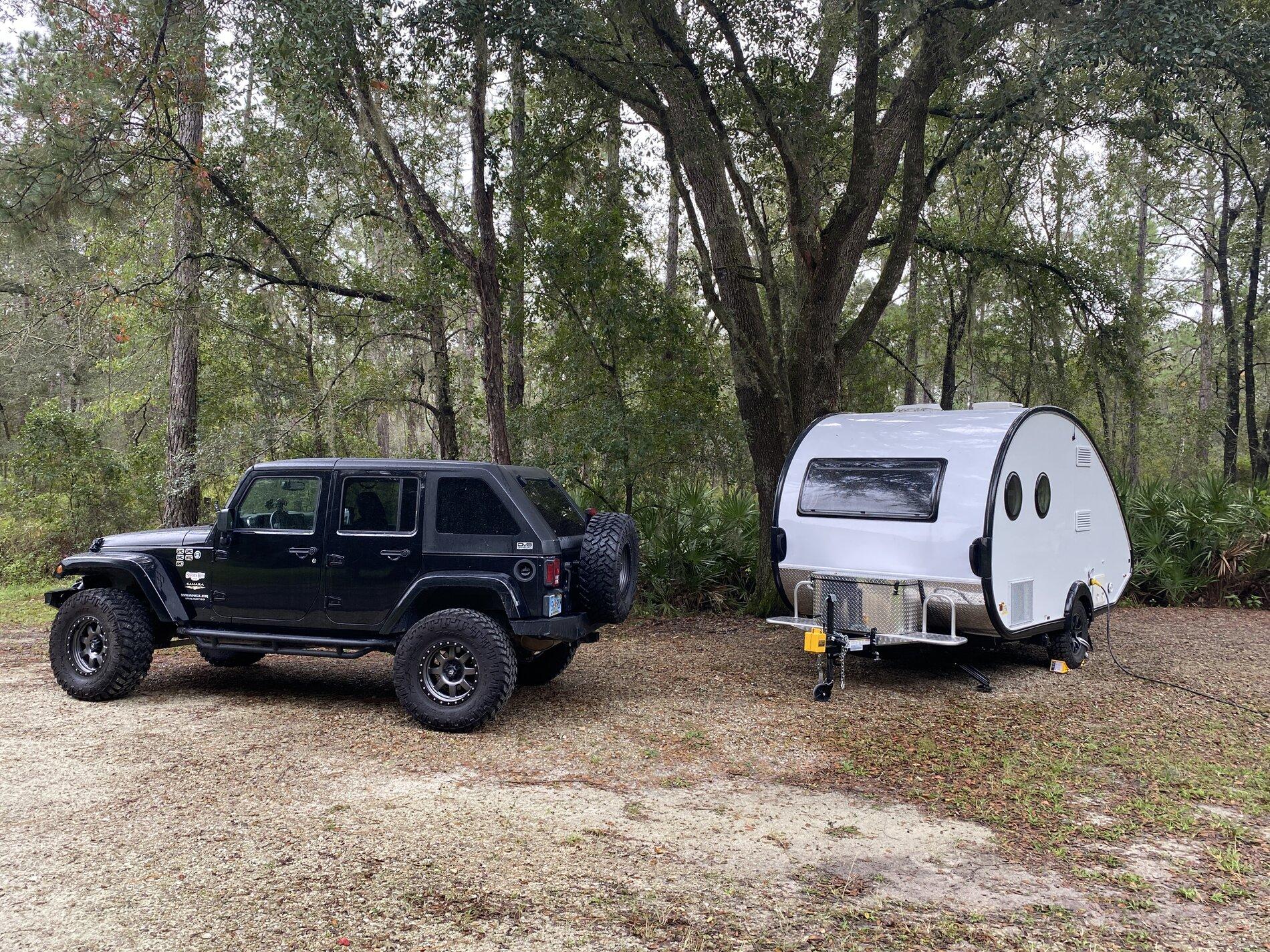

Here is our JKU with our little camper. We are putting flat fenders on the JK at the moment. Also re-gearing.

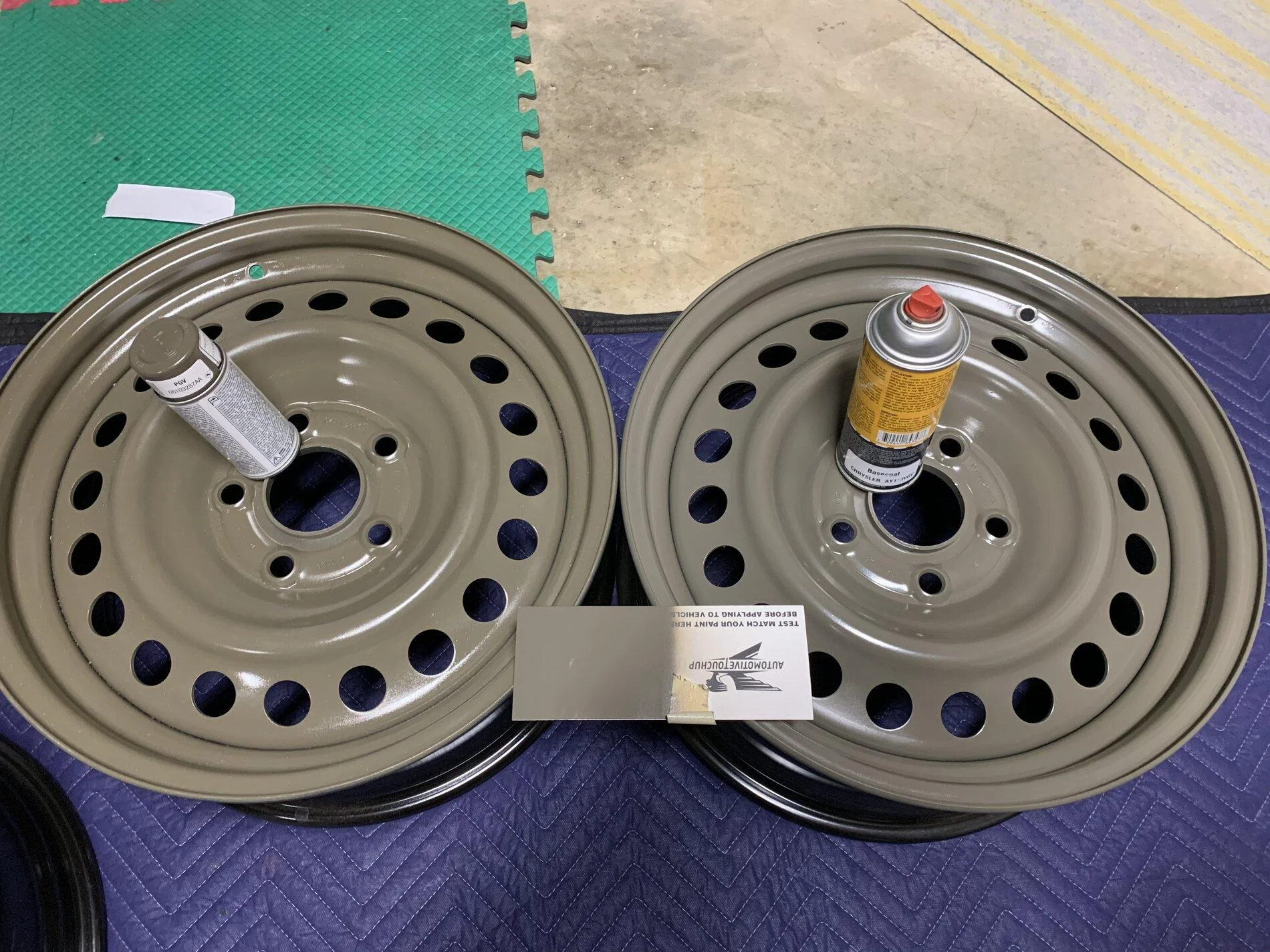

Love your Gator build. I was also looking at the Wheel Vintiques Smoothies but am going with the STeel spare wheel look. I am sticking with skinny tires (35x10.5 or 35x11.5)
That's a good option also. I considered it as well. Either way will look great.

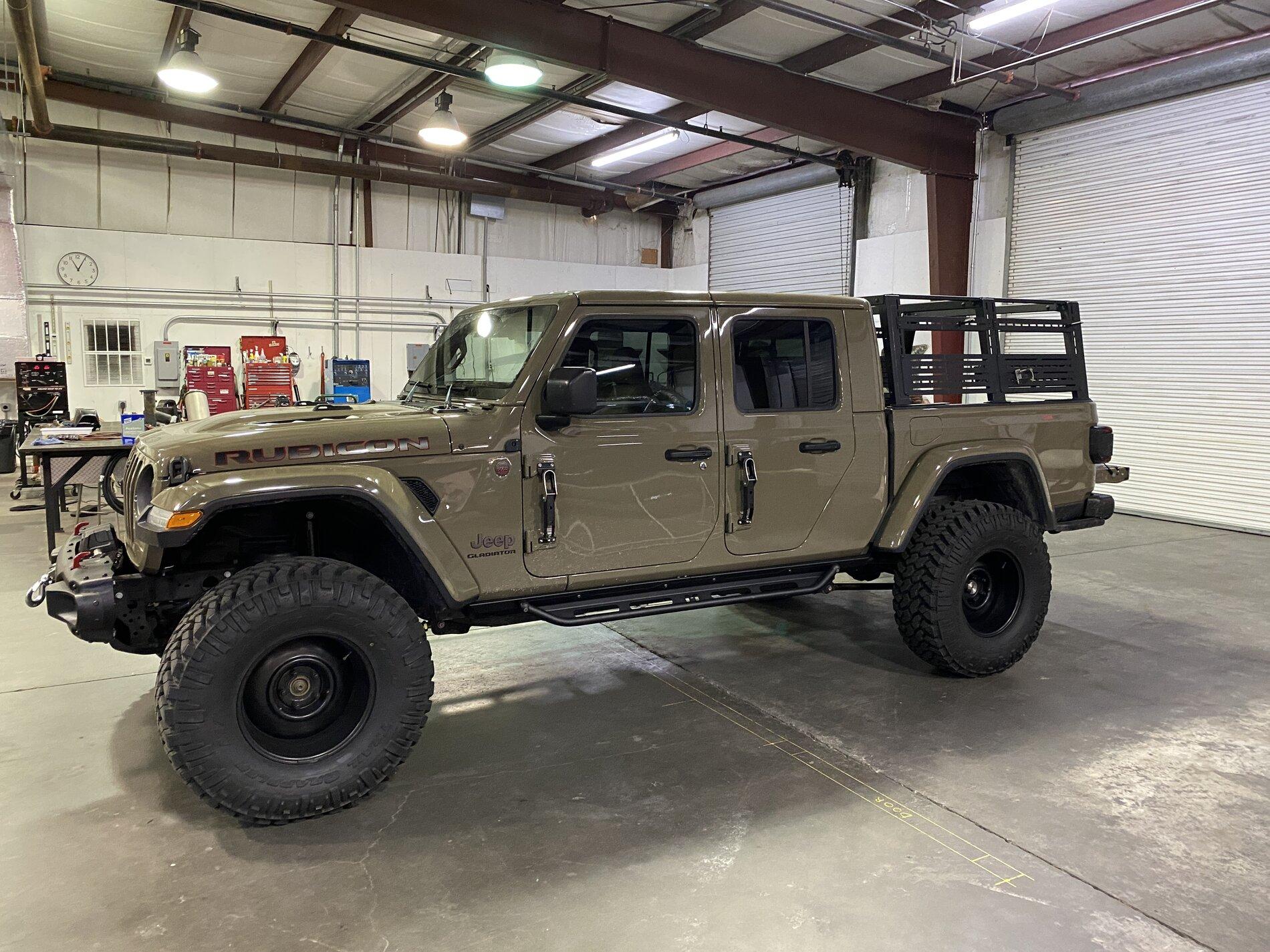

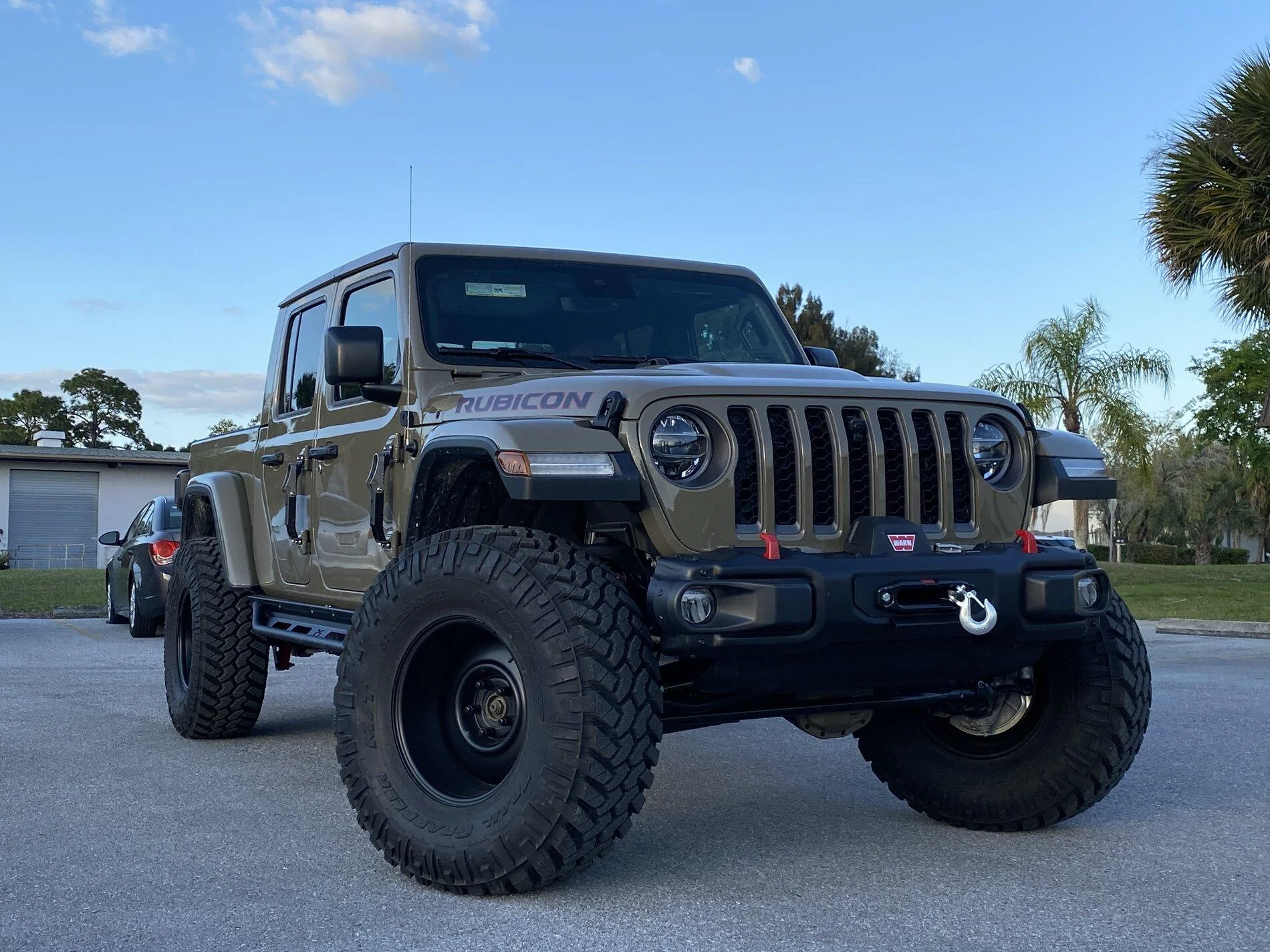

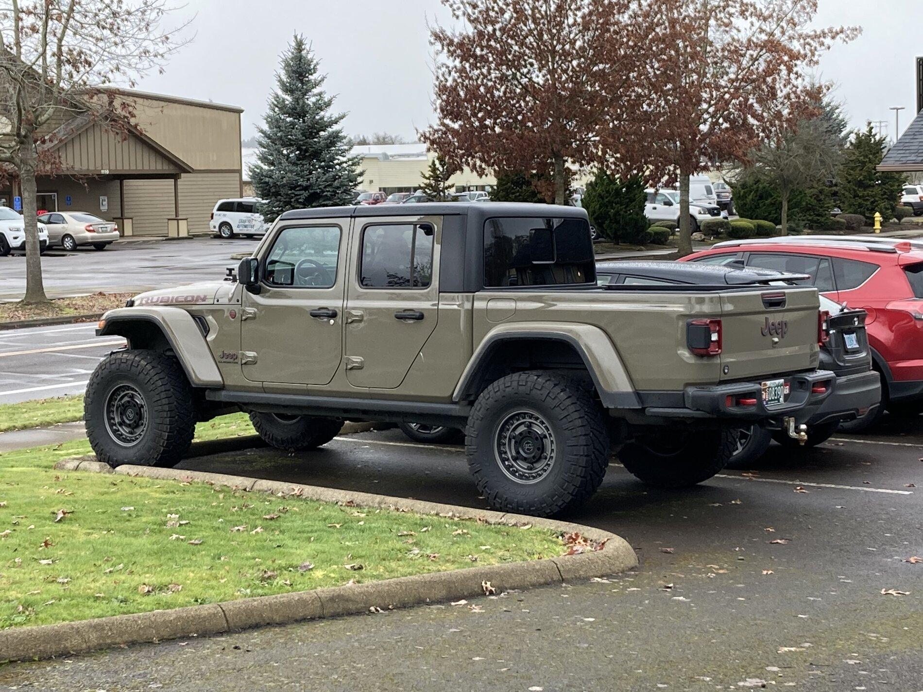

Current look.

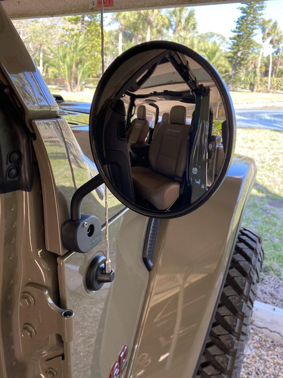

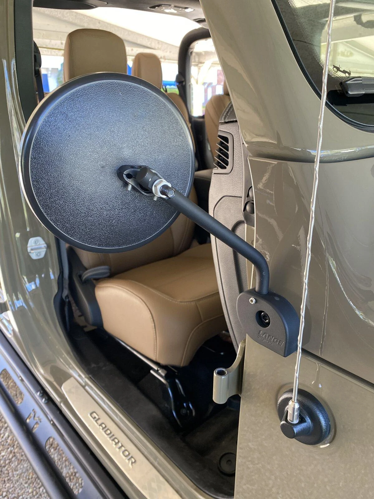

Tested out the doors-off mirrors. Lange Coyotes. They worked great. No vibrations so far but I haven't been to freeway speeds. They are very convenient since you leave the black block installed on the cowl. You can use them with a hand screw or a hex screw to hold them in place. Apparently the hand screws don't always hold well. I used the hex for mine. The mirror is convex so you get a really good field of vision.

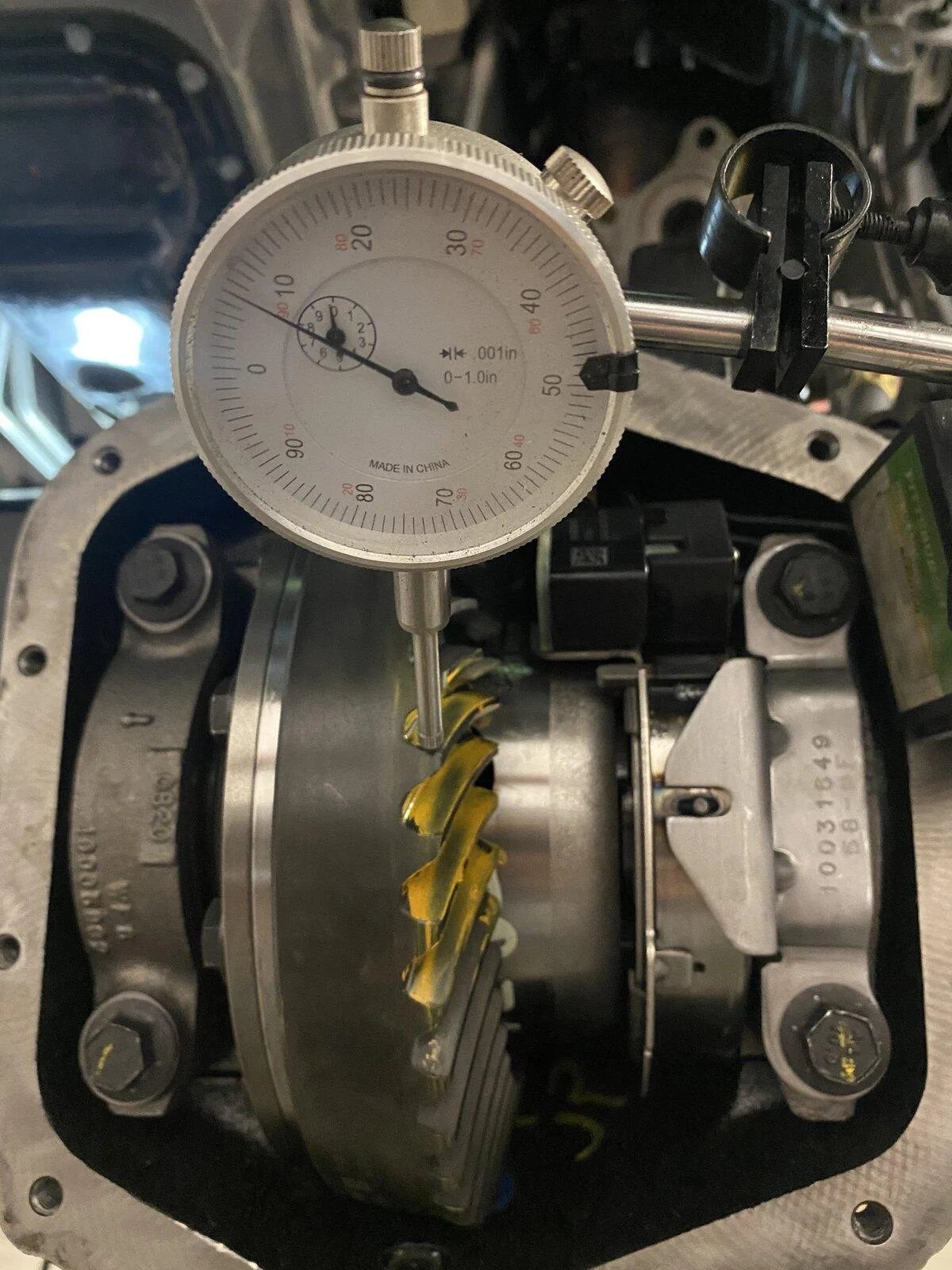

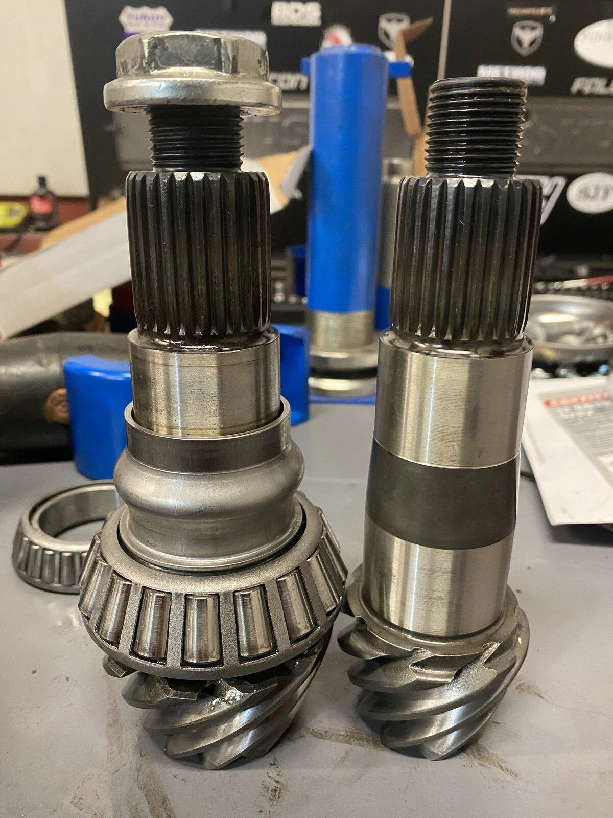

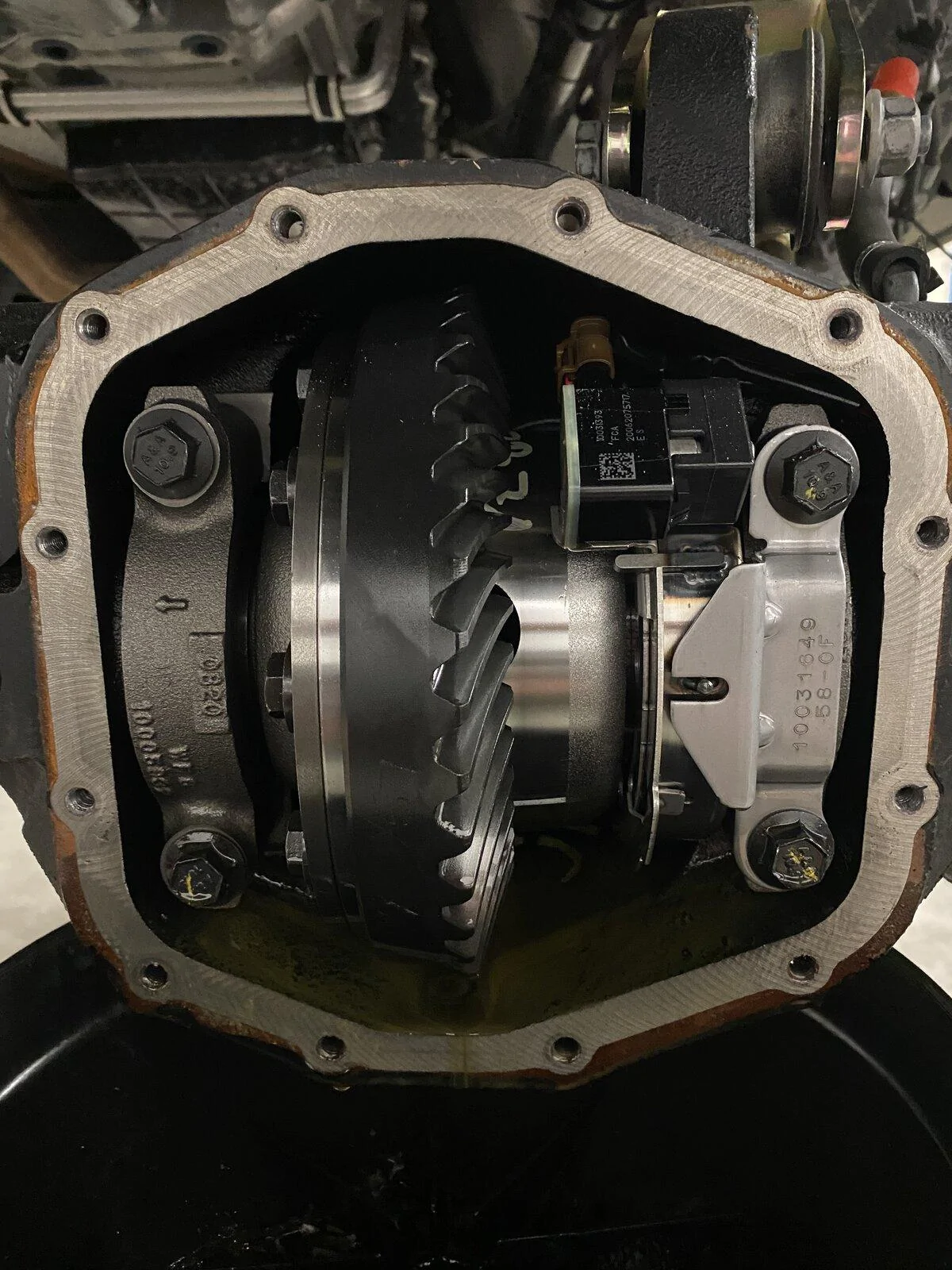

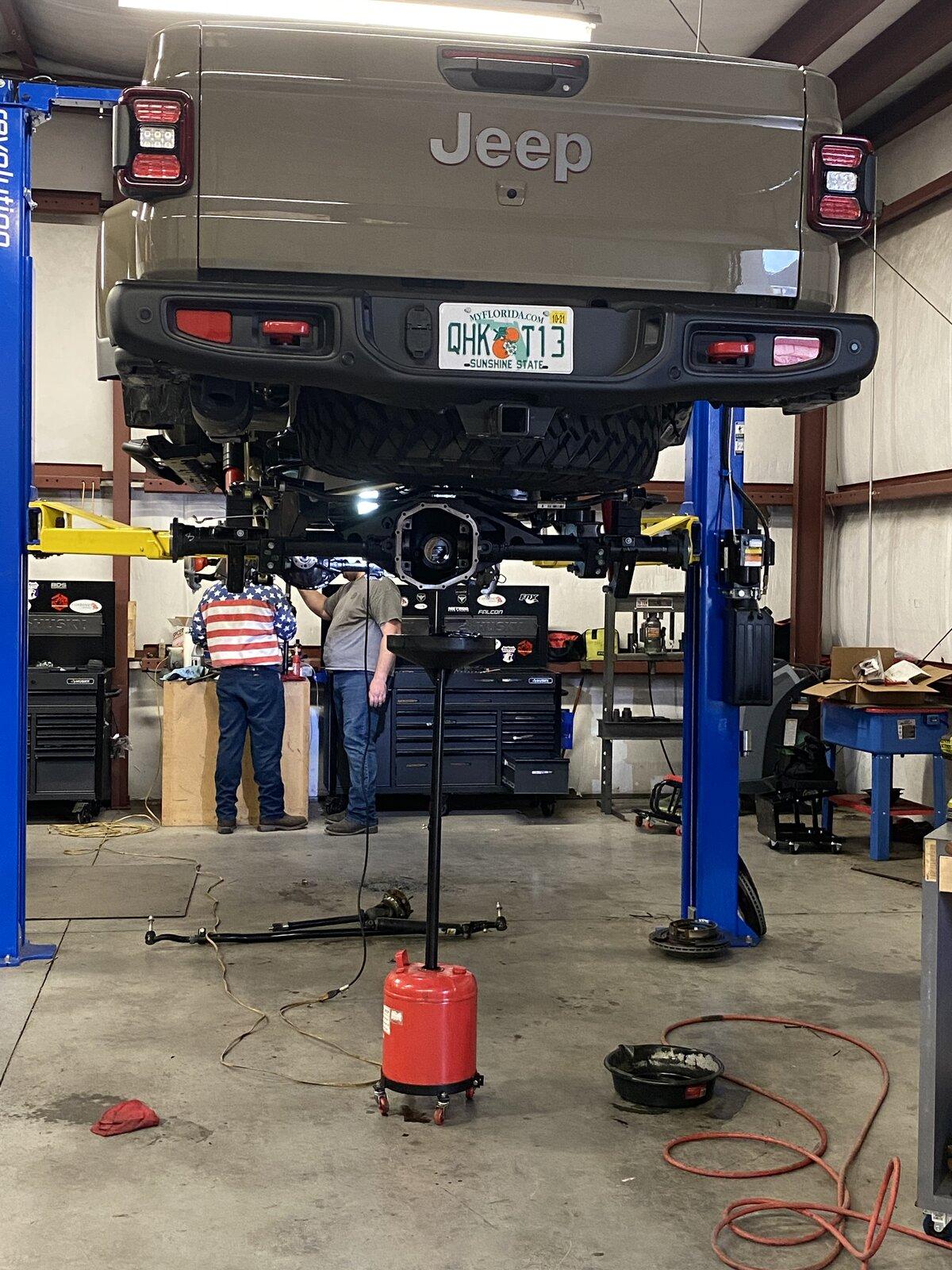

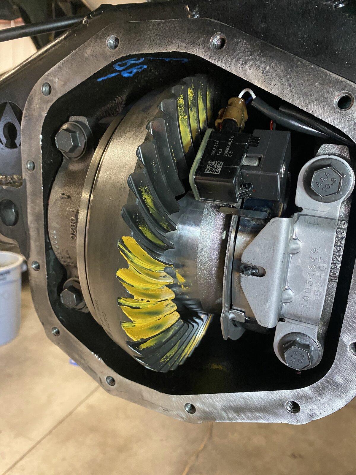

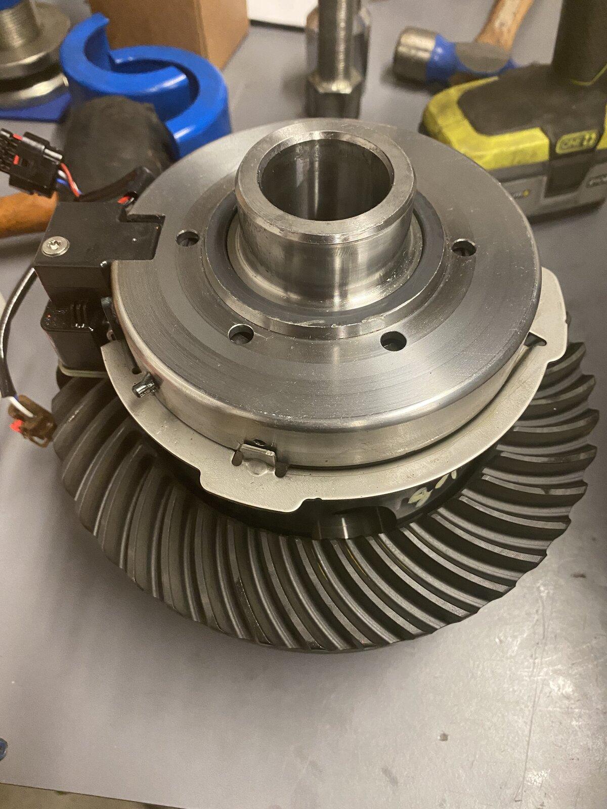

Gears.
Went to 5.13 gears. There will be endless debate on what gears to get with 37s. Most choose 4.88 or 5.13. I chose 5.13s for a few reasons. Heavy wheels. Heavy tires. Camper. Trips in the mountains. Little time spent on the freeway when not pulling the camper.
I love the gears. While I could drive with 4.10 and 37s it is a lot more fun to do so with 5.13s

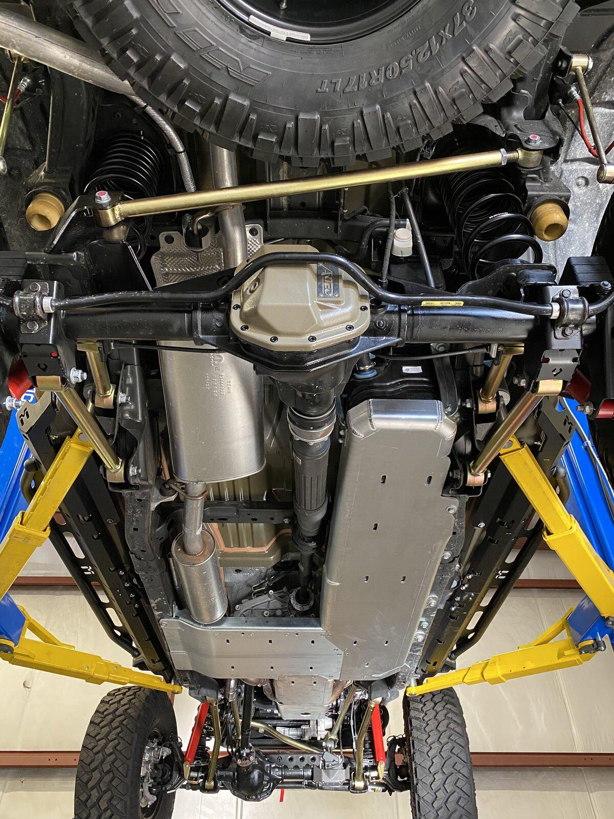

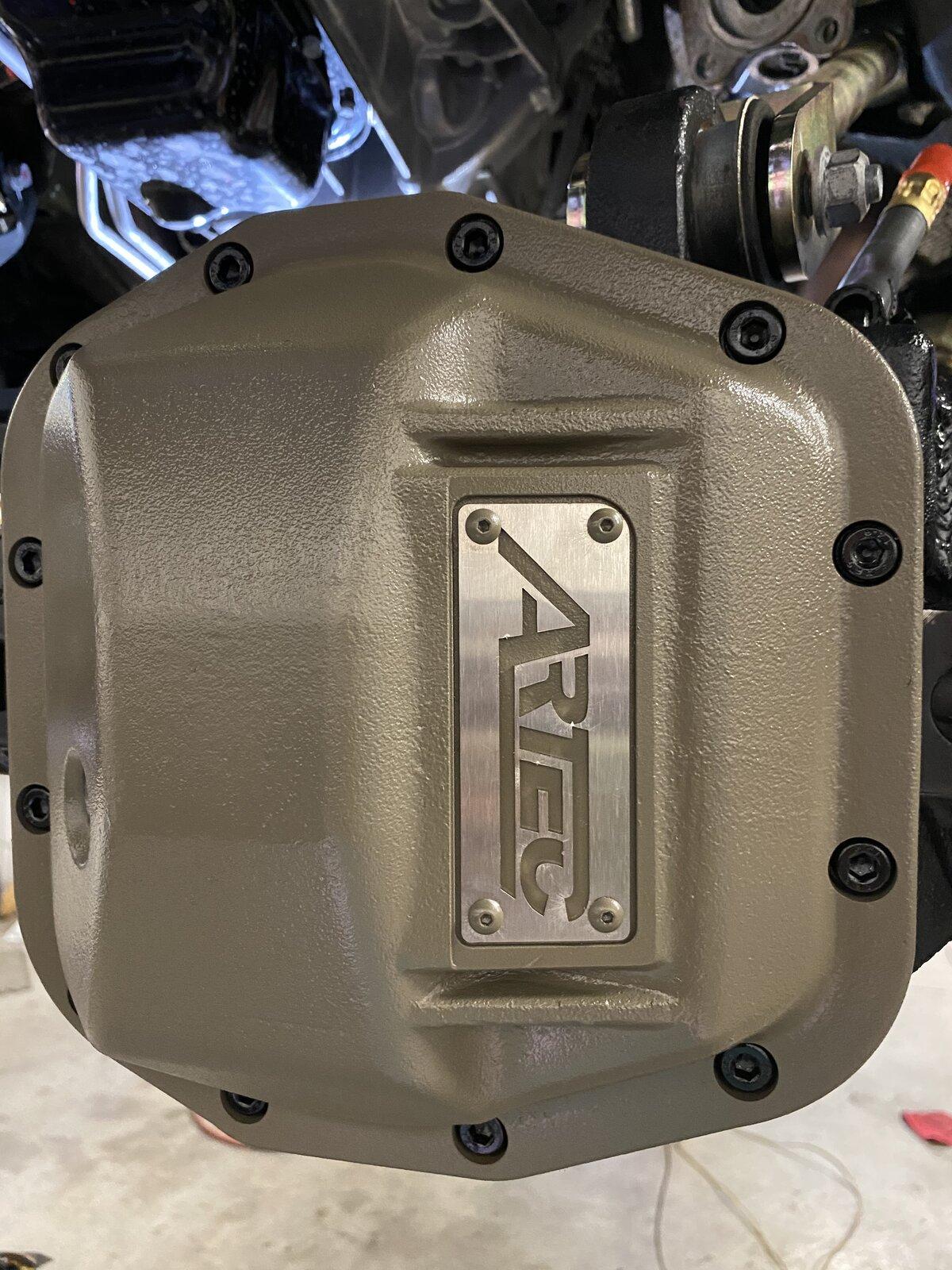

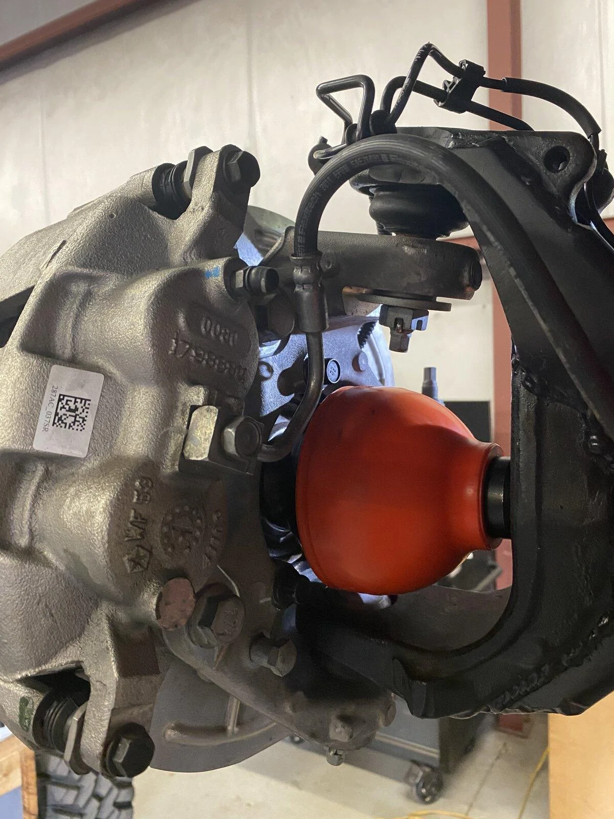

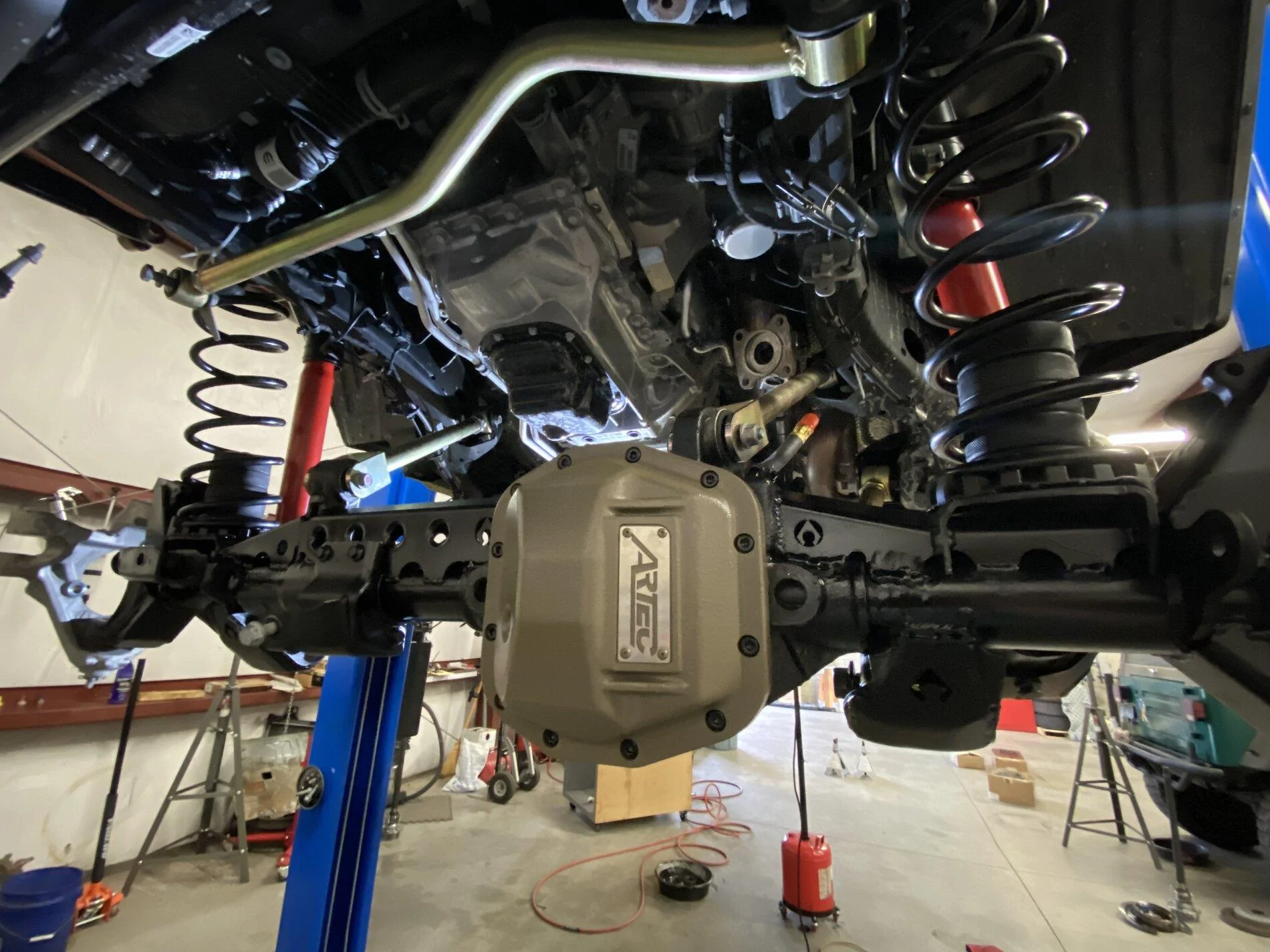

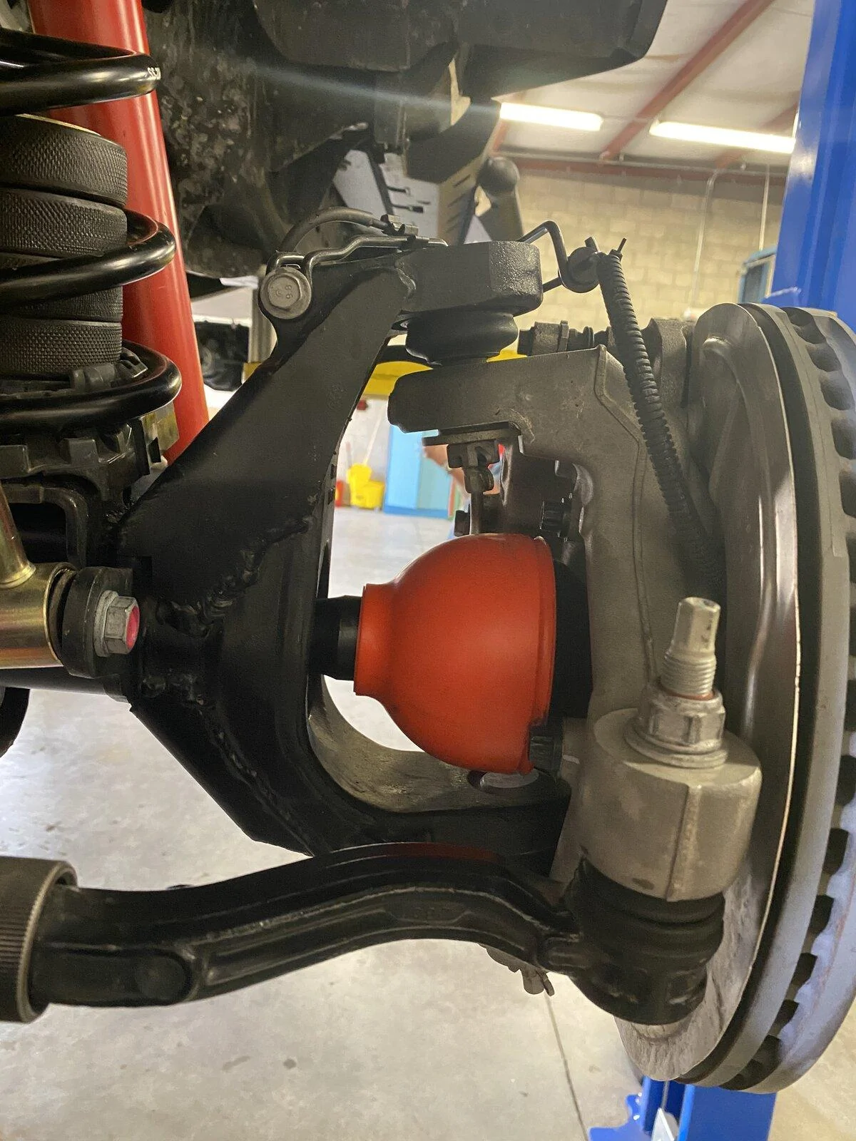

Axles.
Had Artec axle strengthening added front and rear. Trussed and gusseted.
Yukon chromoly shafts in the rear.
RCV with FAD in the front.
Artec Diff covers.

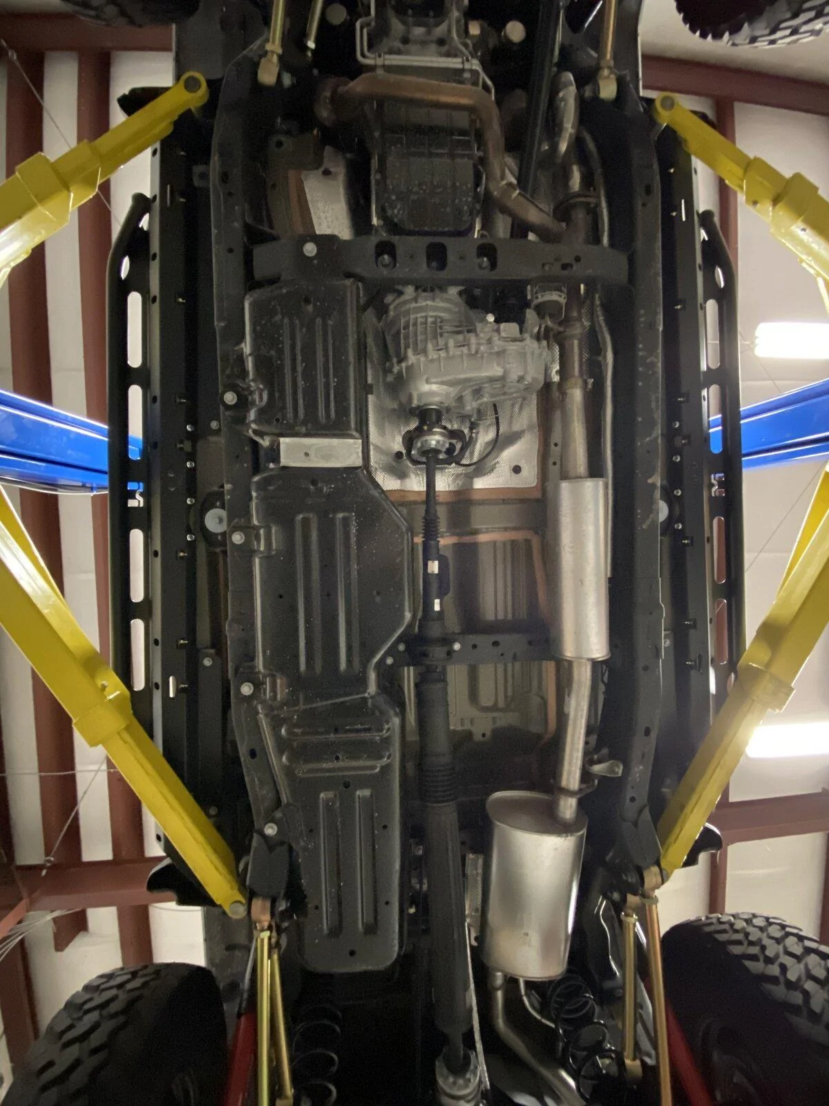

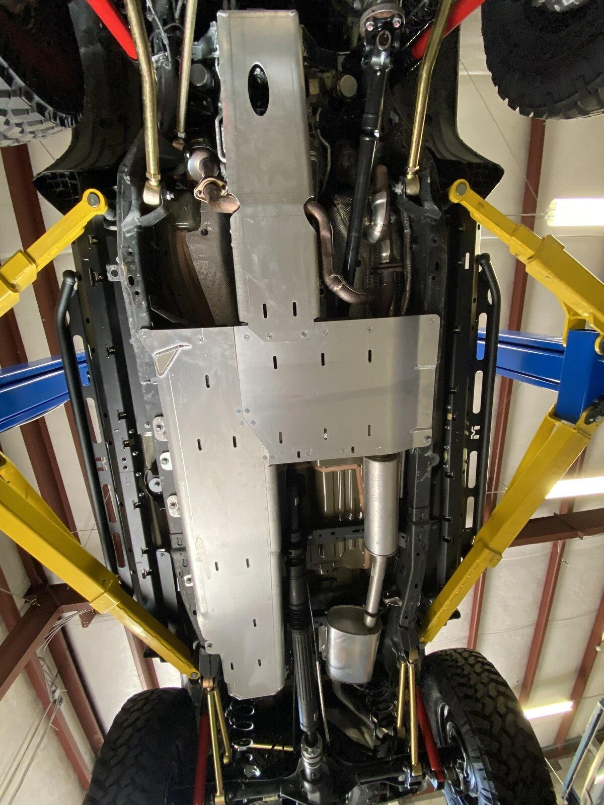

Skids.
Artec aluminum skids.
Artec LCA skids.
I chose Artec because of weight saving and a design with very little to catch on things. You only gain about 10 or 15 lbs total compared to stock due to removing the heavy steel gas can skid and replacing it with aluminum. Aluminum is softer and will take more damage with a beating but can always be pounded back into shape if need be.

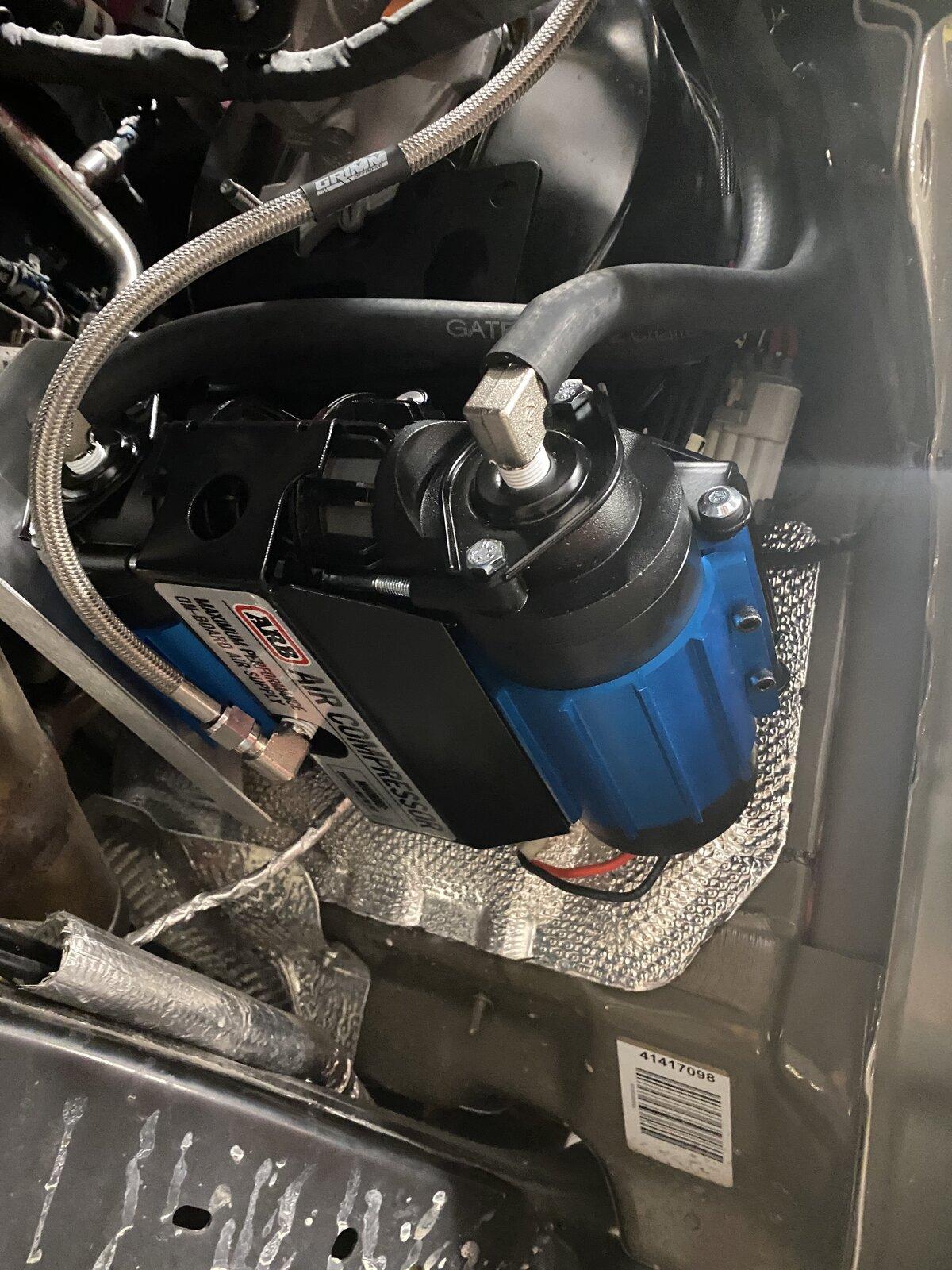

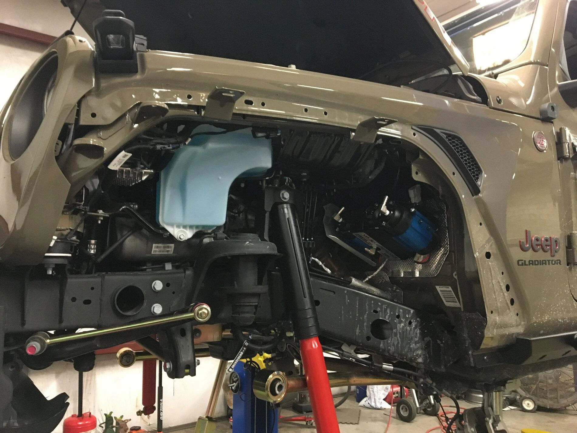

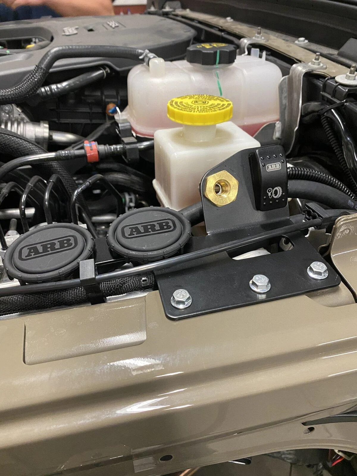

On-board air.
I went with an ARB dual air compressor. I chose to have it installed on the firewall behind the fender on the driver's side. We used a Grimm Off Road install kit.
I chose this location because I did not want it in the cab or in the bed. In the cab is just too noisy. Normally my wife sits in the cab while I air us back up. This thing is way to loud to do that with an under seat mount. I will be utilizing my full bed and didn't want to take up any space back there.
The downside of the install location I chose is that it is more susceptible to taking a bath if you are doing serious mudding. That probably won't be a problem for me. If it looks like it's going to be an issue we'll put in some protection of some sort.
Currently I only have the single point to attach a hose. I have plans to improve upon this system in the future.
