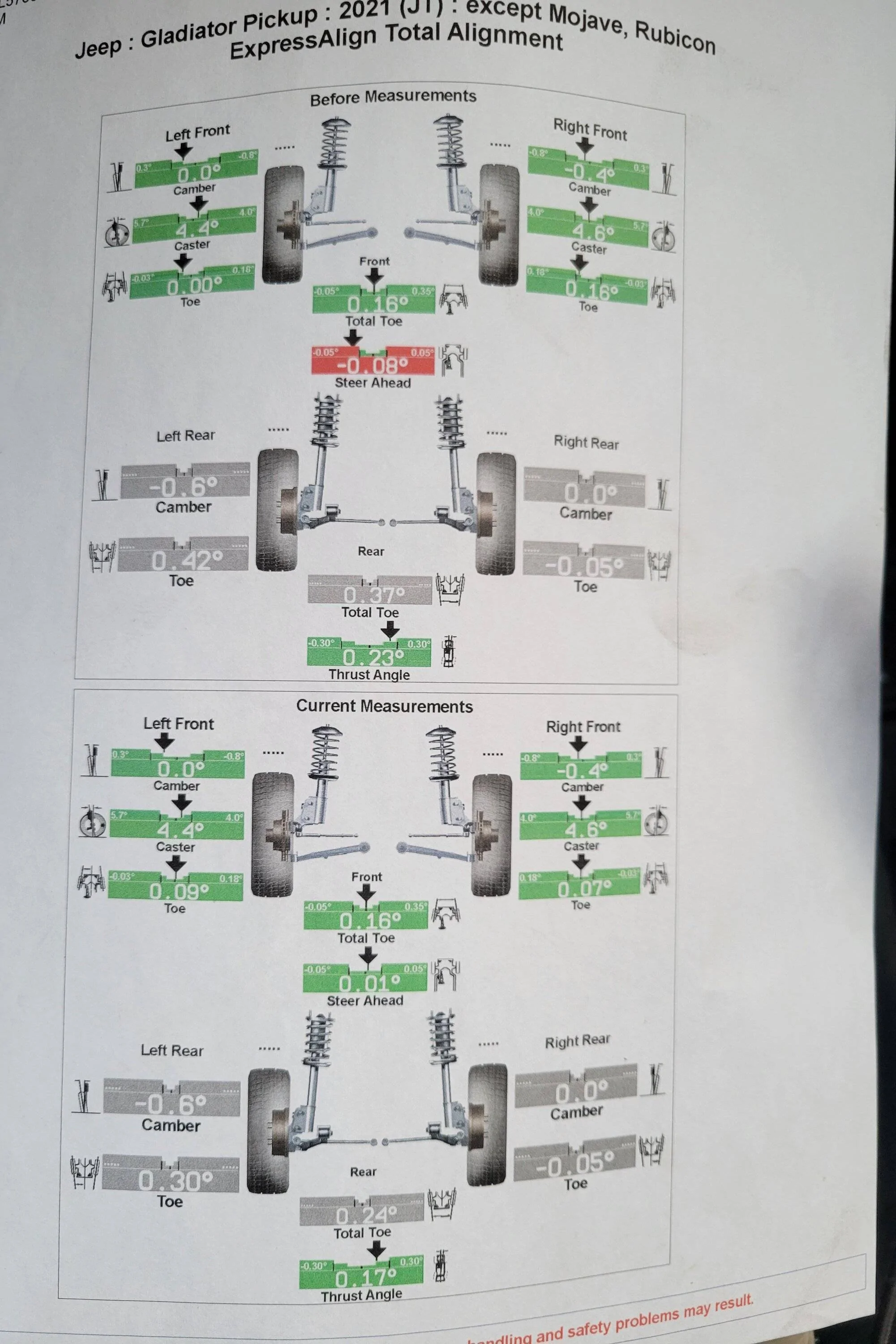

Georelocation brackets needed with these specs?
Vice
JD
Aug 10, 2023
North Carolina
2021 Gladiator Sport
Truck is as follows - Max tow , 2" aev spacer lift, bilstein shocks, and rubicon springs to get the rake close to level. Alignment was completed by CDT automotive. With these caster numbers would georelocation brackets provide much benefit?
Jeep Gladiator Georelocation brackets needed with these specs? 1000008362
Gizmo
Gary
Jun 23, 2023
551
480
West Creek NJ
22 Hydro Blue Sport S MT.
Retired Operating Engineer Local 825
On road I found the Rancho geo brackets had a better effect . Their was less steering correction required from crosswinds and road deviation than when I used the longer MOPAR arms that come with the MOPAR 2" kit. I prefer about 6 degrees caster
