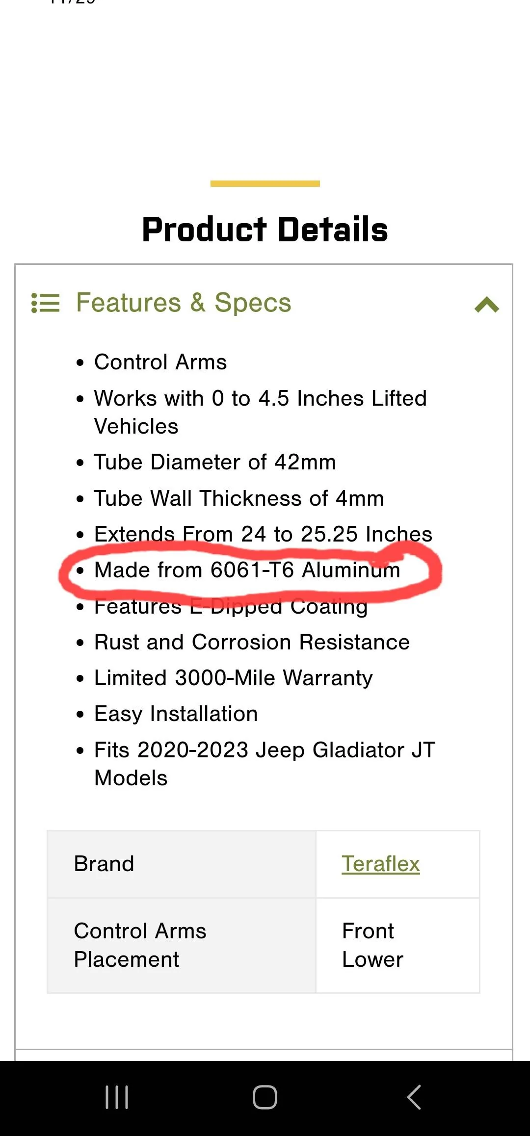

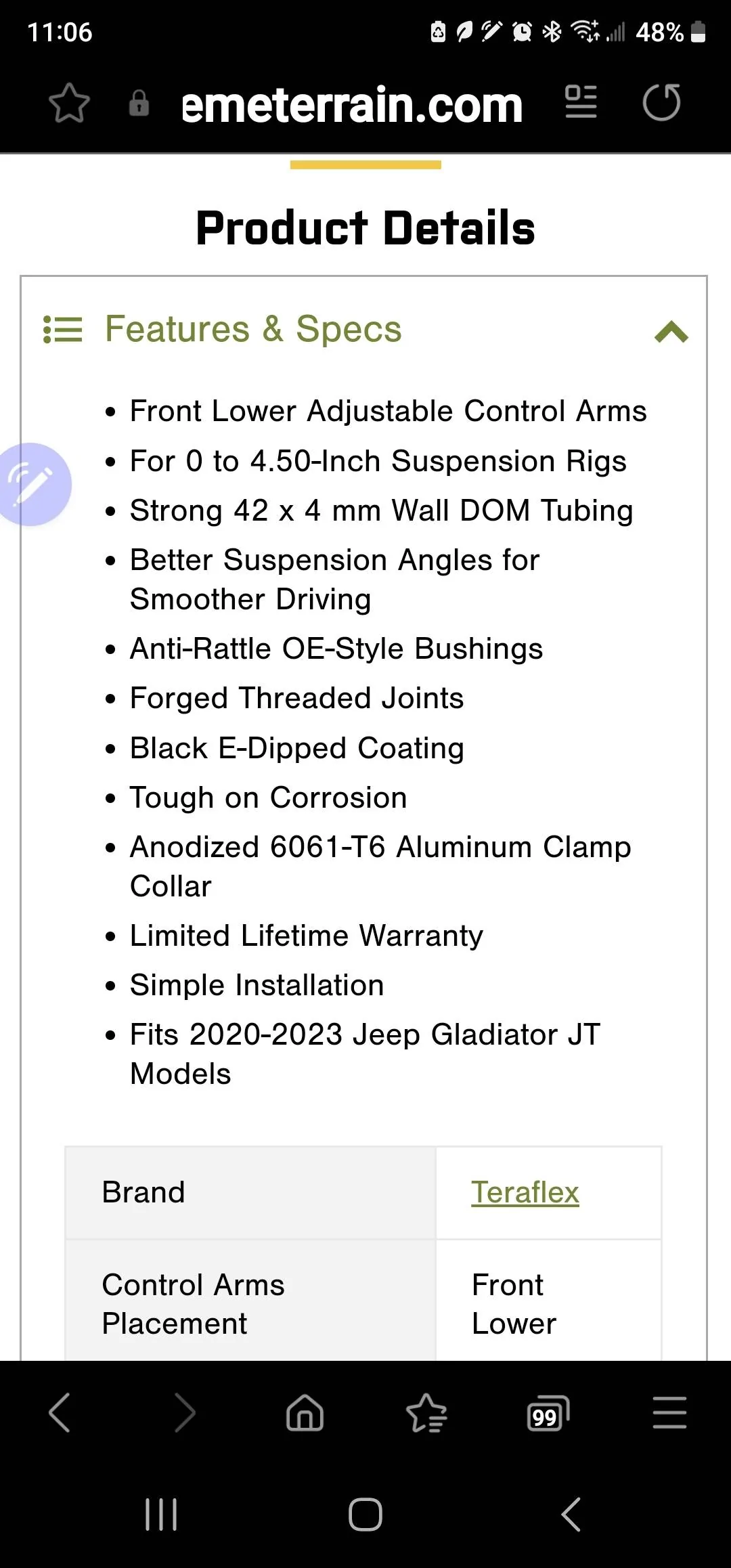

No I didn't do the IR's because they were aluminum. I can't have aluminum. Too many rocks were I wheel . I was afraid I would tear them up and the warranty on those was less than the teraflex regular DOM tubing steel versions.

They’re definitely not aluminum. They’re steel 42mm diameter with 4mm wall welded tubing.

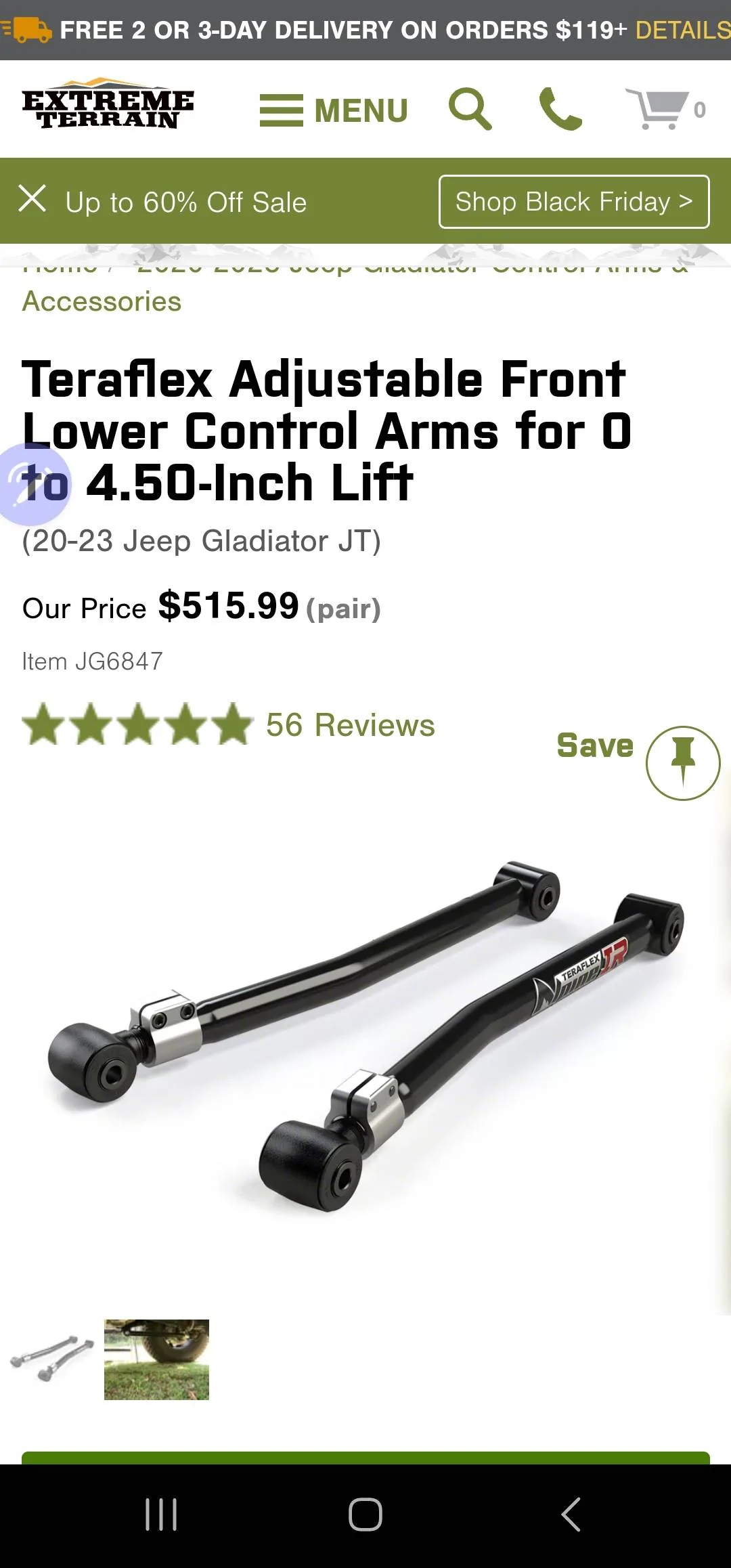

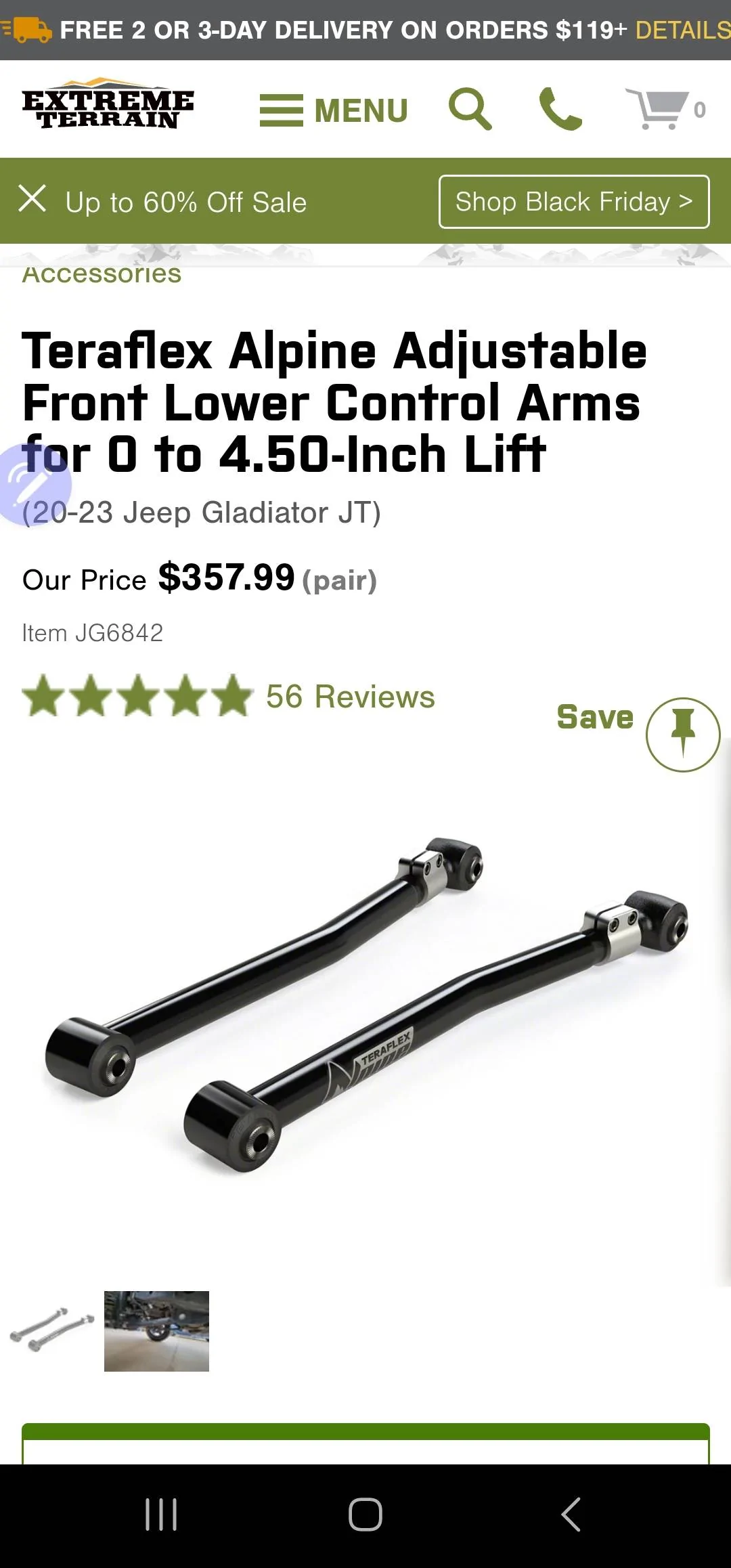

Yeah I am sure cause I called teraflex directly to confirm this was true if these are the same ones you was looking at. First Set of IR that I decided not to go with second set the ones I went with. The IR's are Aluminum and aluminum collar the others are steel with aluminum clamp collar . Also notice the Aluminum ones only come with a 3000 mile warranty whereas the other are limited lifetime warranty.

I recommend you lift them to check the weight. The site you posted isn’t even teraflex.
