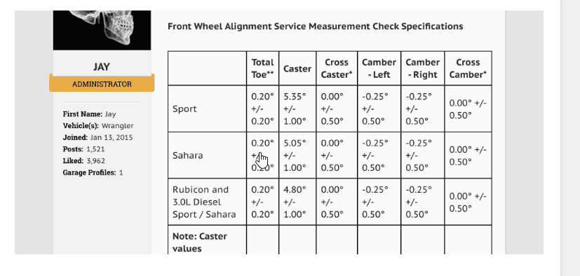

Also found some factory alignment specs for ya as a reference (for the JL but Jt likely similar)
Factory caster ranges from 4.8 to 5.35 depending on the model

Ranchos 90 bux cheaper. Not sure if there is much different on the Metal cloak ones.....
Cool, thanks, I'll save this for reference with the alignment.
