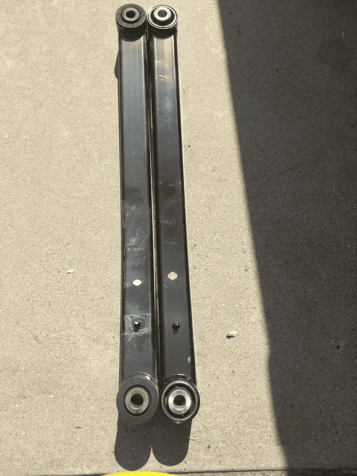

The Mopar LCAs take like 20 mins with swap out. I did with with the wheels on the ground, didn't even need to jack it up
How did you create the extra space to line up the bolt with the truck on the ground? I know it's not much, but the axle has to move ever so slightly.
Hootbro
Apr 13, 2019
10,198
19,978
2025 Gladiator Sport
I have done it twice. First time there was enough slack I could roll the wheels to get into alignment. Next time, I had to put a jack under the front differential yoke section and just ever so slightly lift up/down and everything came into alignment.
Small alignment tool like a 12" "lady Slipper" pry bar also helps.

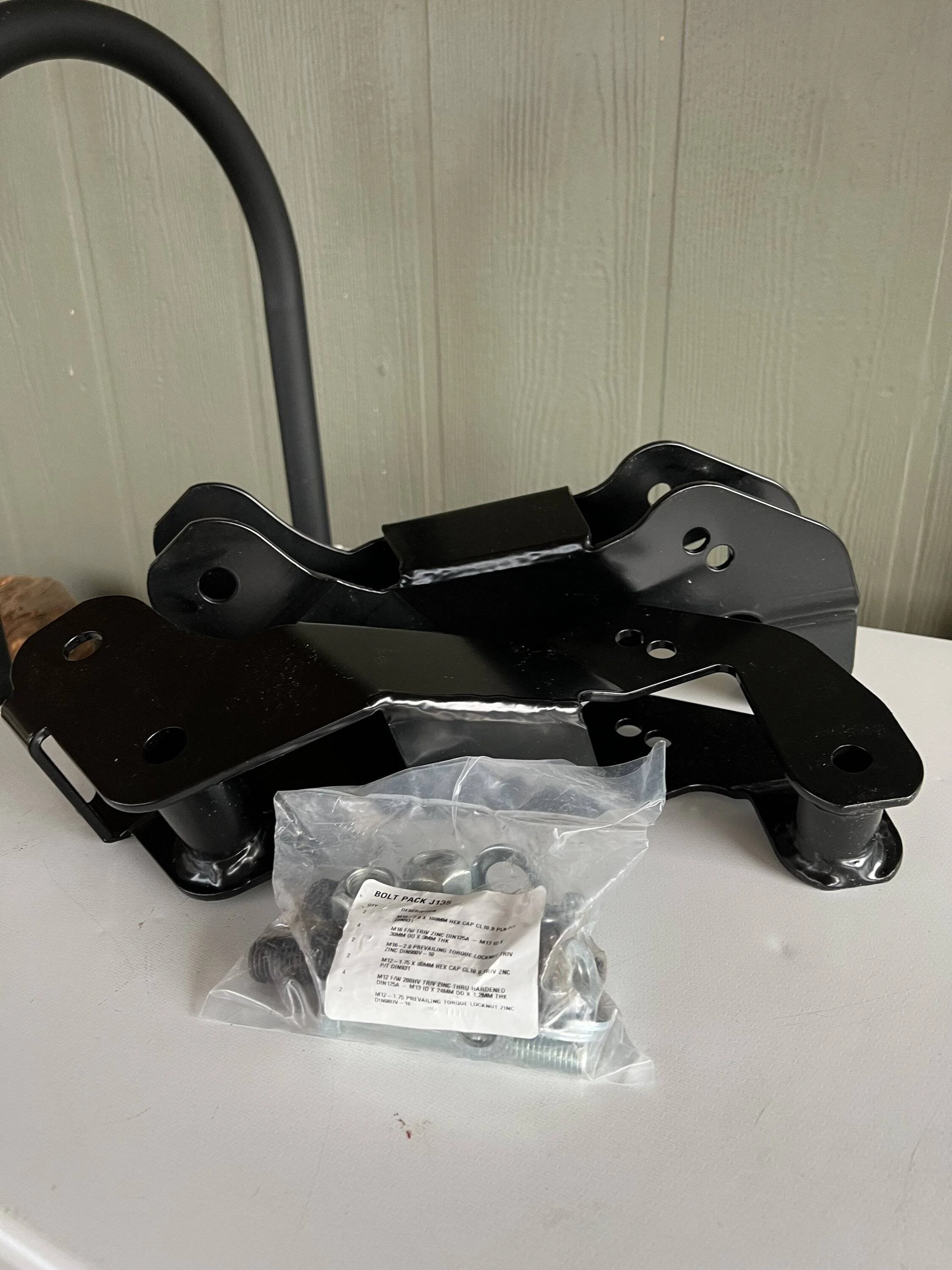

Another option for geo brackets are the ones from JKS Manufacturing. They are very well made and beefy. I have a set in a box in case I decide to add another 1/2" spacer to the front 1.5" TF leveling kit.
Jeep Gladiator Mopar control arms vs drop brackets for 2 inch springs IMG_8173
https://a.co/d/2obacX6
