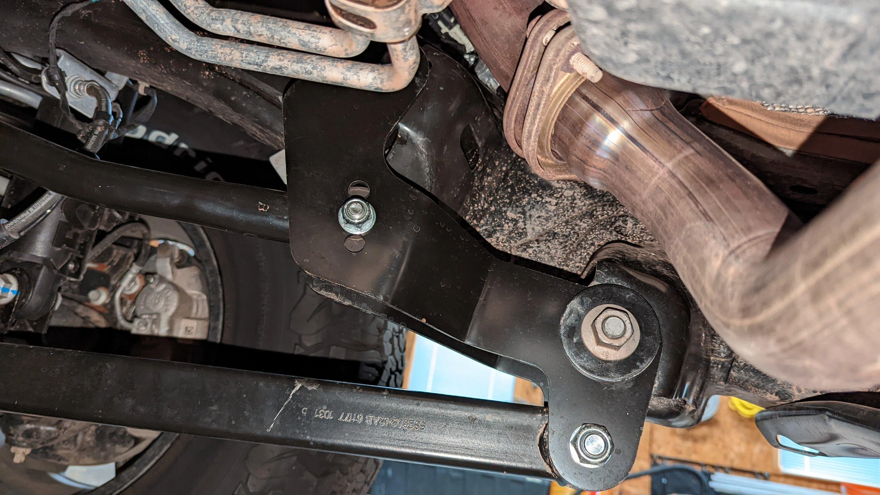

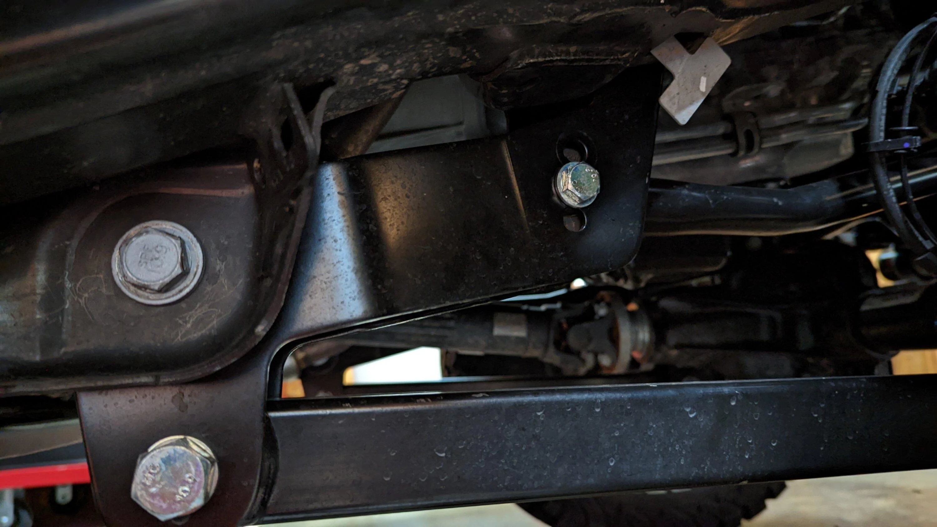

Installed the @TeraFlex rear geometry correction brackets.
First drive - it feels less harsh and less hoppy in the back end and more planted. Maybe I'm imagining things, but it also feels like the Jeep rolls easier when coasting. Pinion angle thing maybe.
It's a pretty good workout to install, and I had to use a ratchet strap to pull things together to get the last LCA bolt in, but it's not awful. The right tools sure help. For example, torquing to 111 plus 90 degrees is easier when you can run that 90 degrees with the impact.
The only reason I can figure the smaller bolts are there is to perhaps prevent the span from bowing out under duress.
They're easier to get in with the wheel off, but you need the vehicle back on the wheels before you tighten the control arm bolts.
Went off road on the rugged grass trail in the front yard for a glam shot.

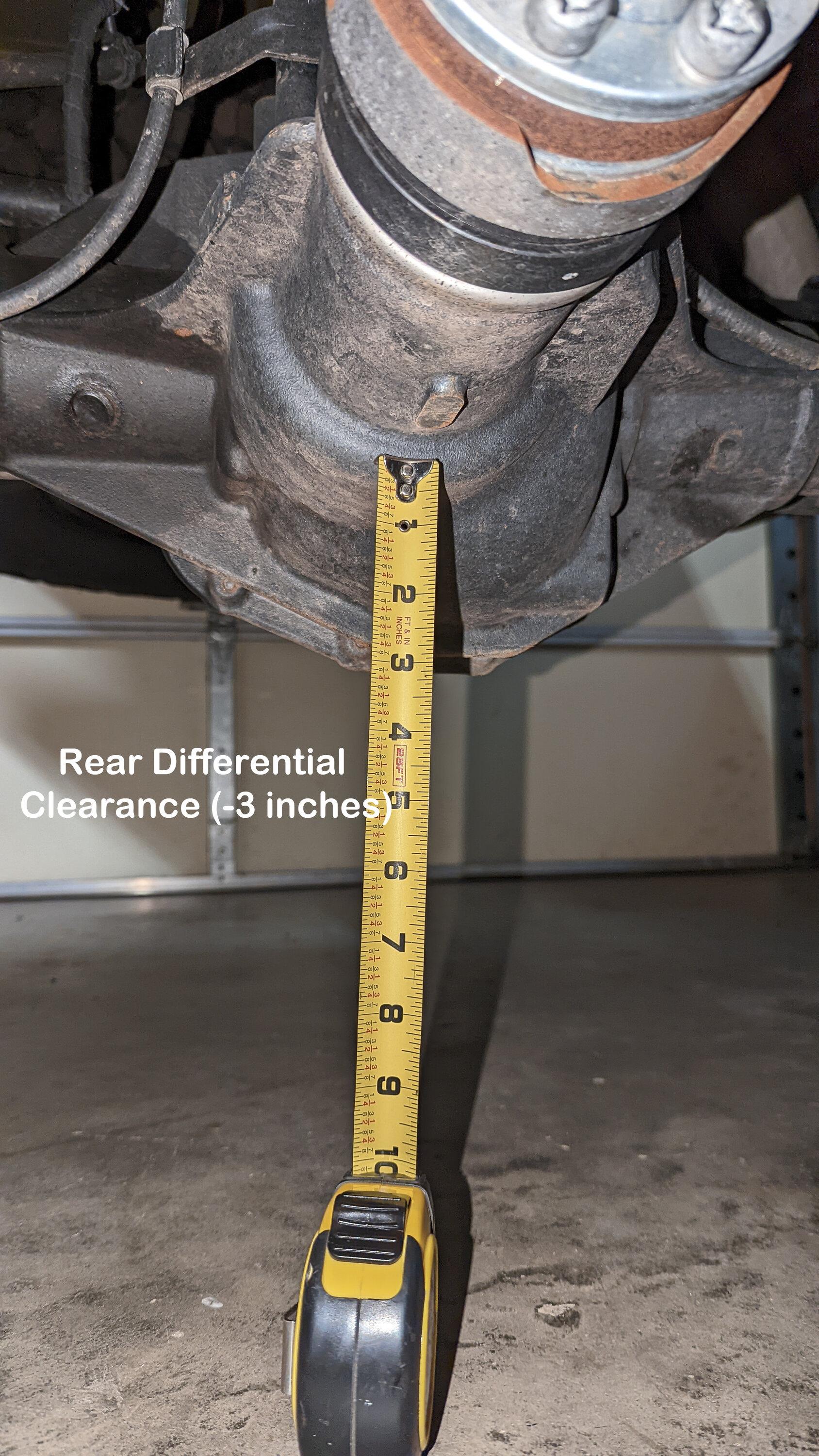

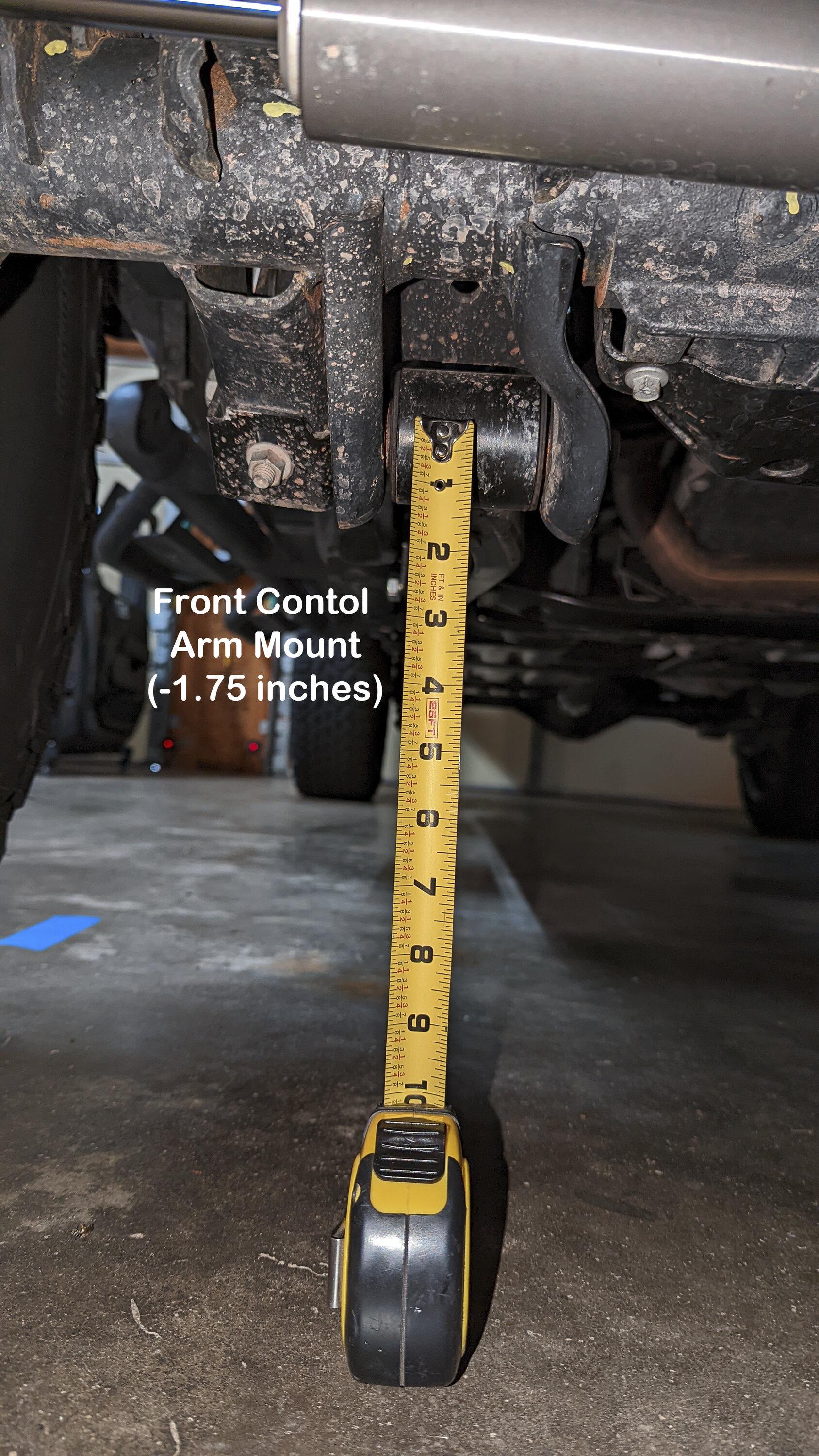

Based on these pictures, it looks like the brackets move the control arms inward as well, by an amount equal to the thickness of the bracket. This could perhaps also lessen LCA rub with larger tires. And by lowering the LCAs, it could also change where/when they rub in certain flex situations.
You have clearance to the bracket of 13.5", but could you measure how much it drops from the current bracket? It would allow anyone to measure their setup and calculate from there.
Thanks!

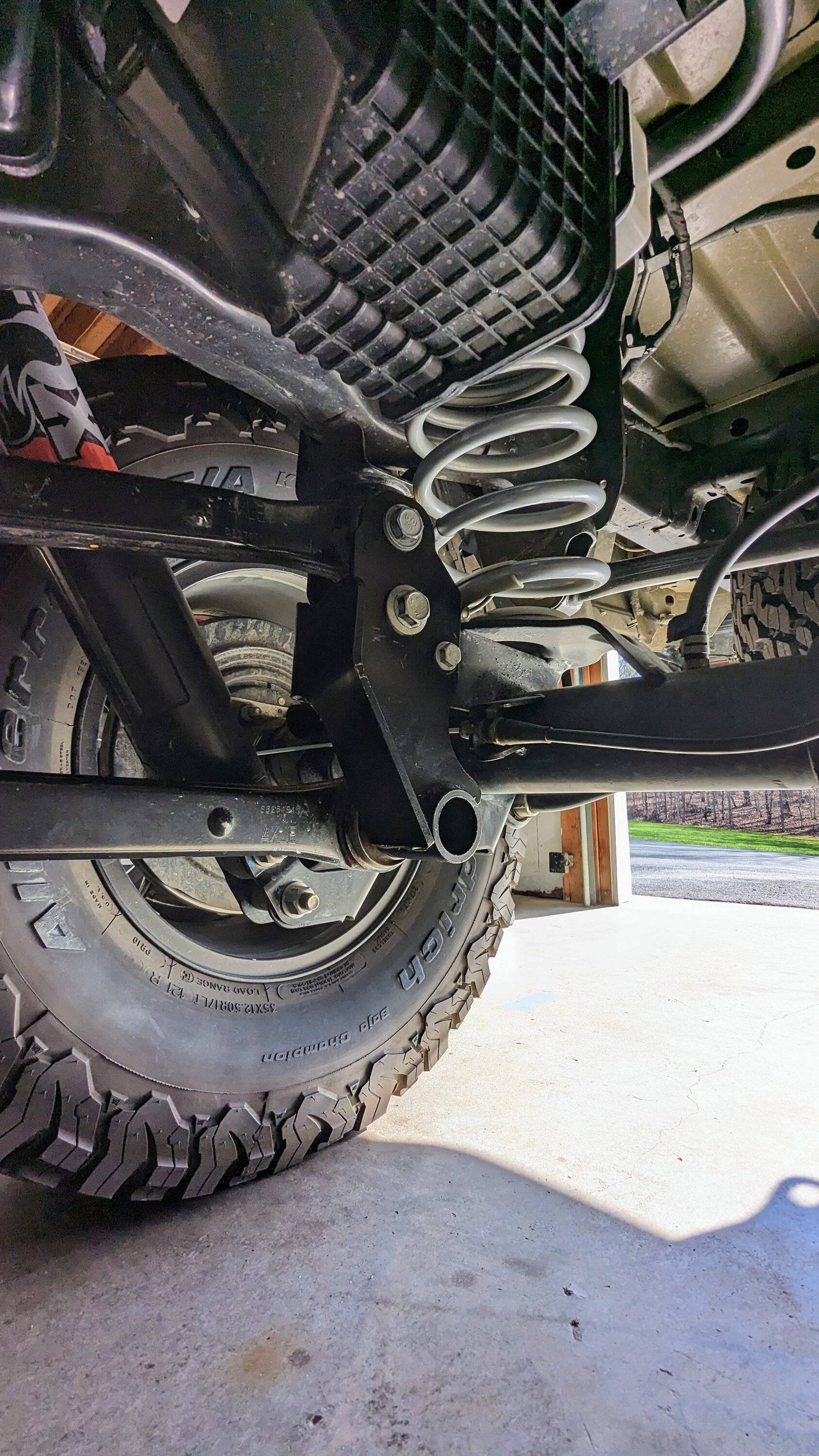

Since someone else brought this thread back, I'll add to it.
I added new shocks to my 22JTRD. I also added the Clayton 1/2" Diesel lift front springs, the ones designed to help with front end bottoming out. Definitely like them.
The new shocks I added have these specs.
Front compressed 17.43", extended 26.66"
Rear compressed 18.14", extended 27.24"
The front aren't an issue, flexed out or on a vehicle lift.
Now the rear, is an issue with stock springs. Flexed out they are fine, but when I put it on my buddy's vehicle lift to change oil, the rear coils unseated. So I added the Teraflex Rear Upper/Lower Coil Spring Retainer Kit 4954000. $70ish and super easy to install.
