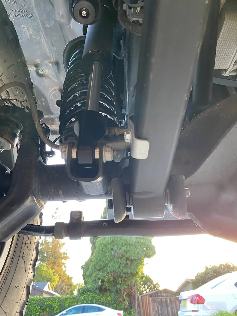

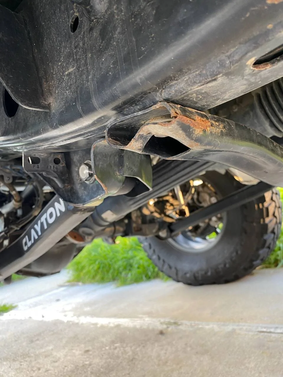

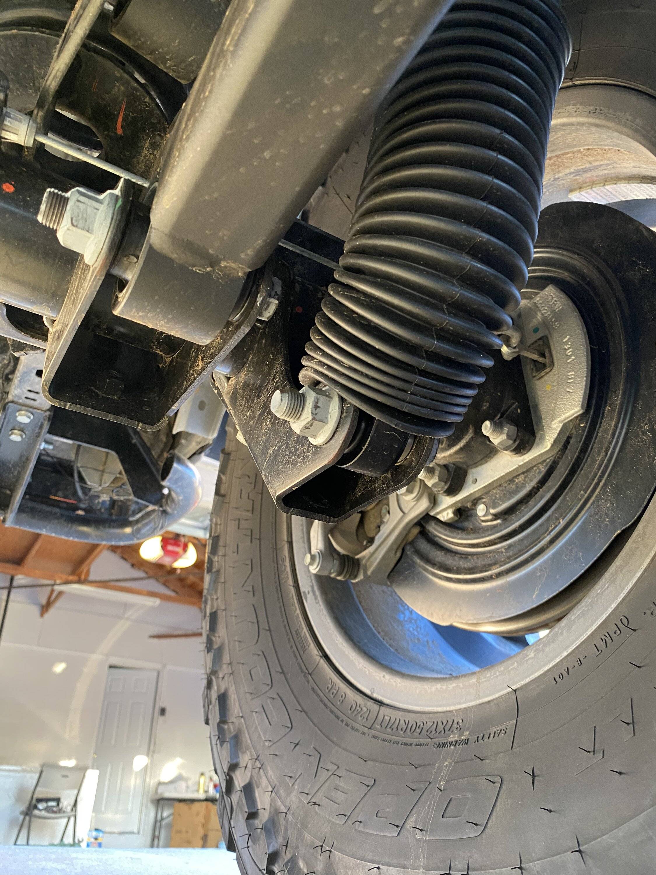

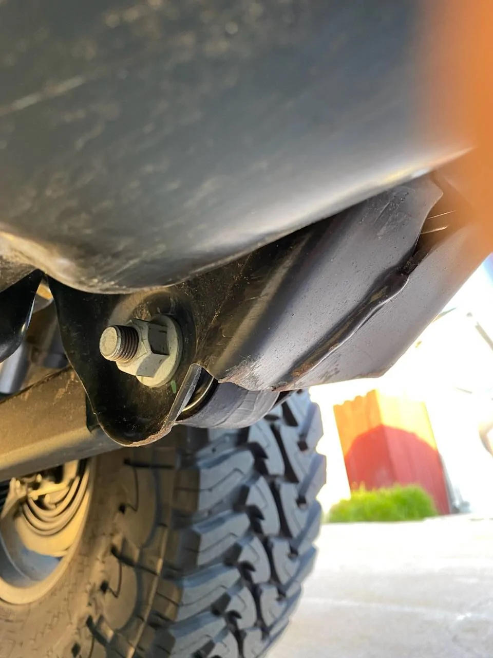

I see where you’re coming from about the other components being lower. But if you check how big obstacles are typically tackled, most of the time is by having the tire go over it, and have enough clearance on the side or have trusty sliders to pivot/finish passing the obstacle. With this in mind, the lower control arm in the front isn’t really important being so close to the front tire, likewise for lower rear. But the bracket sits behind the tire and would be in direct contact with whatever obstacle one would be passing over.
To illustrate, here are mine,
Front, hang low, no scratches:
Jeep Gladiator Relocation Brackets vs Long Control Arms 66AE1B64-EAFF-4DF7-8380-55F880EC2676
Right behind it, you can tell those seen some adventure and are way higher:
Jeep Gladiator Relocation Brackets vs Long Control Arms 6F408CE3-281C-4884-9D13-2F1973952843
Now for the rear, the lowest point has no scratches never seen a rock:
Jeep Gladiator Relocation Brackets vs Long Control Arms DD8EB03C-CC11-4022-A5D1-98A08045DC23
but the one in front of it did:
Jeep Gladiator Relocation Brackets vs Long Control Arms 7C062BAB-C15C-4569-8E93-2CBAD8CFD7D6
I hope this helps, ?

Valid point and a very important one. But it begs the question - what kind of terrain were you in? It has been expressed multiple times now that those who choose the geo bracket style lift do not run hard core rock trails every weekend. Now if you experienced this on a rough and less maintained forest service road, then yeah there is a problem - but I'm willing to bet this was done on a rather large rock obstacle?
By the way are those the Falcon shocks or something different? Maybe it's the angle but they look kinda black to me.
I’d never put drop brackets on something that will be wheeled. Even if it doesn’t hang as low as something else, it’s still being changed to be lower and that’s more stuff to get in the way and get hung up on. Same reason you do a high clearance t-case skid vs using a t-case drop even though you’re dealing with something higher than other things that are lower.
For more road use and better road manners, I’d be fine with using drop brackets. I don’t see the need for them with my Clayton 2.5” lift that’s about 4” front/3” rear.
The very post that you quoted says specifically that the OP does NOT wheel his rig every weekend, but rather drives plenty of rough forest service roads and beat up paved county roads.
ParatusExpeditions
Mar 18, 2022
441
377
CA
22 JT Rubicon EcoDiesel
Right, I do not run geo brackets because I wheel my JT hard sinceI got it even stock. Just pointing out how worse that would be with them and agree with your statement. The shocks are SDI eclik
