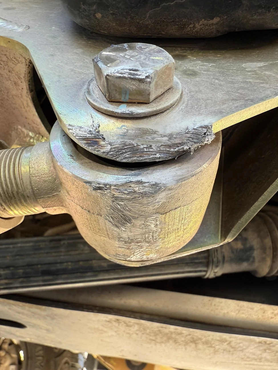

fourfa
Dec 12, 2021
1,137
1,449
CA
22 JTRD + ACCC
I slammed one of my MetalCloak brackets a lot on the Rubicon and it looks like this now (one side only, other side is untouched). Not concerned personally.
Jeep Gladiator Front control arms or geometry brackets IMG_7605
