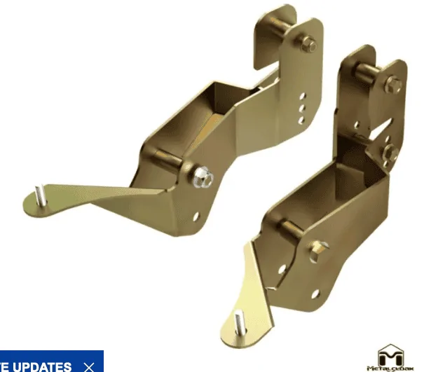

I had to dig a little because it was posted in another thread by @Rusty PW but the Teraflex brackets are beefy and they have additional support braces that you can get to go with them.
https://teraflex.com/jl-jt-sport-frame-bracket-kit-front-control-arms-2-5-4-5-3-5-4-5.html
https://teraflex.com/jl-jt-sport-frame-bracket-hd-reinforcement-plate-kit-2-5-4-5-3-5-4-5.html
Its a tough debate between the three options. AEV (and MetalCloak?) have stamped/forged brackets. Teraflex are thicker and welded. Depending on the weld it could be stronger or weaker. But that is cool they offer an additional bracket for strength. I wonder how much help it actually provides though?
I would bet the Metal Cloak ones would be best against corrosion and AEV and Teraflex are probably equal
Agreed. Metalcloak seems to have the best durable finish and they do make smart good stuff.

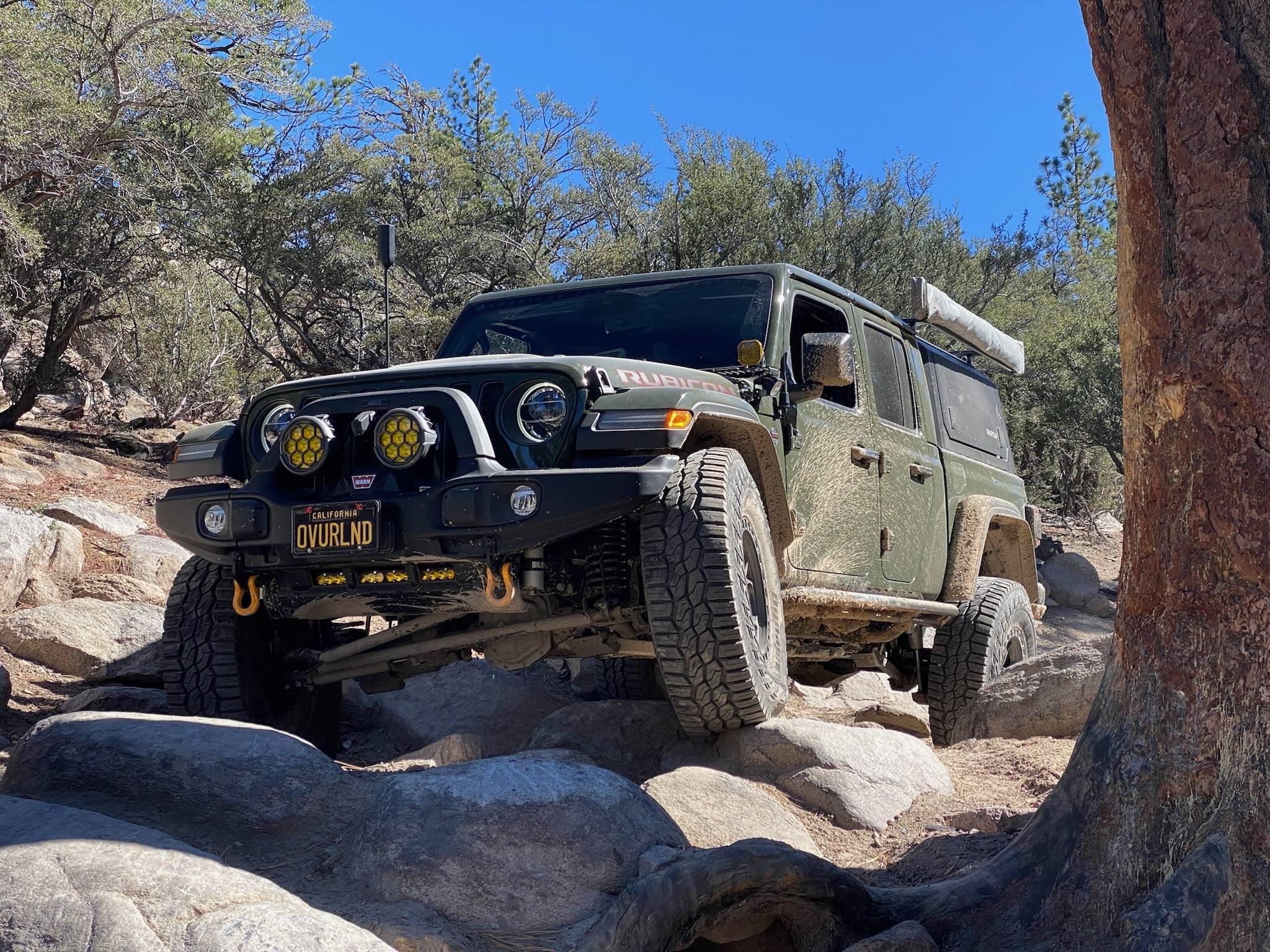

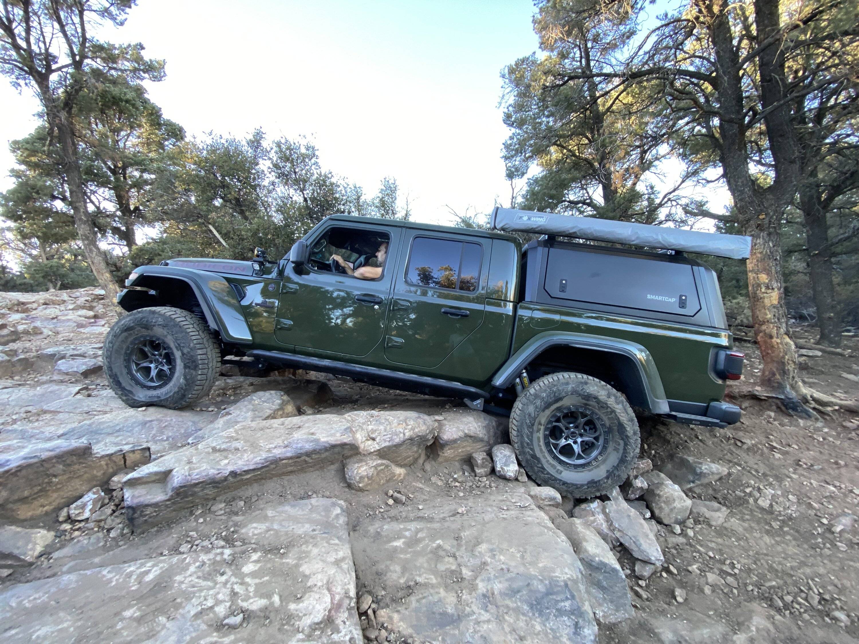

I'm on 37's and 3.5" of lift (Clayton, so more like 5 in the front) the long belly on this thing scraped EVERYWHERE I wanted to go offroad. I do still play in the rocks some, but also lots of steep SXS climbs and whoops where we wheel. I can still drop off an 18" ledge and not scrape a geo bracket, and now I don't get high centered on a rail road track crossing, so it works great. Also rides a ton better than before the brackets.
If I was rock bouncing, sure, it makes sense not to use them, but at the end of the day not needing to buy a dedicated trail rig and something to tow it with was the goal, and I have another jeep that goes where I want it to and doesn't suck driving it on the road.

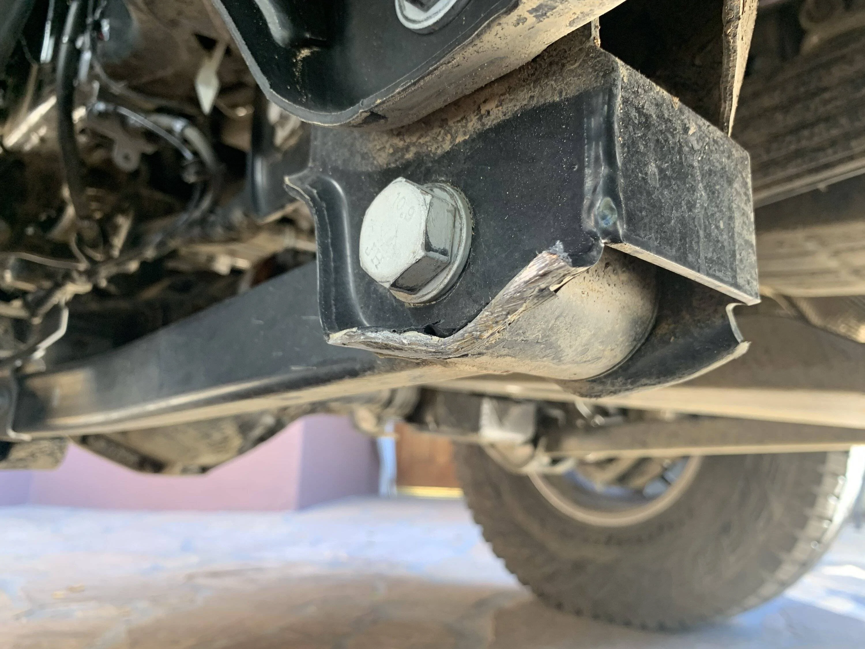

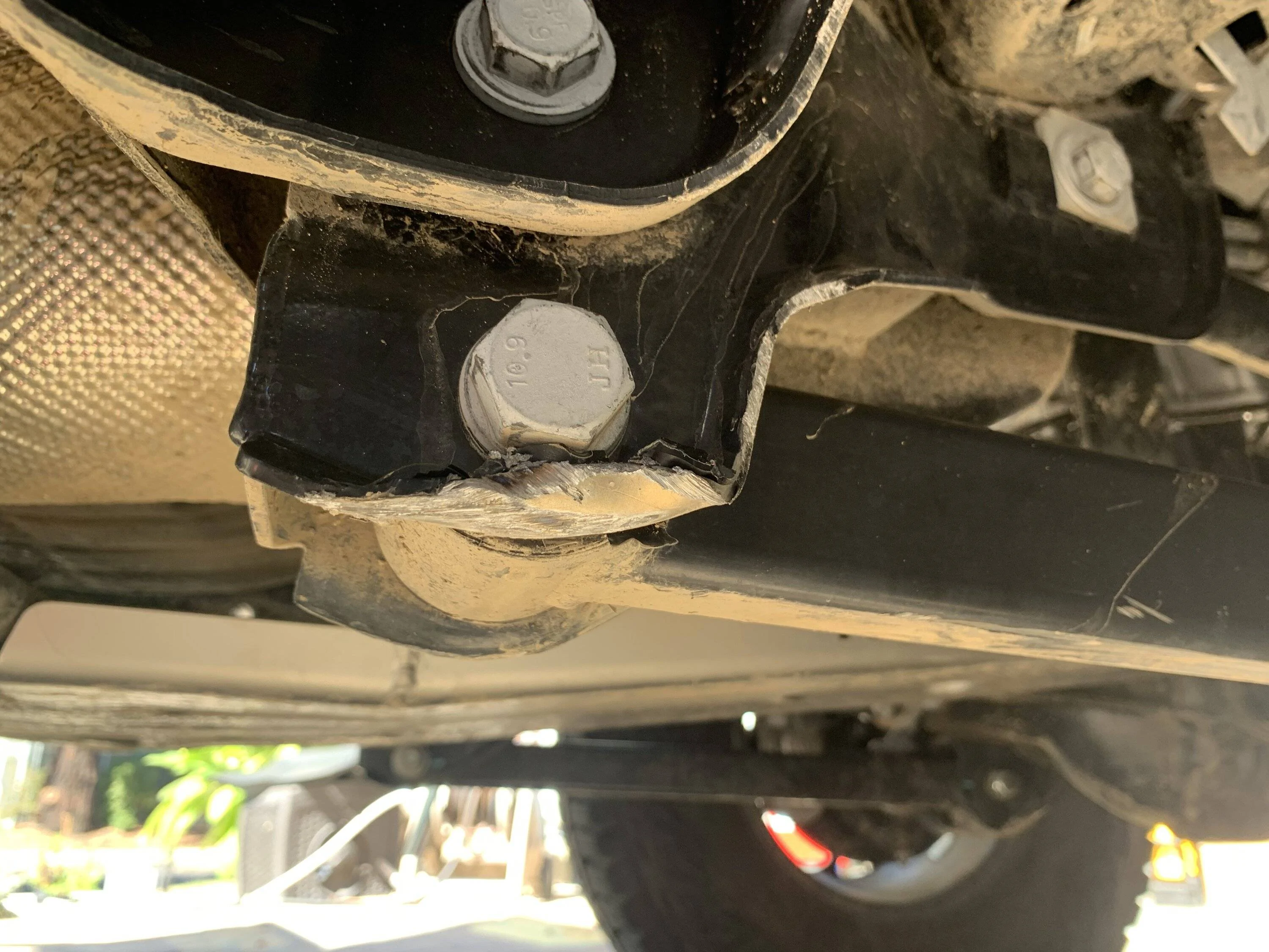

I have an AEV370 diesel. Didnt get it to do hard wheeling so in line with the comments here. I did do some tougher trails when it was new and the drop brackets take a beating. Was able to hammer and bend them back into shape. Might be able to weld a piece of plate on there for some protection, but not sure I will. My JKU with an AEV lift brackets looked even worse since it was on 35s.
Have since added the high capacity 3" springs that gave a little extra height front and rear.
Not sure I am adding much to the conversation other than a visual of how they look with some diesel weight smashing them on the rocks :)
And if you shred them, for a couple hundo you can replace them and its like it never happened.
