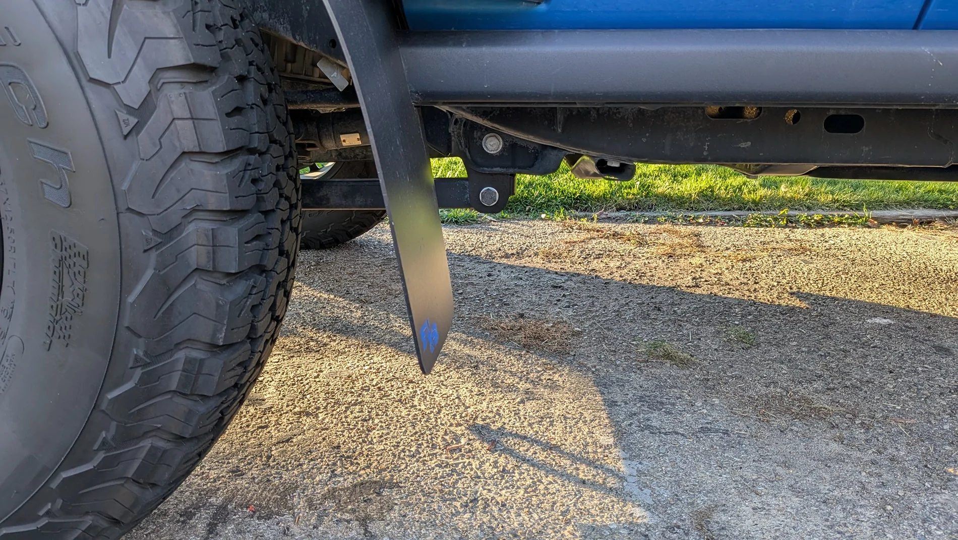

The brackets correct the angle of the control arms. Jeep designed these things to have the control arms close to level with the ground for ride comfort. The brackets let you lift it and keep the same angle on the arms. I have a 3.5" lift and the JKS brackets, and my stock control arms are about level.
