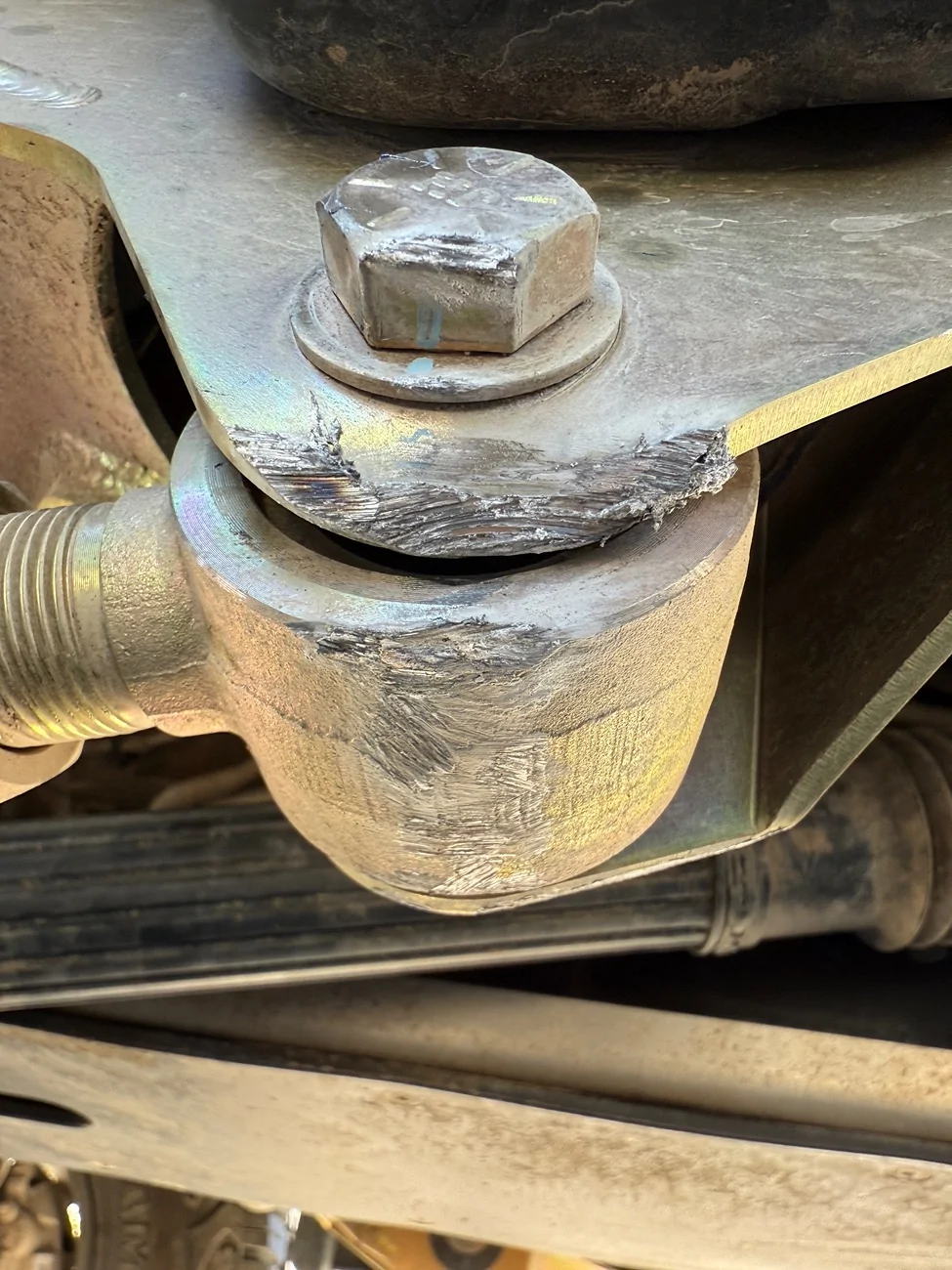

I started with 3.5” lift springs (Clayton diesel), control arms all around, proper increased caster. Ended up with considerable angle on the front arms and a lot of harshness on washboard roads. Even with my adjustable shocks wide open and tires aired way down
I added drop brackets (metalcloak in my case) and reduced harshness transmitted into the chassis was immediately obvious, even on the street. Reduced brake dive was a nice side effect too.
Reduced ground clearance is real, and I’ve slid on mine a few times now. This happened on the Rubicon:
Jeep Gladiator Thoughts/experiences on control arm drop brackets IMG_7605
though ultimately I probably would have made contact in the same spot with or without the drop brackets. Looks like they will hold up to that level of abuse. Absolutely would not take them off - the benefits are too real
I had similar experience with the drop brackets and removed them after 1 trail ride.
IMO not worth it. Buy once cry once with a good shock/spring setup and adjustable control arms. Understand that there's some trade-offs with lifting a Jeep but the majority of it can be mitigated with quality parts.
