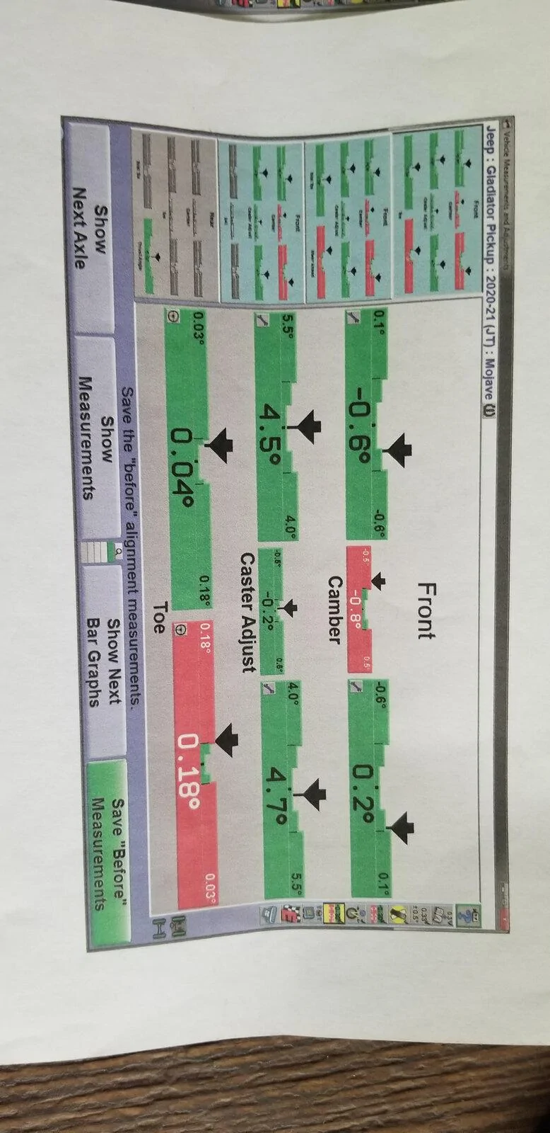

Its a little deadspot, which isn't so bad, but I think a little heavier would help with overcorrect. My biggest complaint of steering wheel off/pull to the right seems to have gone away..I even checked the centering in the garage and seemed pretty straight.

You have a camber difference of .8
.5 can be noticeable and cause a pull.
Here's from an alignment site -
Camber has about twice the effect caster does on causing a pull. On most setups, 0.3-0.4 degrees difference in camber side to side (Cross-Camber) will be noticeable
Here's another example from another alignment site (I could go get my college books but am feeling lazy tonight. I've done hundreds of alignments over the decades but still defer to my college books now and then.)
If your car has .5 degrees negative camber on one side and 1 degree negative camber on the other side it will pull to the .5 degree side (since -.5 is more than -1). Or if it has 1 degree positive camber on one side and .5 degrees positive camber on the other, it will pull to the 1 degree side (since 1 is more than .5)
Note that both use examples well under .8 degrees difference - one says .4 is noticeable and another says .5 degree difference can cause a pull.
I see no reason to not let them put a new truck into factory specs - especially since it's THEIR suggestion.
I'm afraid I'd tell them to get it ordered if it was mine.
I'd not want a pull at month 37 and then have them tell me sorry, it's not under warranty.............
IF it's out of spec it's out of spec - why resist making it correct while they are willing??
THEN if you have issues with steering or pulling or whatever, well..........

That's interesting as I have alignment sheet images from a Rubicon and from what's listed as "Sport/Overland" and one is 4.0 to 5.5 and the other is 4.0 to 5.7
Not much of a difference at all.

Heard back from the dealer. They spoke with Jeep. Jeep wanted them to verify the calibration on their alignment machine and retest my Gladiator. :surprised: Well maybe not surprising, as I was thinking it'd be worth double checking on a different alignment rack before tearing things apart; and I figured Jeep would want it or a factory rep inspection anyway before doing thousands in warranty work.

So they put it back on the rack, and talked to jeep and now the Cross Camber/Camber readings are in spec...go figure. Sheet's in the jeep but Caster actually went down a few tenths...

Apparently the equipment mentioned above was not 100% calibrated - and of course a lot depends on the person hanging the equipment on the vehicle. I've seen the same vehicle with different readings simply by changing the person doing the work. In this case - one has to wonder about the calibration or the person doing the work as now as if by magic, the caster difference has changed.

Makes me wonder as well..its a very slight change +0.1* caster both sides, to 4.8, Camber on the left went from -0.7 to -0.3, so now cross camber is -0.5 (right in spec, almost magically?), toe is now 0.05 on both sides.
WRT to the stabilizer, as I said at low speeds, not sure I noticed much, but at Highway speeds its quite noticable. Michigan roads are generally crappy, and it seems Jeeps in general, especially IMO with M/T tires get sensitive to road deformations. The amount of effort needed to highway drive is much less with the Fox ATS vs. stock. That alone, IMO, makes it worth it...before adventures at 70 required near constant corrections, this smoothed it out nicely.
My steering isn't loose at all, even slight turn of the steering wheel moves the wheels, and no shimmies either. There's still a very slight pull to the right but this could be road crown, as it not really apparent on left lane highway driving.
Not sure on the LCAs though, I've heard they add +2 which would put me at 6.8, which seems high.
If your roads are rough - and I don't doubt it seeing some of the roads in this country - you may be suffering bump steer - a good one would help there. If the thing wants to follow deformatoins, cracks, worn spots, etc...... that gets tiresome after a while.
