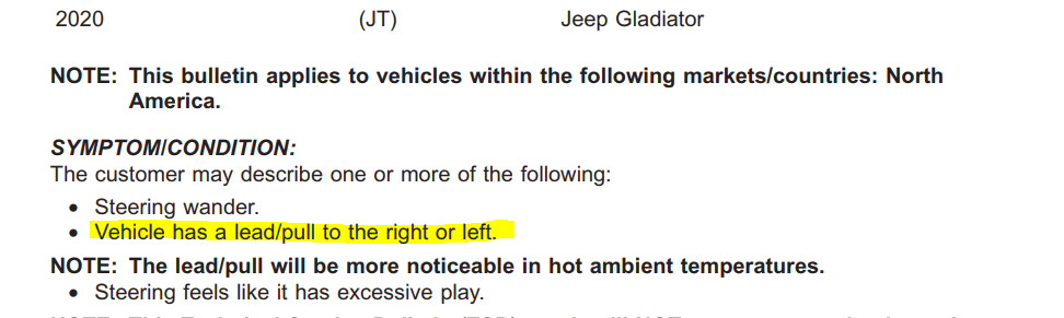

@ShadowsPapa - I talked with BFG support. They confirmed your comments. They said at the most I should run 37 psi (factory standard), but recommended 35 psi. I dropped the tires down to 35 and it was MUCH better.
I still have an issue with it pulling to the right. Any suggestions on where I should ask them to look on that?

Bravo. Well done. And it's great to get the info from the folks that have to support those tires if there are any issues.
A simple thing to check as far as the pull is to swap the left and right front tires. Put the left on the right and right on the left. If the pull is a tire, that will make it pull left instead of right.
Since you have a 2020 - have you still got the original steering gear?
Have you seen this:
Jeep Gladiator JT alignment specs 1639440261962

I have seen some of the forum posts, but no, I haven’t had that work done. I’ll start with that and see where it goes. I have a Launch Edition and took possession in July 2019 (for dating of the build purposes).
